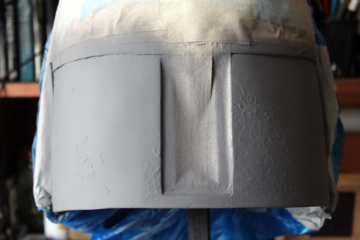

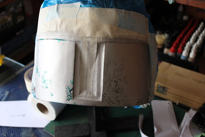

First of all mask your helmet to prevent ant oversrpay, than with an airbrush i applied Testors Aluminium,
And than using the stencils that made by RafalFett and a transfer paper ( i used black but white one works more better) i draw the design and masked with liquid masking medium.
Now its time for grey, heres the mixture, 3 drops of Natural Gray and tiny bit of German Gray, then i applied it with my airbrush (Im using a DevillBiss Dagr but any kind of airbrush will do this work)

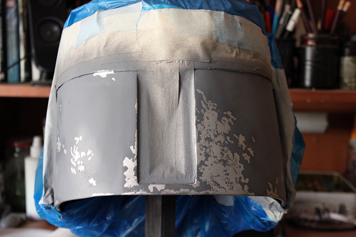

Here's how its look when i peeled the masking, so its time for the cream color, i already have the Andrea's White Paint Set so Base Color no:1 looks very good to me, with the same transfer method i transfered the stencils but this time i used white one which works better than the black one.Masked the areas and painted two coats of paint because of gray layer beneath the white.When i peel the mask off, thats what its looks like,
