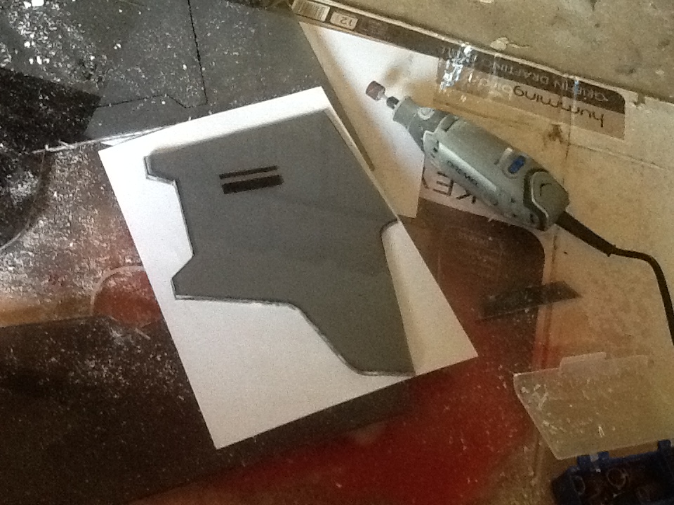

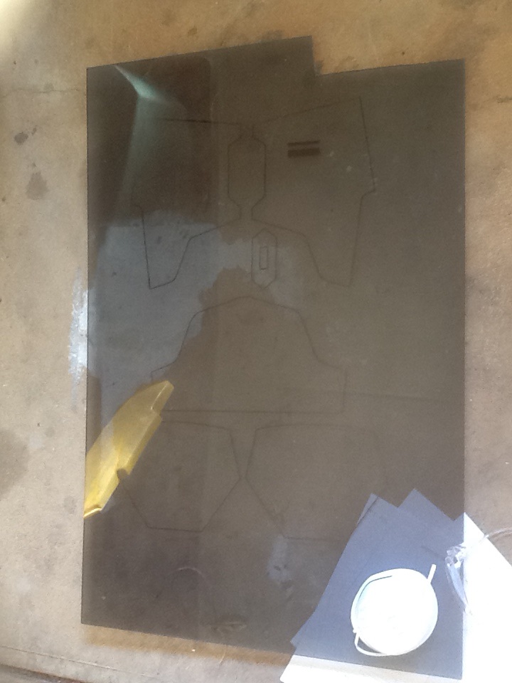

What I used for the Boba armour is 5mm acrylic sheets from the hardware store and the process of
marking it from the templates given here then cutting each shape with a Dremel. I bought 2 sheets
and is enough for all templates. I tested a small bit of acrylic by heating with a heat gun and twisting, also
heating one spot and pushing a paintbrush handle into to see if a dent can be made this way and so
far so good.

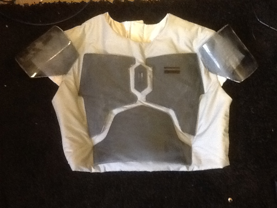

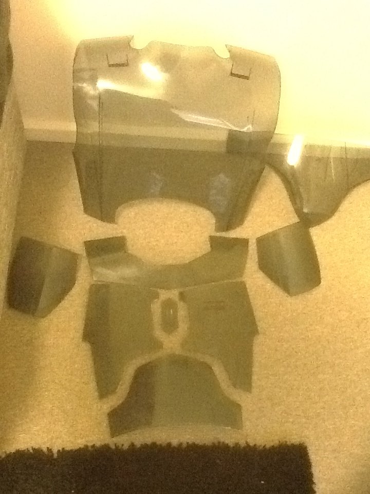

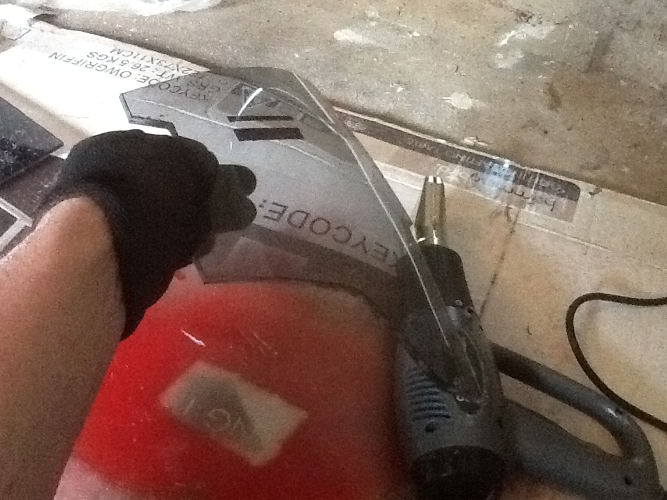

After the pieces are cut out I gently heated with the gun and the flat attachment. It was quite an
easy process as long as you're patient with the heating then gently flexing the acrylic and
holding the shape while it cools. It behaves well and I can get slight complex bends from it.
I've just got the torso pieces and shoulder bells as in the last picture linked. I can keep posting
more as I go with the rest of the armour.

Thanks man. I just use my hands to mould it. Heat, bend and hold. I do it in stages... for example, with the shoulder bells I heat up and down the centre then bend and hold the position I like... then heat, bend hold the outer edges. I reheated one side to make adjustments so both match exactly.
I still have a collar, backplate, cod to do so I can take extra pics and break it down if that helps.

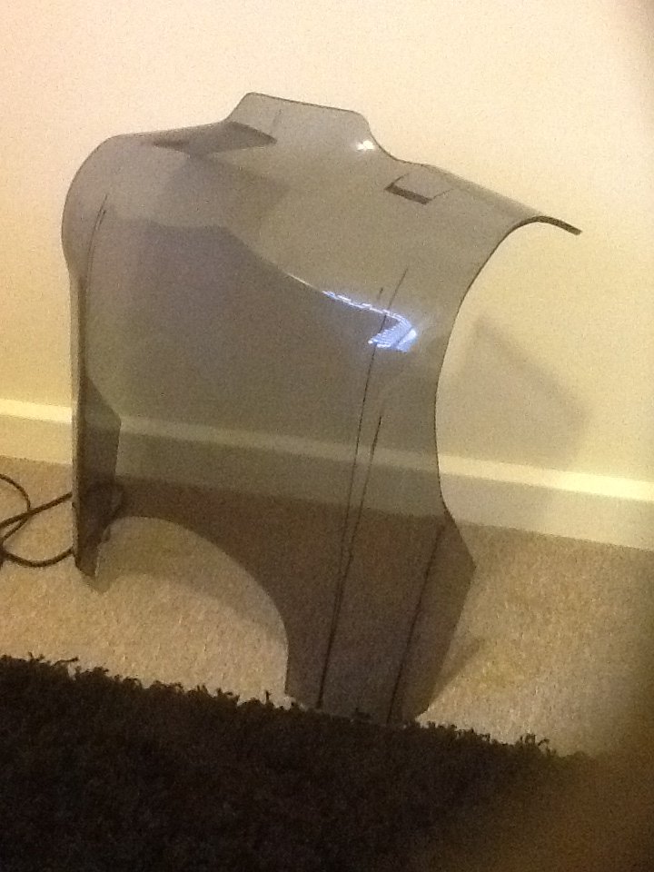

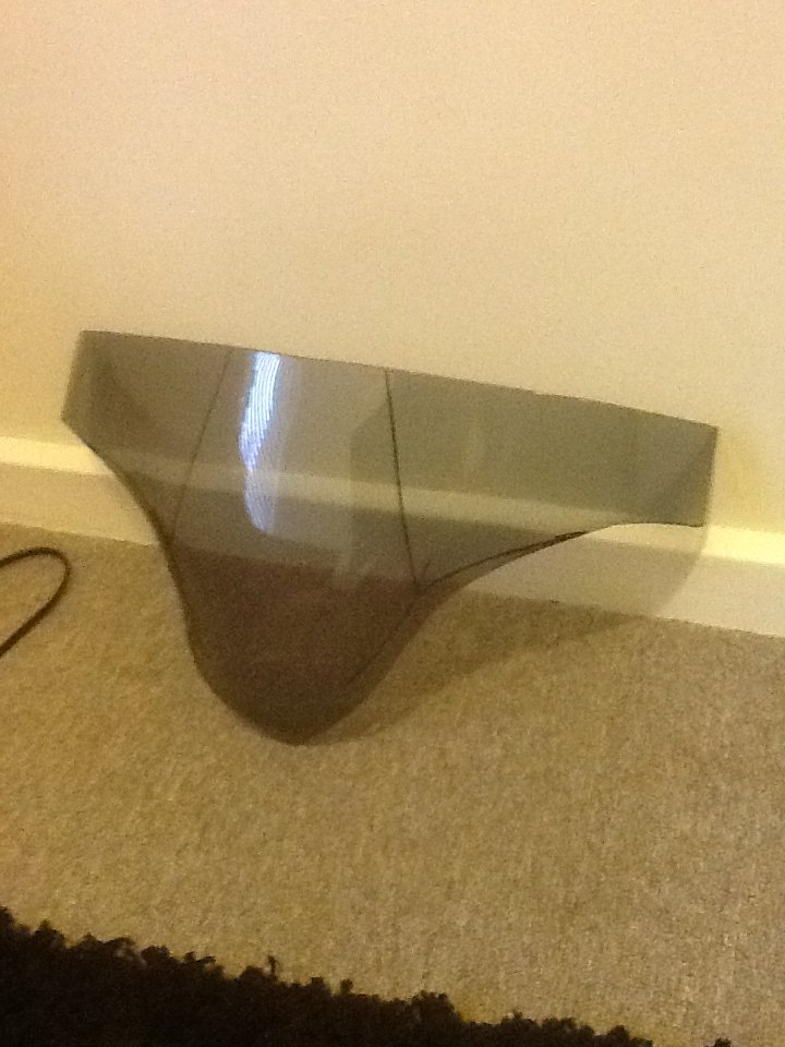

Its been a while since I have been working on all different parts simultaneously, but here are two progress pics for my acrylic armour. The same method was used of heating the acrylic, holding the position for a few minutes while it cools.
Backplate
codpiece
So far the pieces are pretty close to where I want them, I will make further adjustments when I attach the armour to the vest, bolt the collar bit to the backplate (which I have made but forgot to include it in the pic) and work out my under the vest harness system. Im thinking of using a cheap dogsled harness...we shall see....but the main thing I want is to make an awesome snug fit before any kind of painting.
Still a lot of work to go. The cod piece needs that extra bit on the front and the two little oblong shapes. Also, I'll be needing to add the damage. Besides that I think its coming along.

Cheers man. I knew the backplate and cod would be the bigger challenge so I left it til last after I had a bit of practice and feel for the material. I studied the pics very closely and decided to change the lines. Im glad I did. Also the strap vents I'll lower but I'll leave that until my jetpack is closer to being complete and I have the harness done so I can get it just right. Otherwise I found the shaping to be pretty straight forward and took me about an hour to mould it. There will be some more micro moulding adjustments to get the collar fit right. I saw your pvc backplate, looks awesome. I agree with those line changes.
