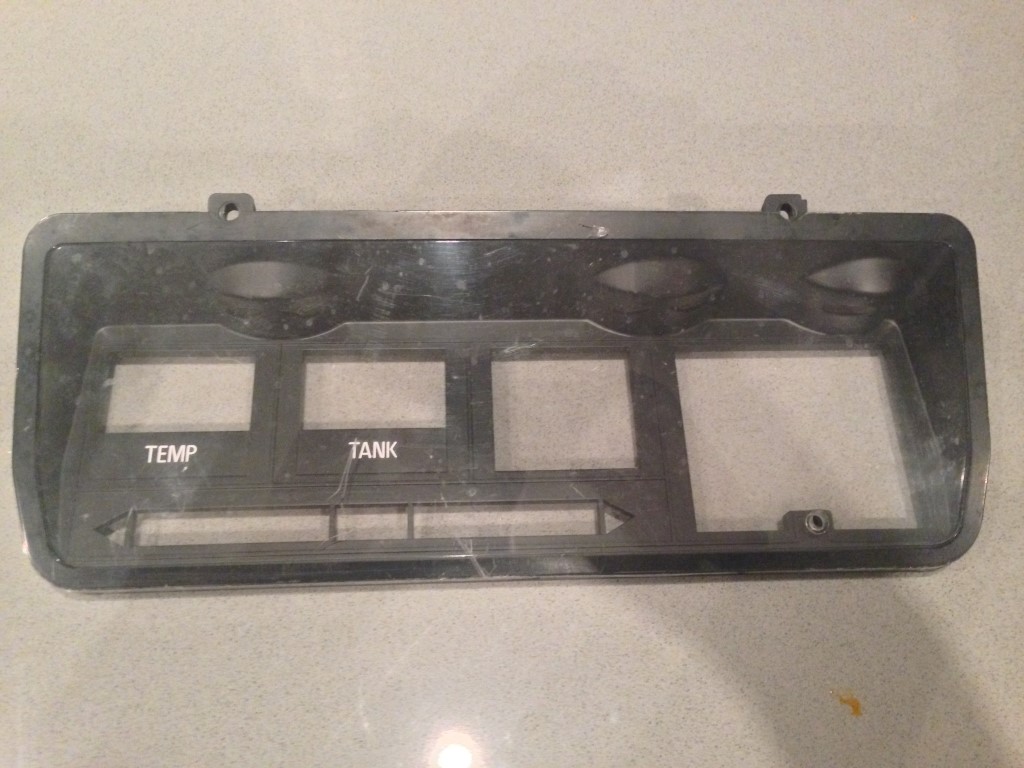

Got a Volvo panel from Philip @ Rebelscum, found the original t-levers, Michell arms and we also figured the panel nipples with the help of Kurtyboy. Lots of info to be found on this!

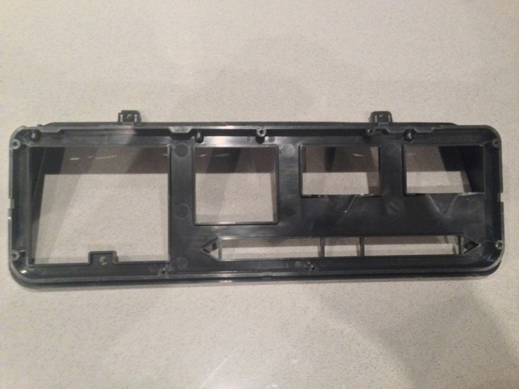

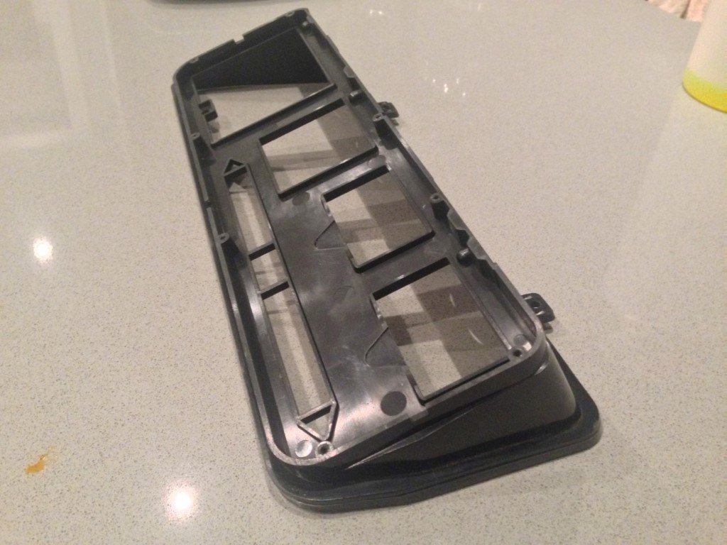

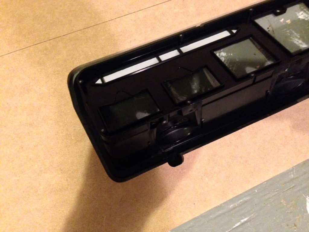

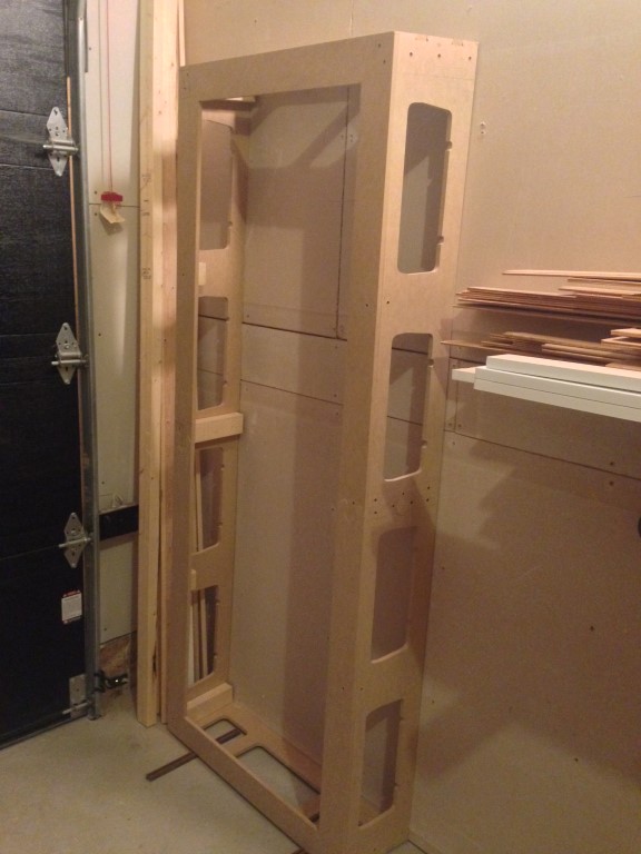

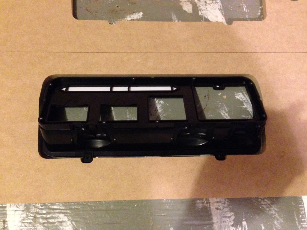

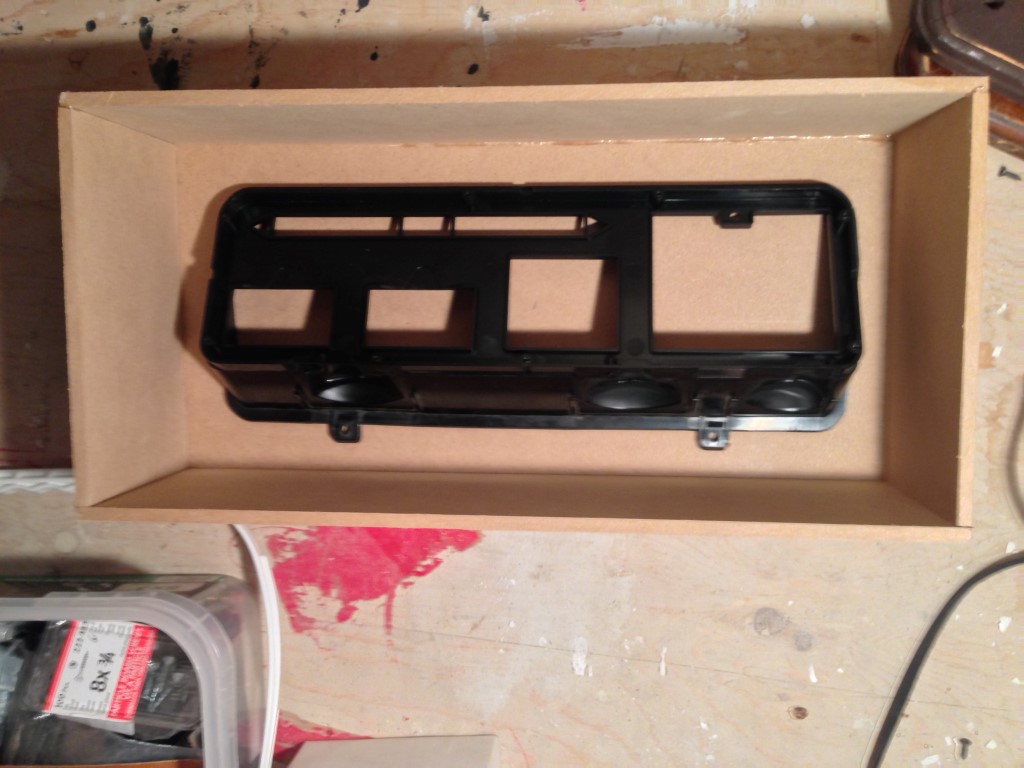

Original volvo panel checked against the box. Perfect!

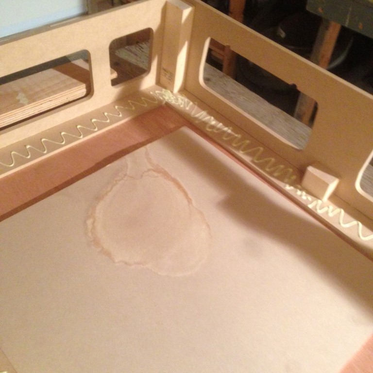

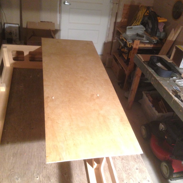

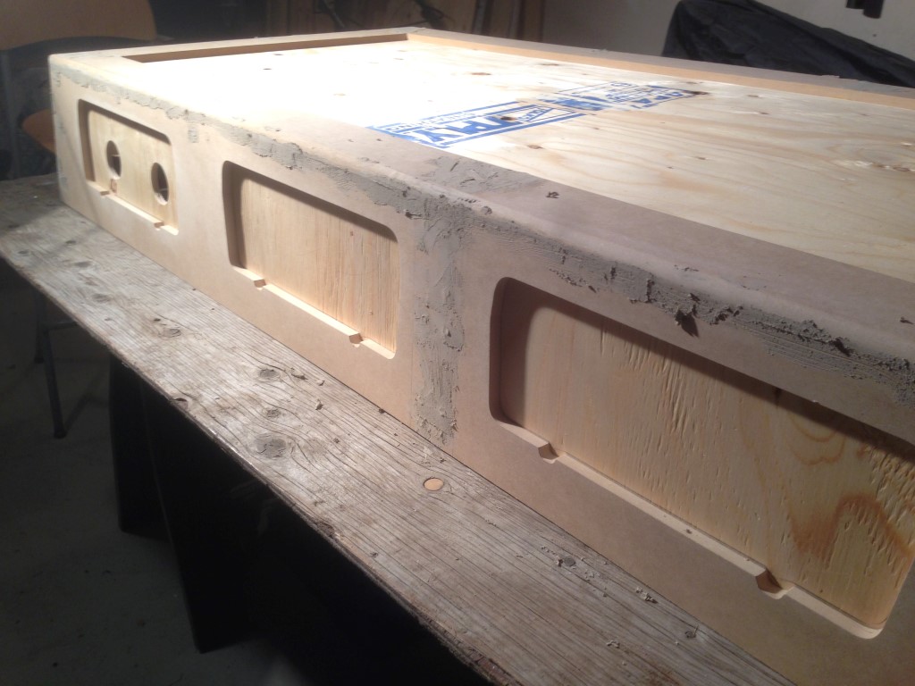

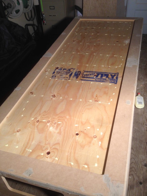

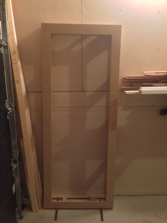

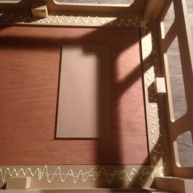

Front panel
Since Zenix's box is about 5/8" thick MDF, I wanted to build my front with the thinnest depth possible to not have to fill with 1/2" of glue. So I built it first, than added a 1/4" thick plywood over the backing. In the end, I should have added more like 1/2" and only kept 1/8" .. you'll see later why!
You can see here the 1/4" backing beside the KingJawa 3 parts cast. What's left is about 3/8" of space. That should have been narrowed down to 1/8" instead.
View attachment 96273 View attachment 96272 View attachment 96274

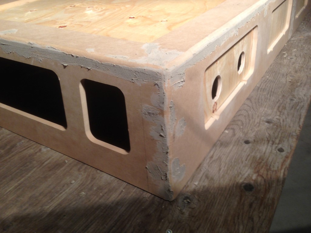

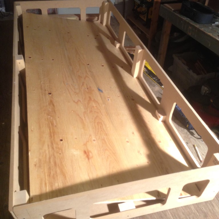

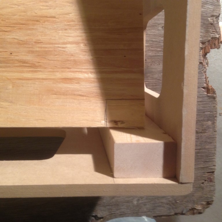

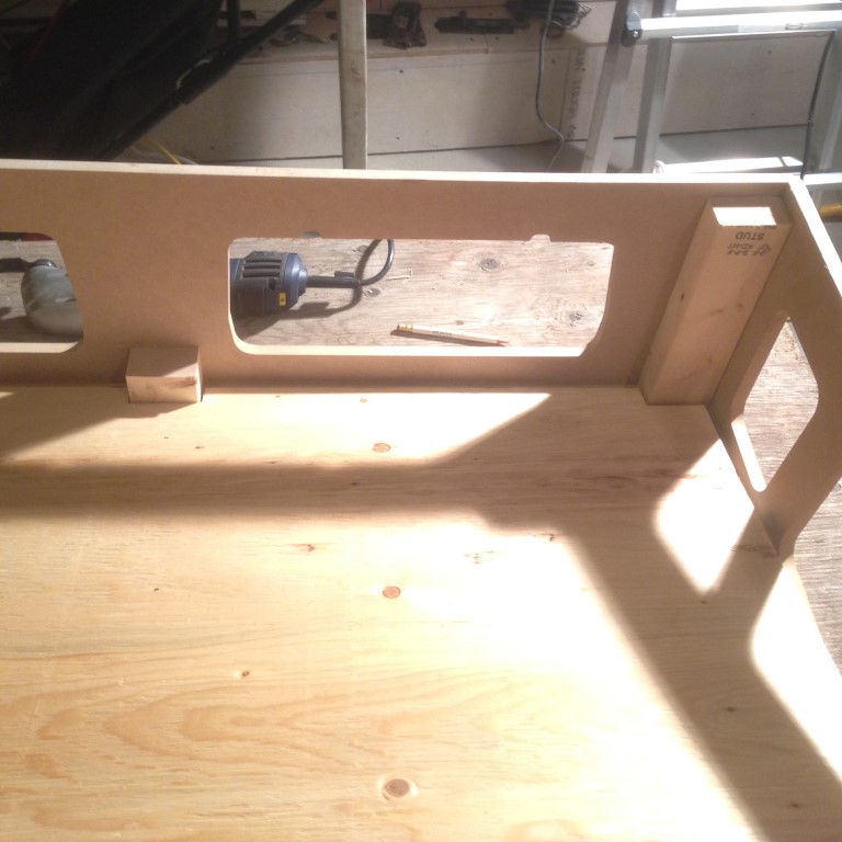

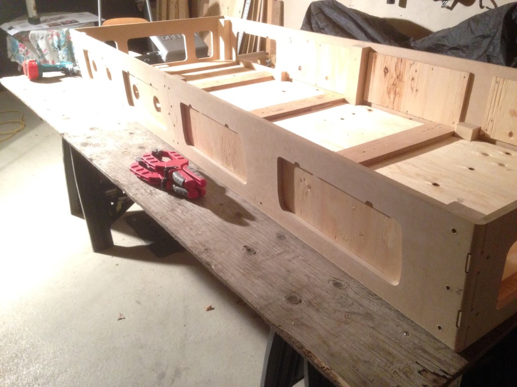

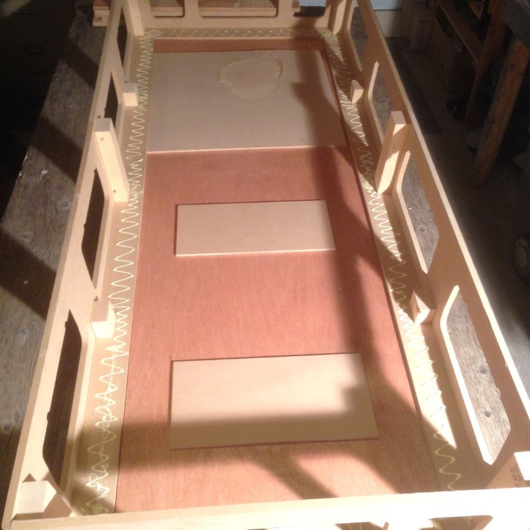

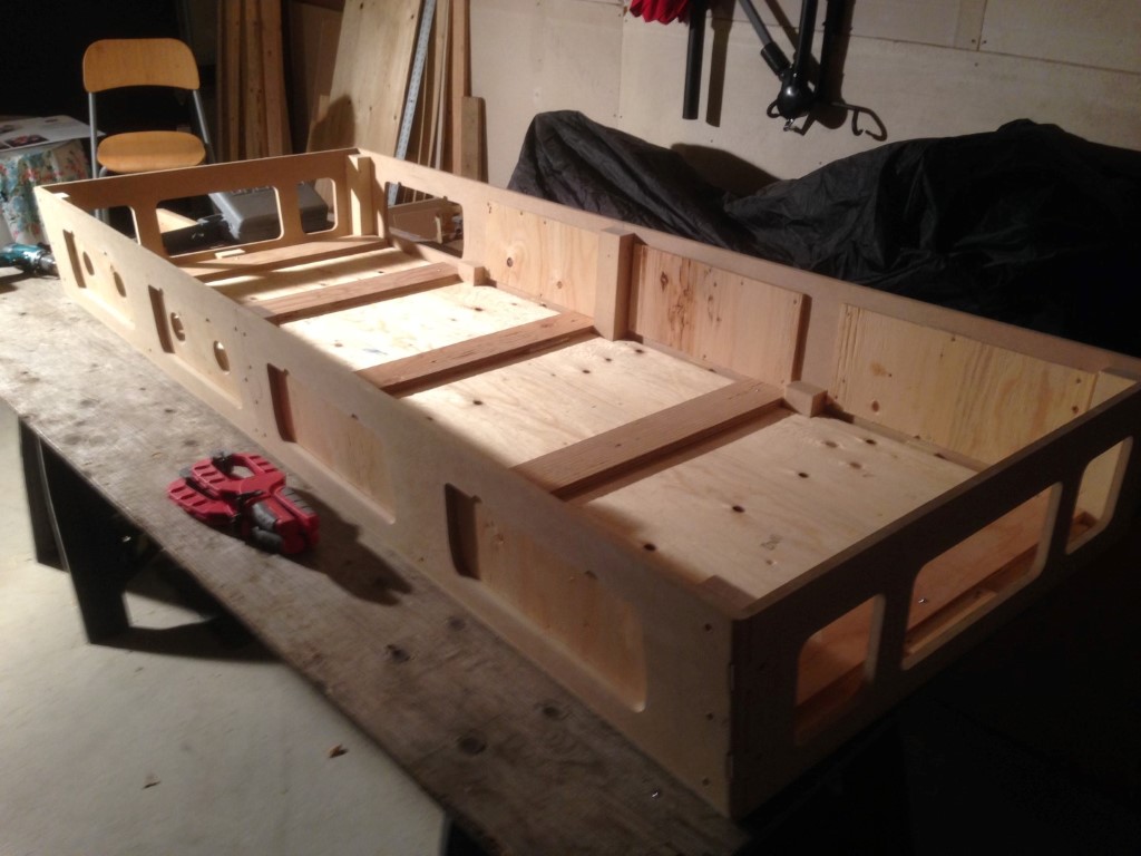

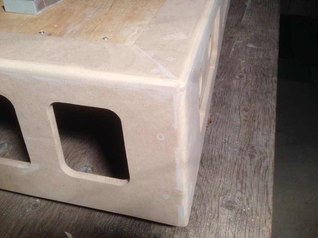

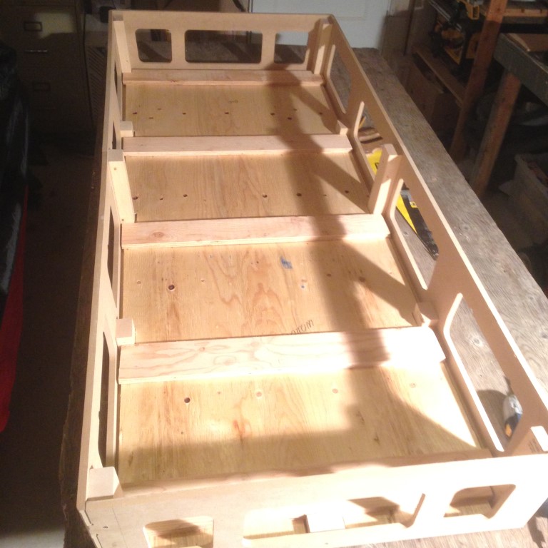

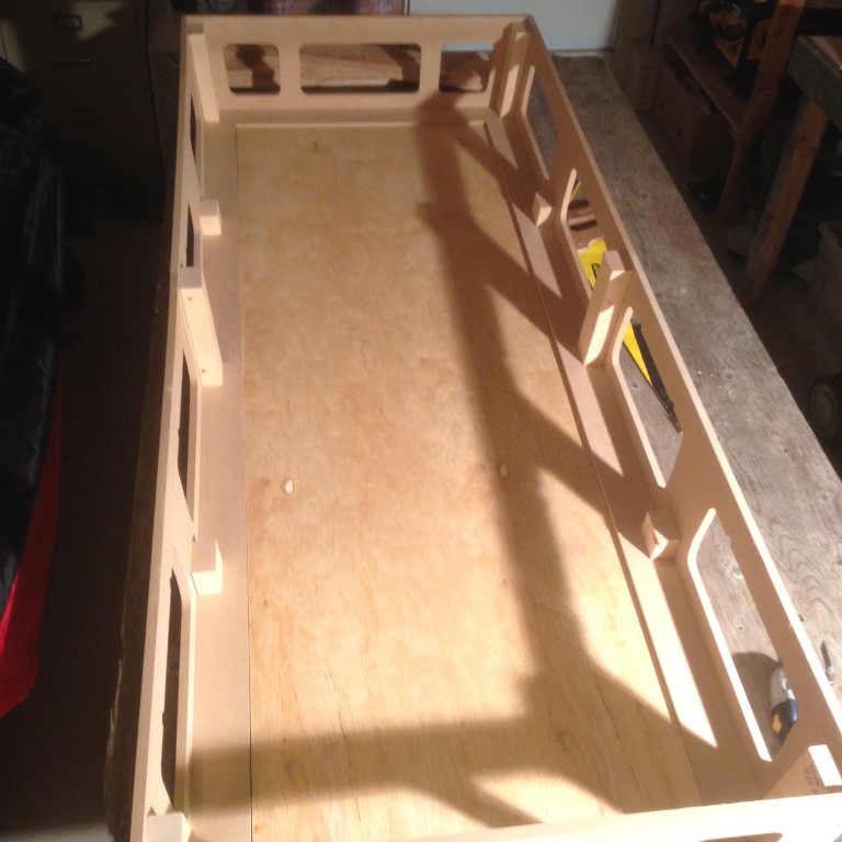

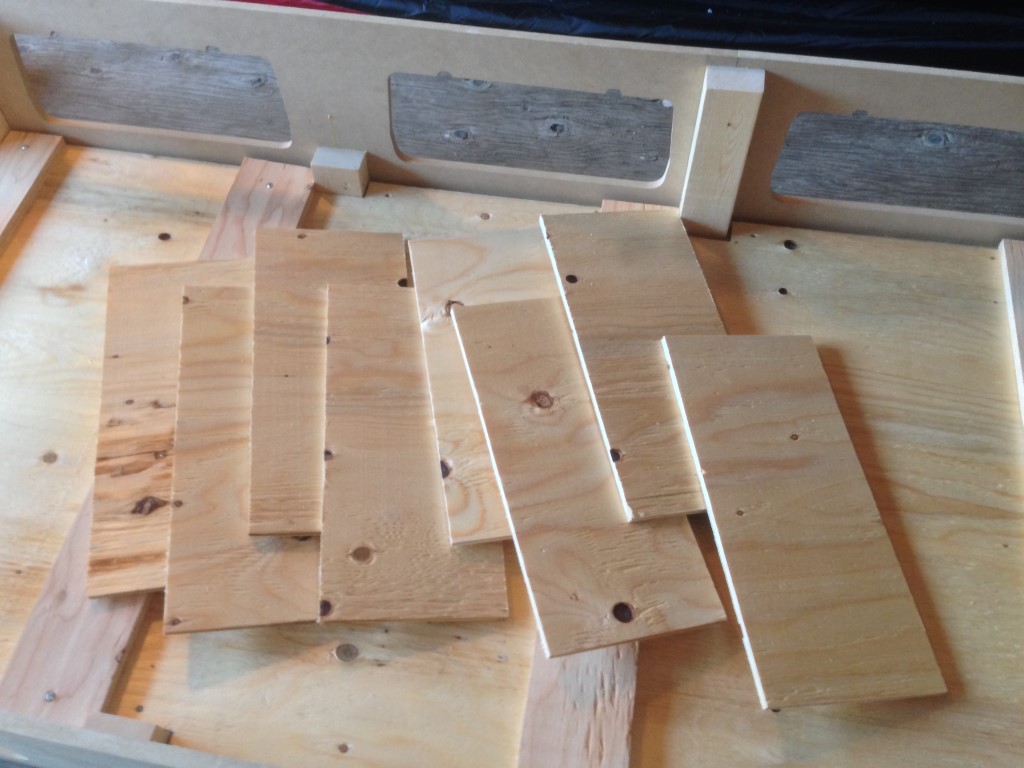

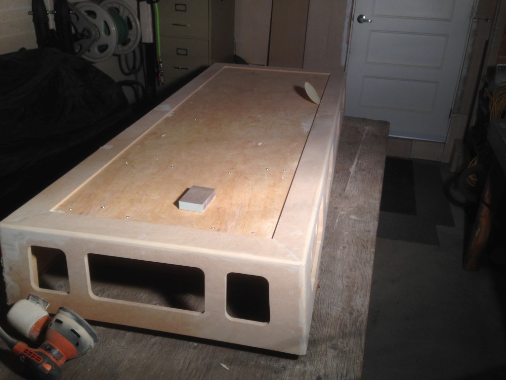

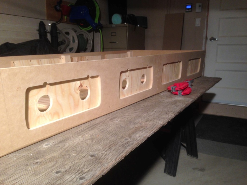

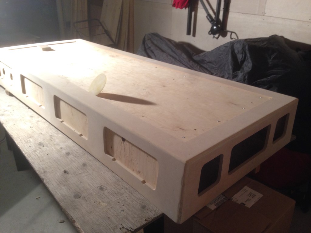

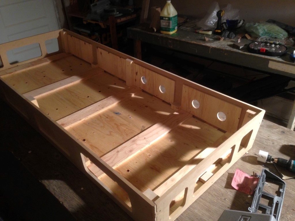

Box cutouts
Side cutout made of plywood .. they will mostly be hidden by the panels anyway so we don't mind for the rougher surface. I just wanted to save the MDF for later, in the end, I didn't use it so I could have done it smoother with MDF anyway!

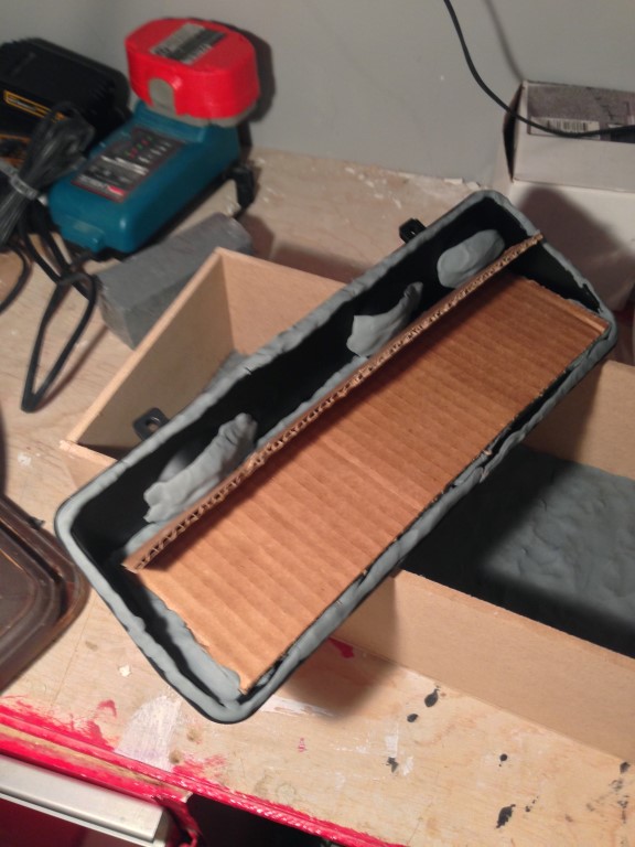

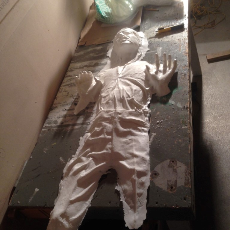

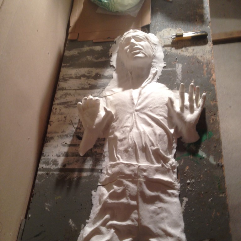

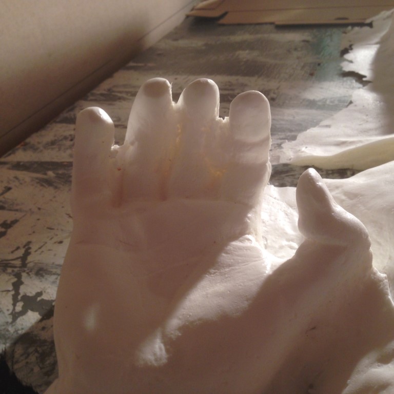

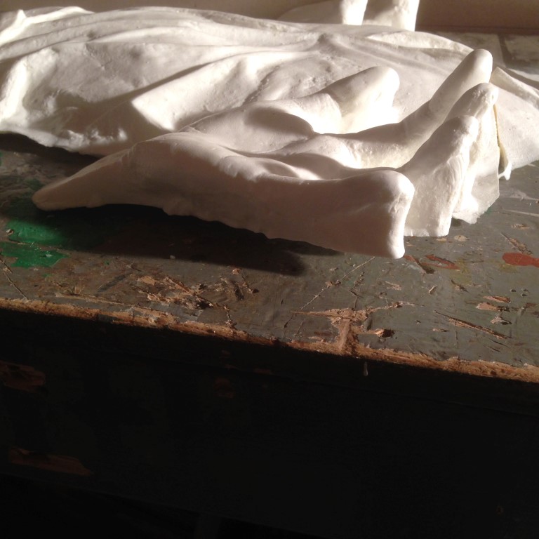

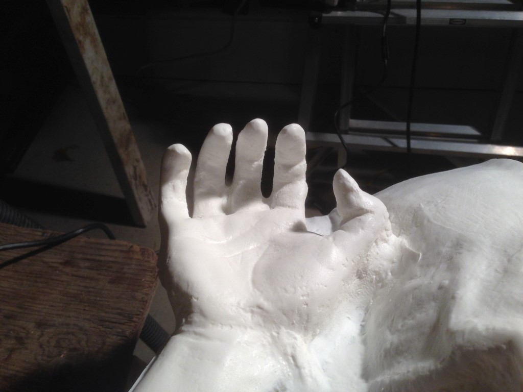

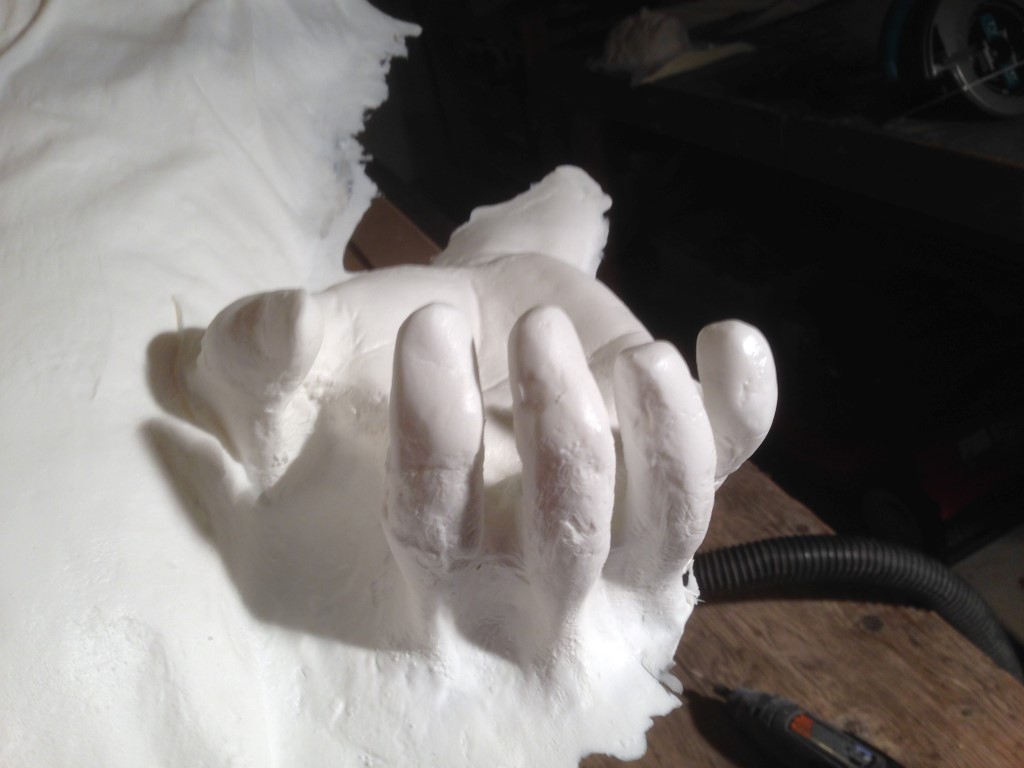

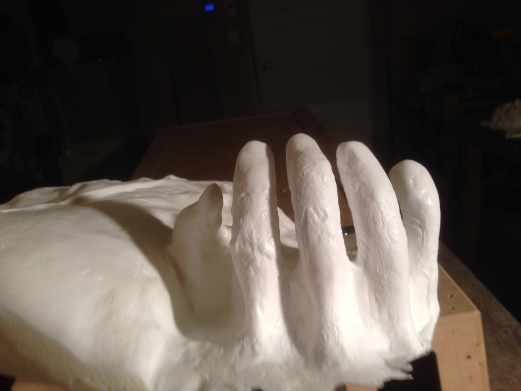

Han Cast
Work had started on the Kingjawa cast to make it cleaner. Mostly around the fingers where there was a lot of extra material.
Before
After the dremeling .. much better now!

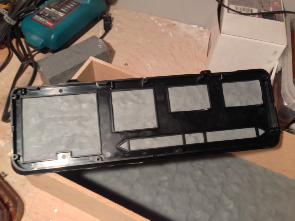

Volvo panels

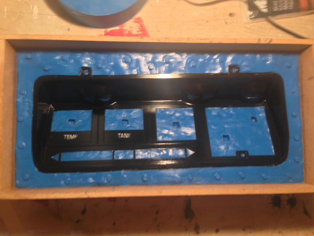

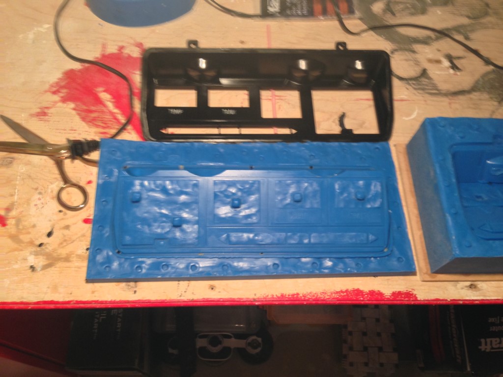

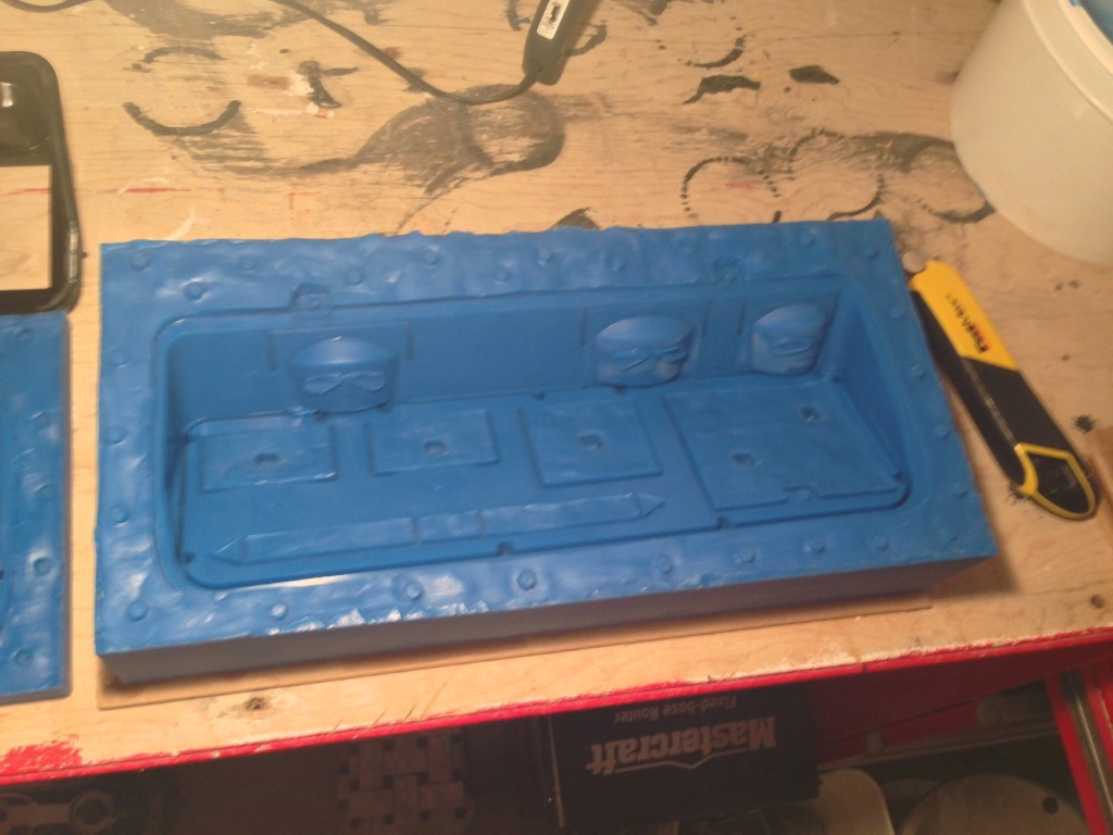

For those not on the RPF, I made a mold and cast my own panels and offered them. Here's some pics of the process

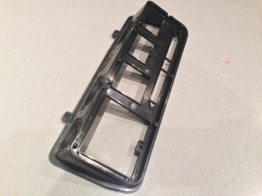

Original panel

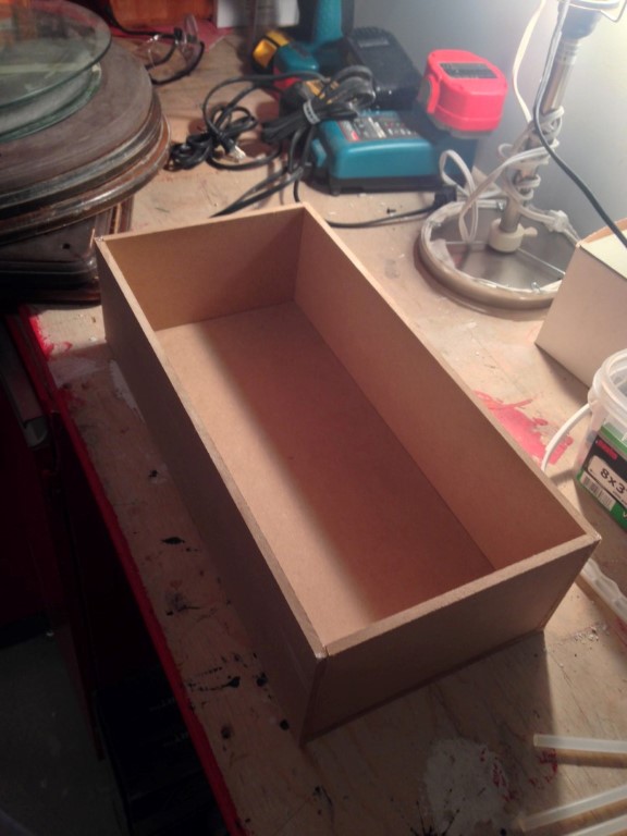

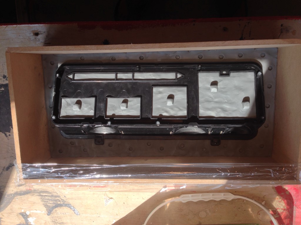

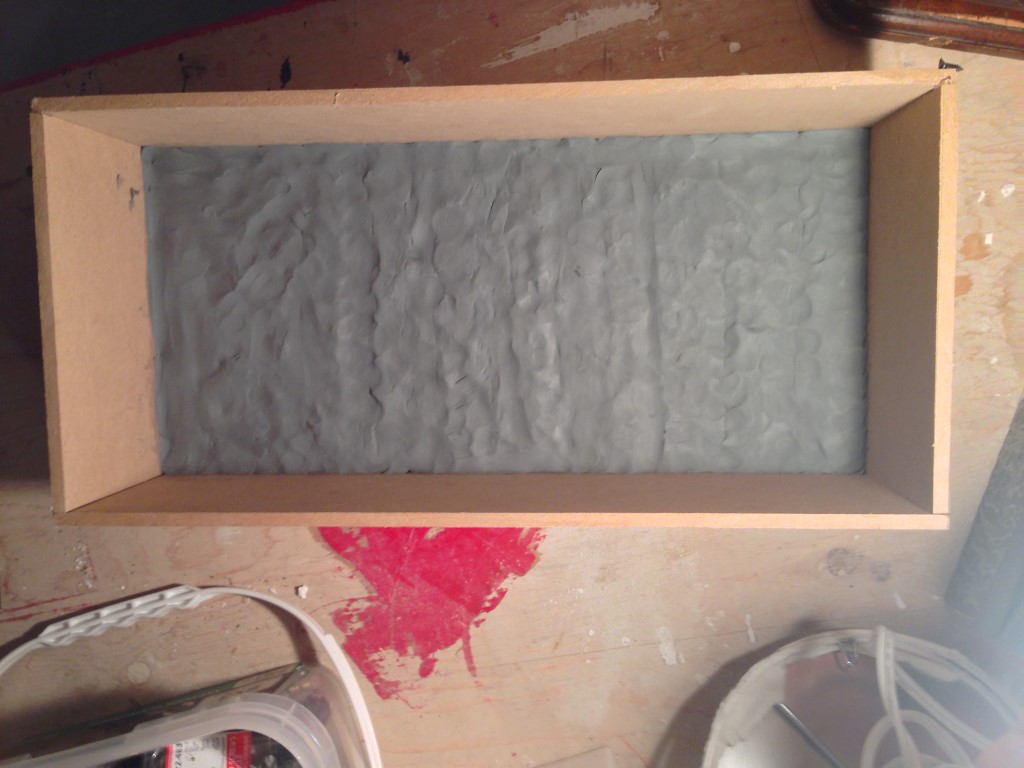

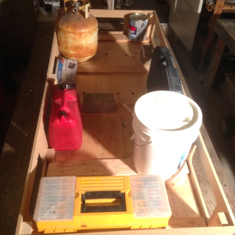

Box construction (To this day, I've done 7 of those molds .. and will probably do a 8th soon!)
IMG_0377 (2).JPG IMG_0383 (2).JPG IMG_0380.JPG IMG_0384 (2).JPG IMG_0385 (2).JPG IMG_0387 (2).JPG IMG_0393 (2).JPG IMG_0399 (2).JPG IMG_0400 (2).JPG

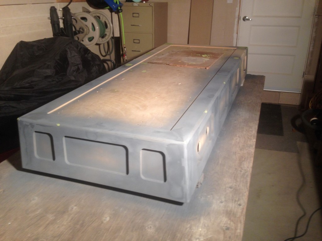

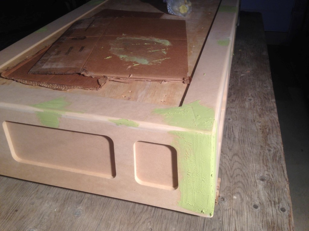

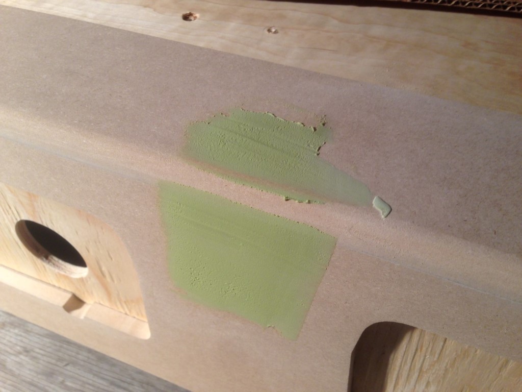

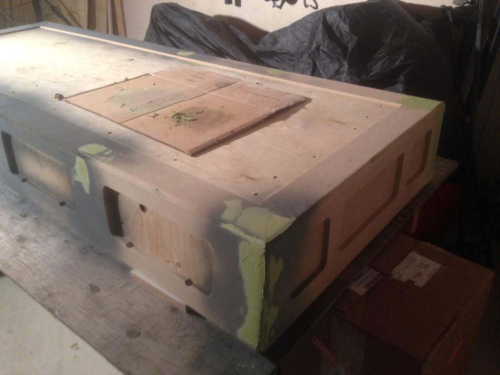

Prepping the box ..
primer, 400 grit sanding, bondo, sanding, primer, bondo ...
First pass was done with wood filler but I really didn't like it ...
IMG_2392.JPG IMG_2393.JPG IMG_2395.JPG IMG_2396.JPG IMG_2397.JPG IMG_2398.JPG
Second pass was with good old evercoat filler .. smooth as butter!!
Looking good. I am ready to paint mine once the weather gets warmer. It was 60 degrees in December, finally found all the paint colors and the temperature dropped. Spring cannot come fast enough.
