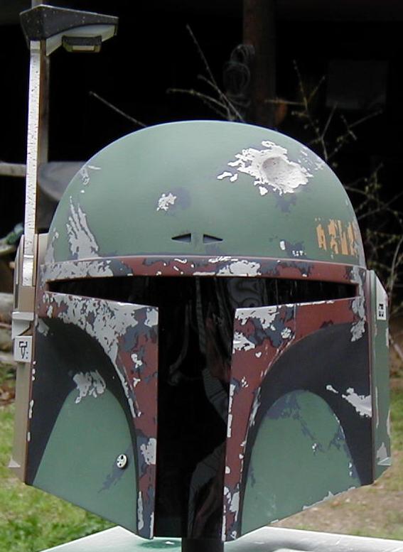

well ill get strait to the point on this one. this is the MR helmet i recently bought. honestly the pinch is not that bad imo but im a stickler for stuff to atleast lookright to a cirtain point so i figured ide fix the damn pinch. the paintjob on this thing is amazing and there is no way i was going to cut the helmet to fix it so i asked what to do on the another board forum and i was told that the cut is completely unnecessary. Thanks for the help Lee. what i was told was to use a heat gun to heat the helmet up and make it flexible. had to do this VERY SLOWLY as to not ruin the paintjob. removing all but the top two screws on the virticle parts of both mandables (this keeps the mandables level like on the ESB filming helmet) and repositioning the existing visor (didnt want my nose to be pushing against a new thicker visor) so that the verry bottom screw holes were on the very edge of becoming visible then glueing the visor in place, i was able to do this.
the top & the bottom are now only 4mm in difference. this is not easily visible. i also removed alot of the green on the borden conecter to bring out the silver on it, also took some rust off the RF
what ya guys think?

Agreed well done, I have always though it un-necessary to cut up the MR helmet when it is a copy of a PP helmet, glad to see another person taking the initiative (y)
honestly its not that bad as people were making it out to be IMO. it is off by 10mm or so but this is a very simple fix that saves the helmet interior (which is very nice) aswell as the paint job. for the best pics of the pinch, look for the reparing the MR helmet thread by tk7602.
Dana
That does look really good. If I had wanted to preserve the paint on mine, that would have been a great way to do it. I was planning to strip it no matter what, so doing the cut and shift was actually sort of fun ;)

hey guys this is what ive been sending for instructions to people who wanted alittle more detail than my first post..
the heat gun ,(or hair dryer they both work) just point it directly in the helmet from a foot or two away. dont get it too warm though. and keep away from the visor!!! the padding only needs to be pulled back enough for you to get at the vertical screws, between a half inch to an inch. for the screws remove all VERTICLE mandable screws save for the two at the top corners of each mandable. leave the rest alown aswell. screws taken out you can put aside in a safe place but you wont need them as there holes are now off set. now for the visor. you are going to position the two bottom most holes on the verry edge of being visible and glue into place. i used CA glue. its a model superglue. use as little as you can, only enough to hold the visor to the proper spot on the mandables, so it doesnt damage the visor. if you want you could probobly drill new holes in the fiberglass for some of the screws instead of gluing it. I only used glue because i could not find the right size drill bit. on a side note you may not have to heat it up if you dont want to. by the time i was done removing screws the helmet had probobly returned close to normal temperature.
hope that helps and good luck. post those fixes!!! (y)
also alot credit goes to Lee and the guys from the another board for reccommending the heatgun method (y)
