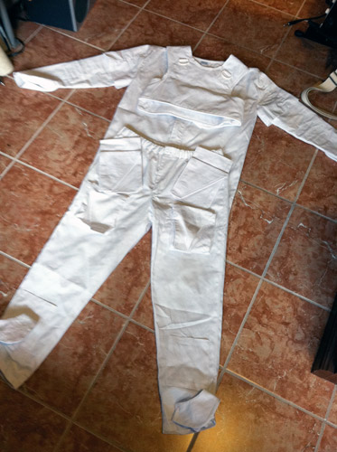

So I bought this beautiful flightsuit and jetpack harness from Man Of War. 100% cotton. When I got it, it was snow white.

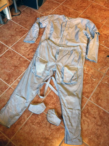

I threw in the flightsuit and stirred constantly for about 10 minutes. Then I hung everything to dry overnight.
When it dried, I ended up with this:

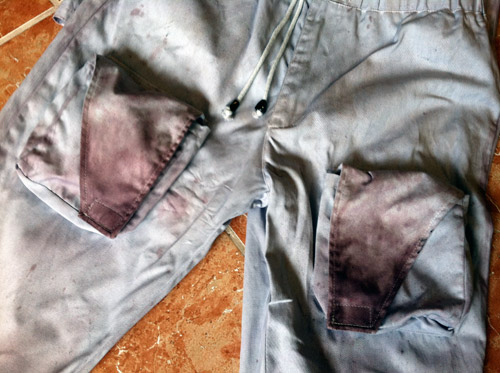

The final result is this:
And here it is with the white jetpack harness. You can see the contrast.

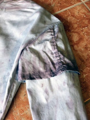

Here are some close-ups:
