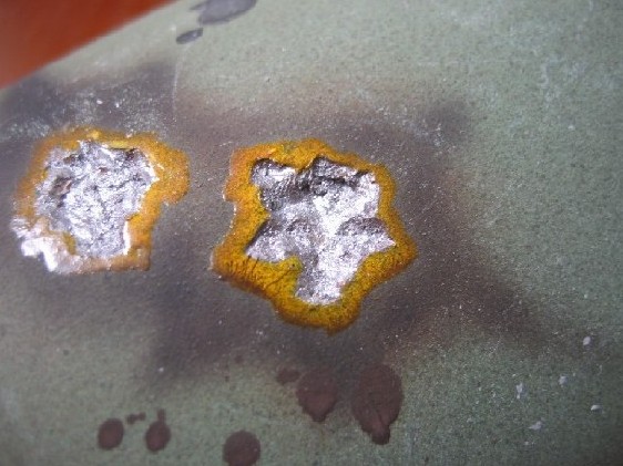

It looks like your using sintra so here are a few pictures of some armor I did up 2 years ago for my GF. I heated the area up that was to be damaged from BEHIND the piece using a heat gun. When the sintra was maluable I quickly went to work on the area with a chisle and carved in the battle damage. Carefull not to get to crazy and poke a hole through then you'll have to make a quick bondo repair.
After your done your damage paint the dented areas silver, mask them with liquid latex or mustard and paint your other colors. When your done painting rub of the masking and you've got your perfect damage.
