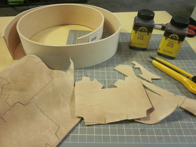

Hey guys, I'm getting started on one of my first major Fett upgrades and it's the ammo belt! This one will be replacing my vinyl belt, which has served me very well so far but is due for an upgrade. I'll keep track of my progress here. This belt will be in the same style as the wood block vinyl one I currently wear and will be non-functional.
Got the wood blocks cut today which means I had something to mold the pouch sides around. The sides will need to dry now before receiving the same dye treatment as the belt. When they've been dyed I'll glue them to the blocks with contact cement.

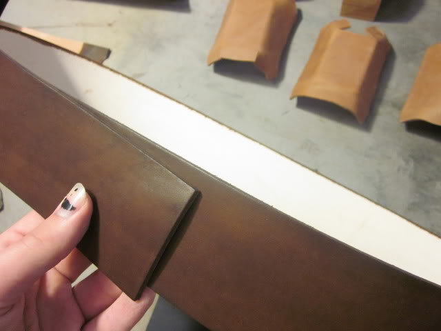

The belt is finished dying and just needs stitching and grommets. I used Fiebings oil dye in dark brown and light brown mixed at a 60/40 blend to achieve this color.

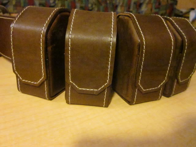

The outer flaps have been cut and dyed and I've dyed the inner pouch segments as well. This took many layers over a few weeks as the dyes would fade into the leather over time and lighten again. I like the shade I was finally able to achieve. The inner leather is about halfway glued on now. I'm using contact cement which is very effective but also very time consuming to complete.

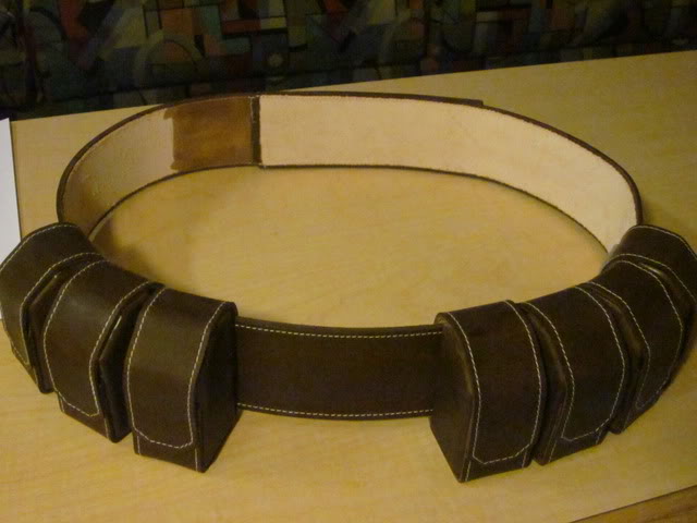

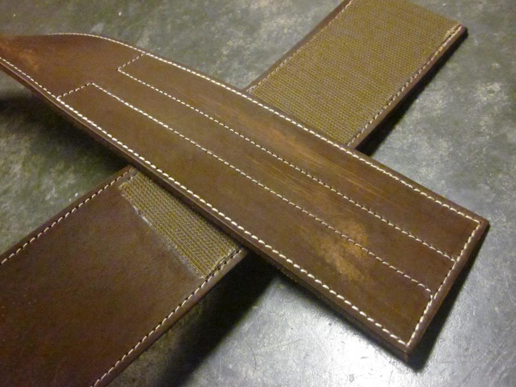

The belt is almost complete! Thanks to a lot of help from lonewolf my belt's stitching is looking amazing and I've got them all glued together, including the velcro closure. There is also velcro along the back to allow the hanging pouches to adhere. All that remains is the false snaps, two grommets in the back, and weathering.

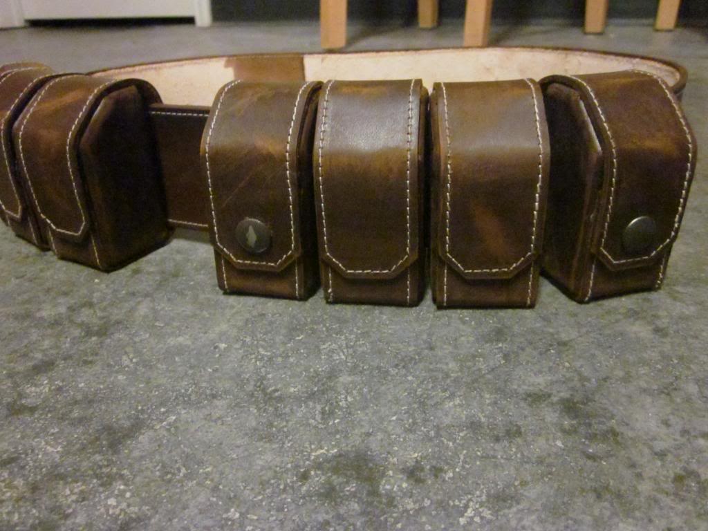

The belt is almost finished, guys. All the weathering here is done with a pumice scrubbing stone (sparingly) and 320 grit sandpaper. I seem to have misplaced my bag of grommets at the moment, but when I find them there are still two to install in the back of the belt. Sorry for the image size, Photobucket is transferring to a new beta and the resize/edit feature is down.
