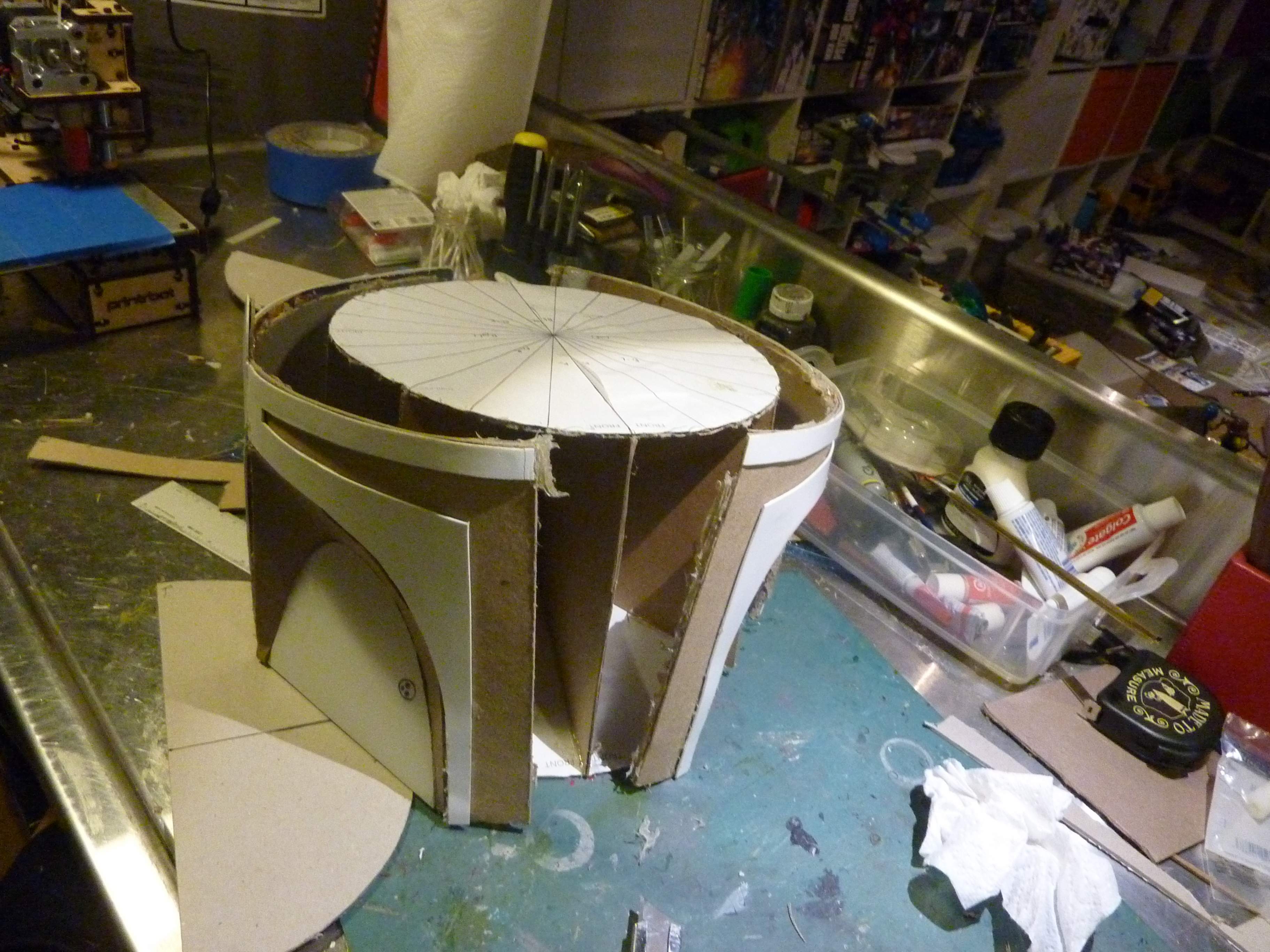

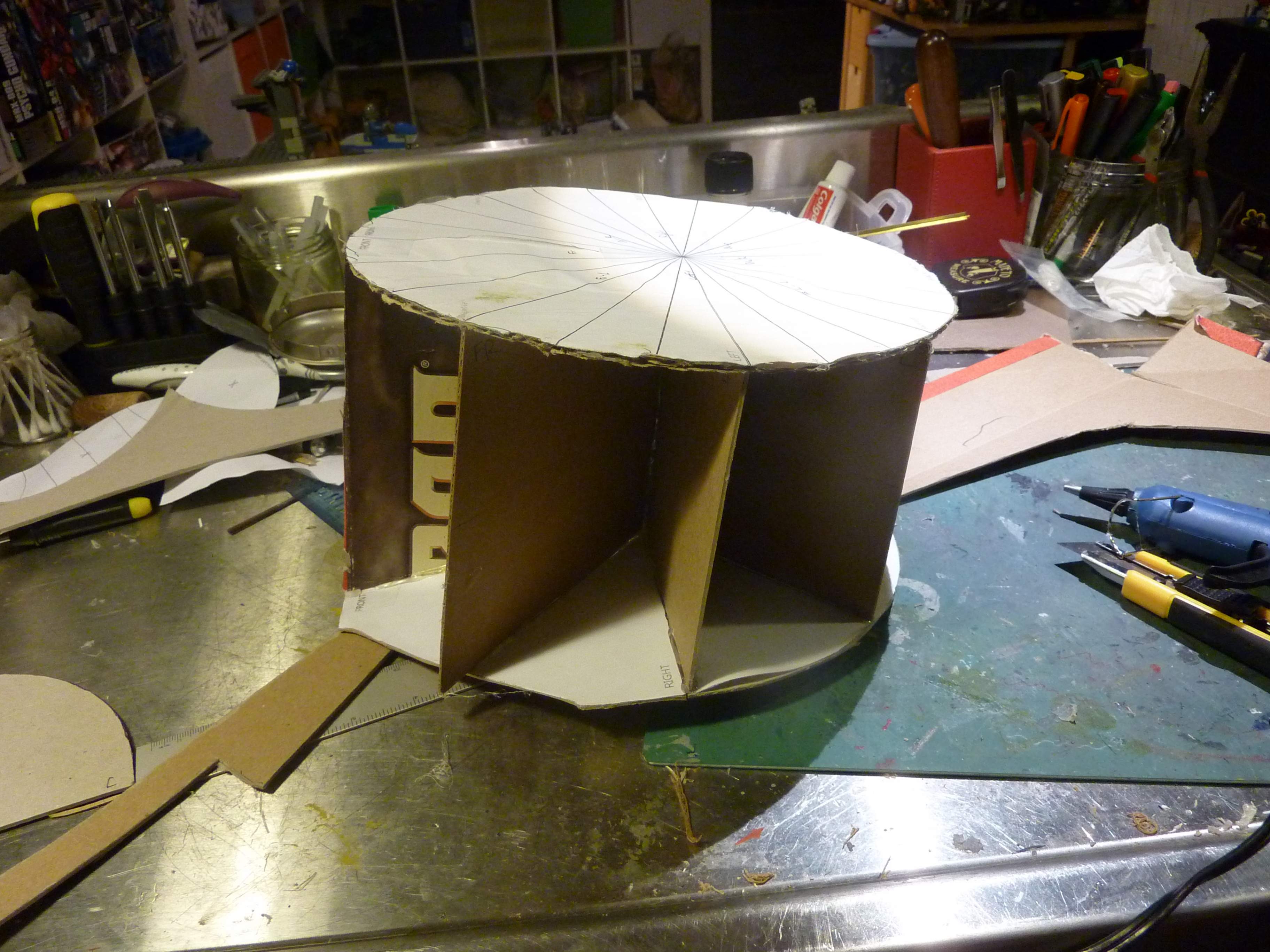

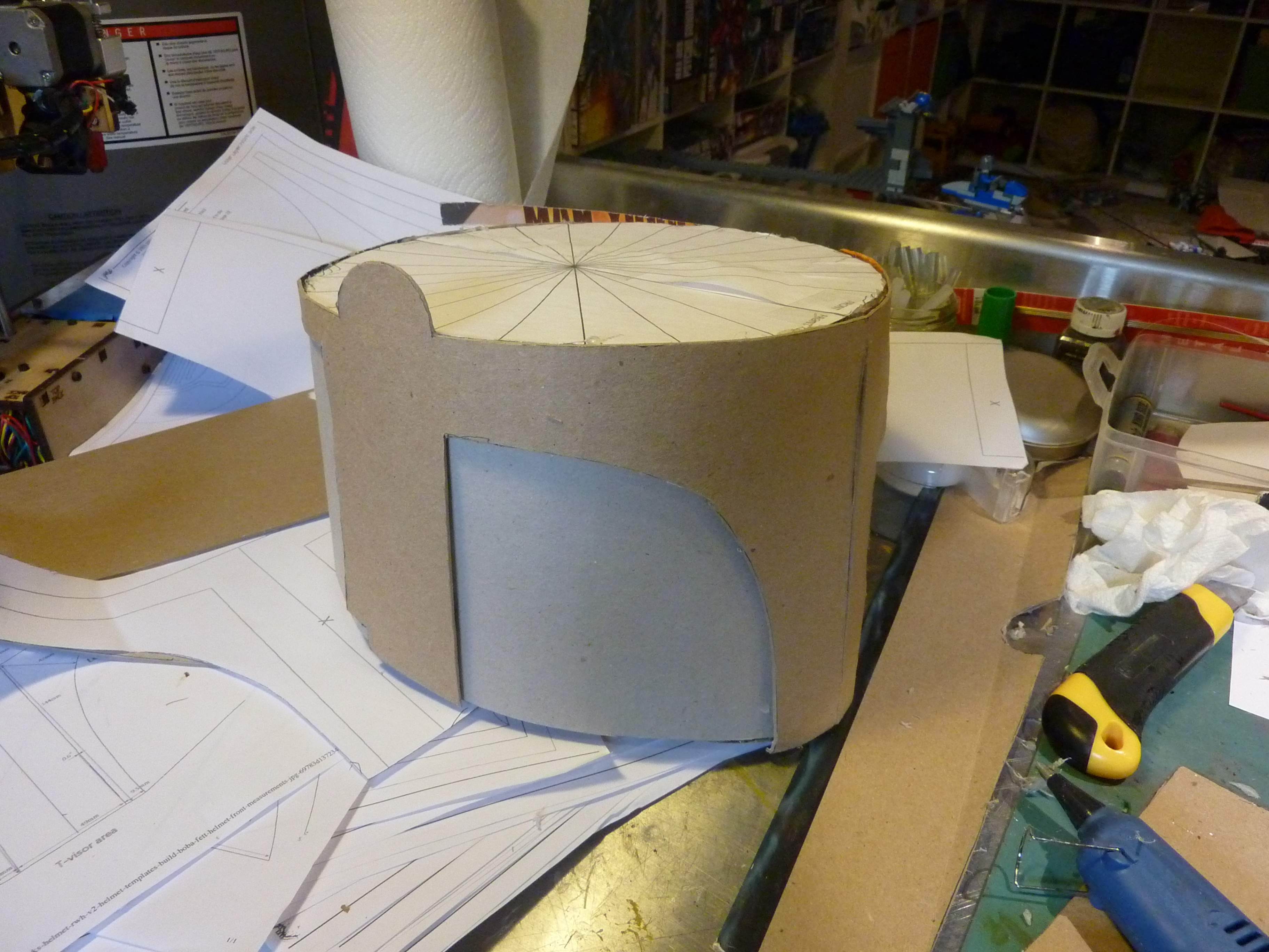

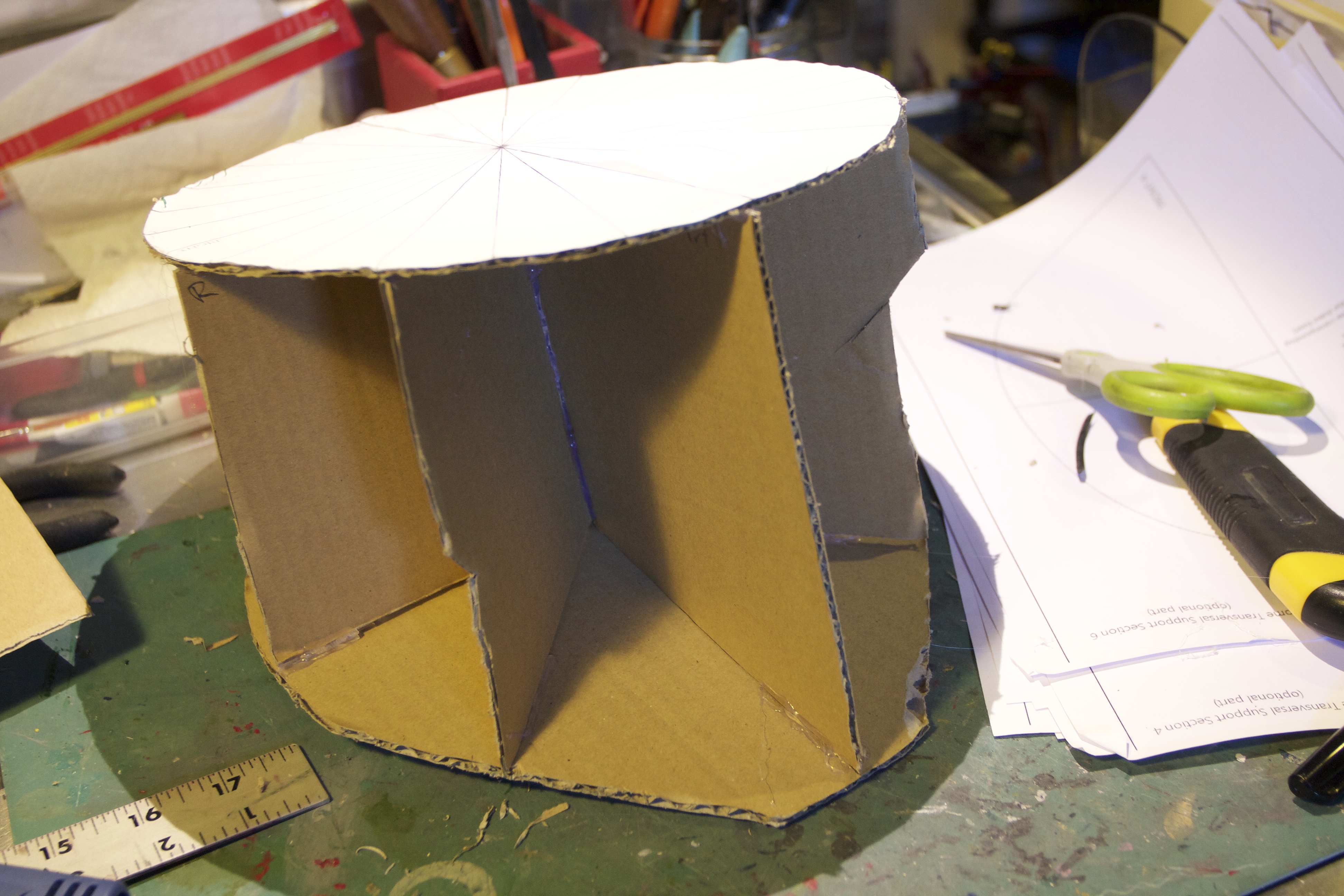

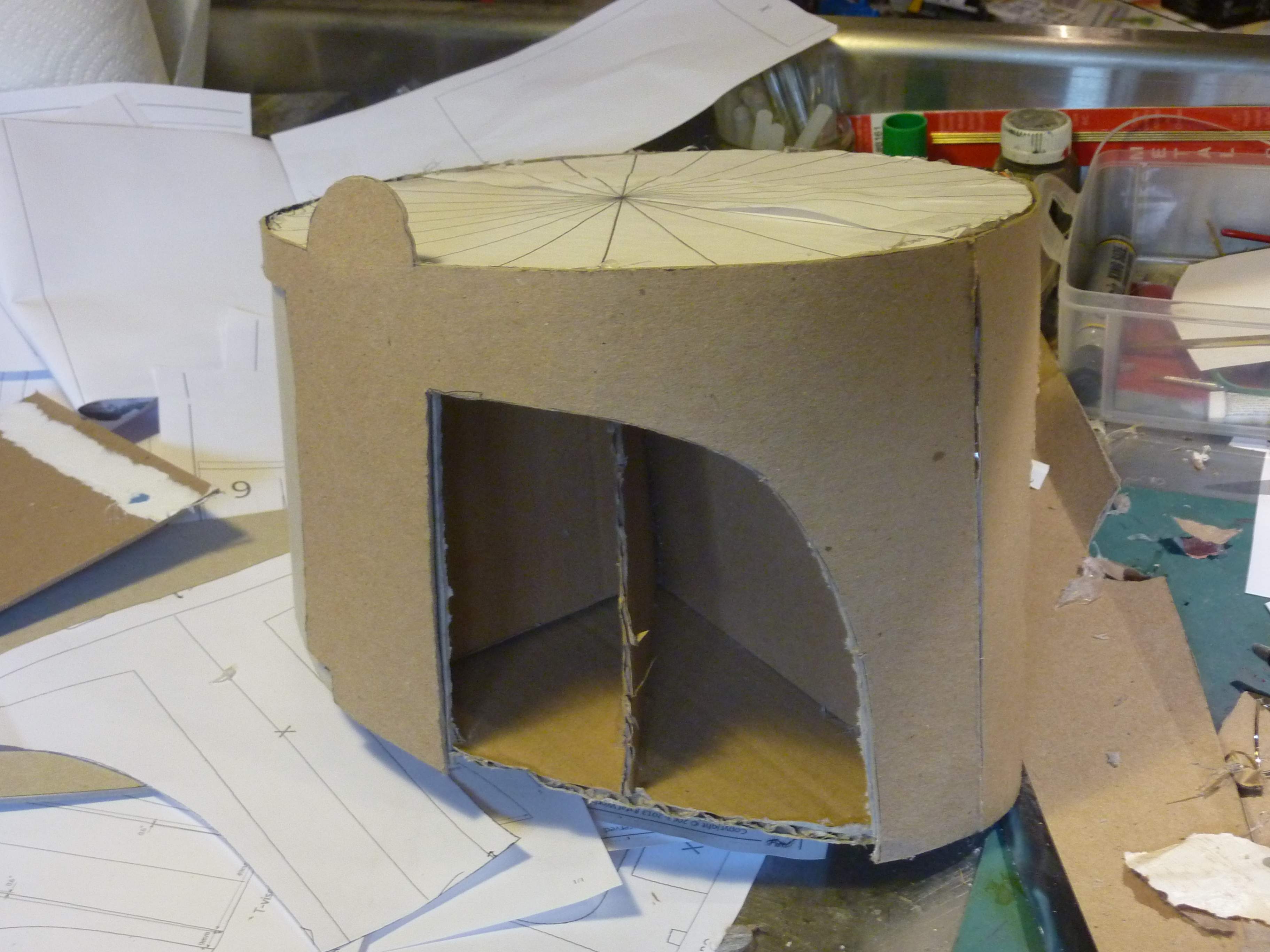

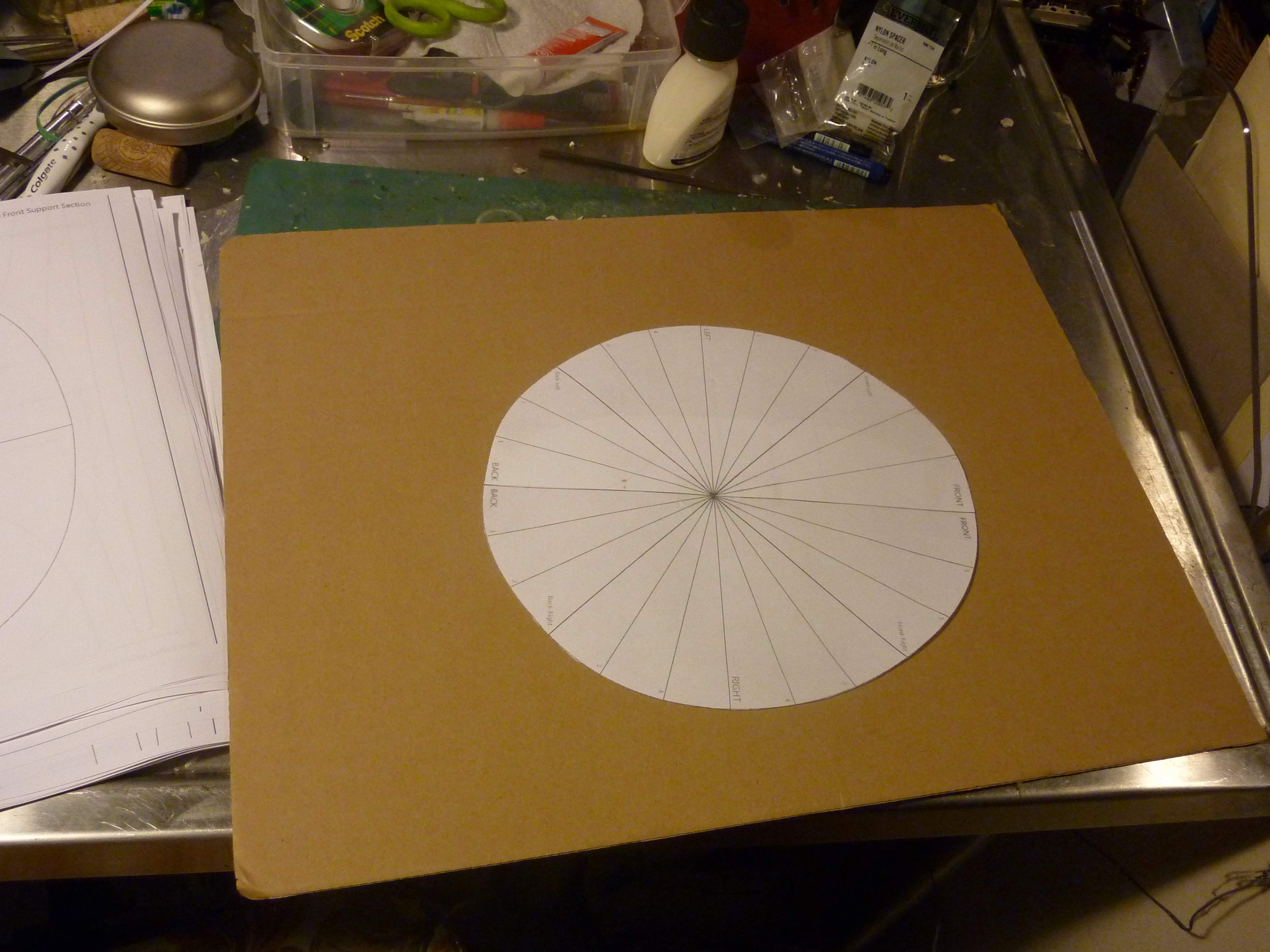

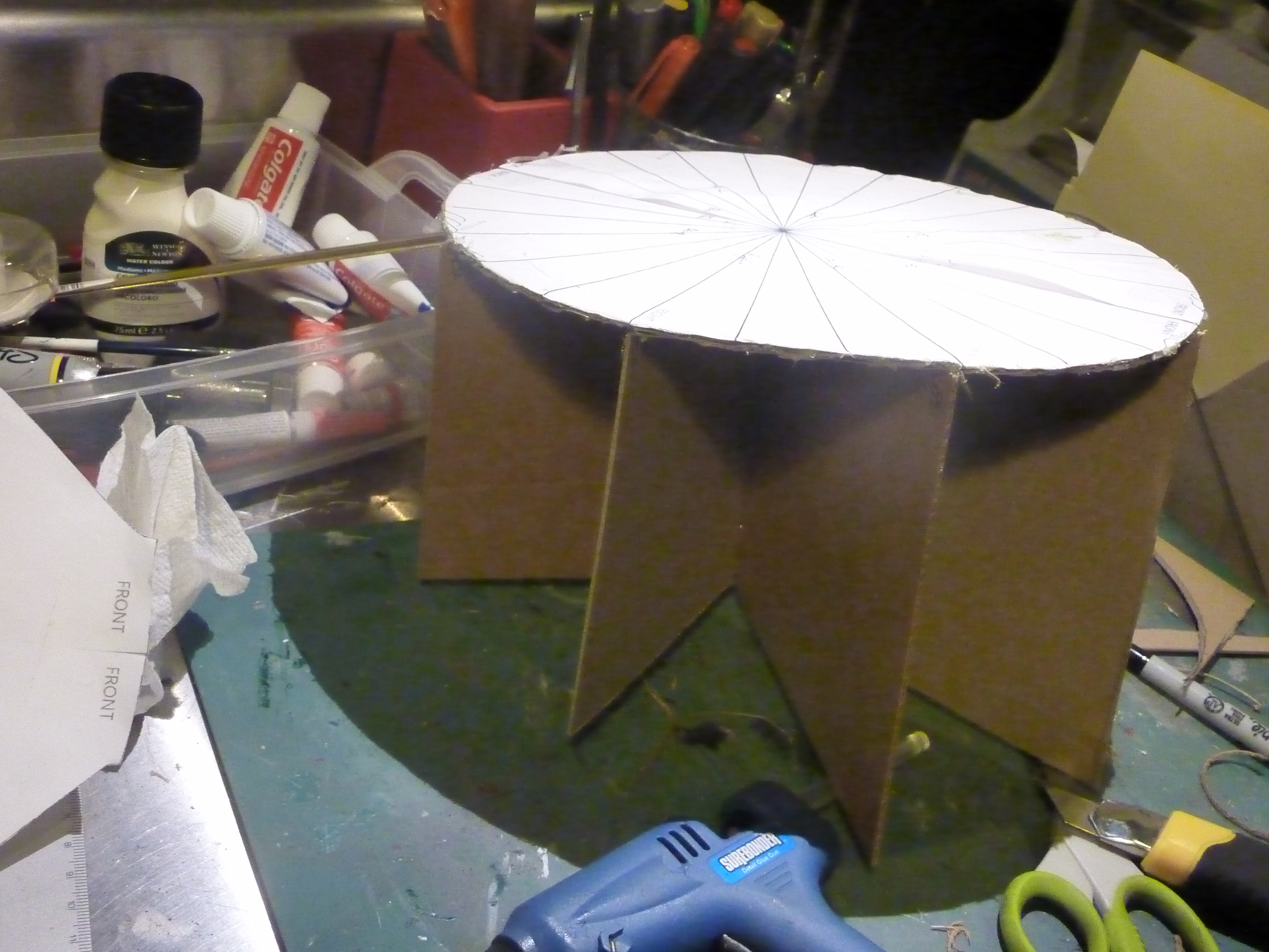

Inside support:

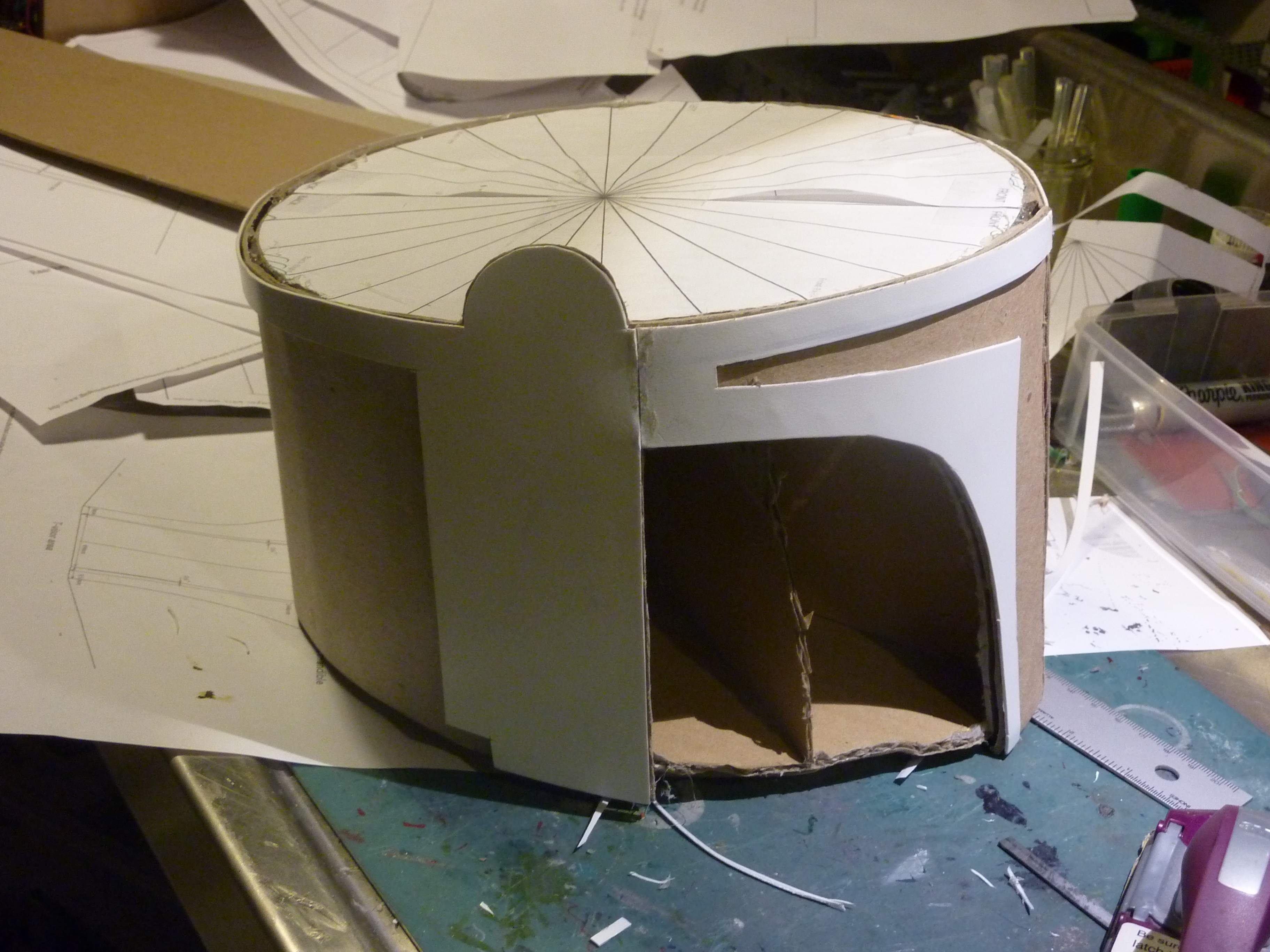

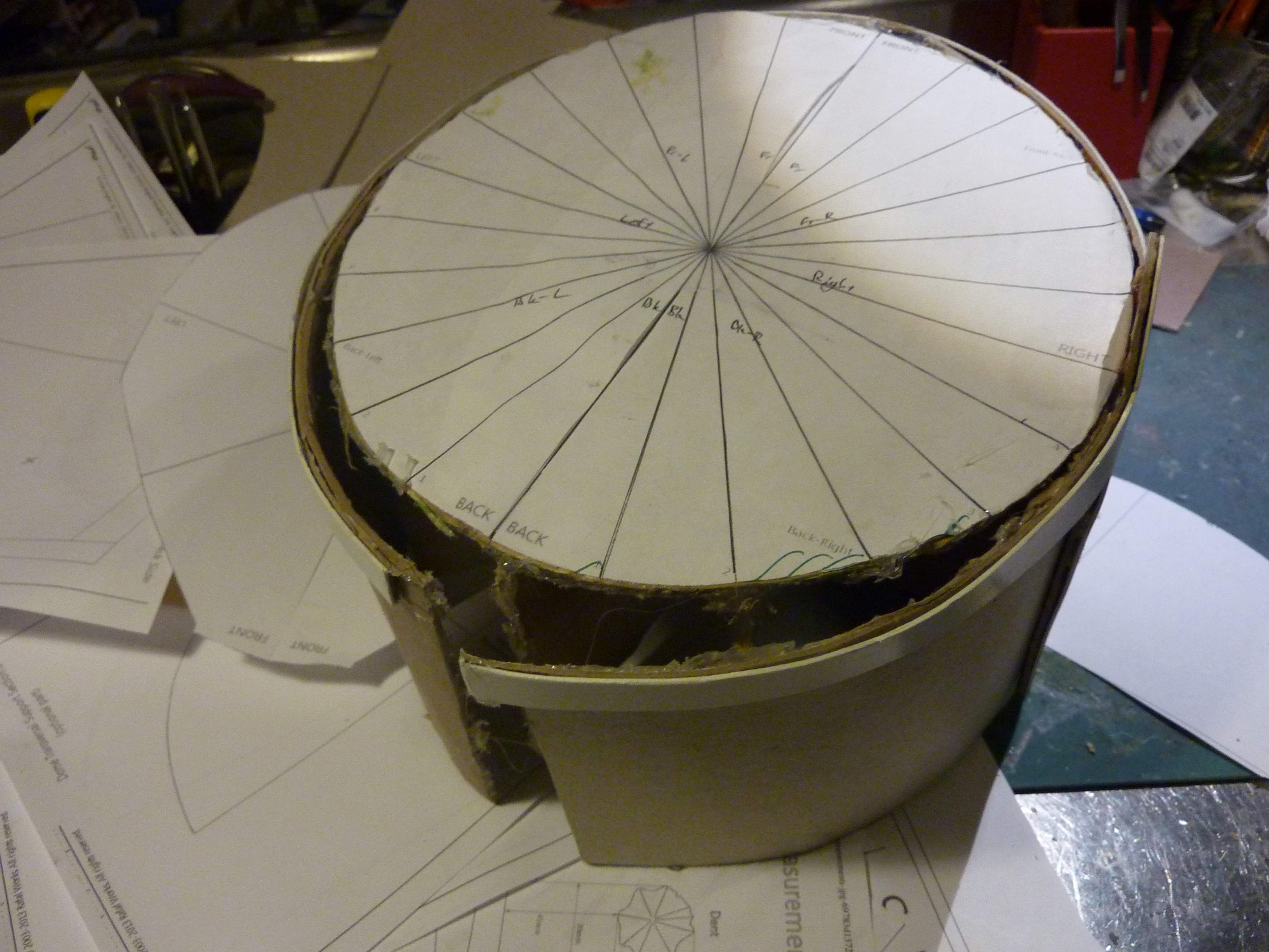

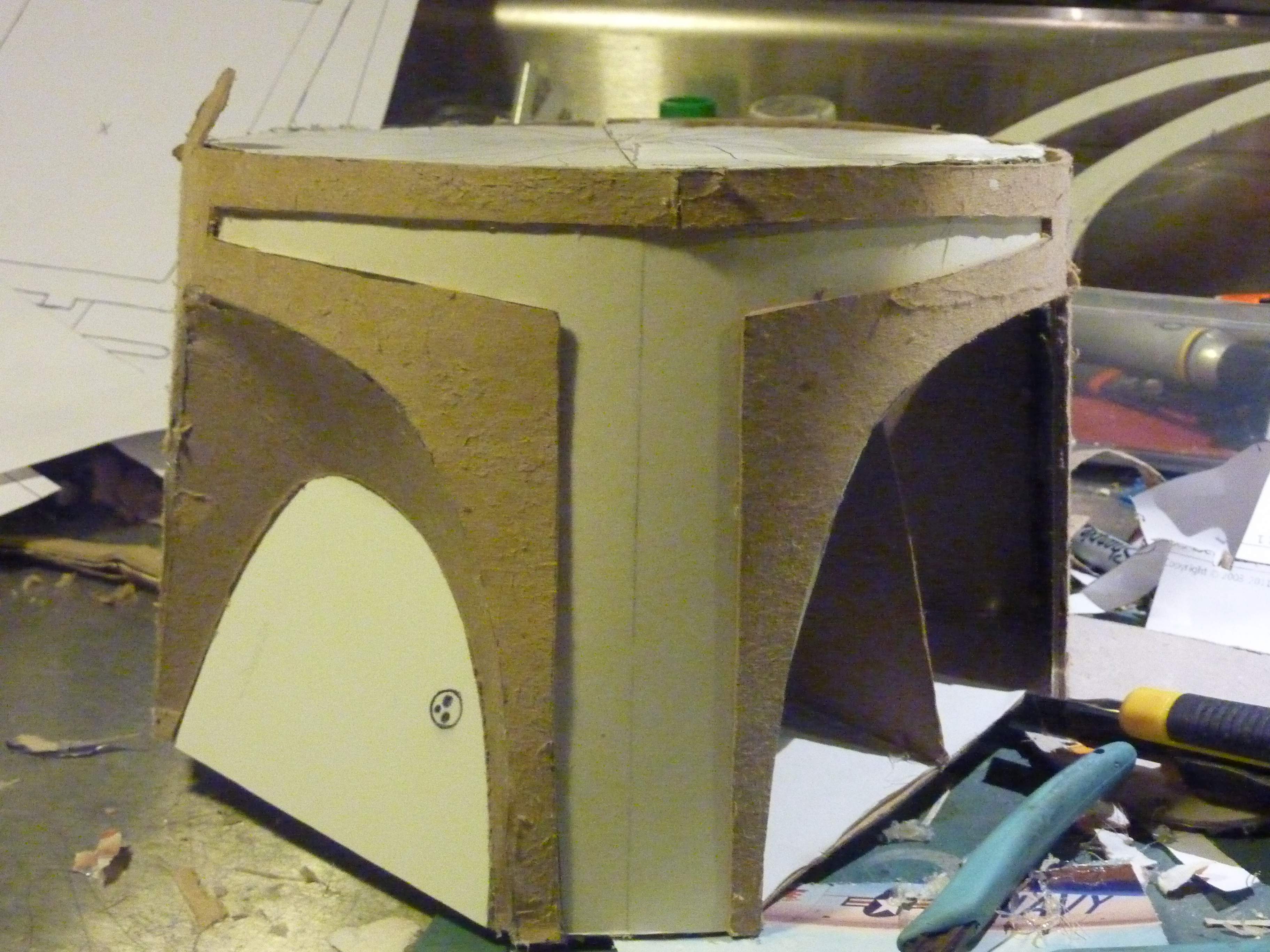

And proceeded to dress it up:

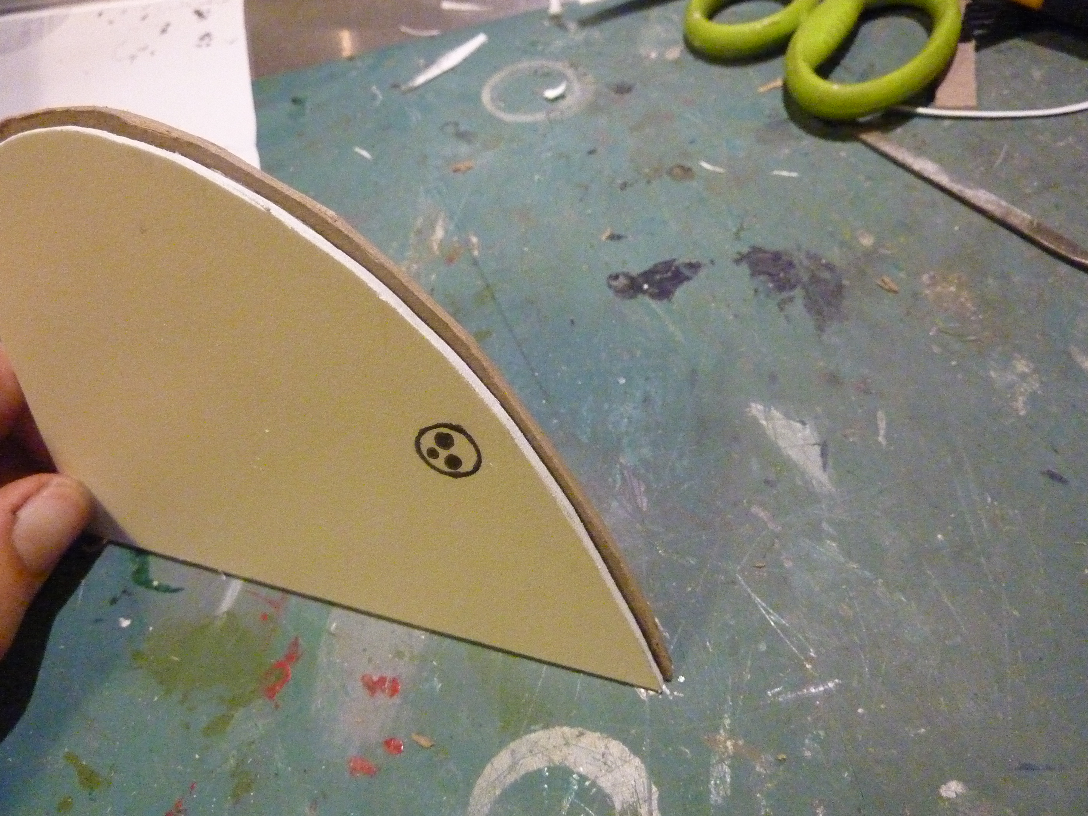

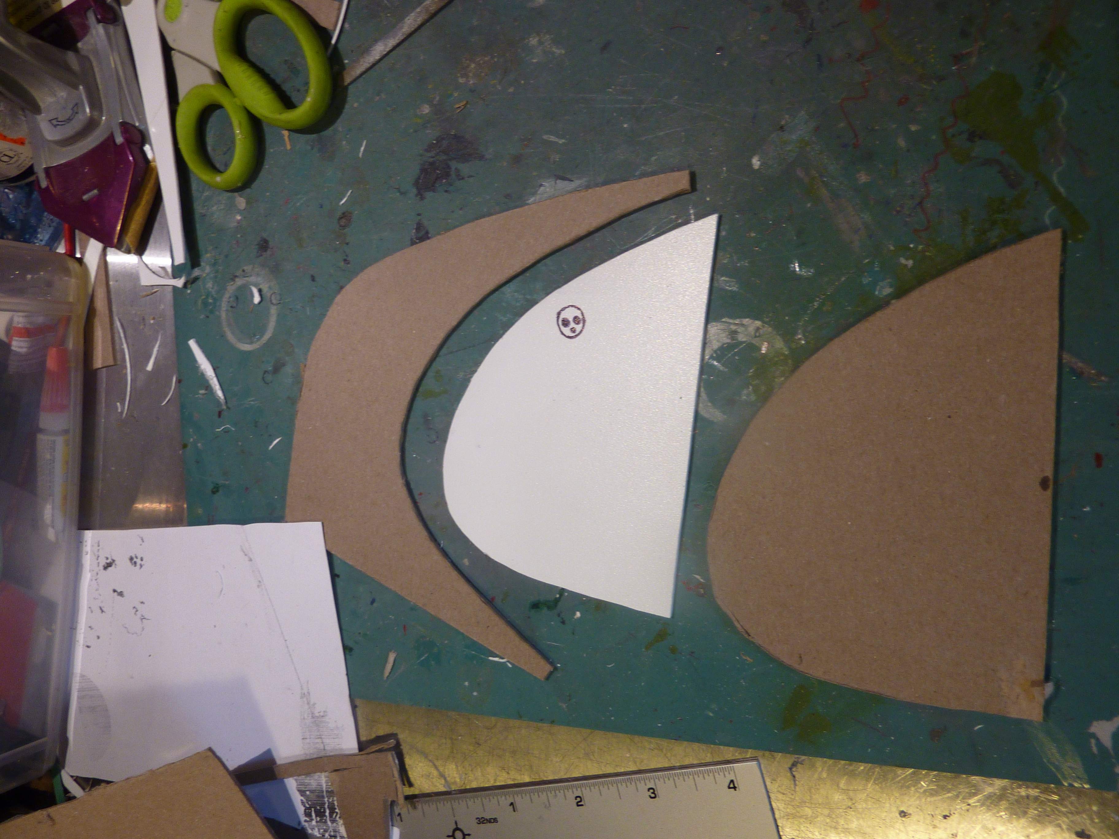

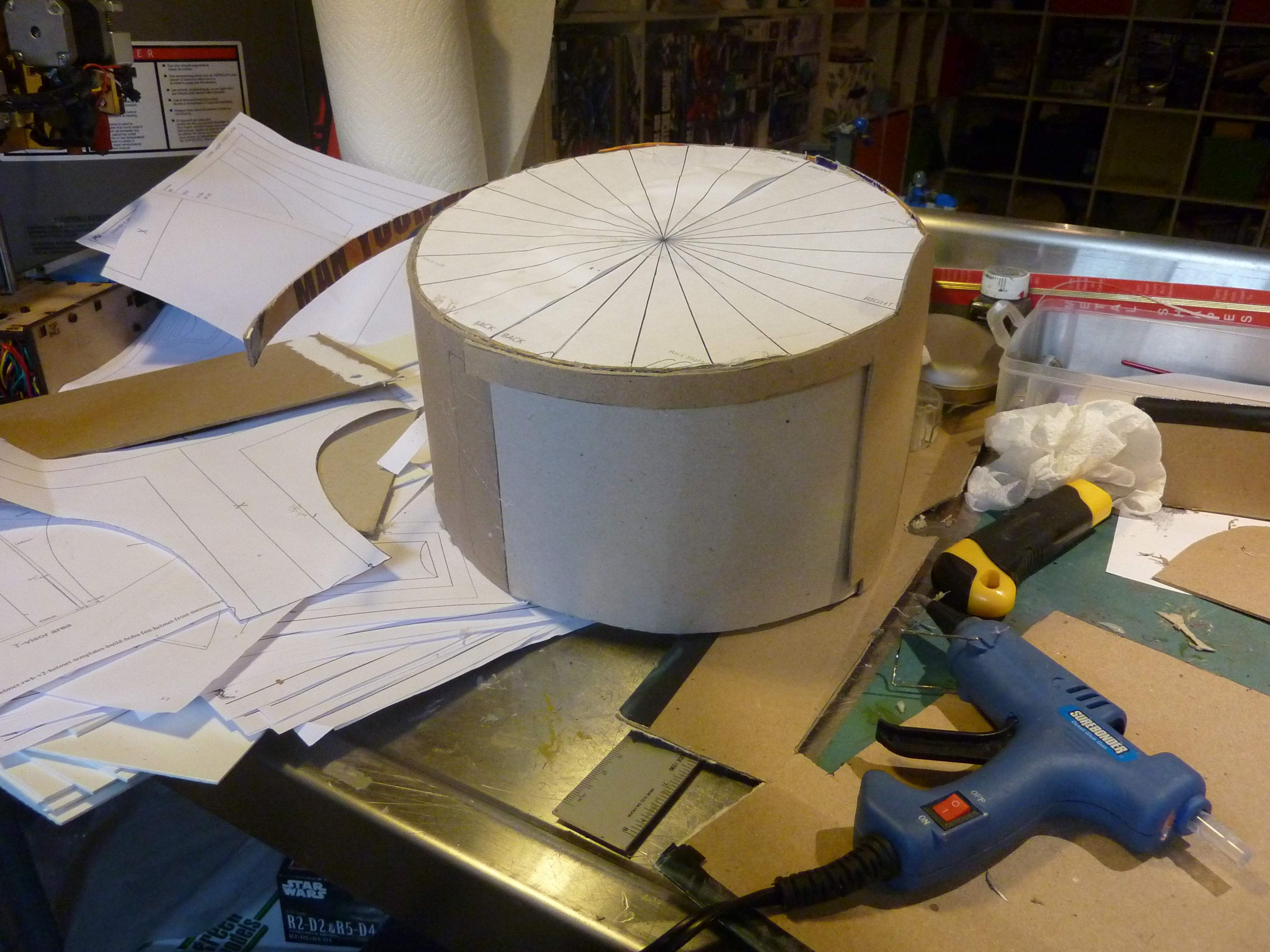

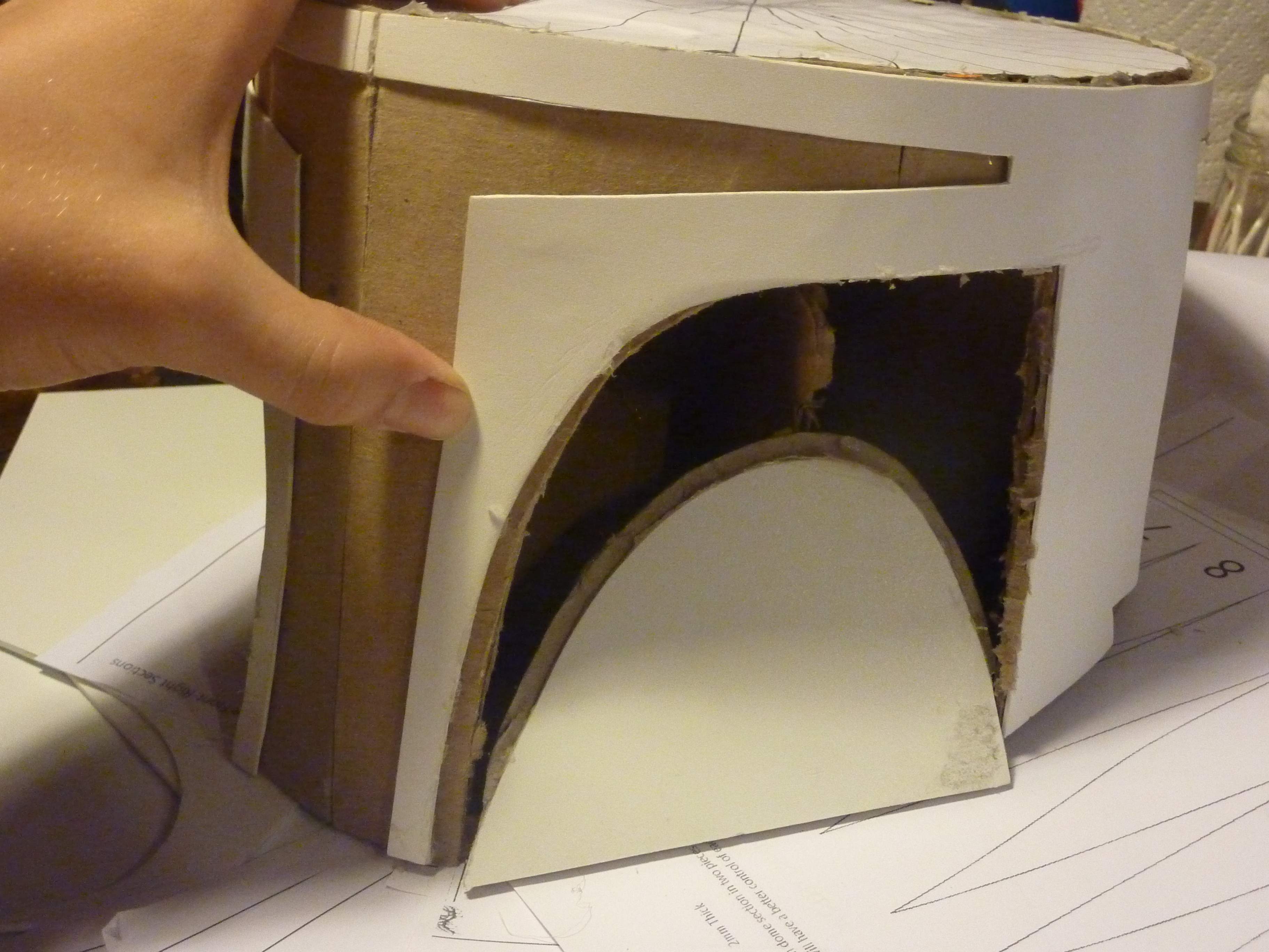

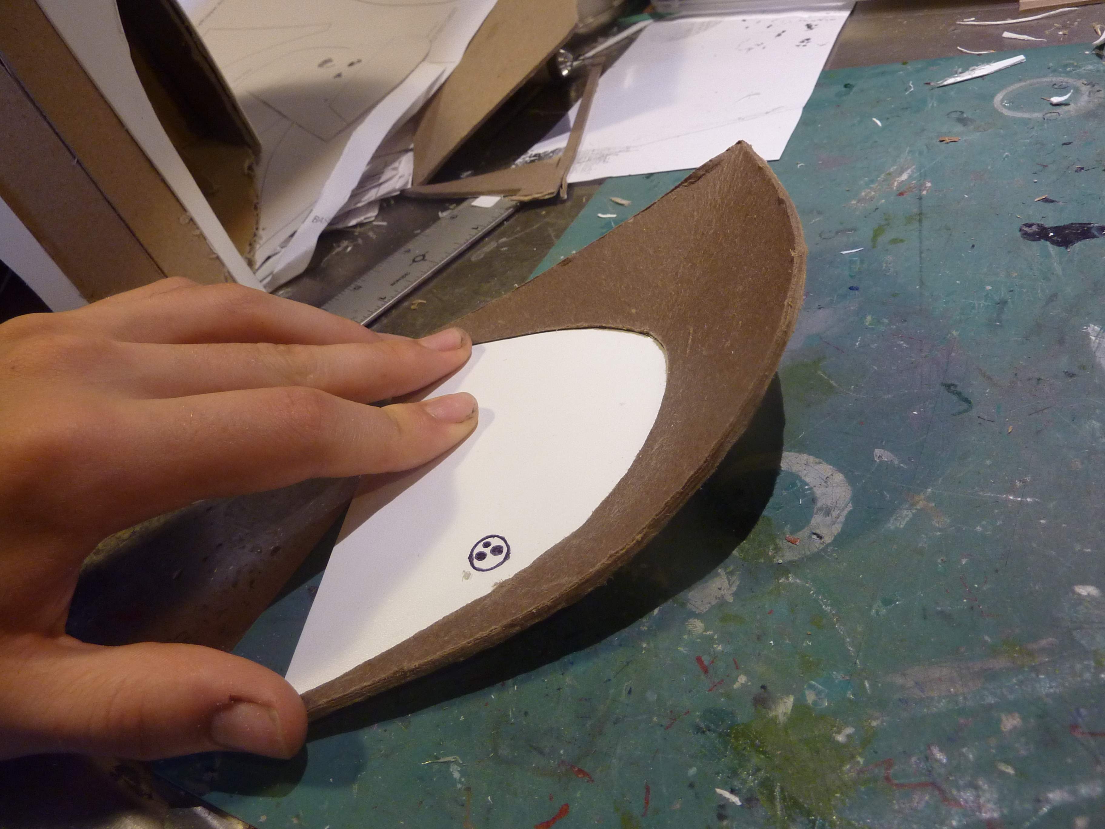

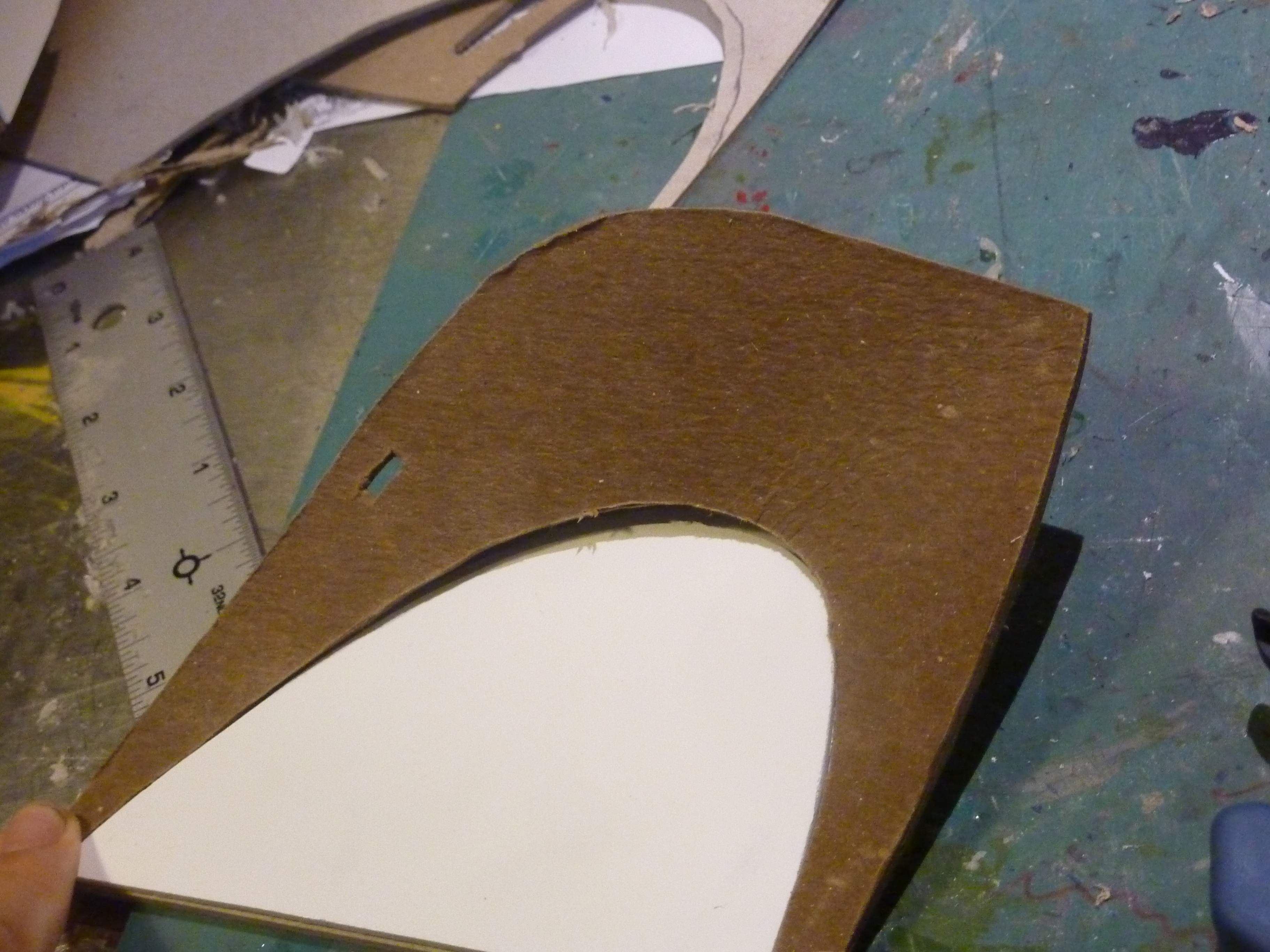

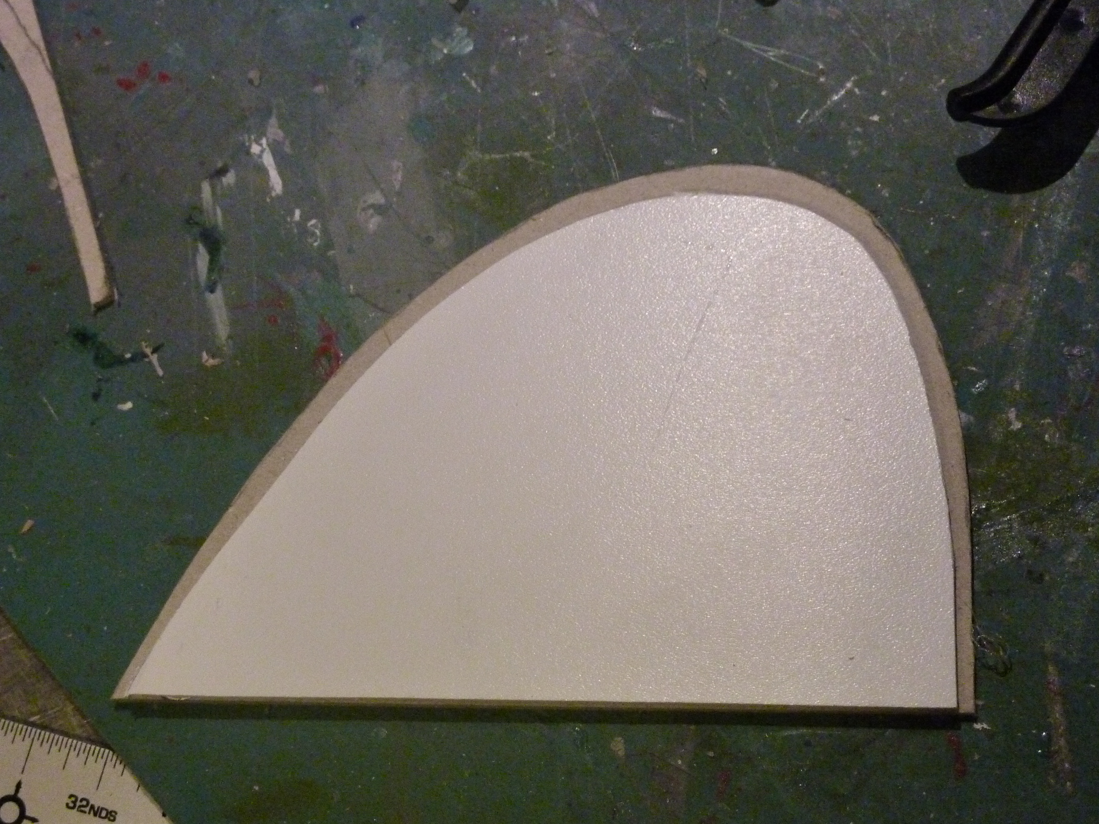

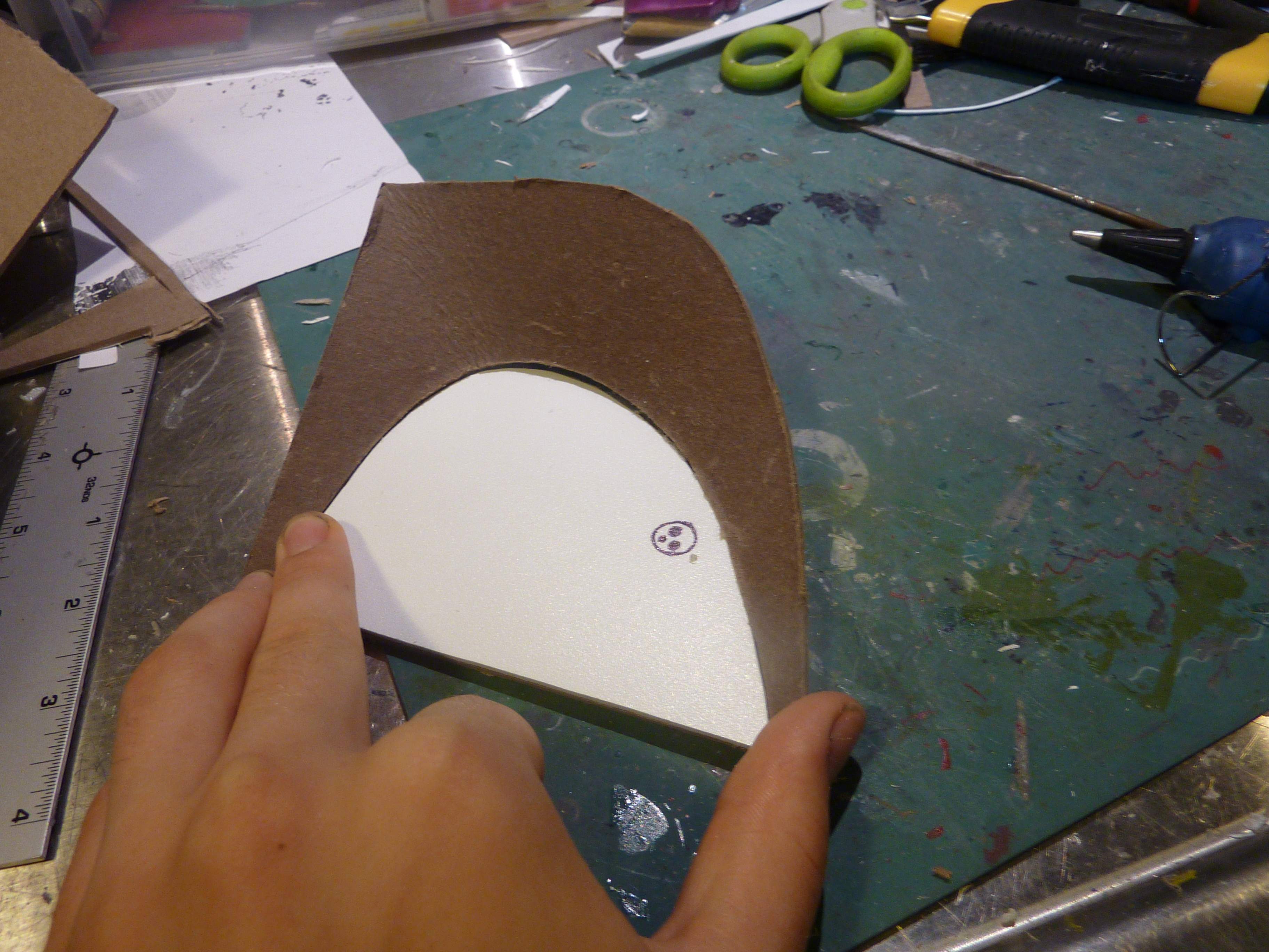

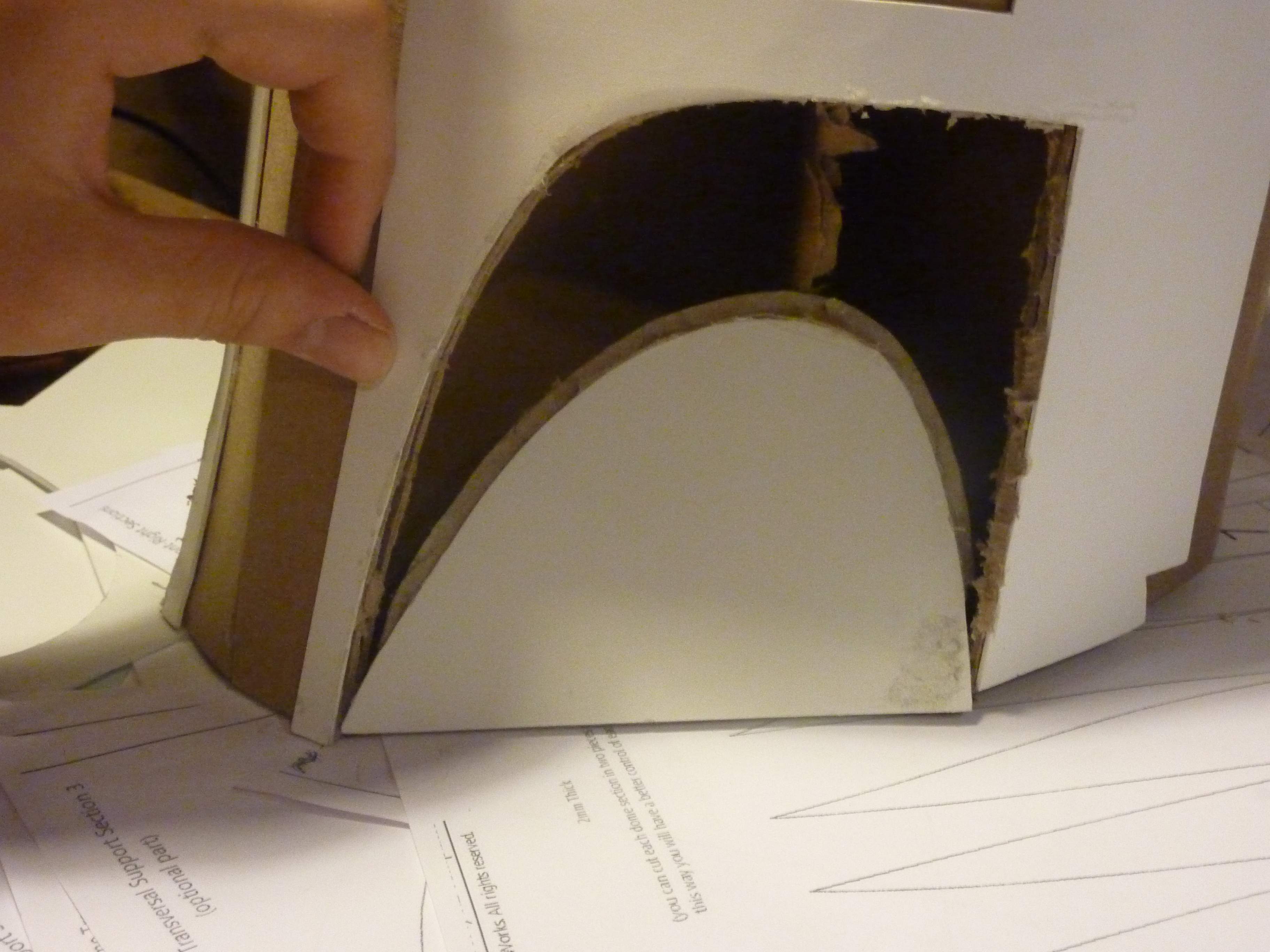

I cut out the area for the cheeks:
I decided to use some 1mm sintra for the outside because it sands unlike cardboard...but we'll see how that goes:unsure
Advice and criticism is very much appreciated.
RafalFett

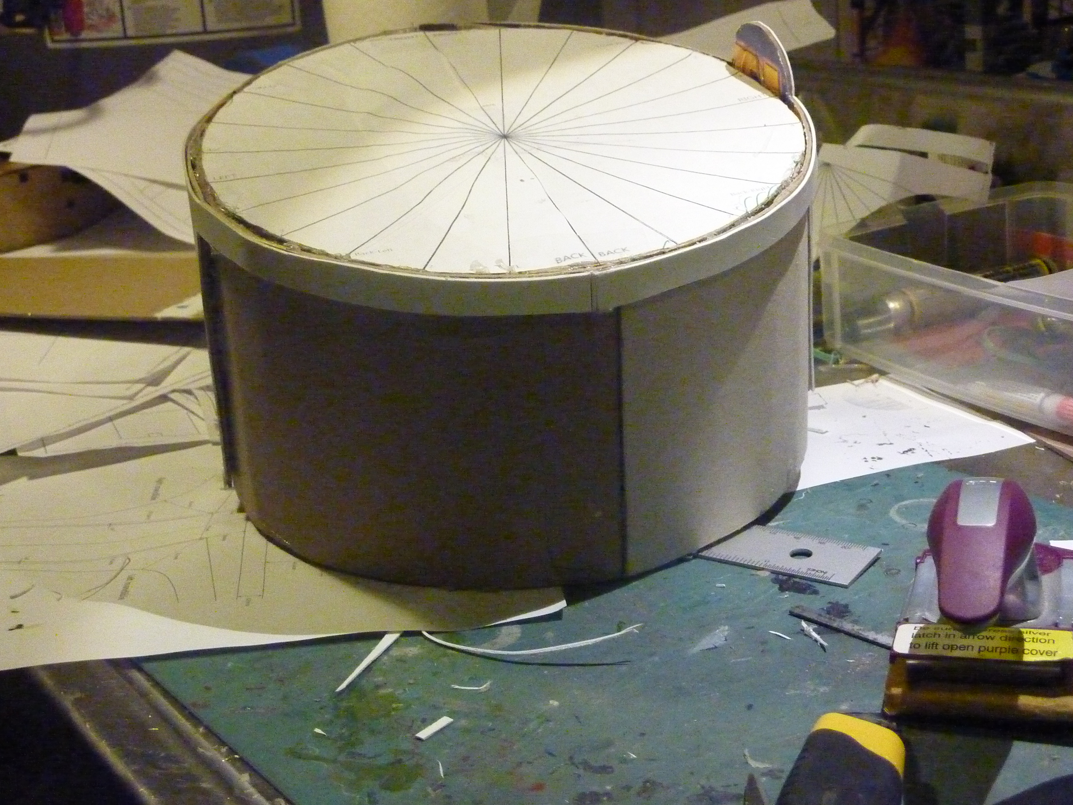

The first major issue in your build is that you used corrugated cardboard to do the inner parts. The second issue is with the outer layer which is aligned with the inner layer at the top and not at the bottom. If you align it to the bottom of the inner layer, the outer layer will have a 5mm recess which will allow the dome slices to sit comfortably between the outer layer and the dome support pieces.
Other than the issues noticed above, the build looks pretty good so far.
Artakha
Ok, thanks. However, what problems will the corrugated cardboard bring me? I thought it would be ok to use on the areas that will remain unfinished...:confused
I will have to (at this point) simply try to keep the dome parts aligned...I will have some updates on that by tonight (I hope).
RafalFett
The corrugated cardboard is too unstable to use it on builds that needs stiff parts. In this case the pieces you used might warp under pressure of pulling or stretching the layers, which might result in defectuous shapes. This is why I say that this type of cardboard is not the best for these builds, even if you will discard most of these pieces.

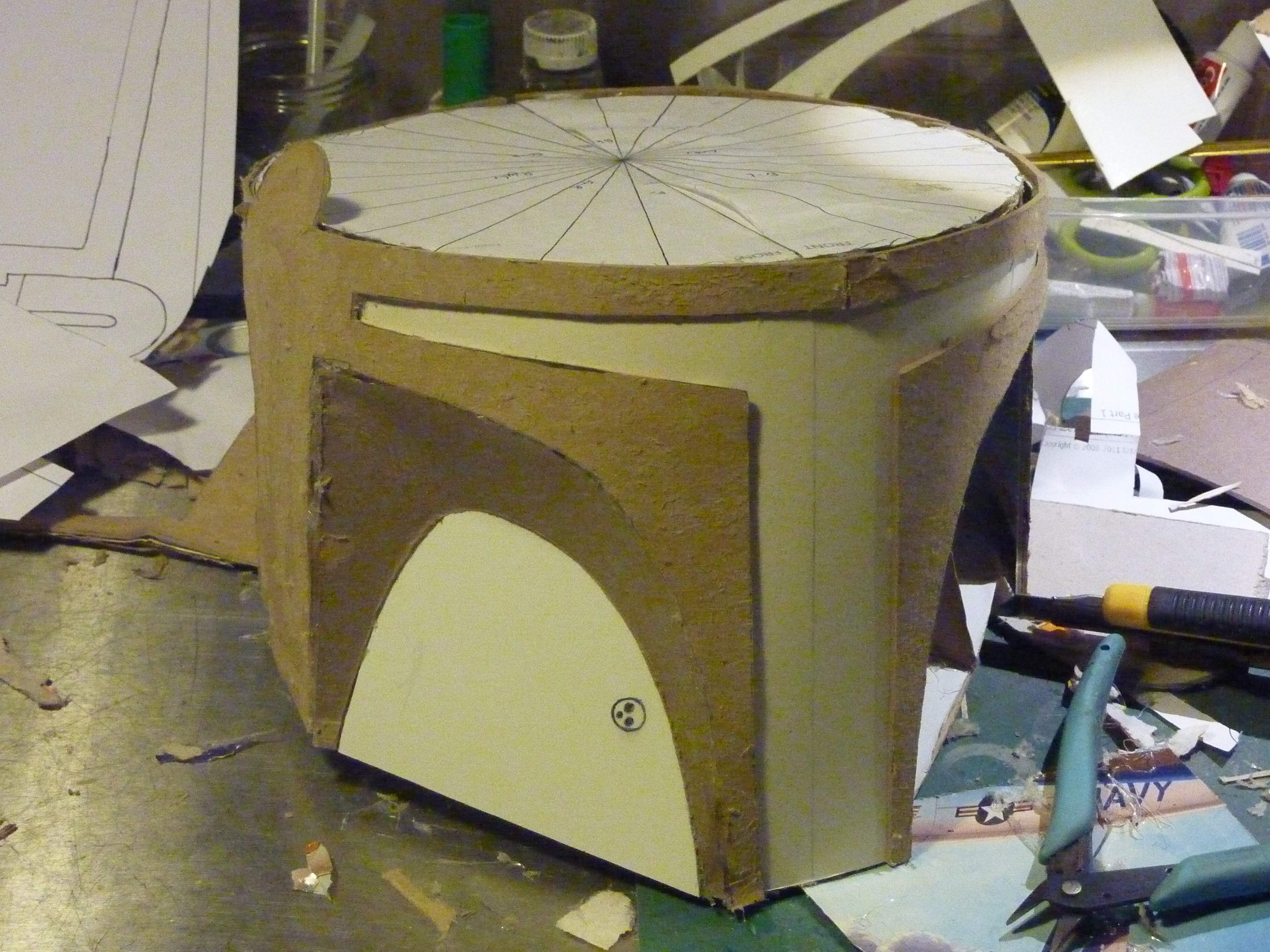

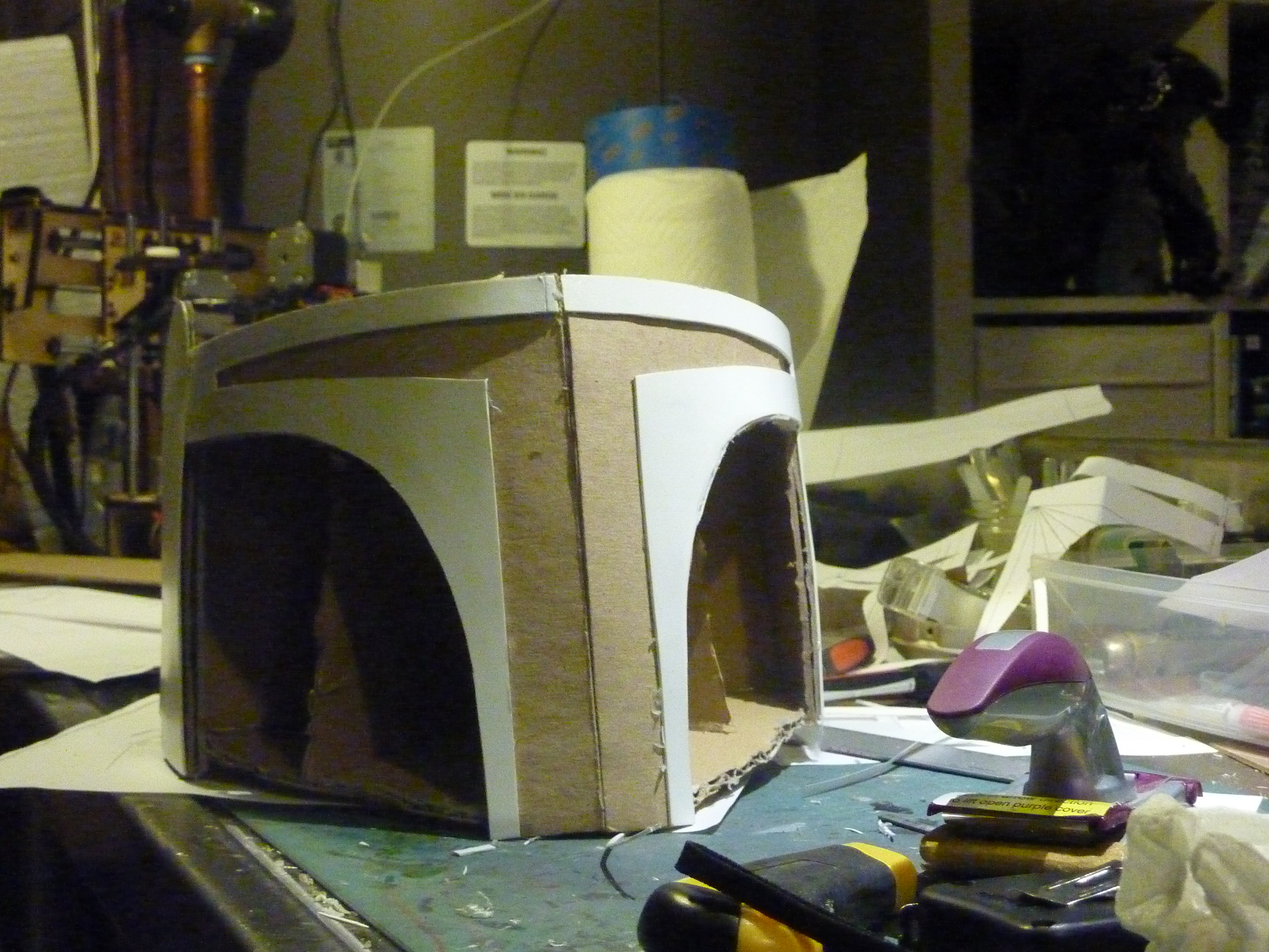

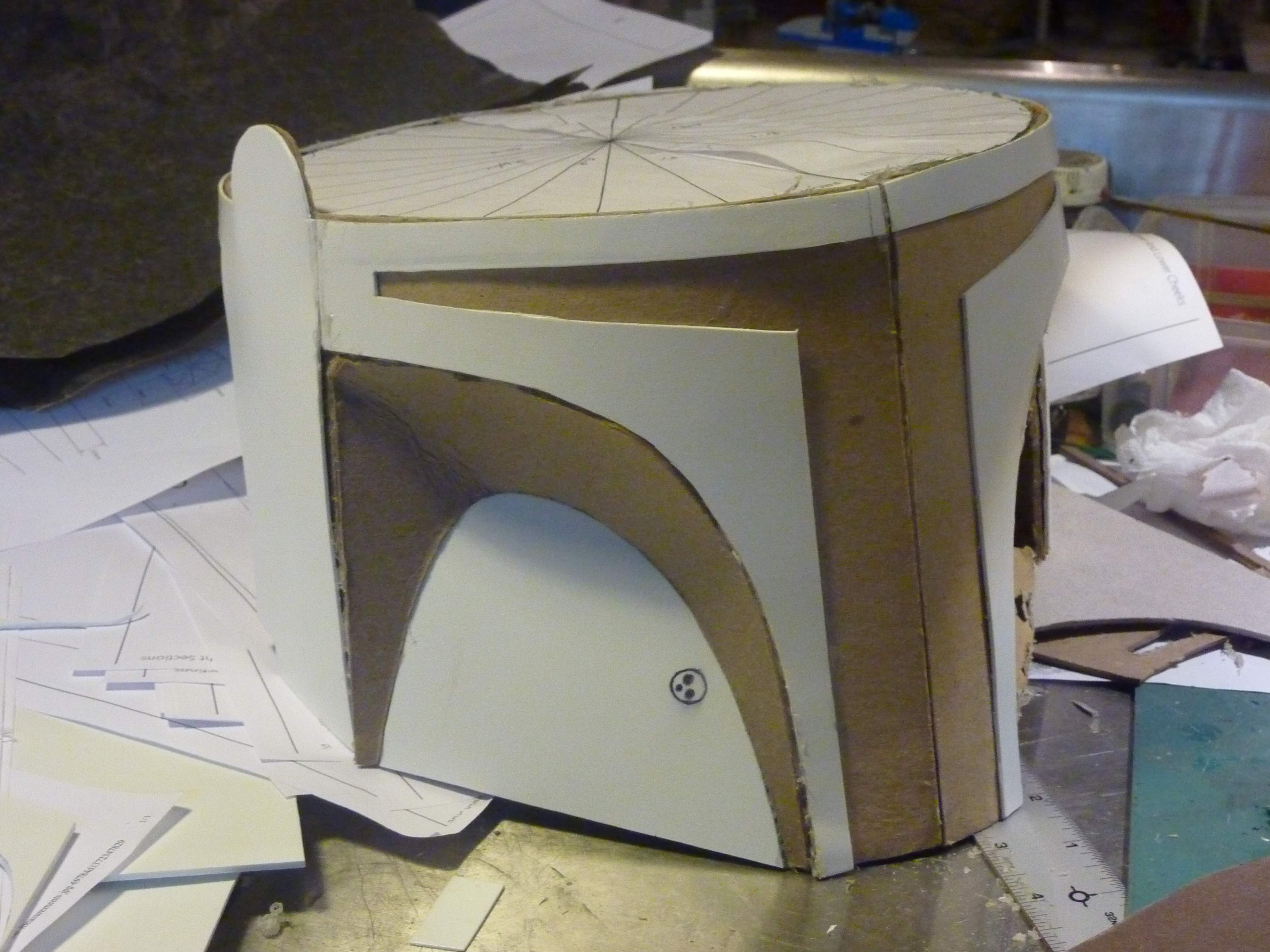

Anyway, I began the cheeks:

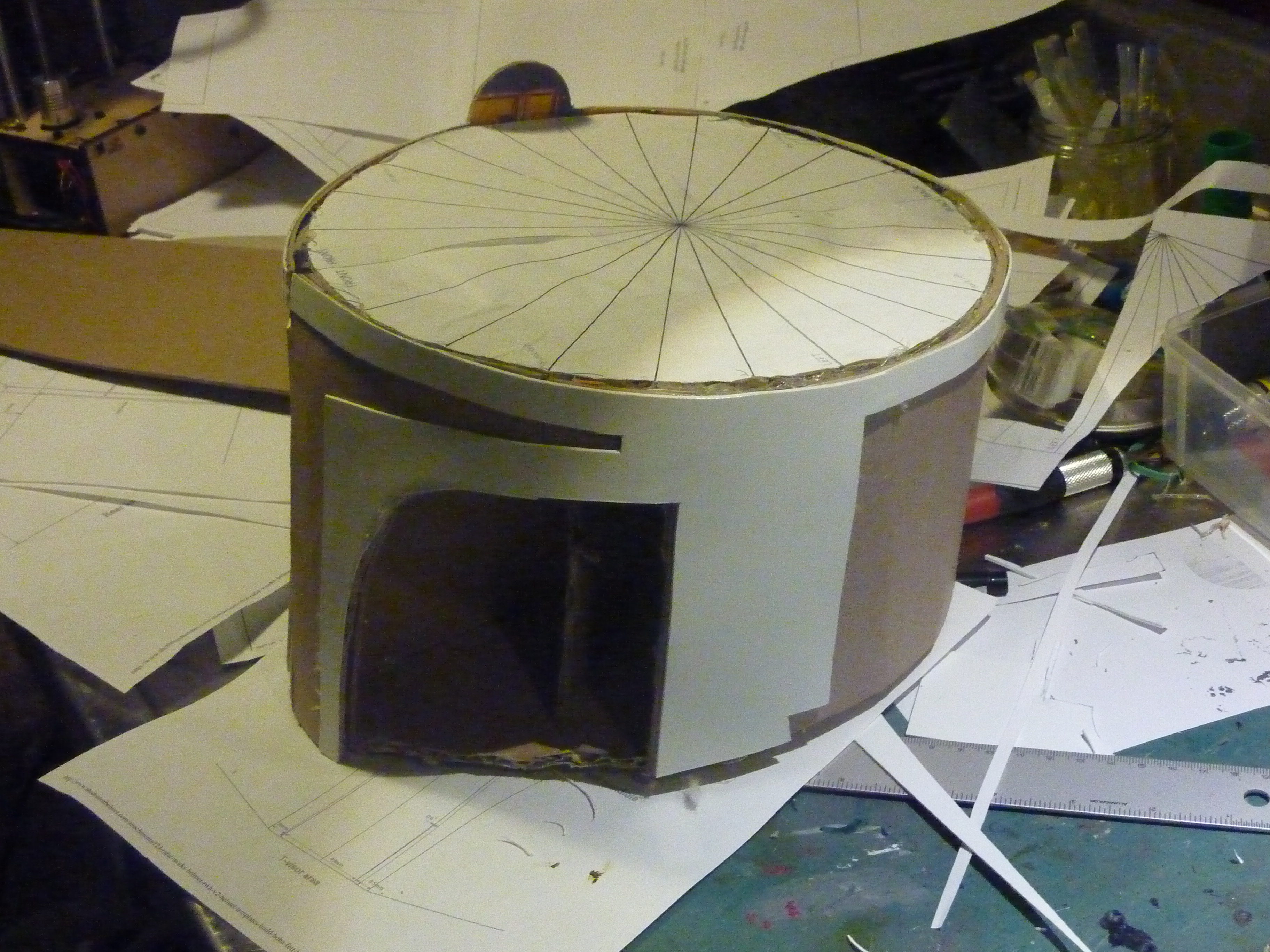

Progress: I got one cheek on!
Yay. I always remember the cheeks being the hardest part to put on from my first scratch build.

Second cheek begun!

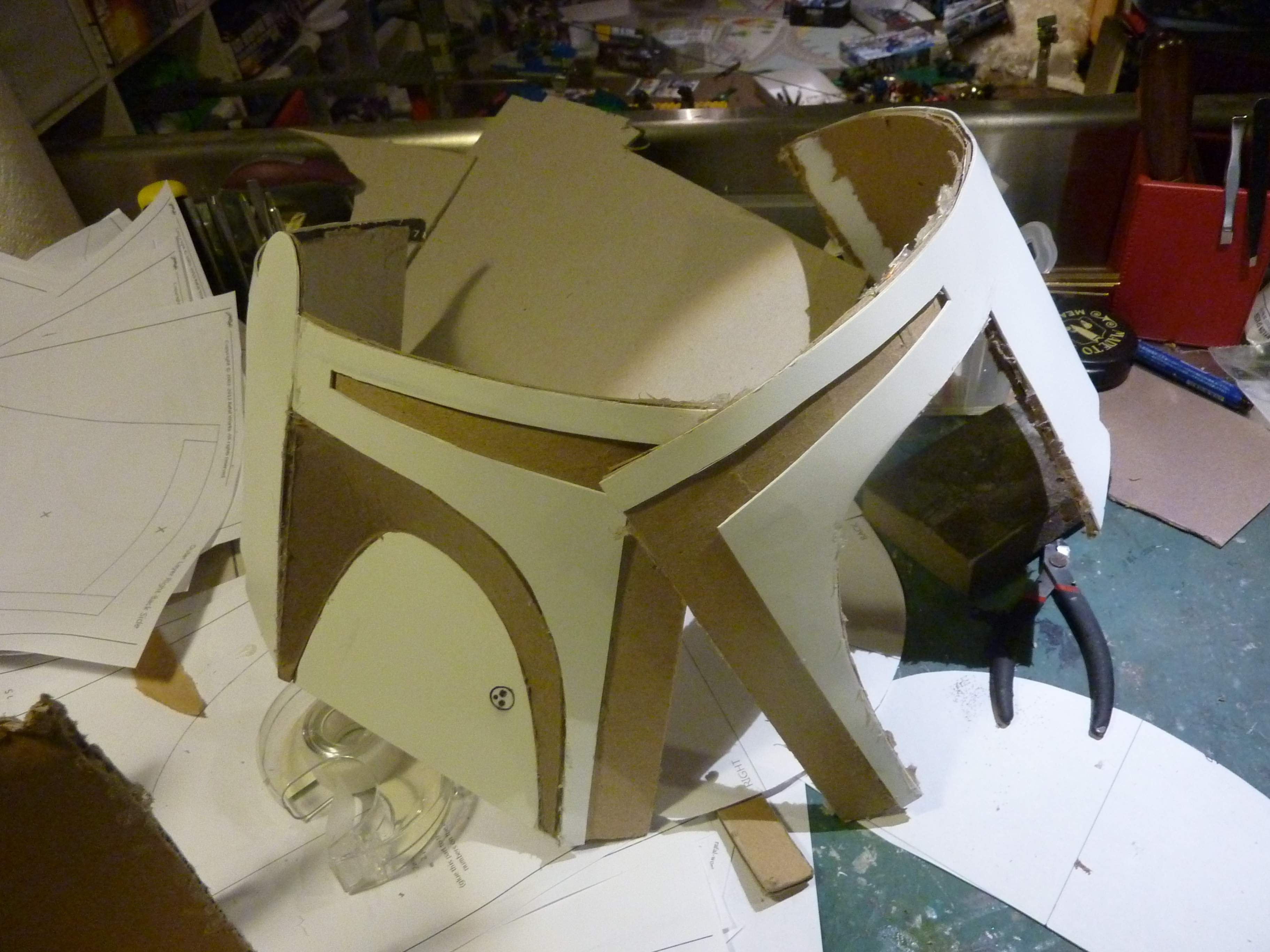

Artakha

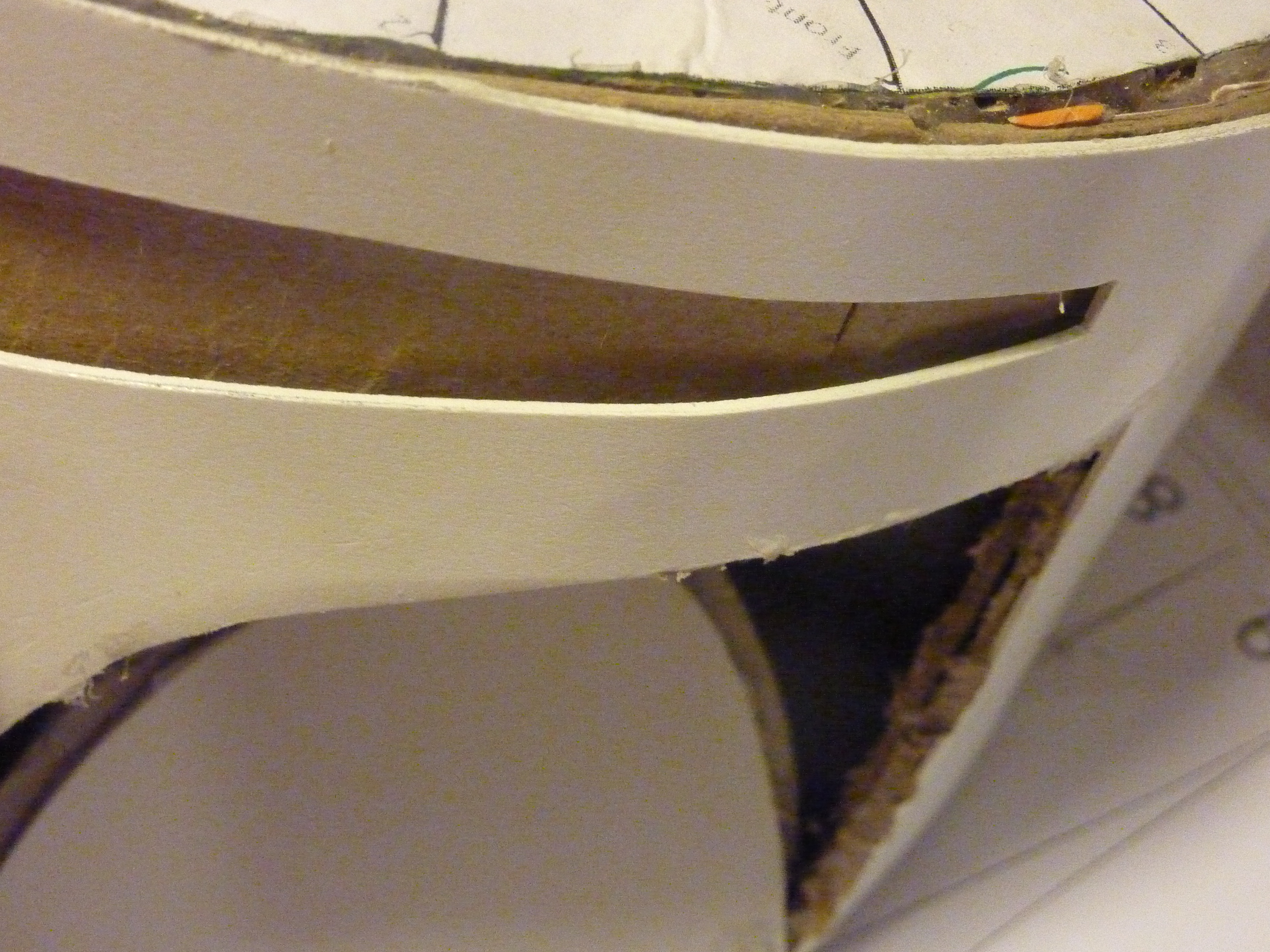

Well, the right side did not go half as smoothly as the left. I ended up yanking it out because I had to squeeze the cheek parts into the helmet so much that the cardboard piece got really twisted and messed up. This is after I yanked it out (I forgot to take pictures of when it was in).
The issue is that although the cheek part can fit in the helmet, there isn't room for the upper cheek piece unless its just totally flat and mashed in there.
The other thing is that the mandible of that side bends outward when I keep it in the correct position:
What it wants to do is this:
which allows more room for the upper cheek....
but then the space for the visor is a bit pinched. :facepalm
Anyway, looking for some help and advice.
(Rafalfett SAVE ME :D)
RafalFett
Try to glue the upper cheek first, then squeeze in the lower cheek. As I already said, the corrugated cardboard is not the best choice, especially for the inner parts, as it tends to warp:

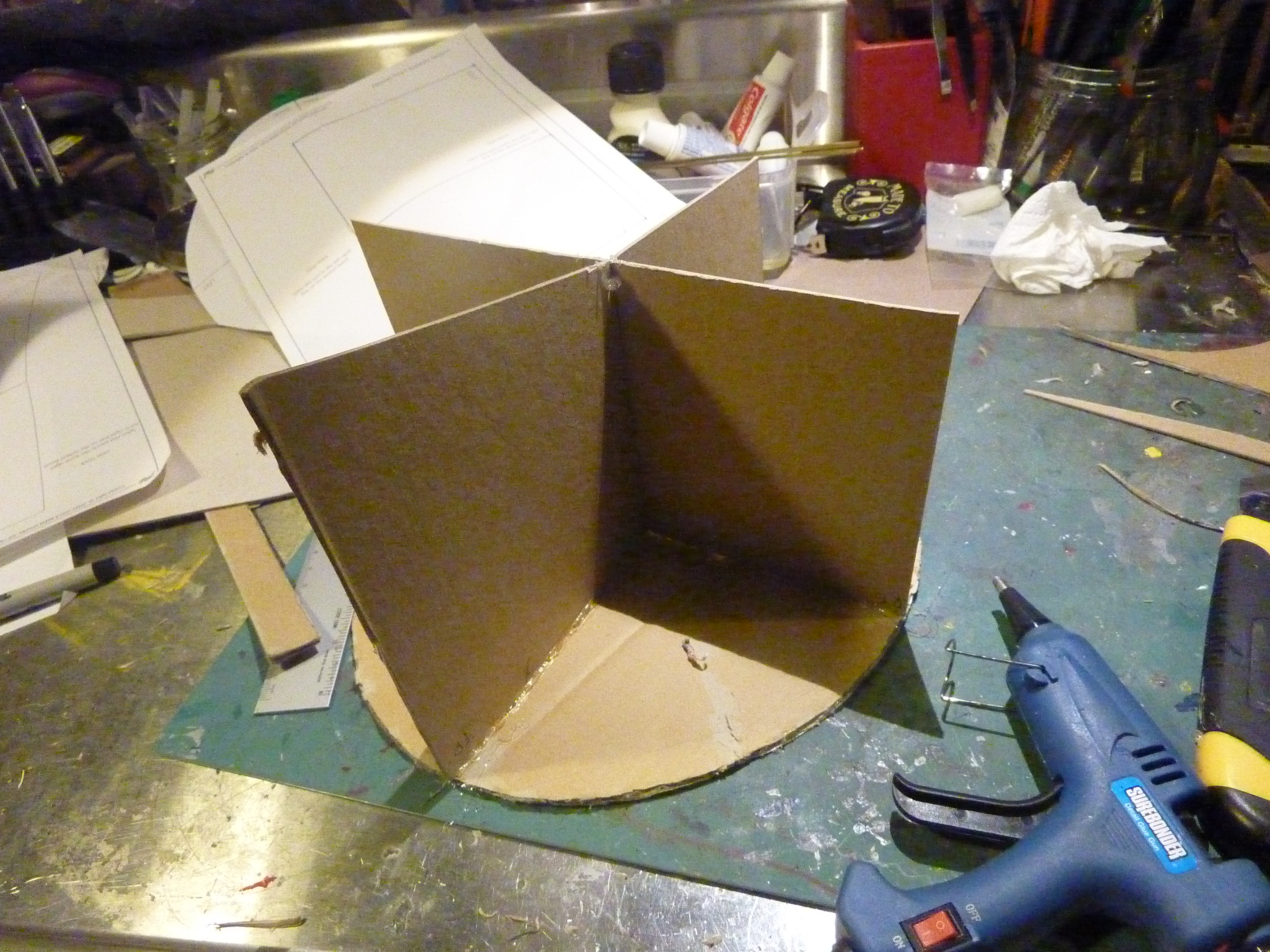

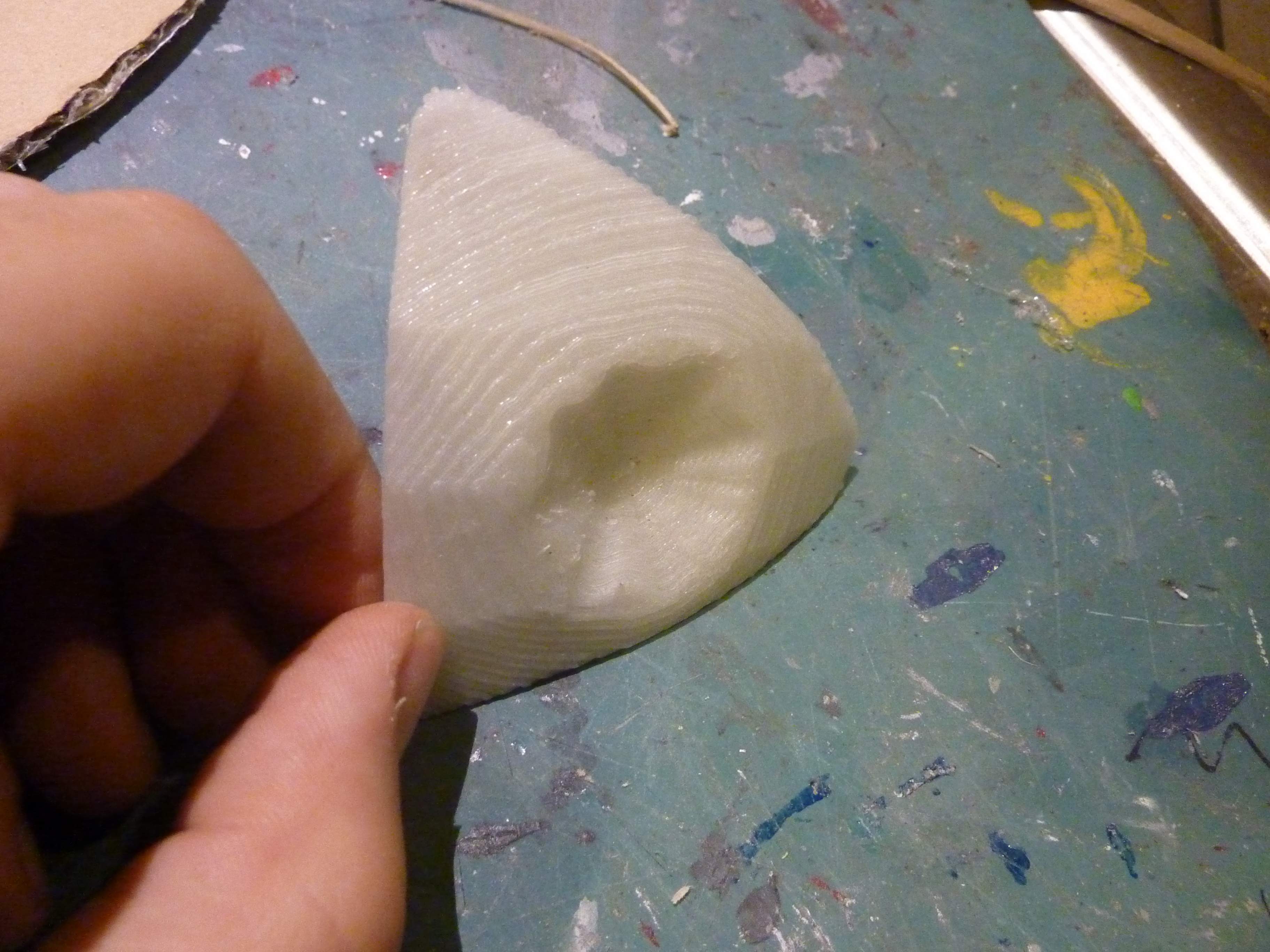

Ok so I don't have any pictures to show, but I started checking the helmet's frame for warps and began work on the frame for the dome using non-corrugated cardboard. I started up my 3D printer, and began printing just the dent from Raf's 1:1 helmet file. I also picked up some XTC-3D which will allow the finished 3D print to look like a finished part. Can't wait for the print to be finished. More updates tomorrow.
Artakha

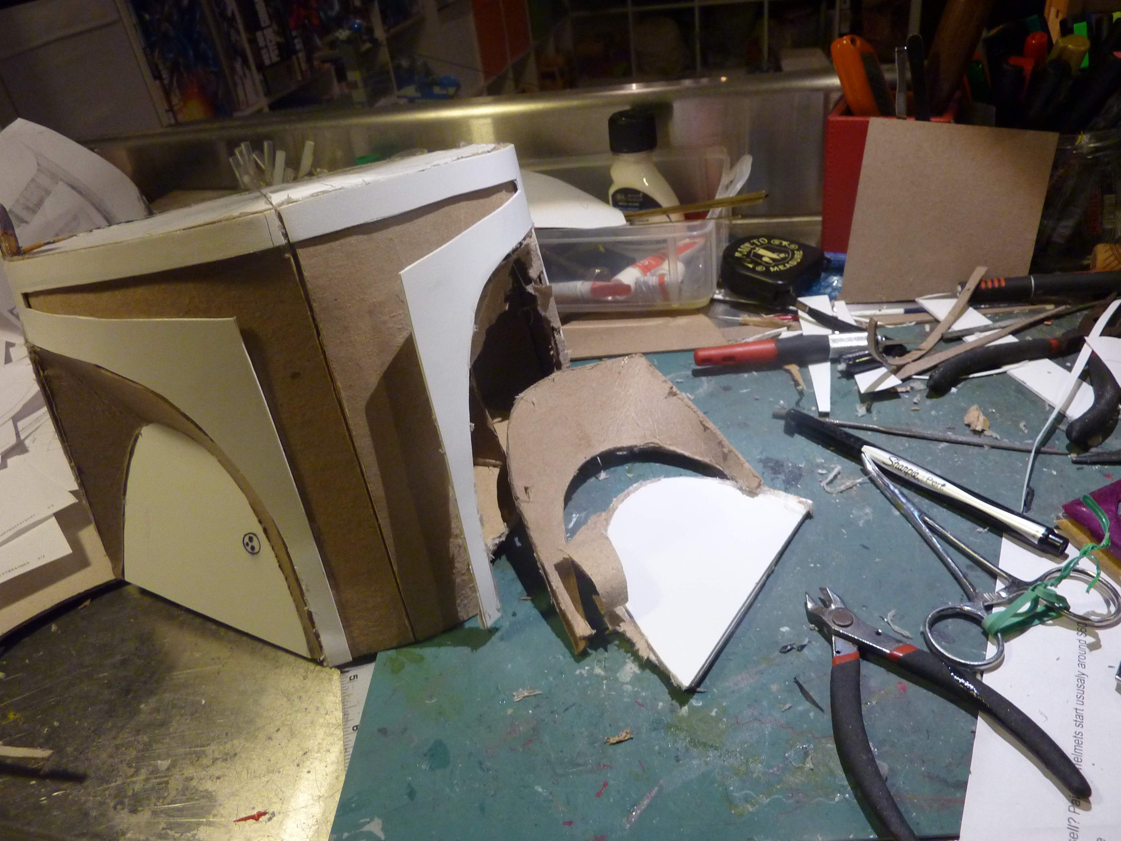

Well, the cheek piece just doesn't want to fit, so I decided to take apart the helmet and redo the inner support frame with non-corrugated cardboard. (gasp!)
So, tearing apart the helmet :cry

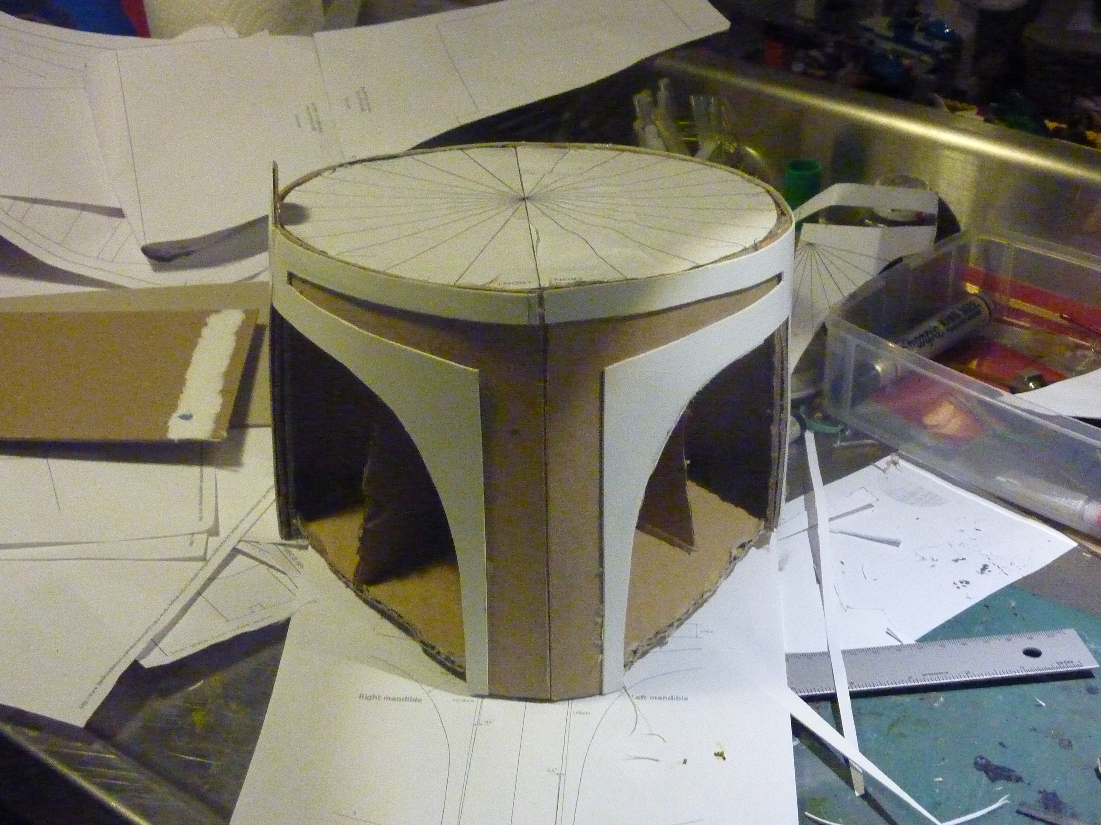

Then rebuilding the frame.
Advice and criticism is much appreciated!

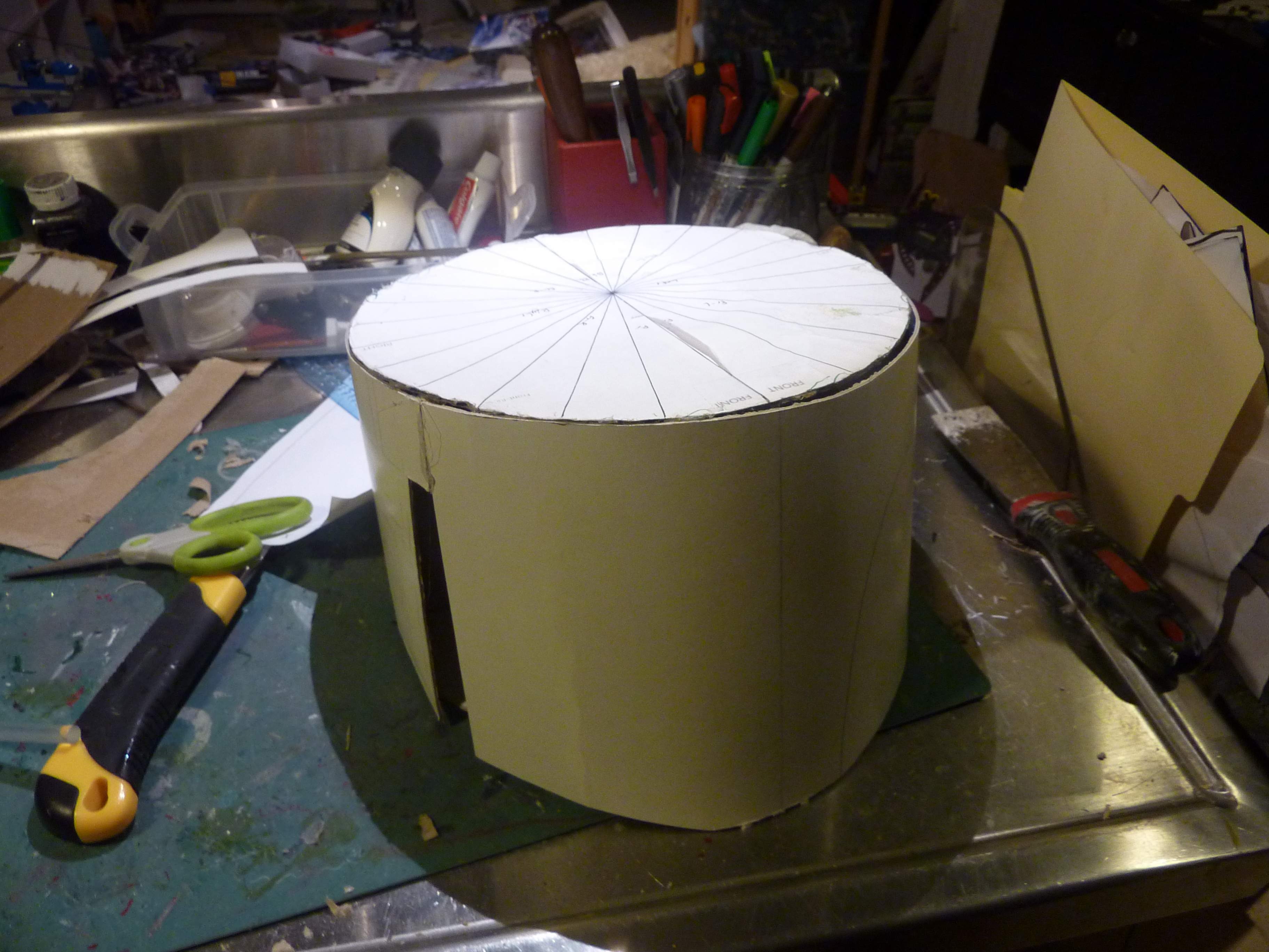

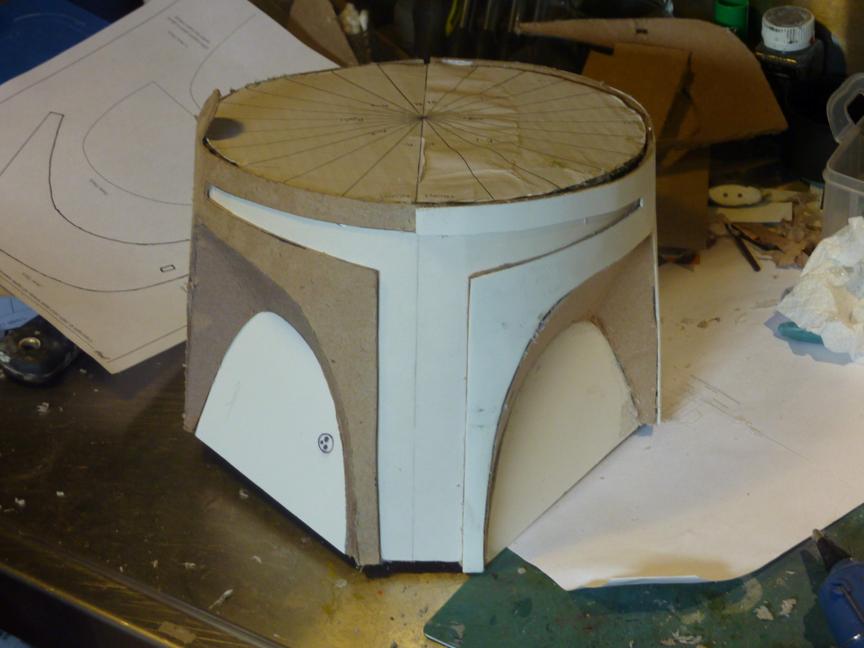

Artakha
Getting the helmet rebuilt...I think it's appearance is improved but any thoughts?
I'm still gonna put on the sintra outer layer though so we'll see how things go.
Any advice or criticism is very much appreciated!
