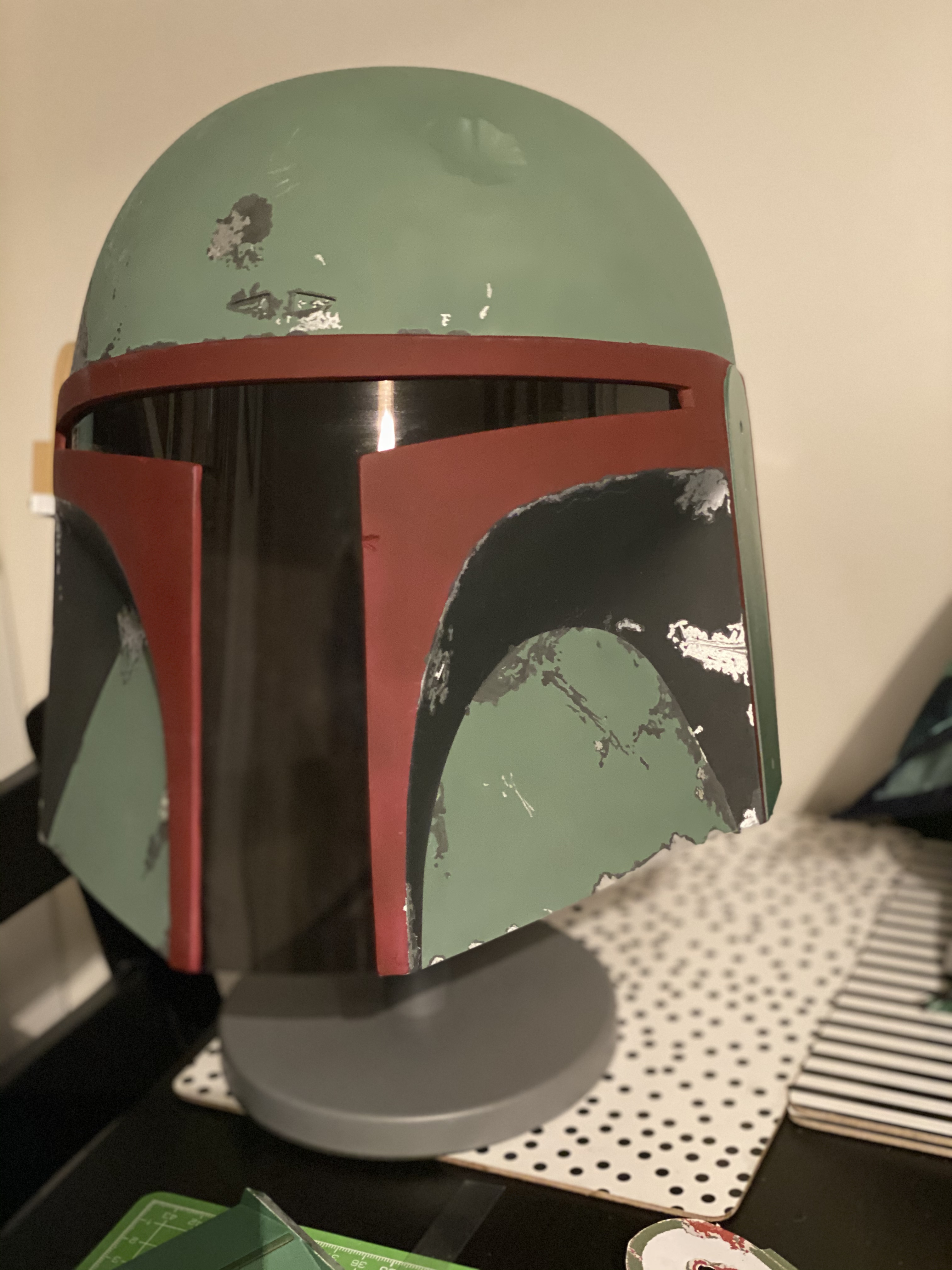

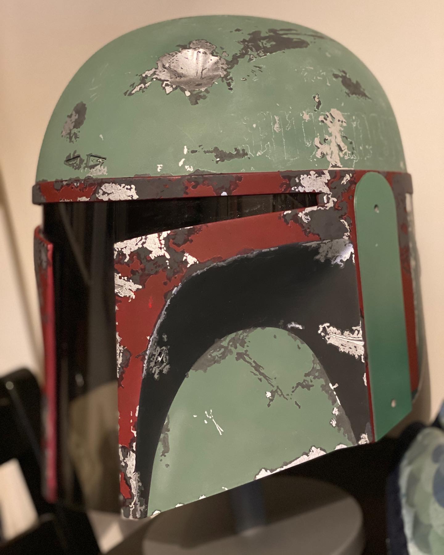

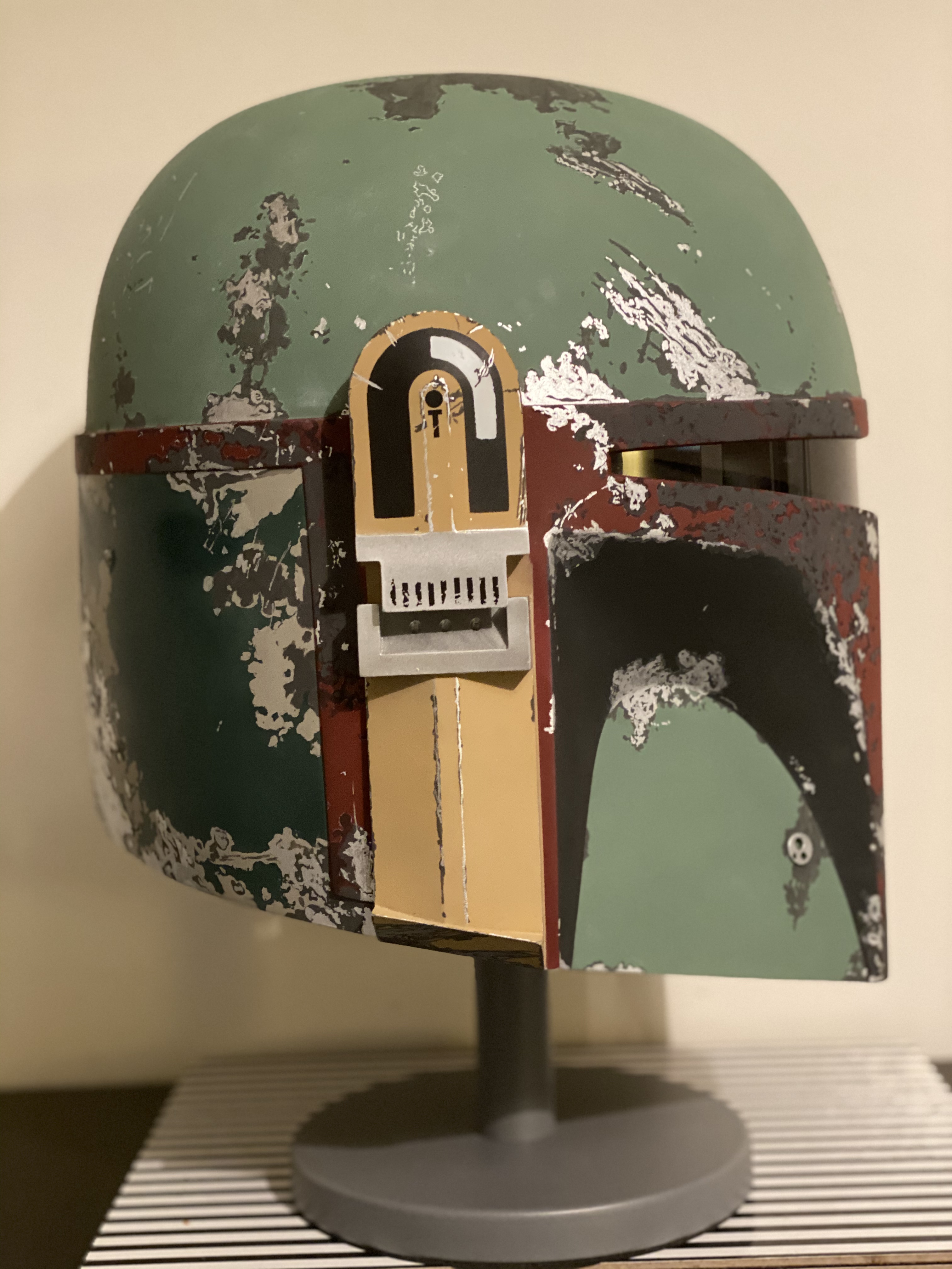

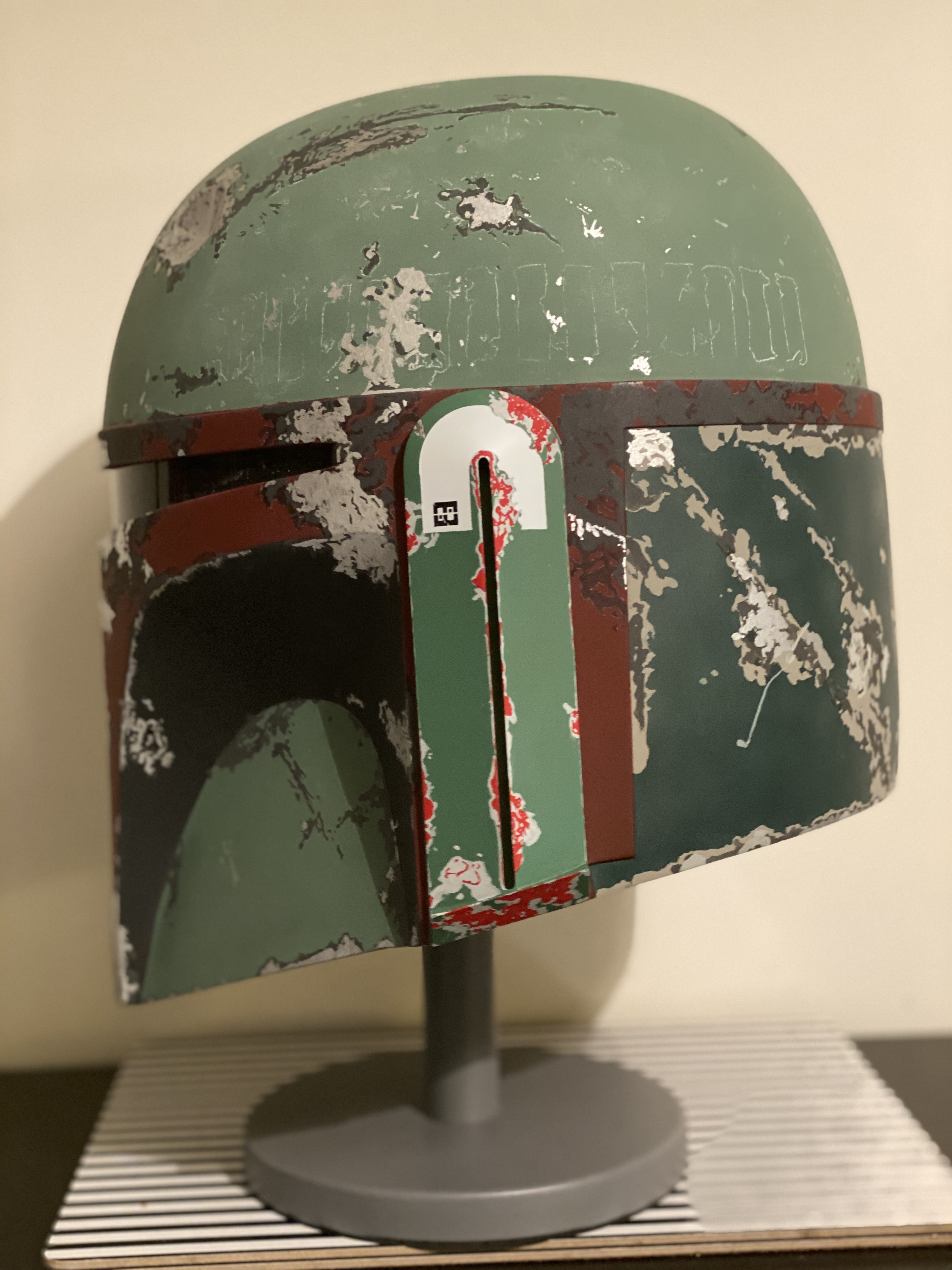

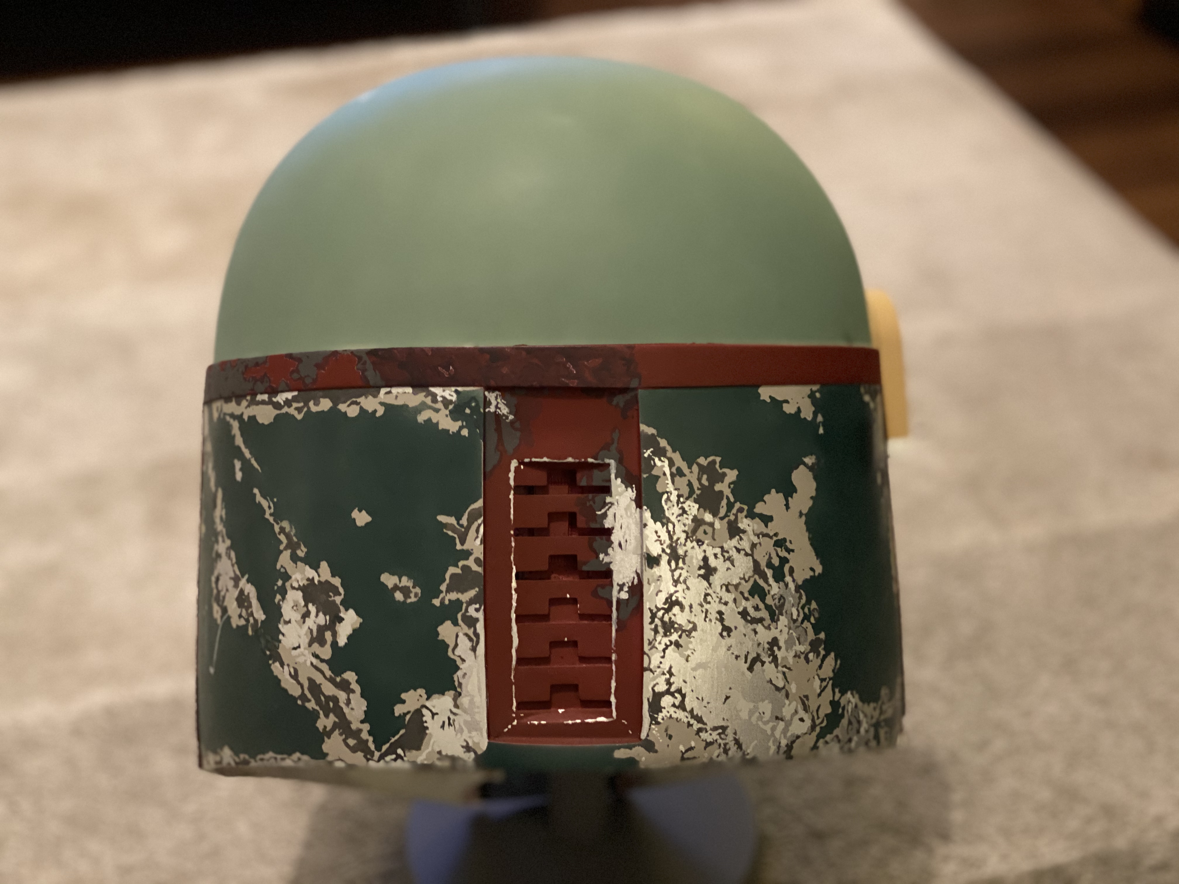

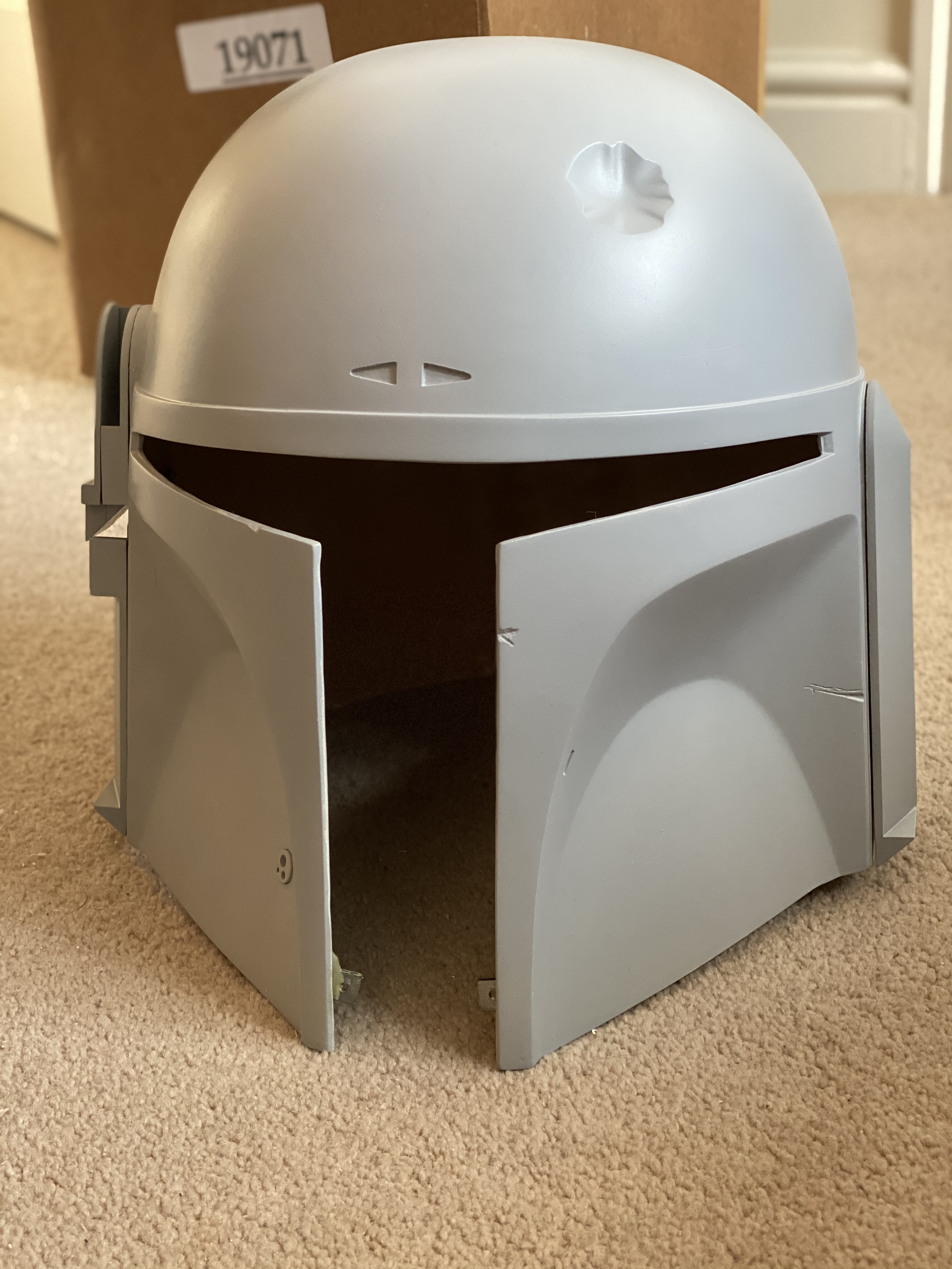

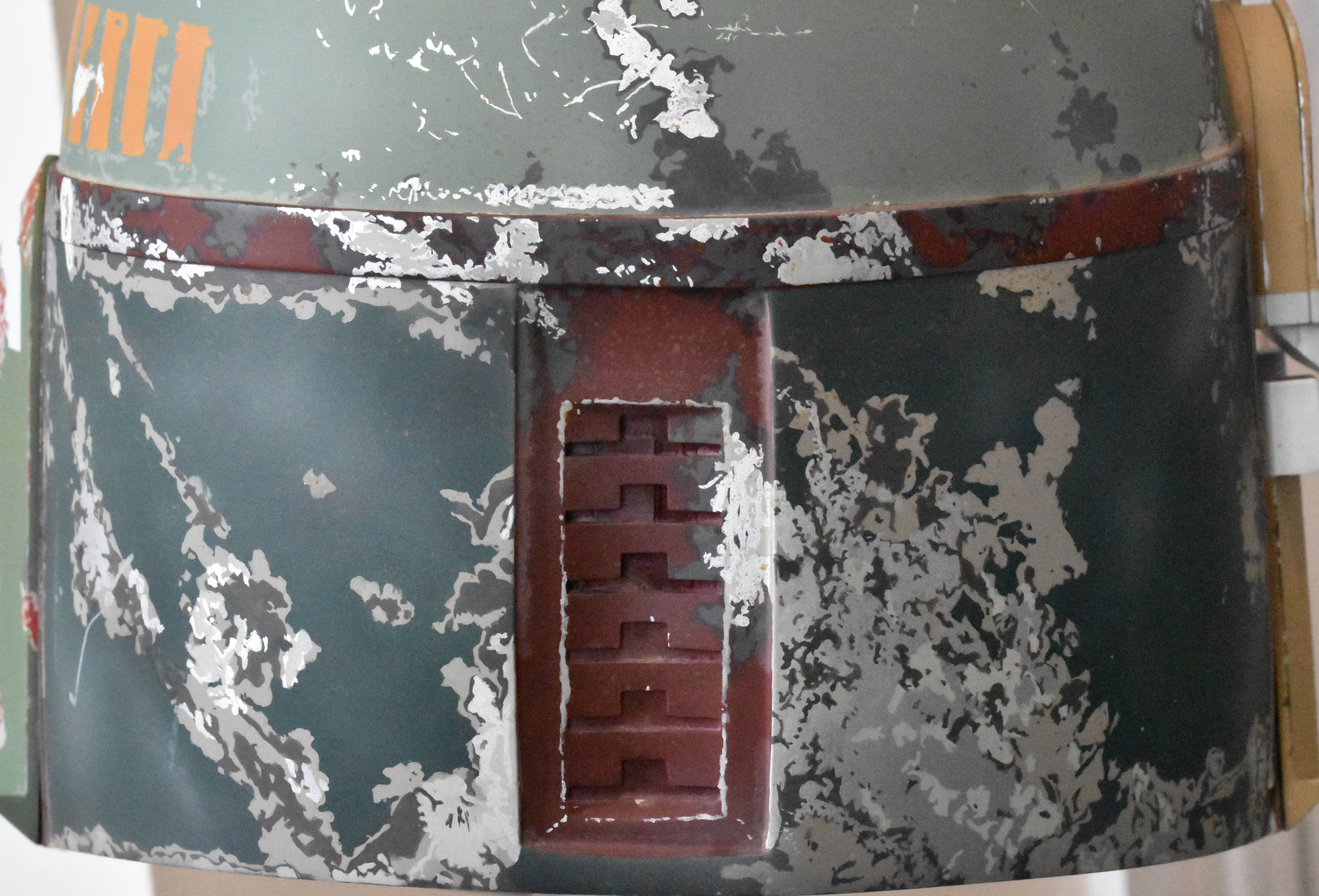

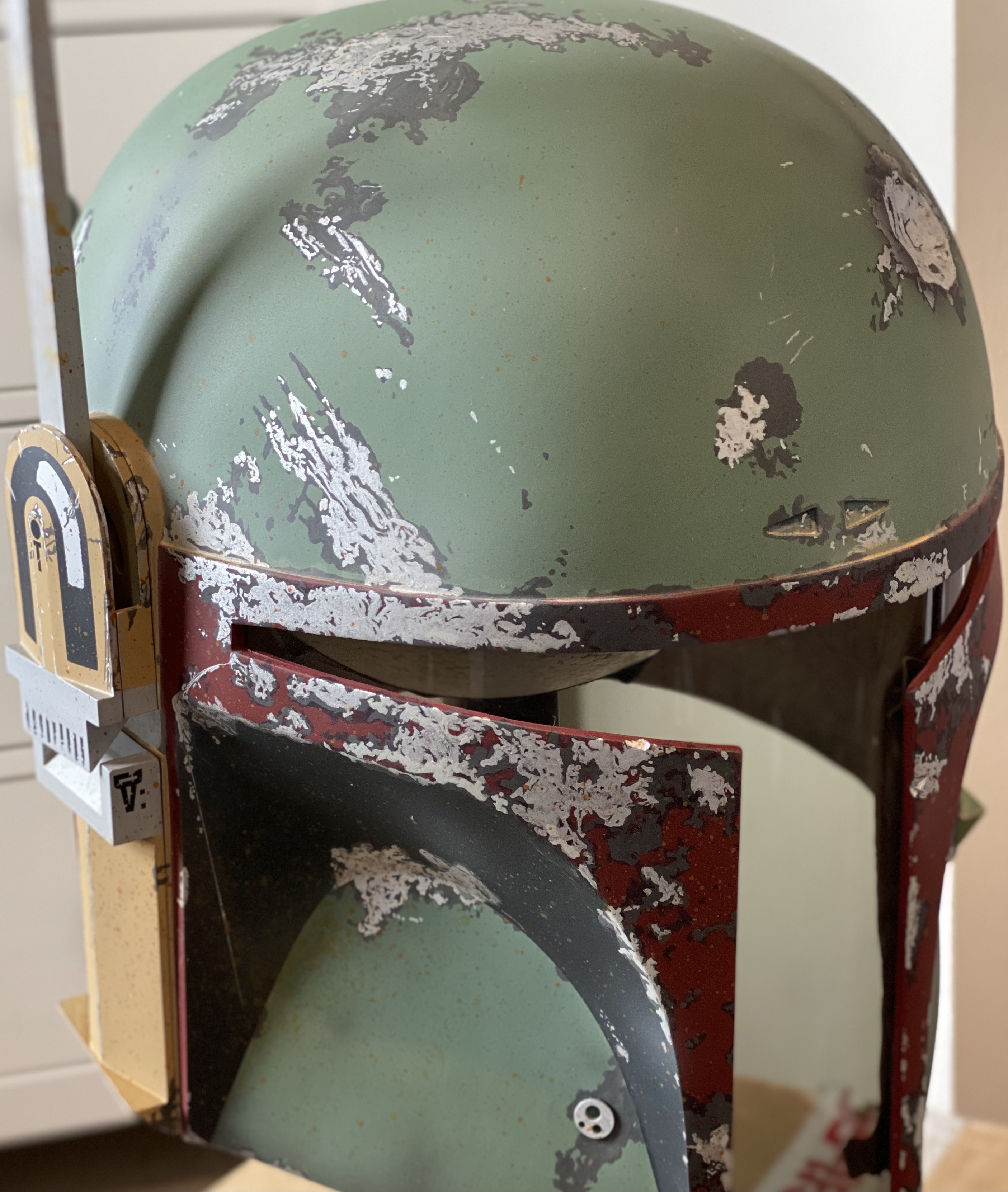

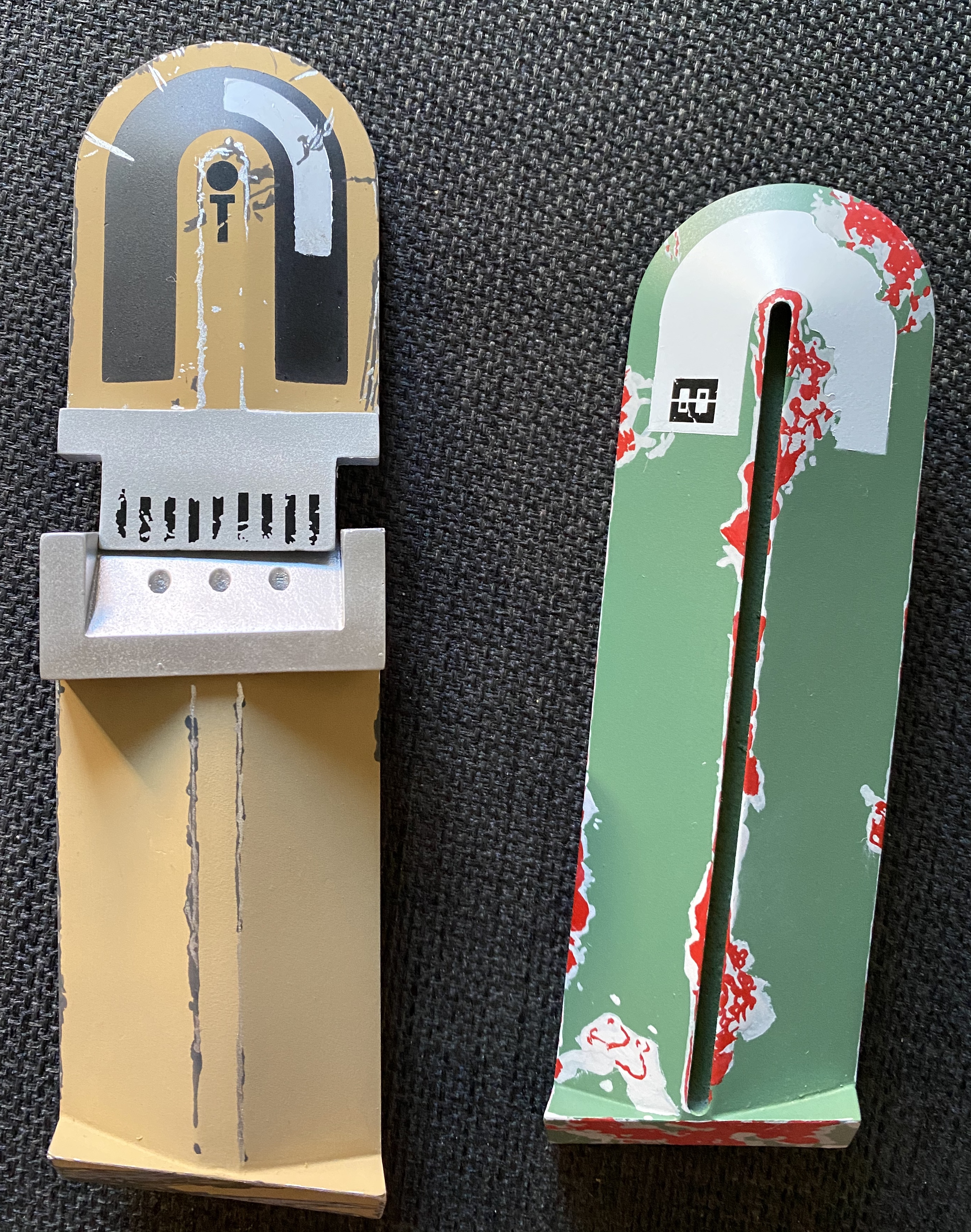

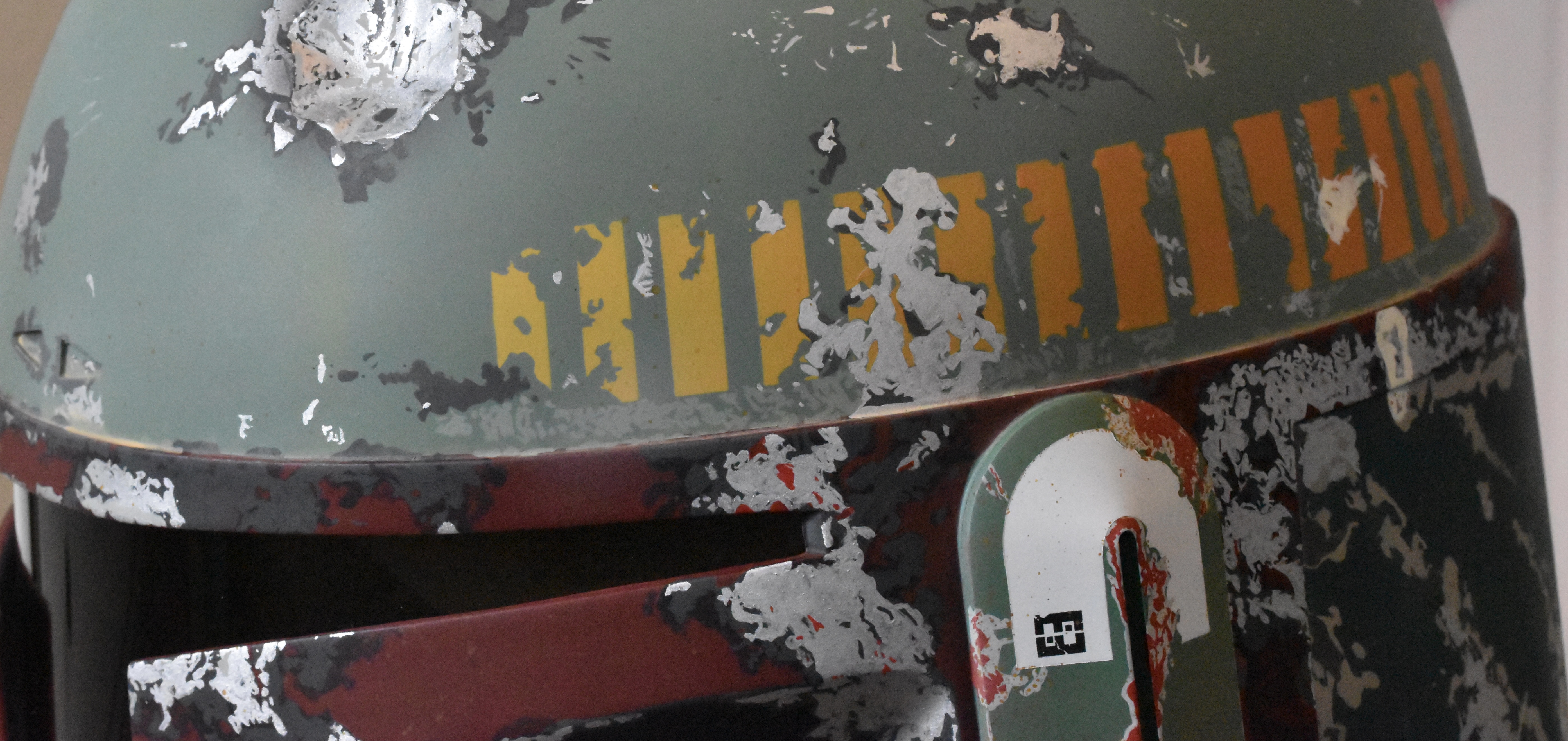

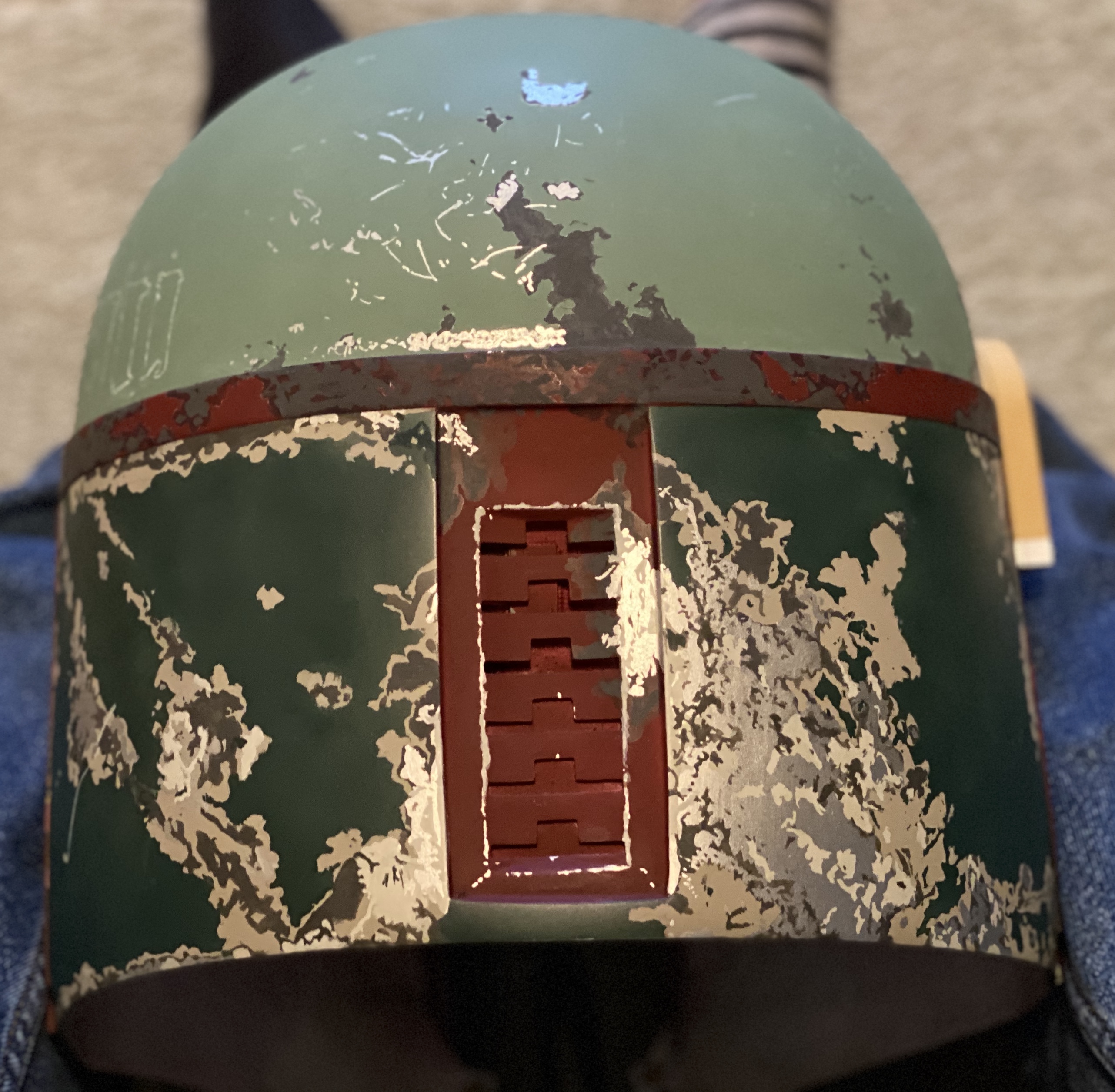

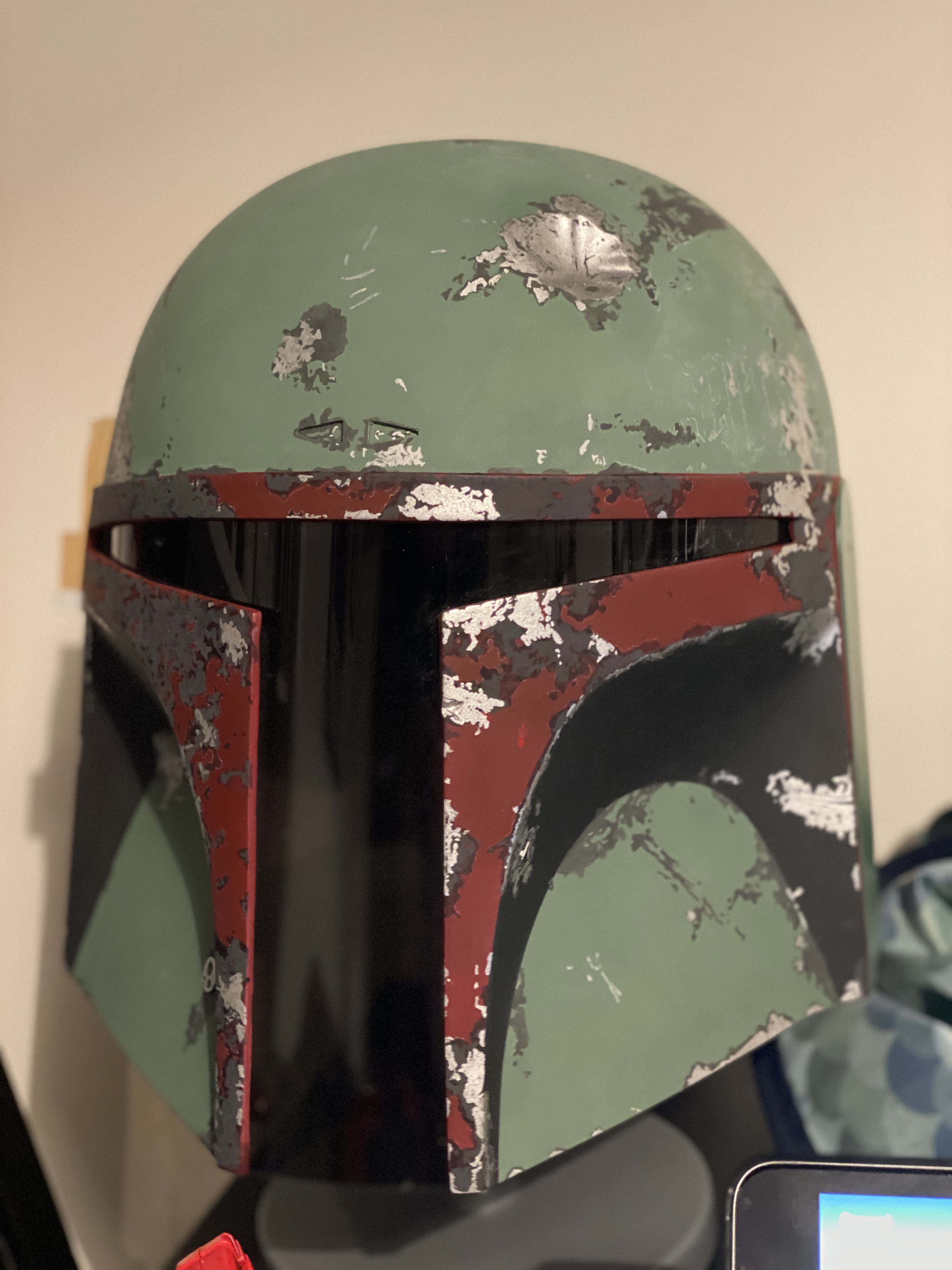

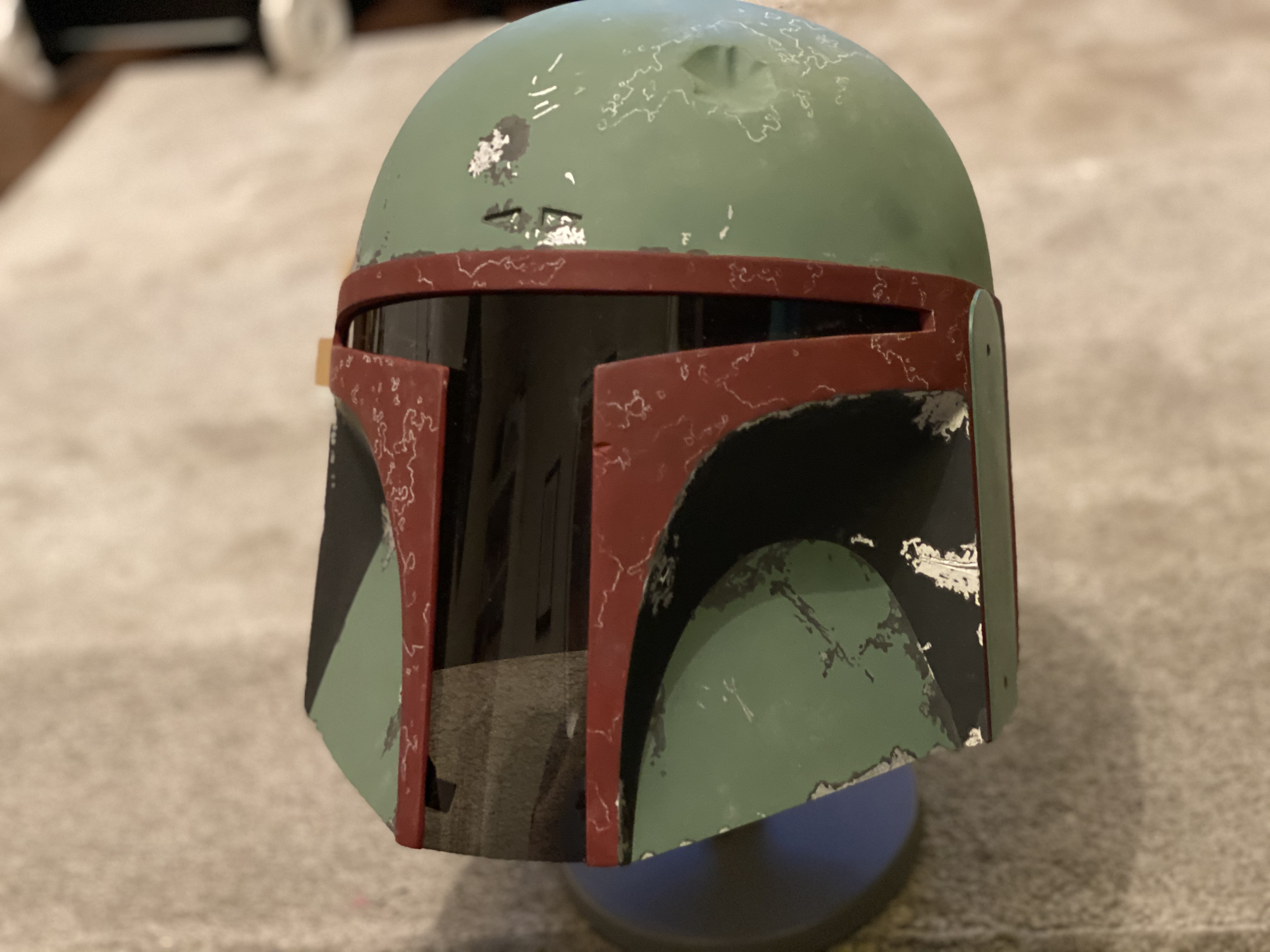

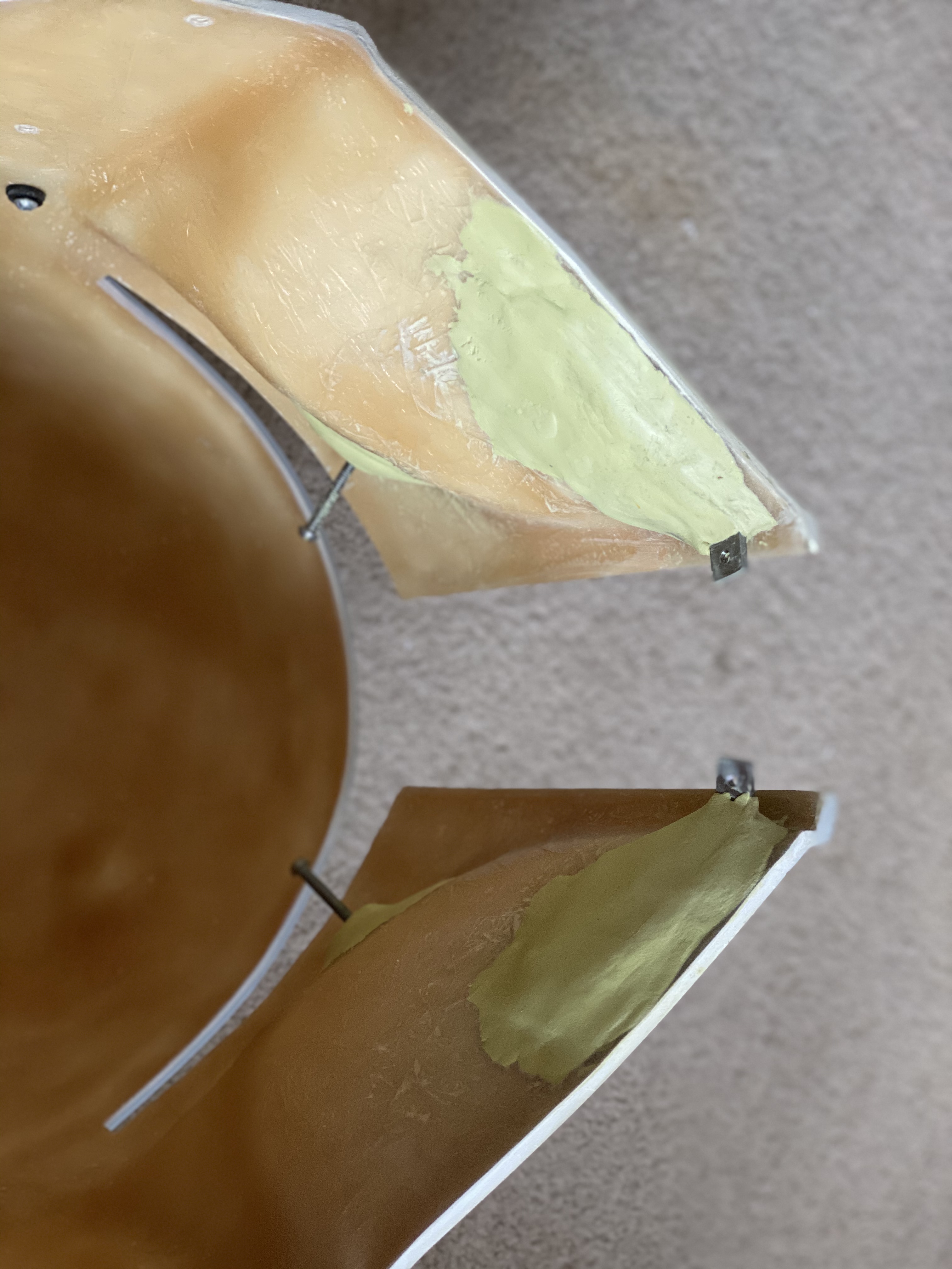

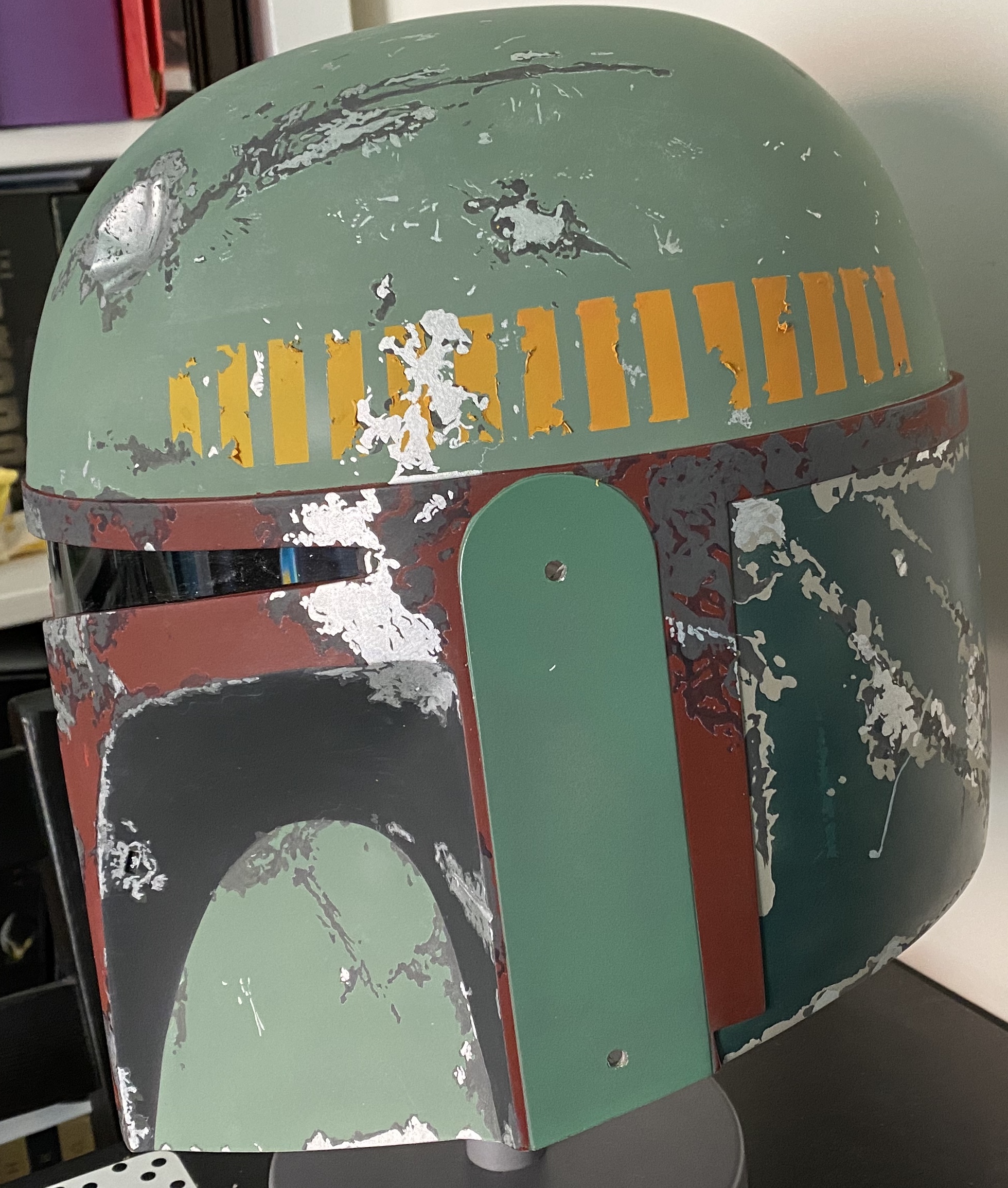

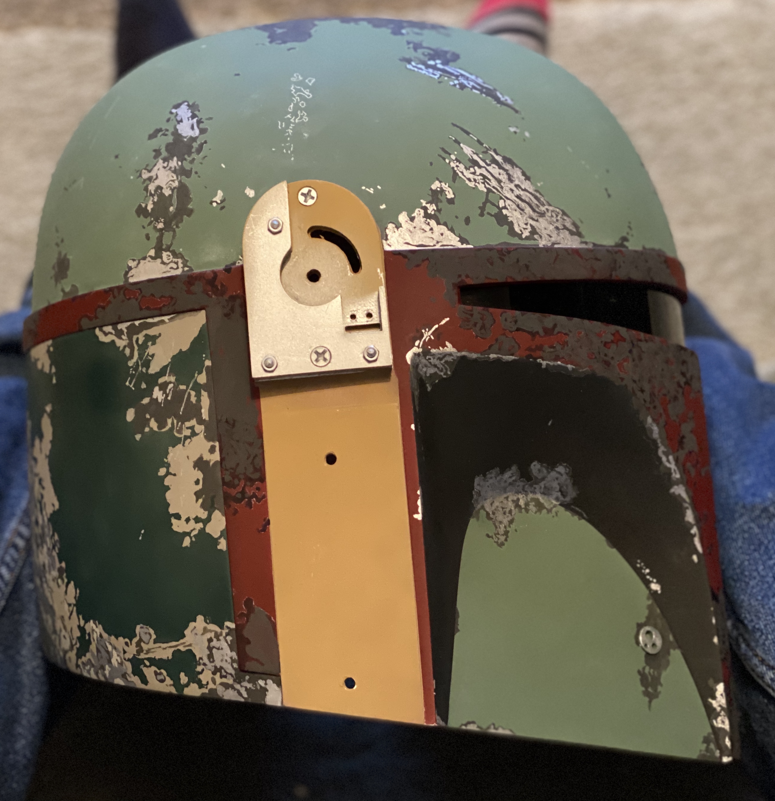

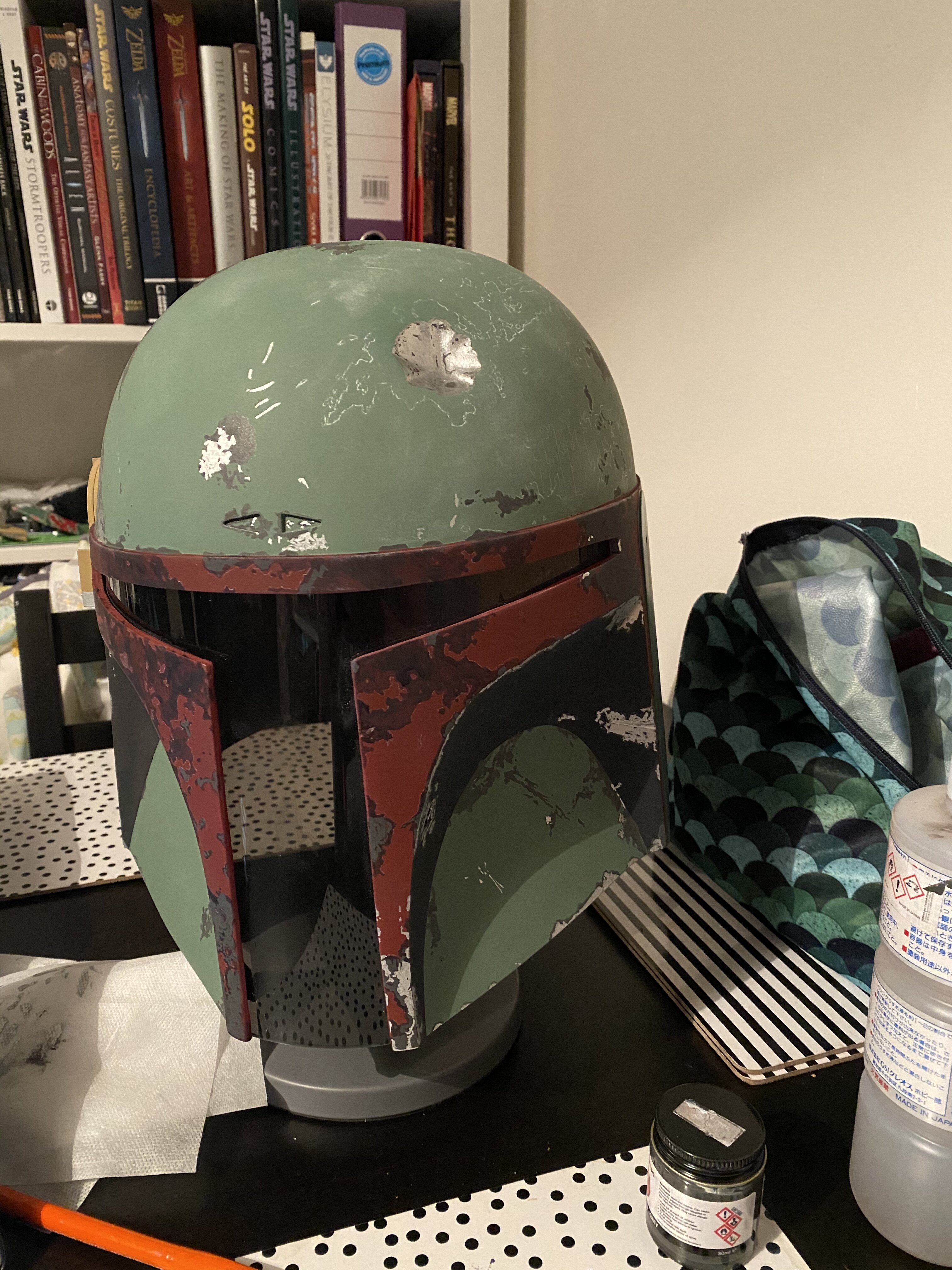

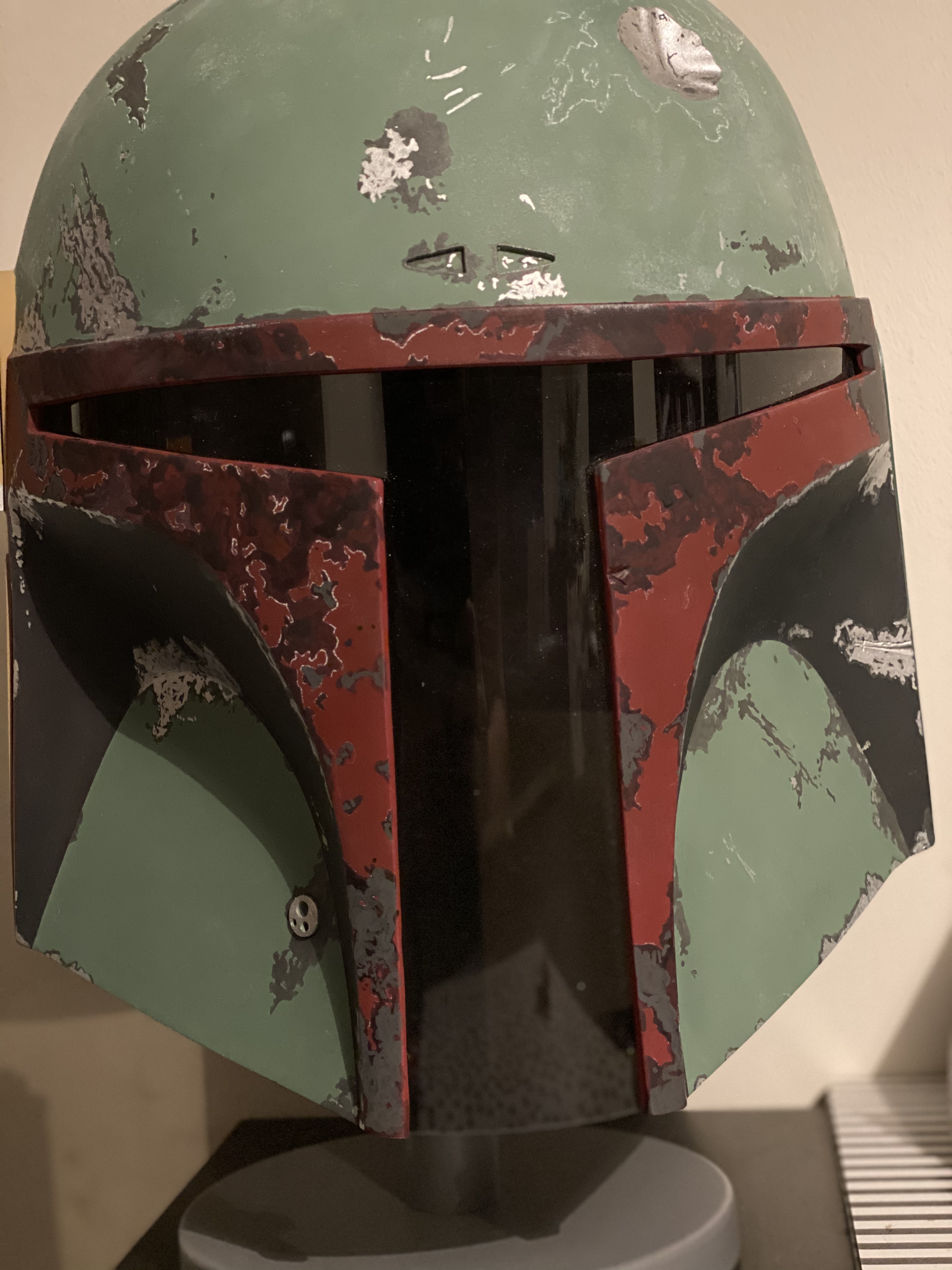

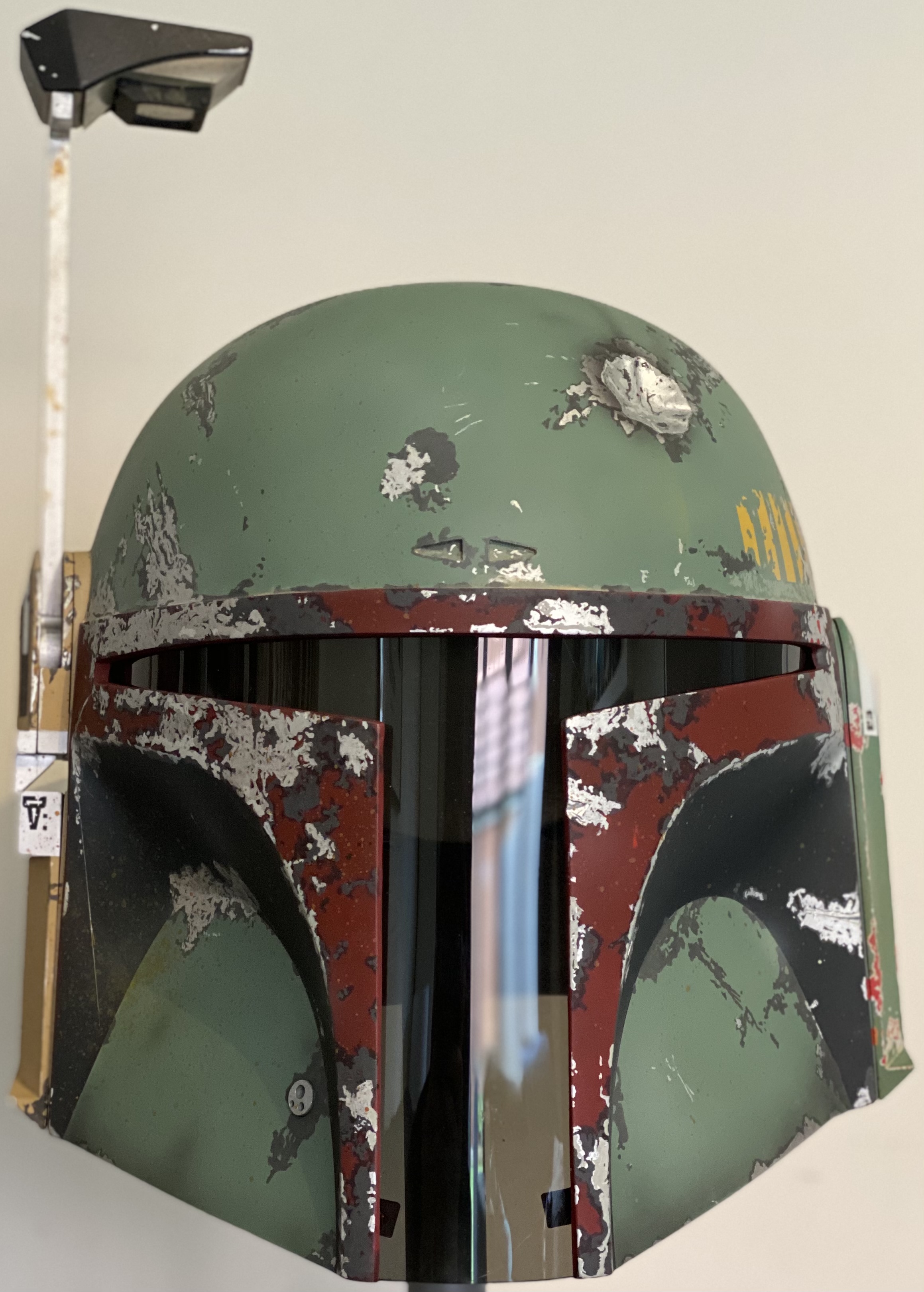

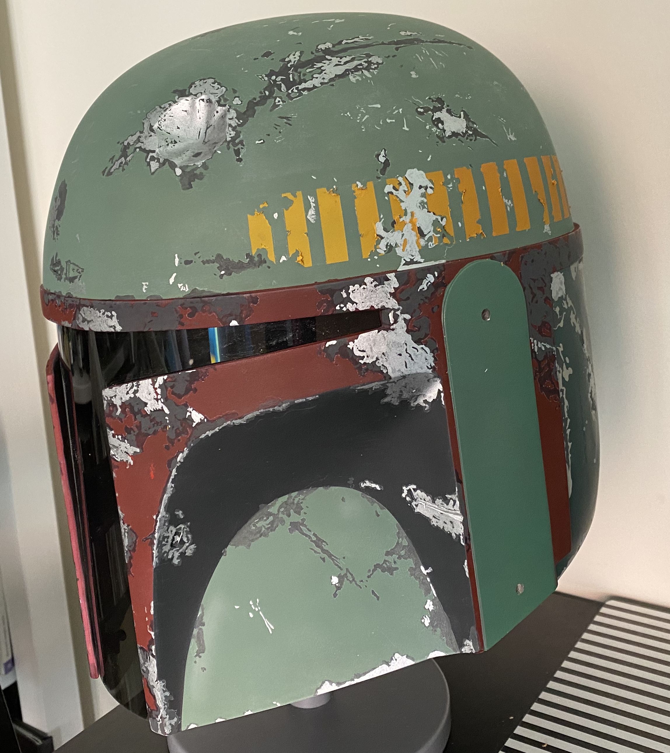

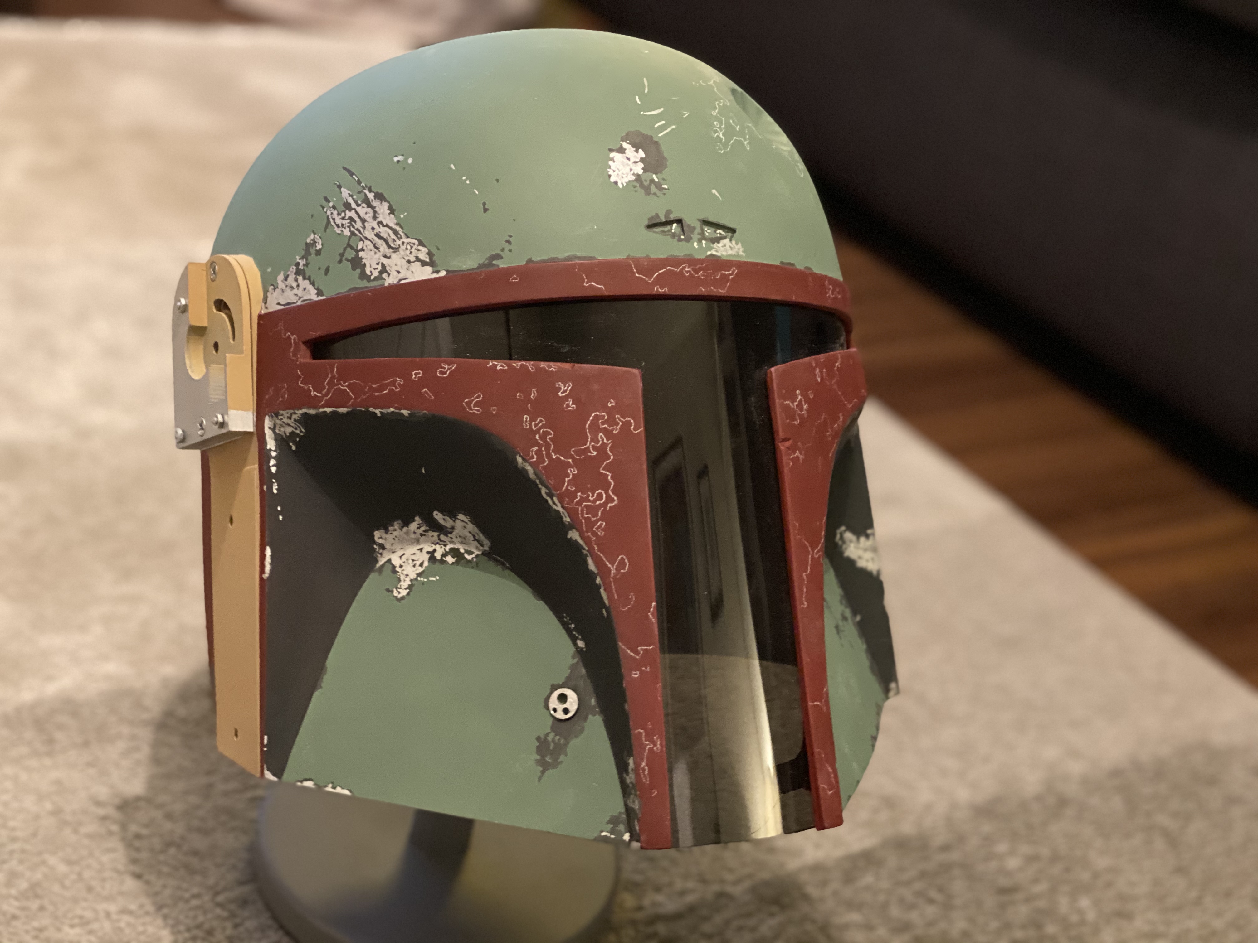

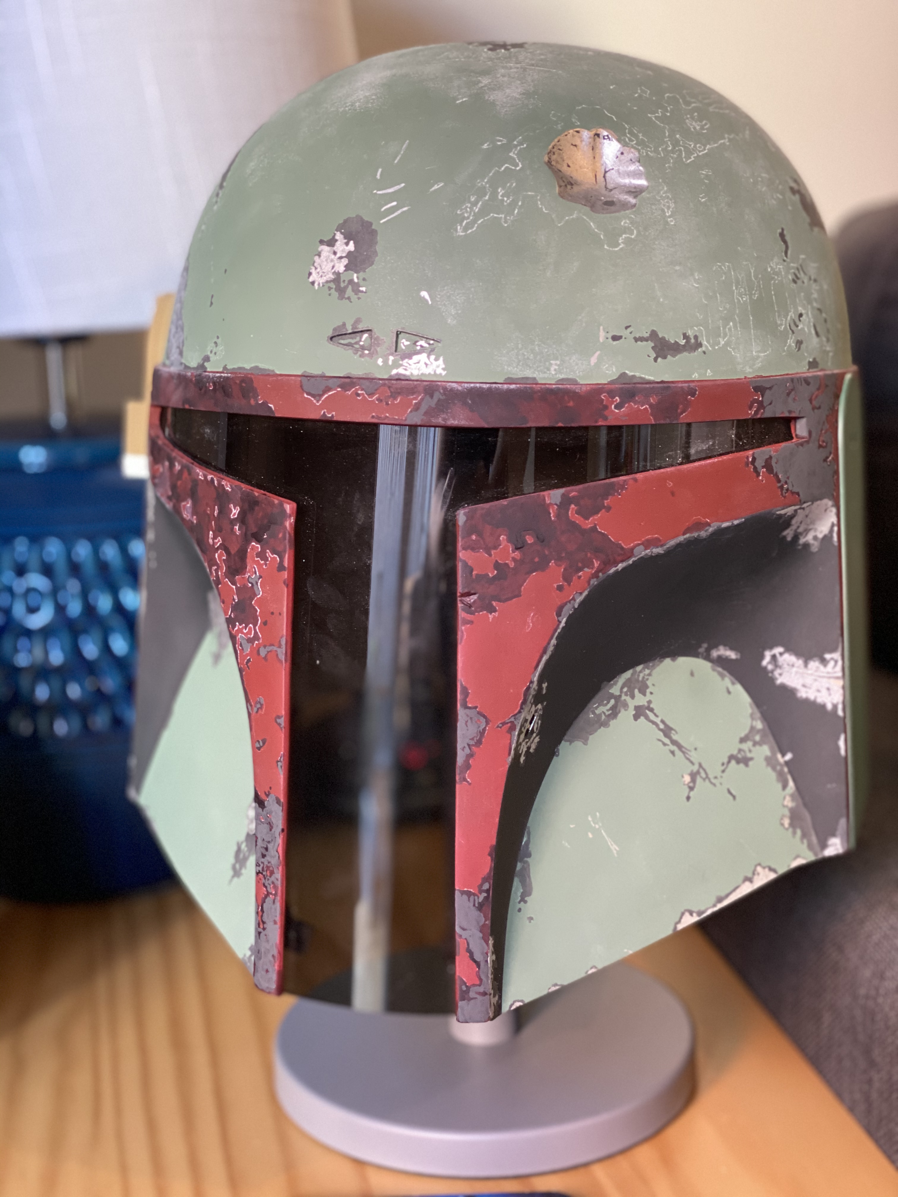

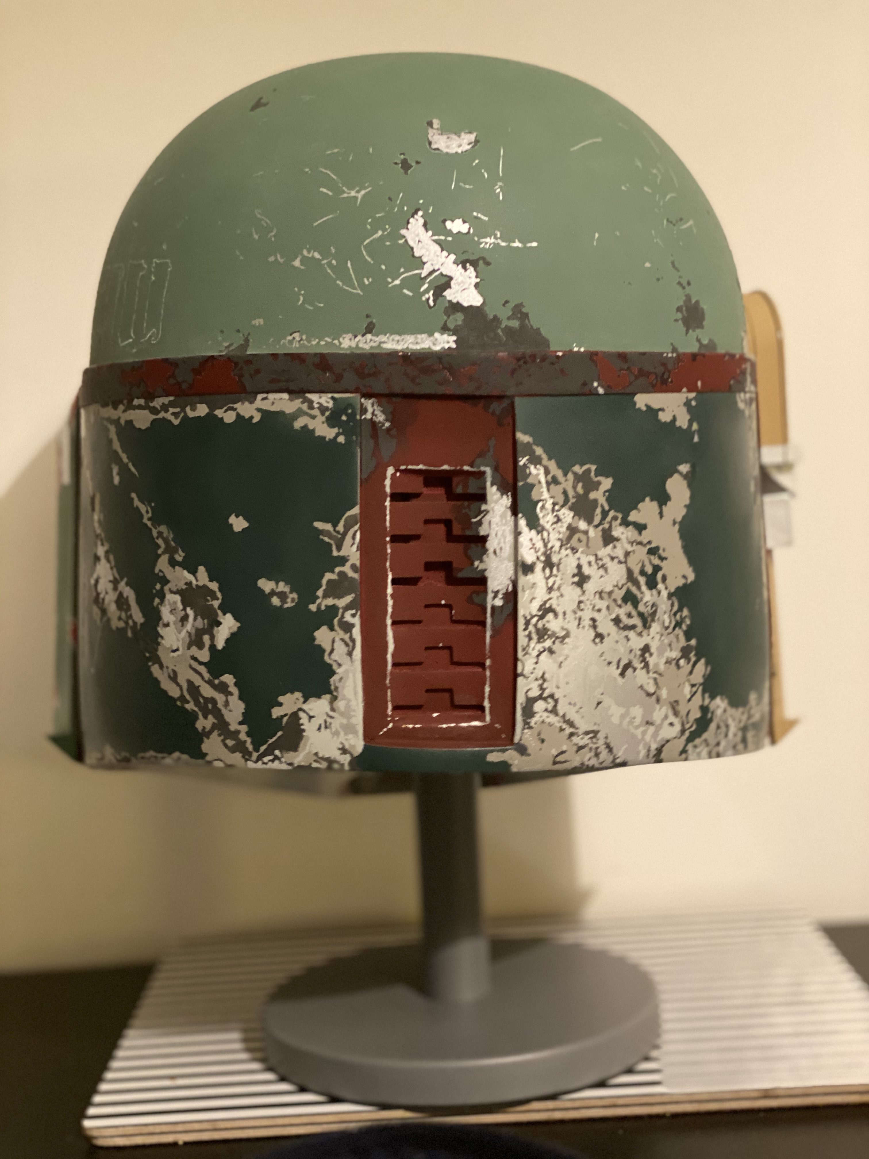

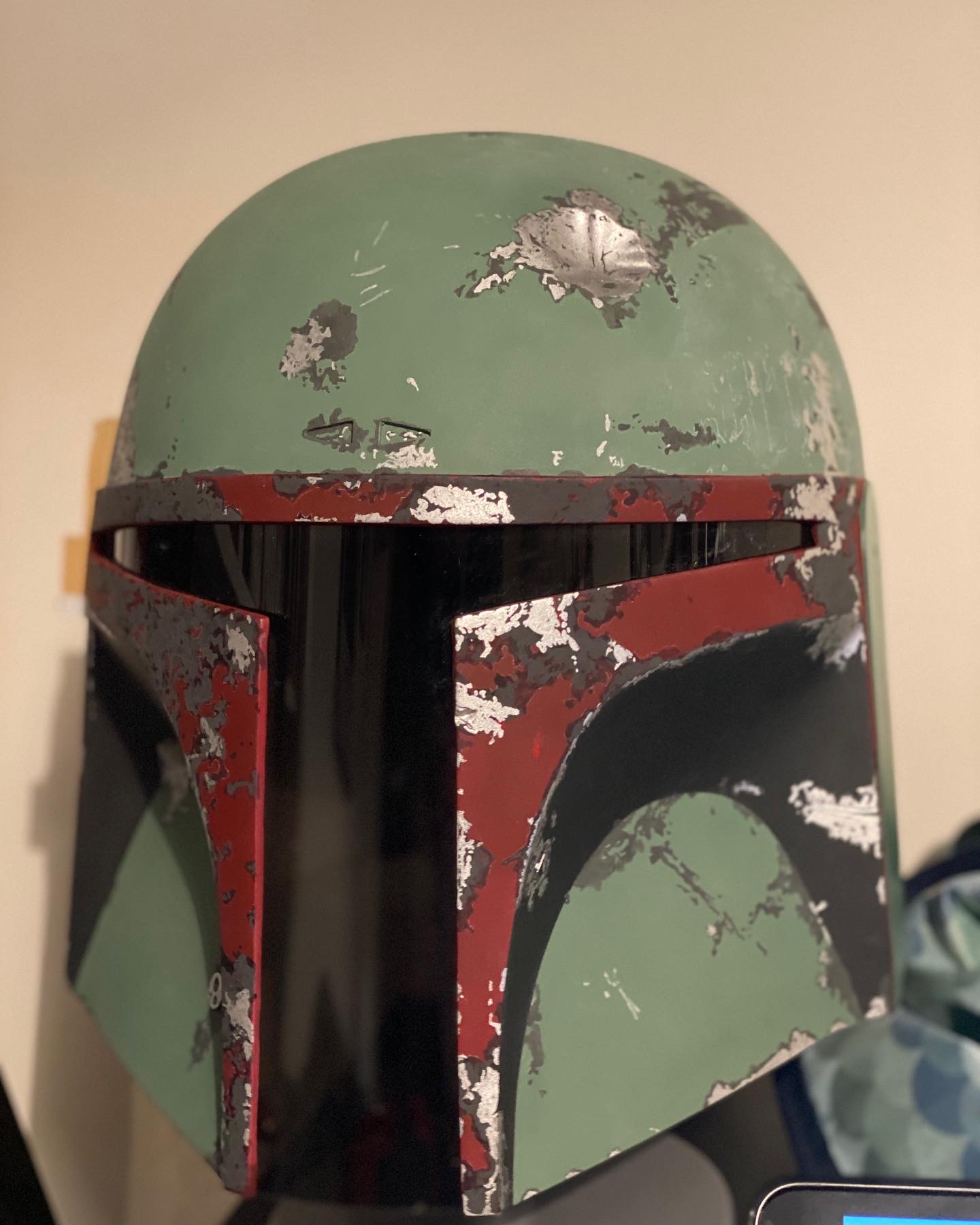

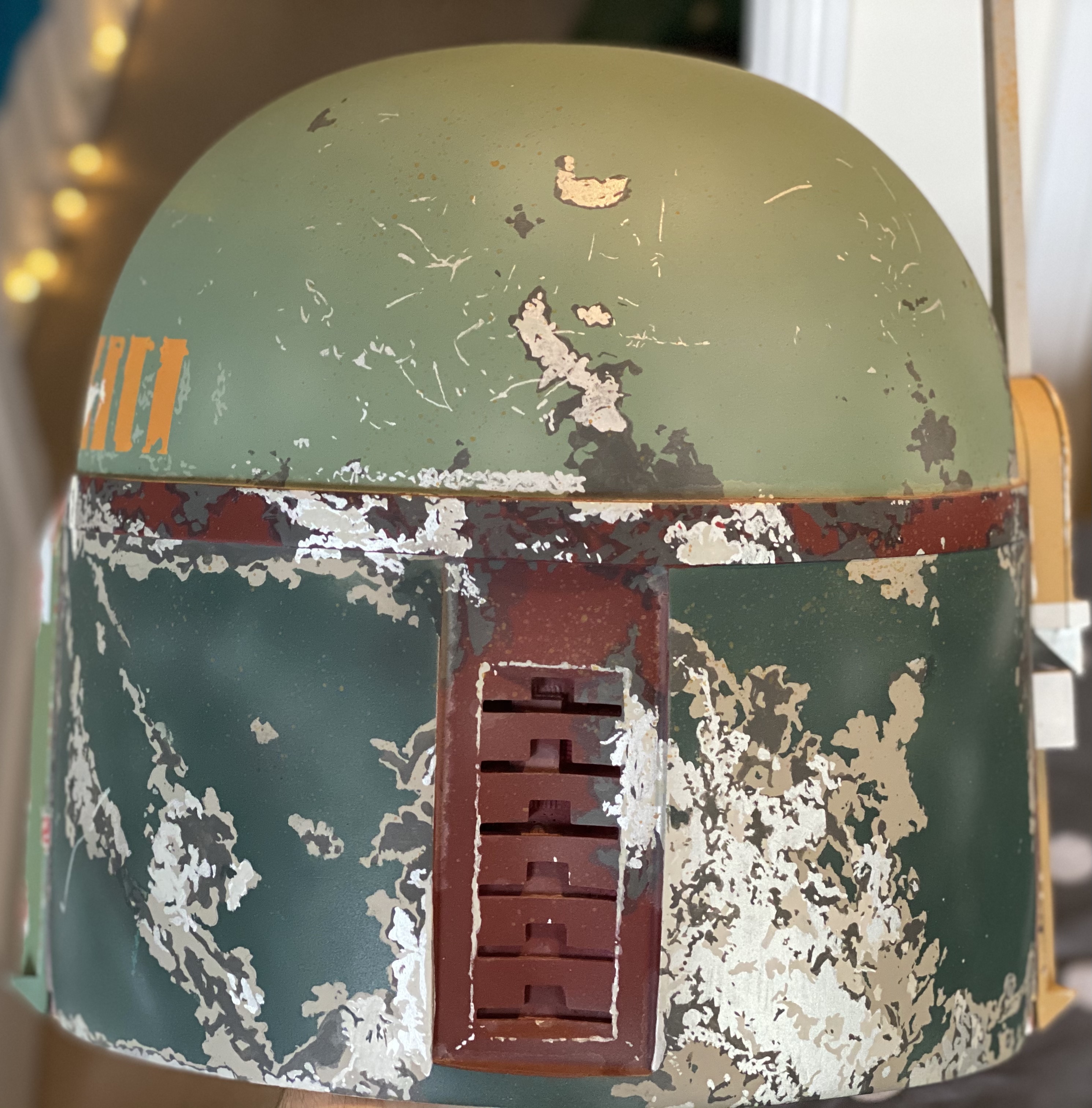

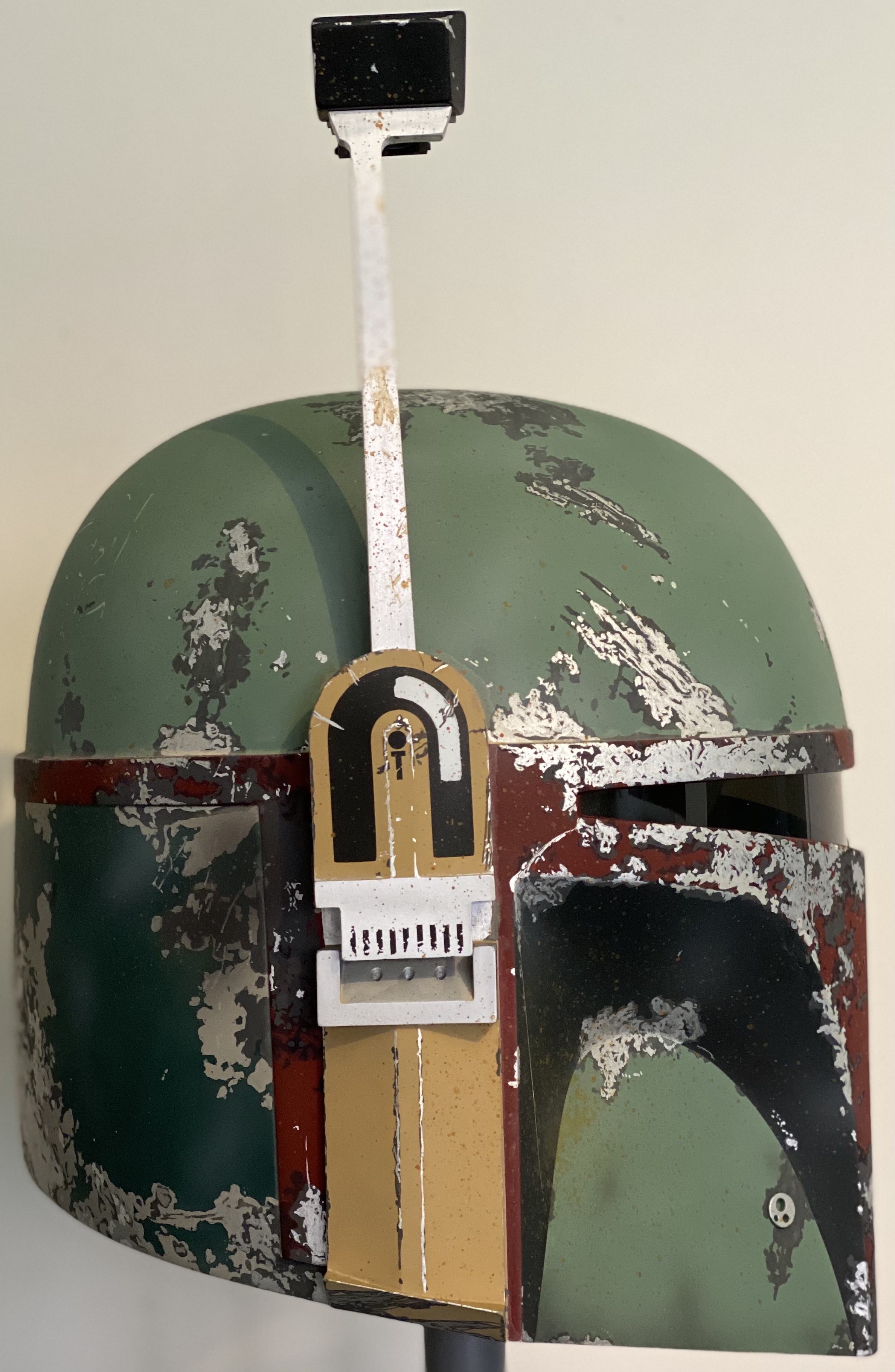

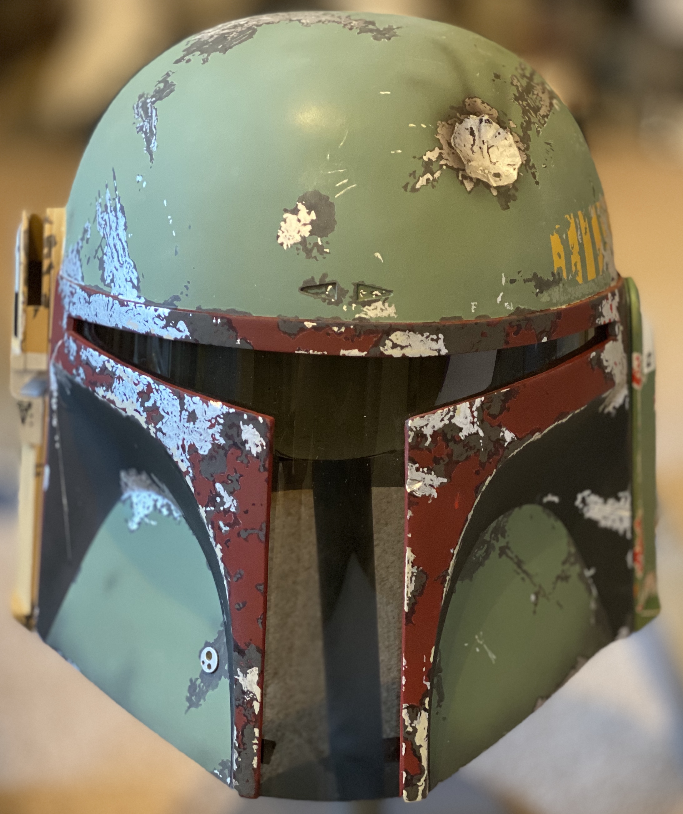

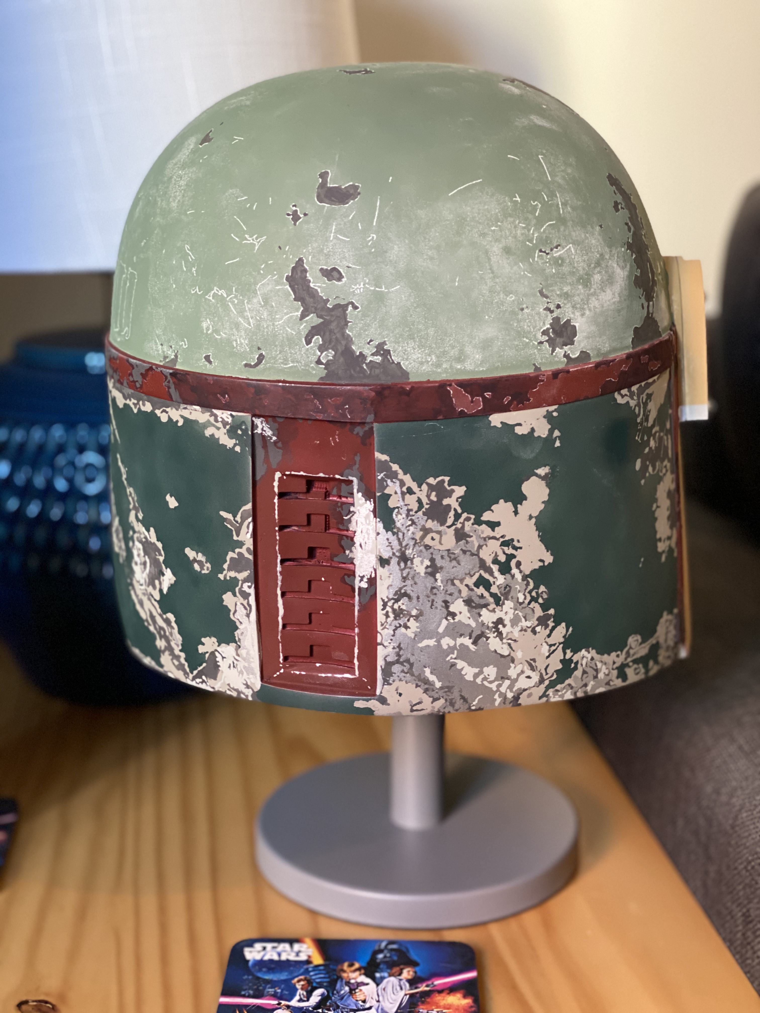

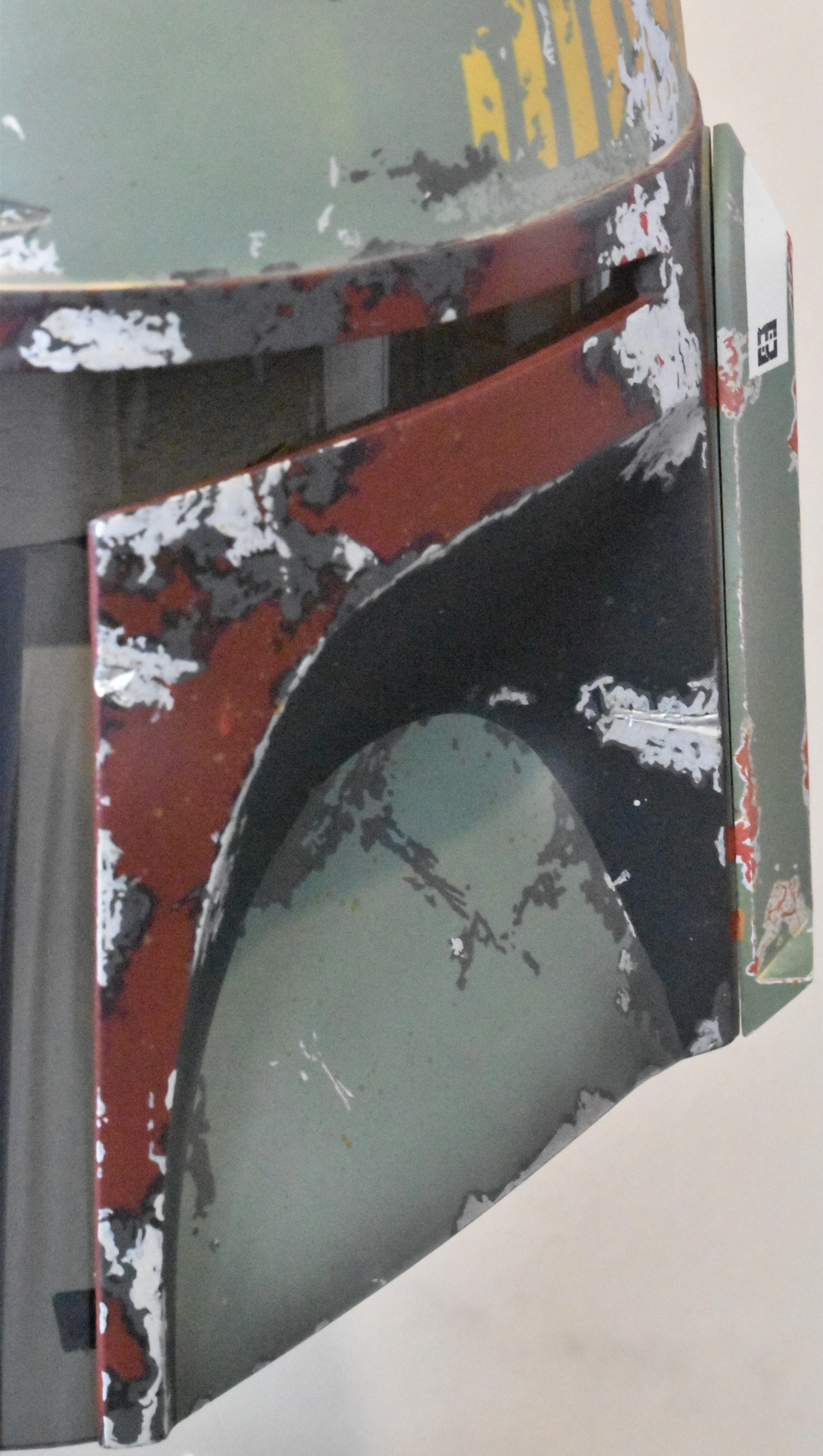

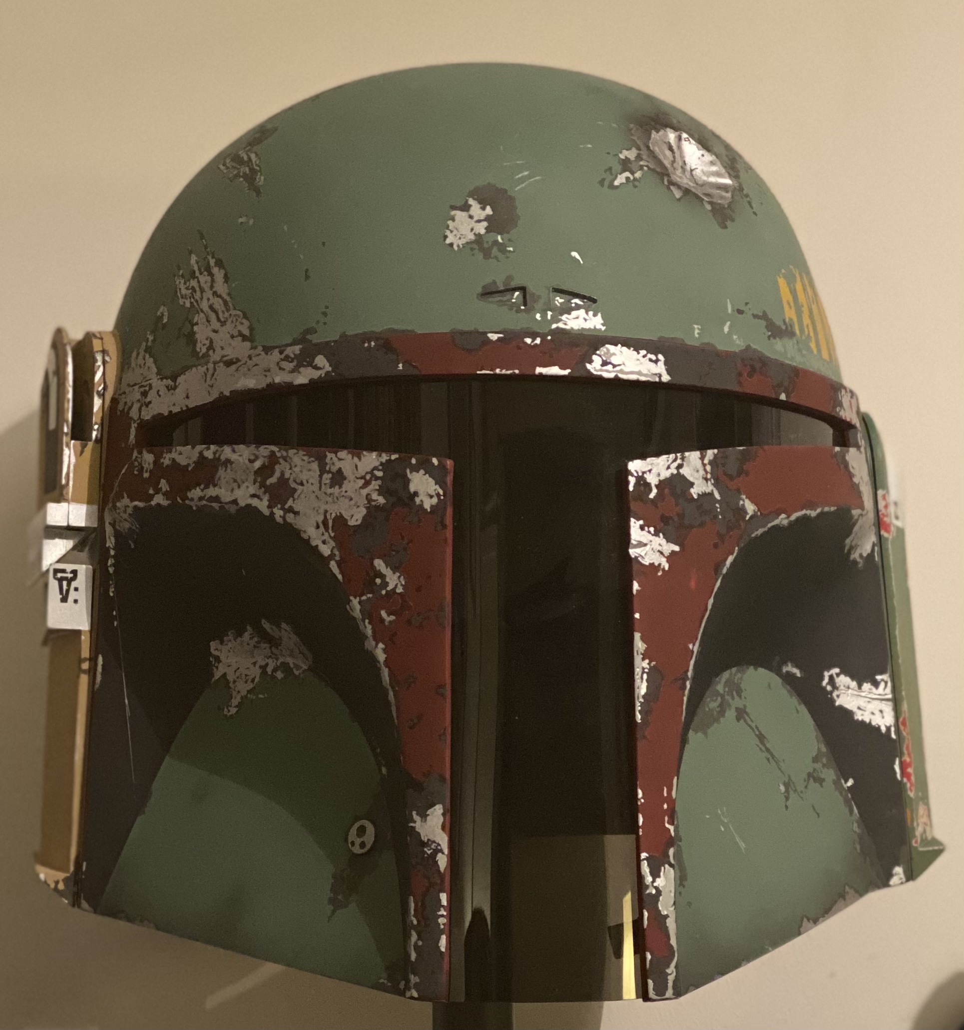

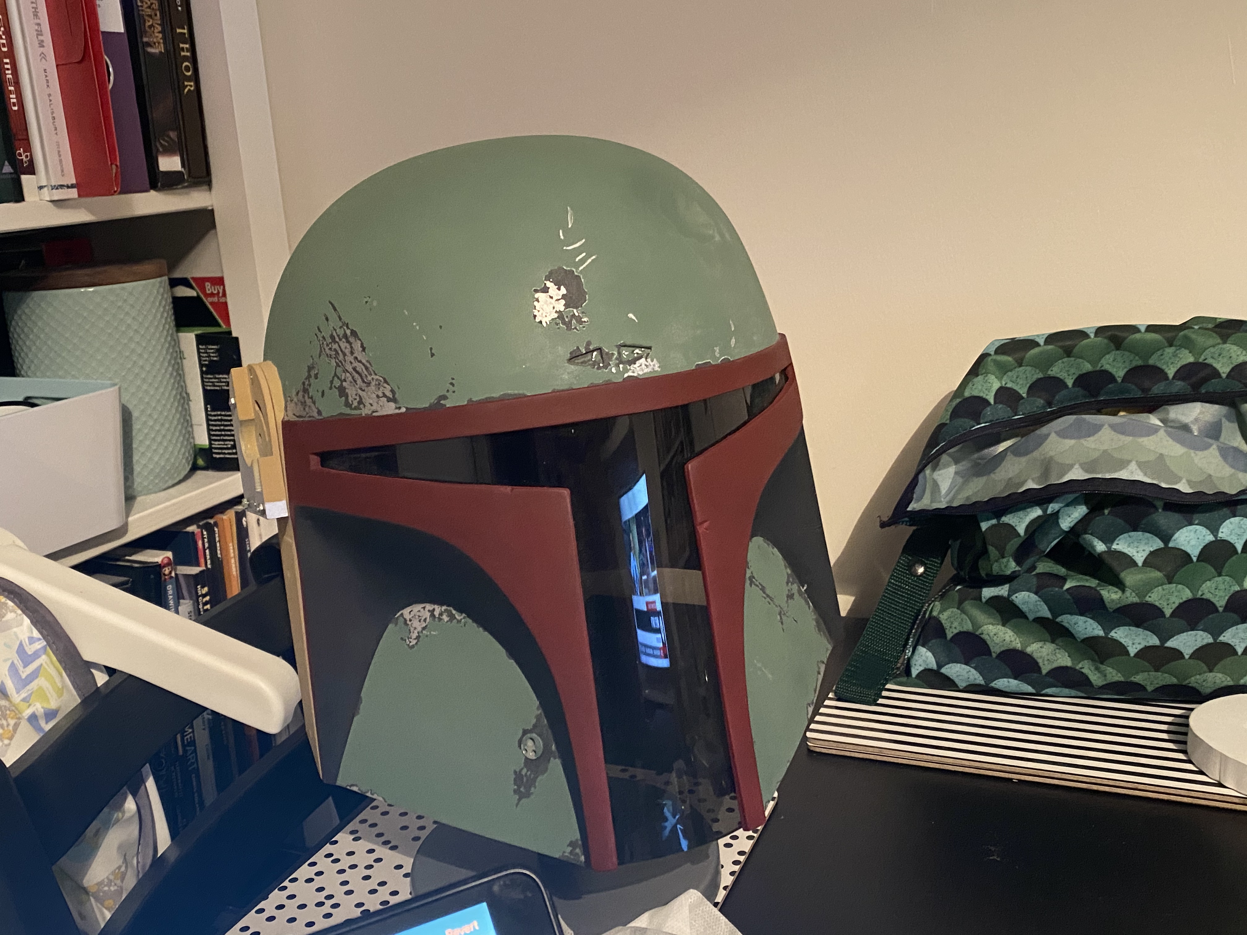

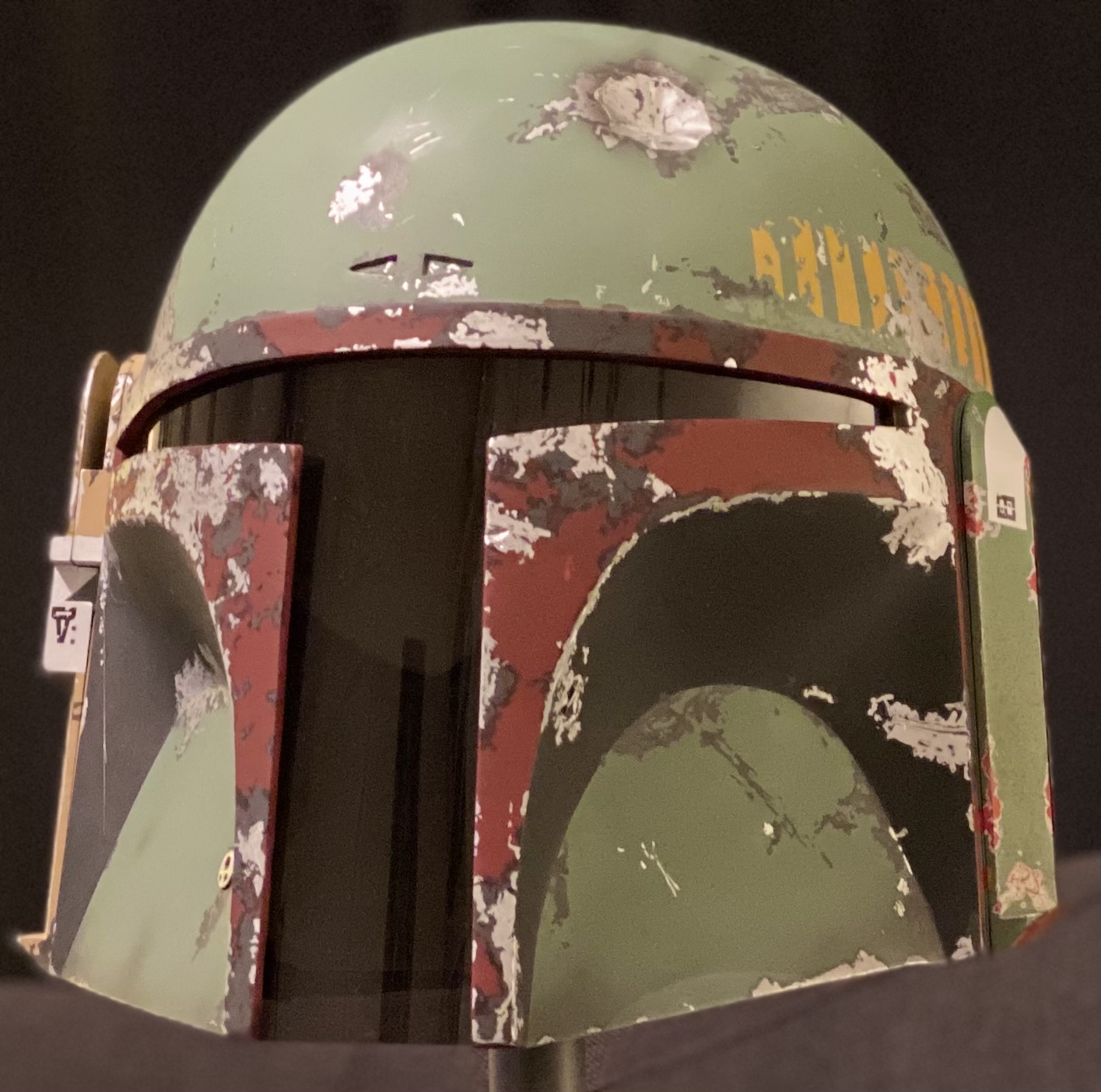

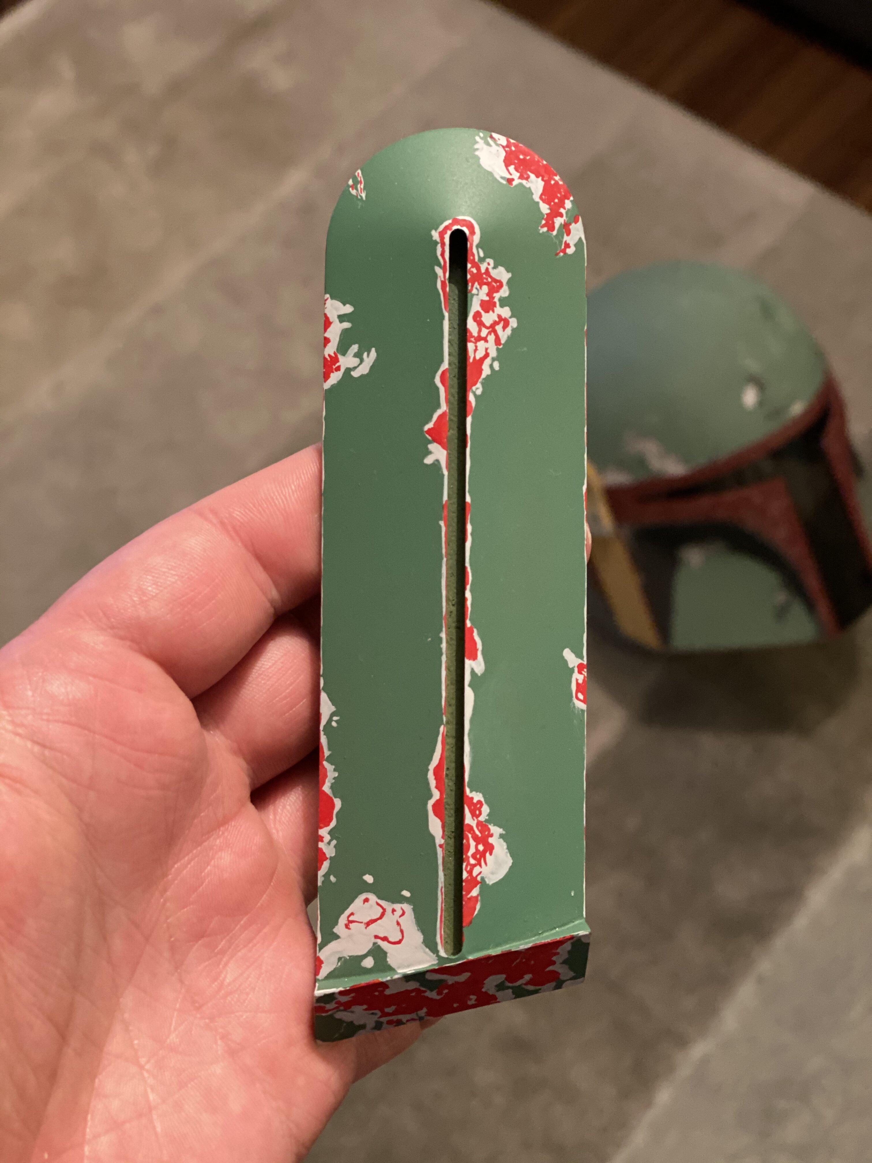

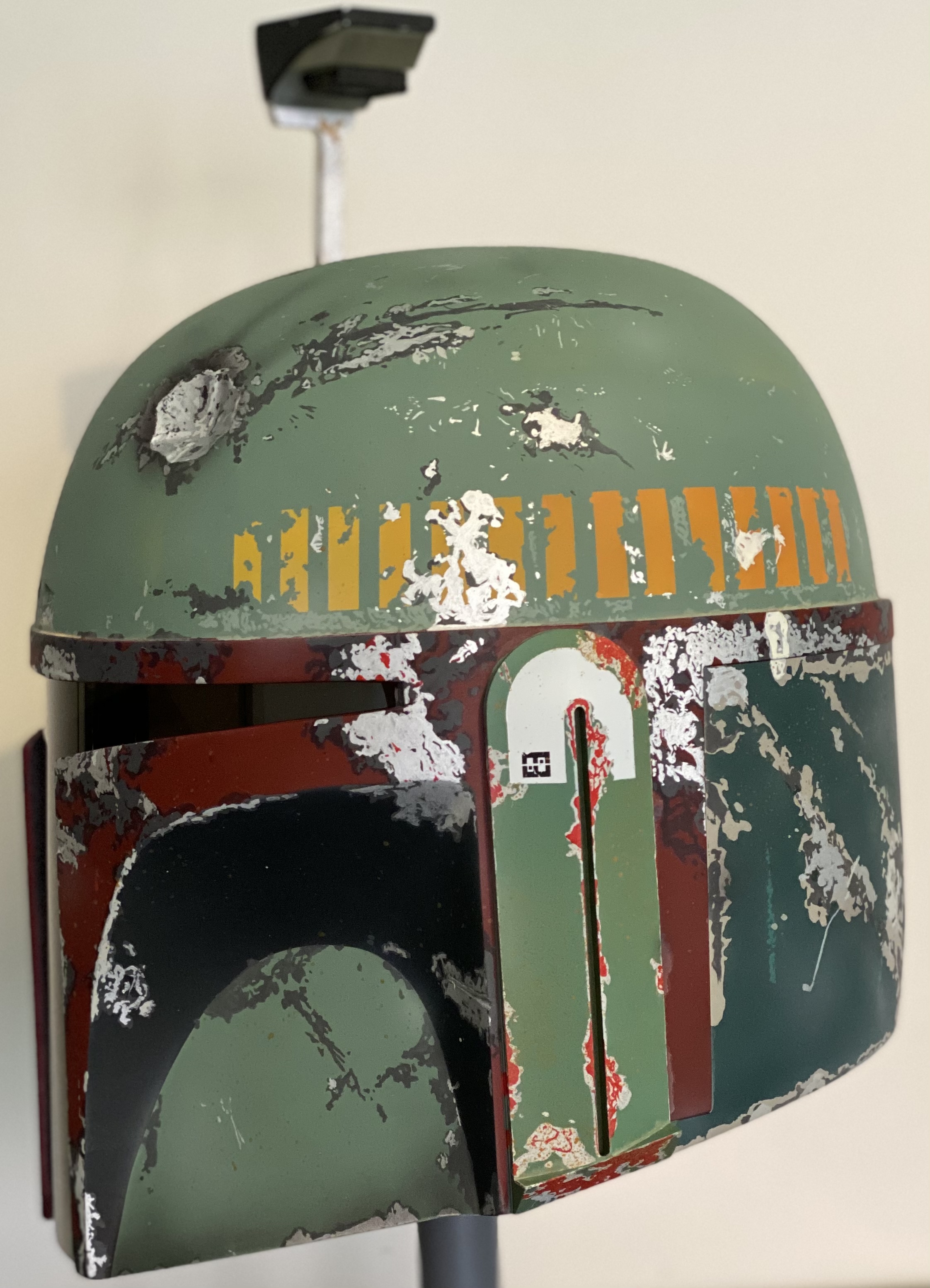

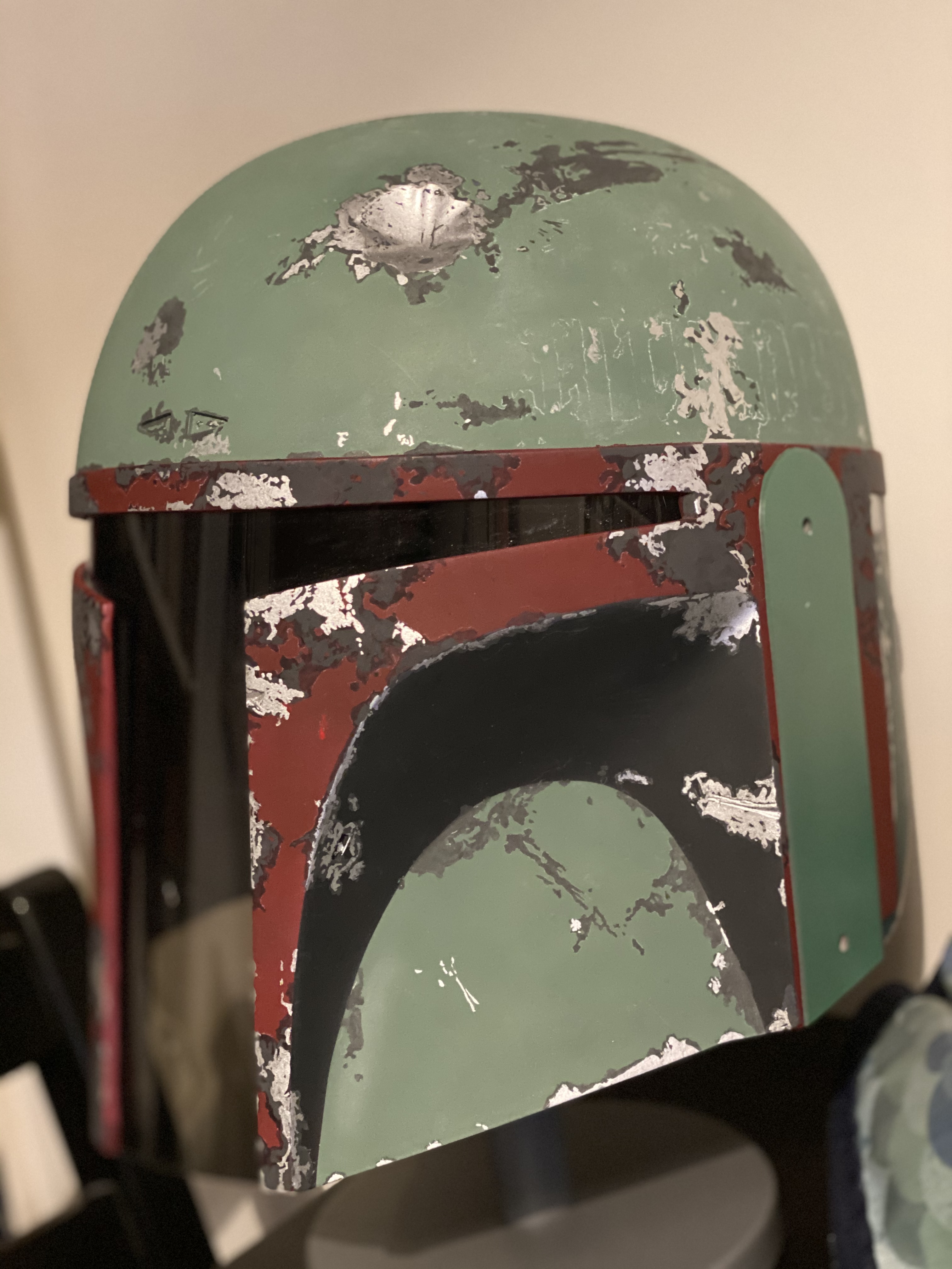

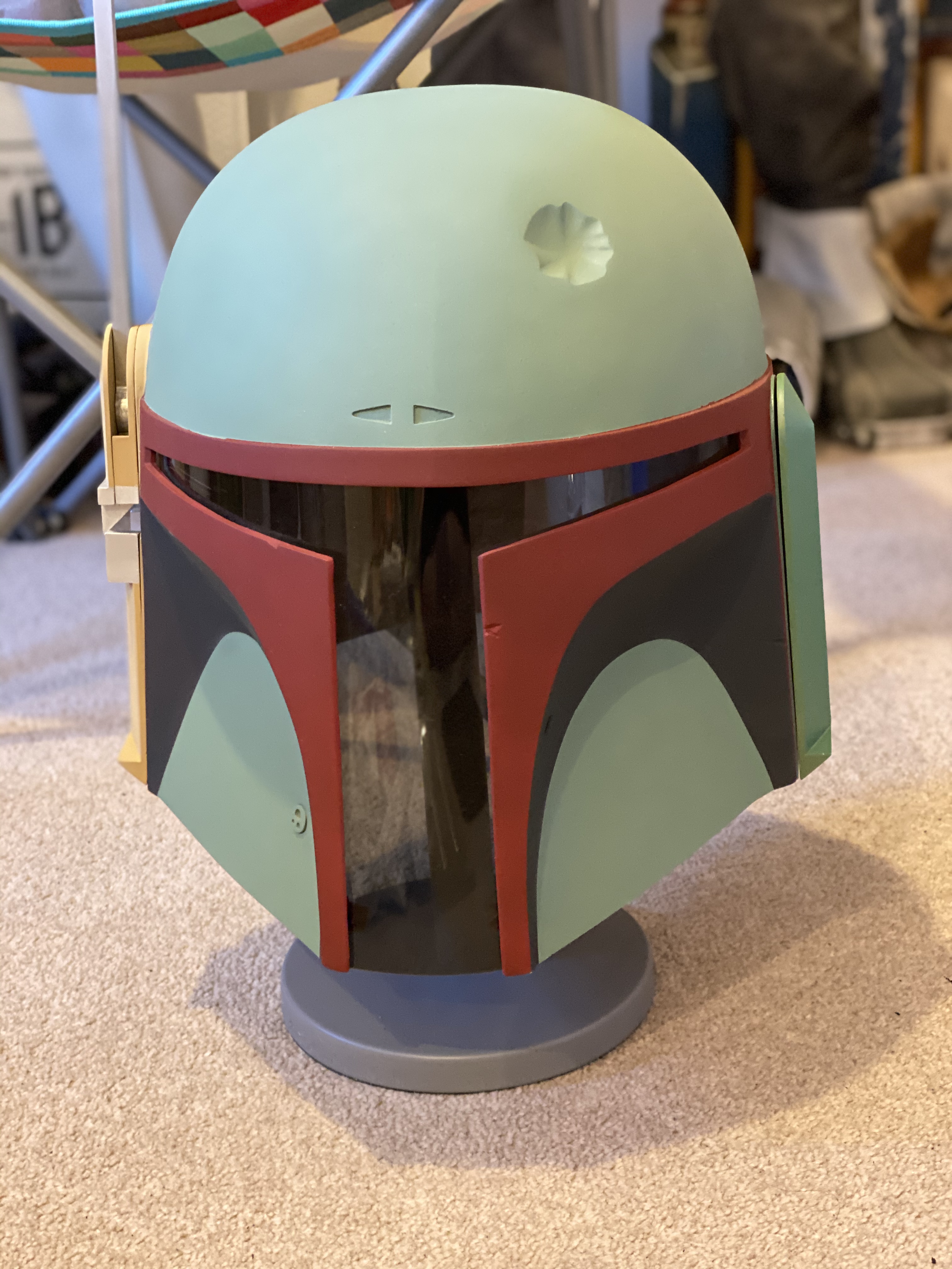

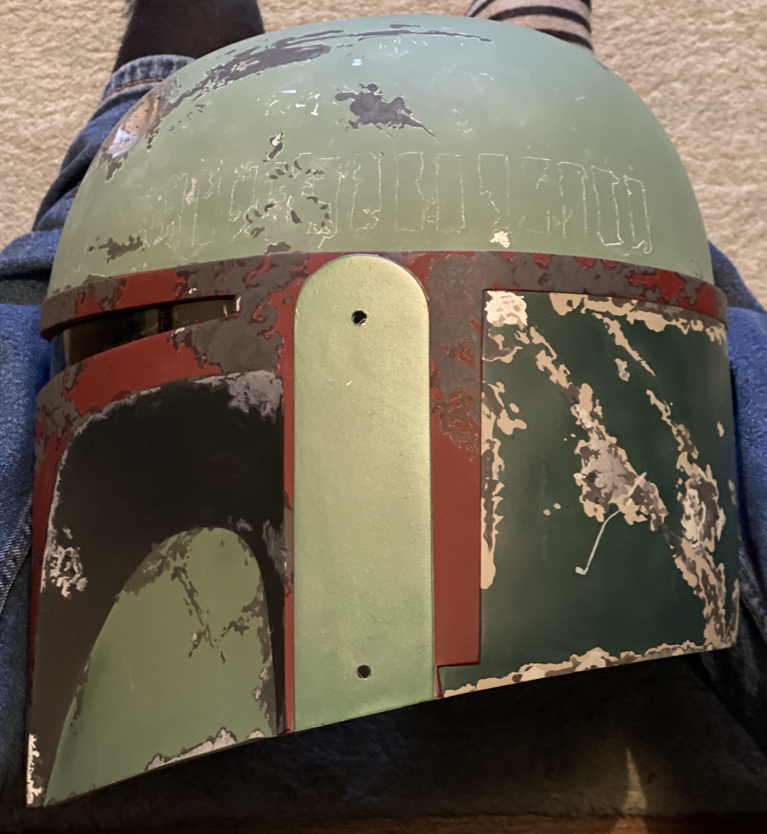

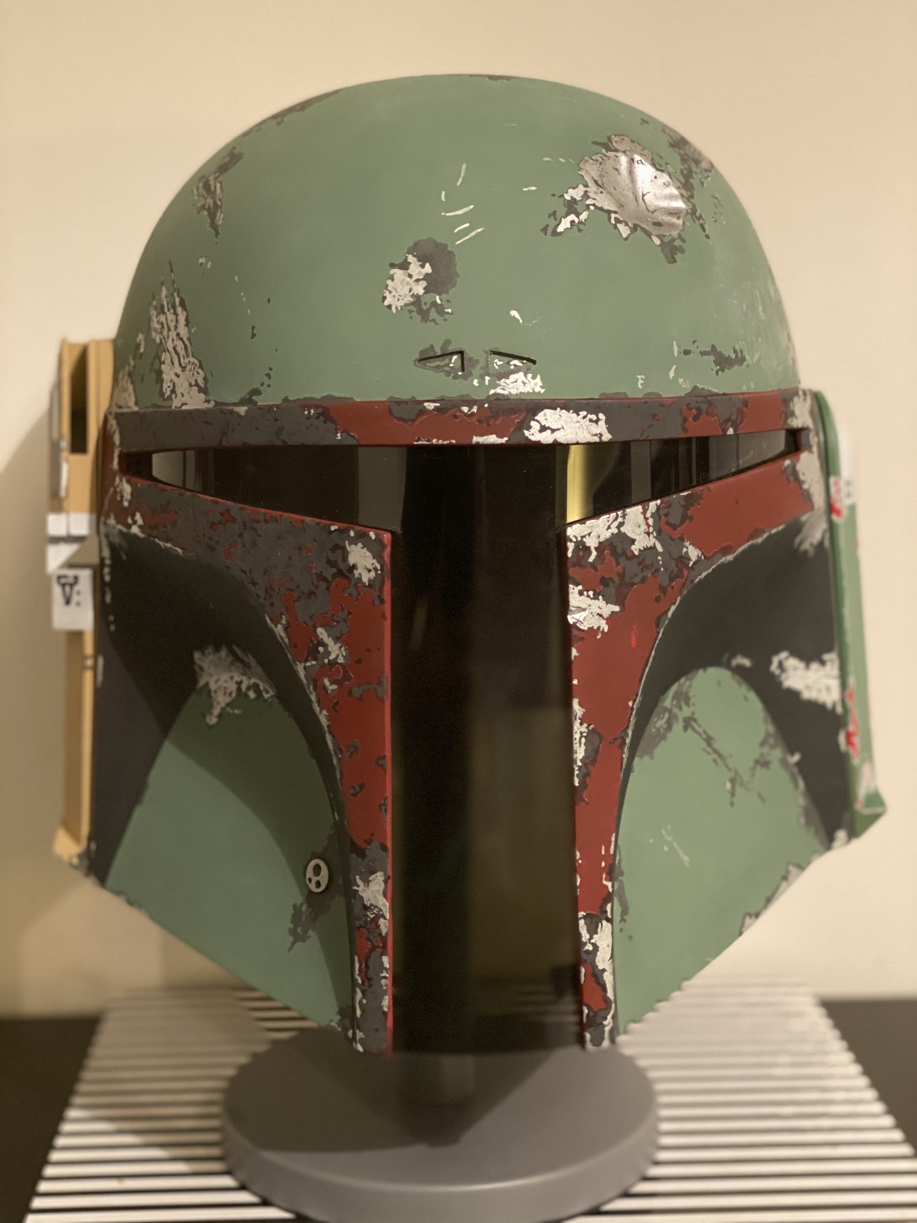

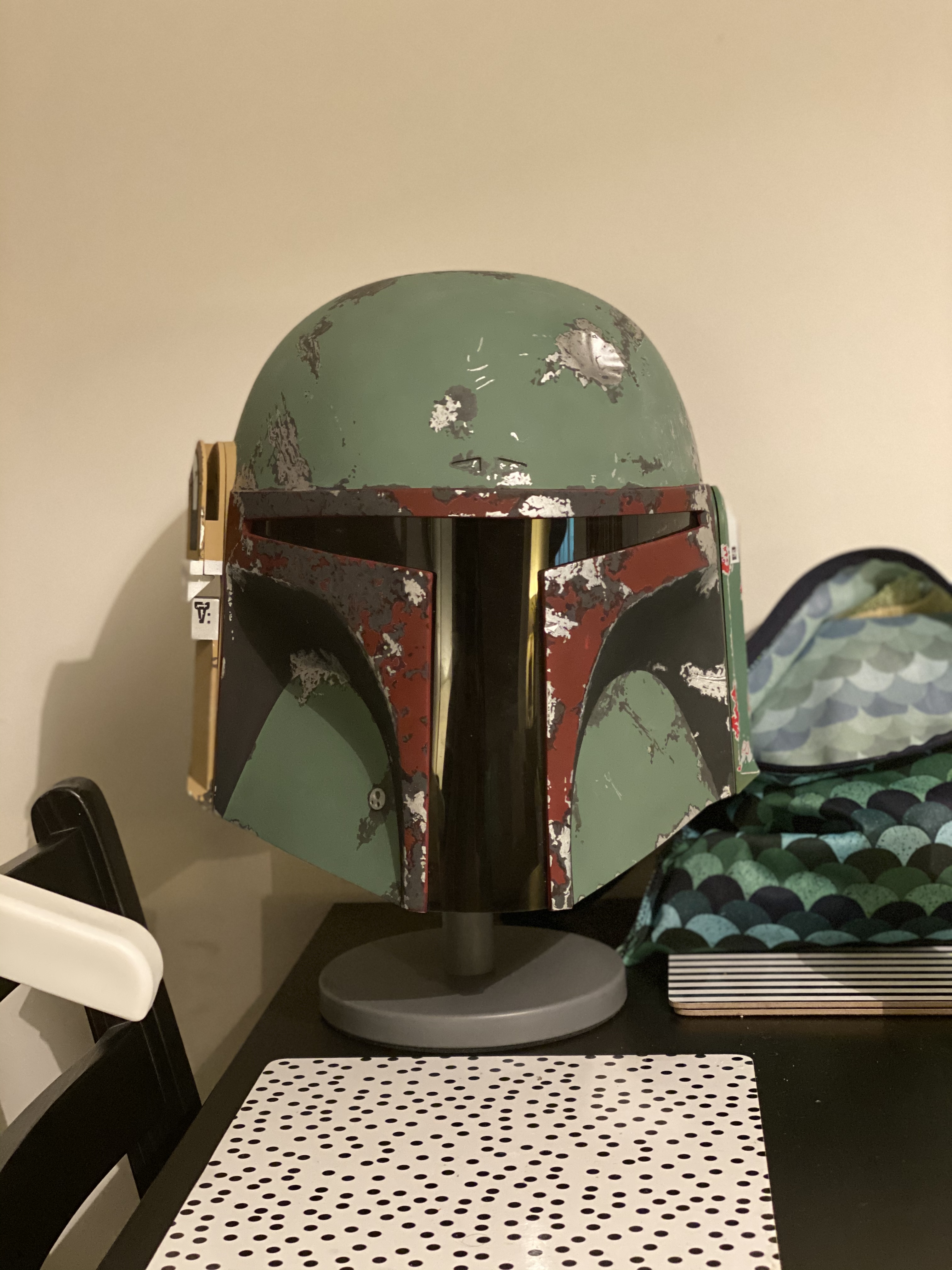

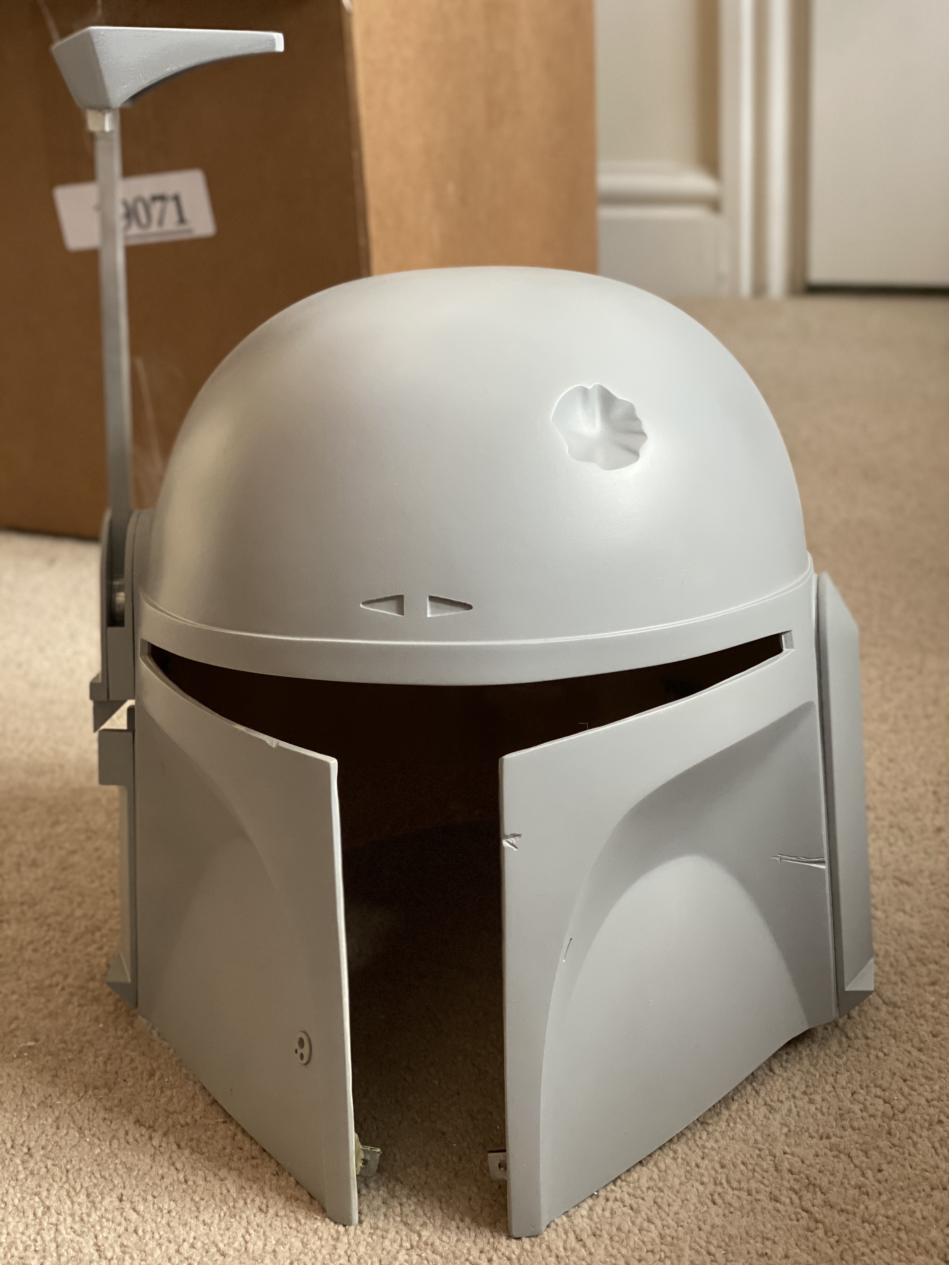

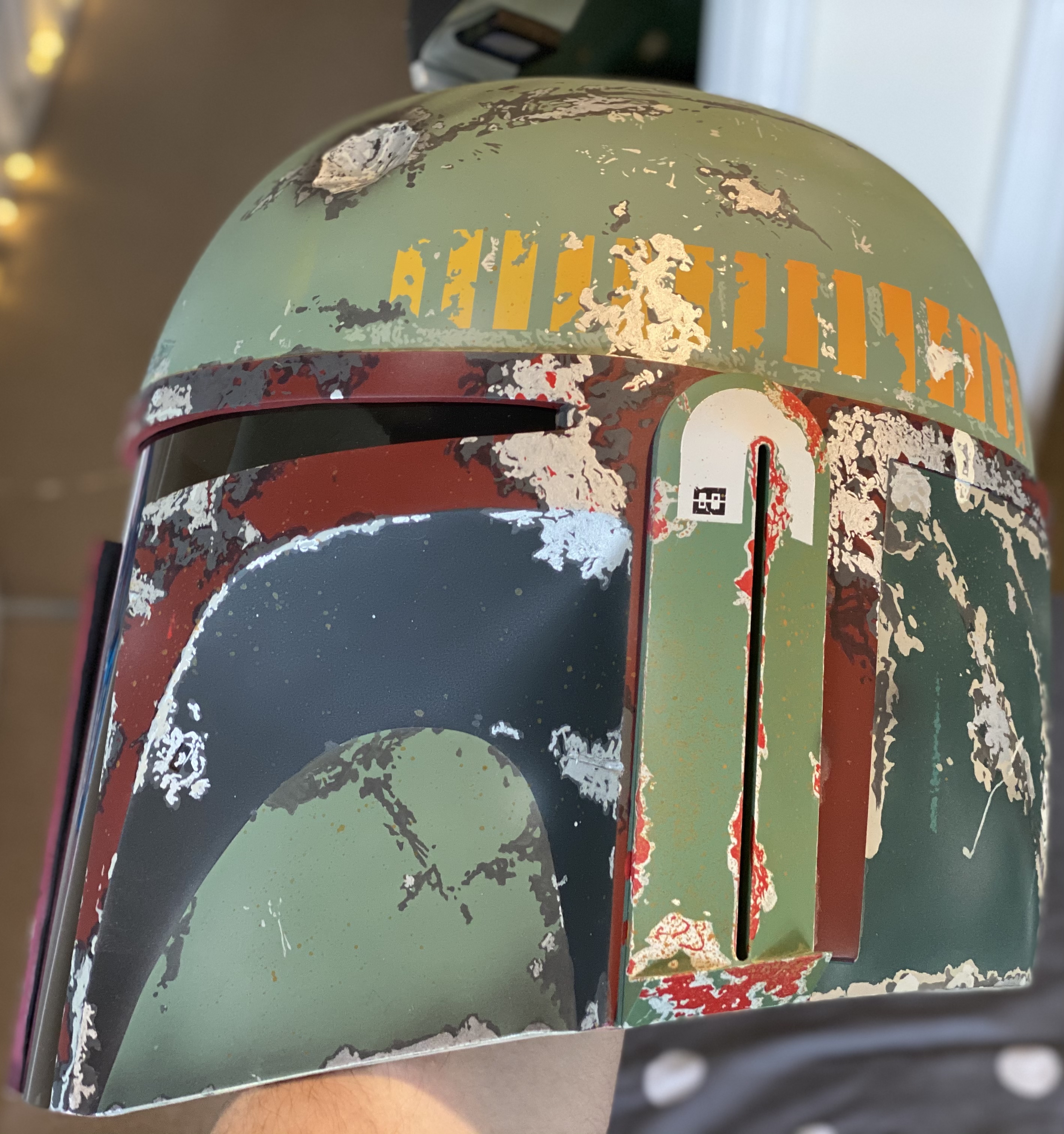

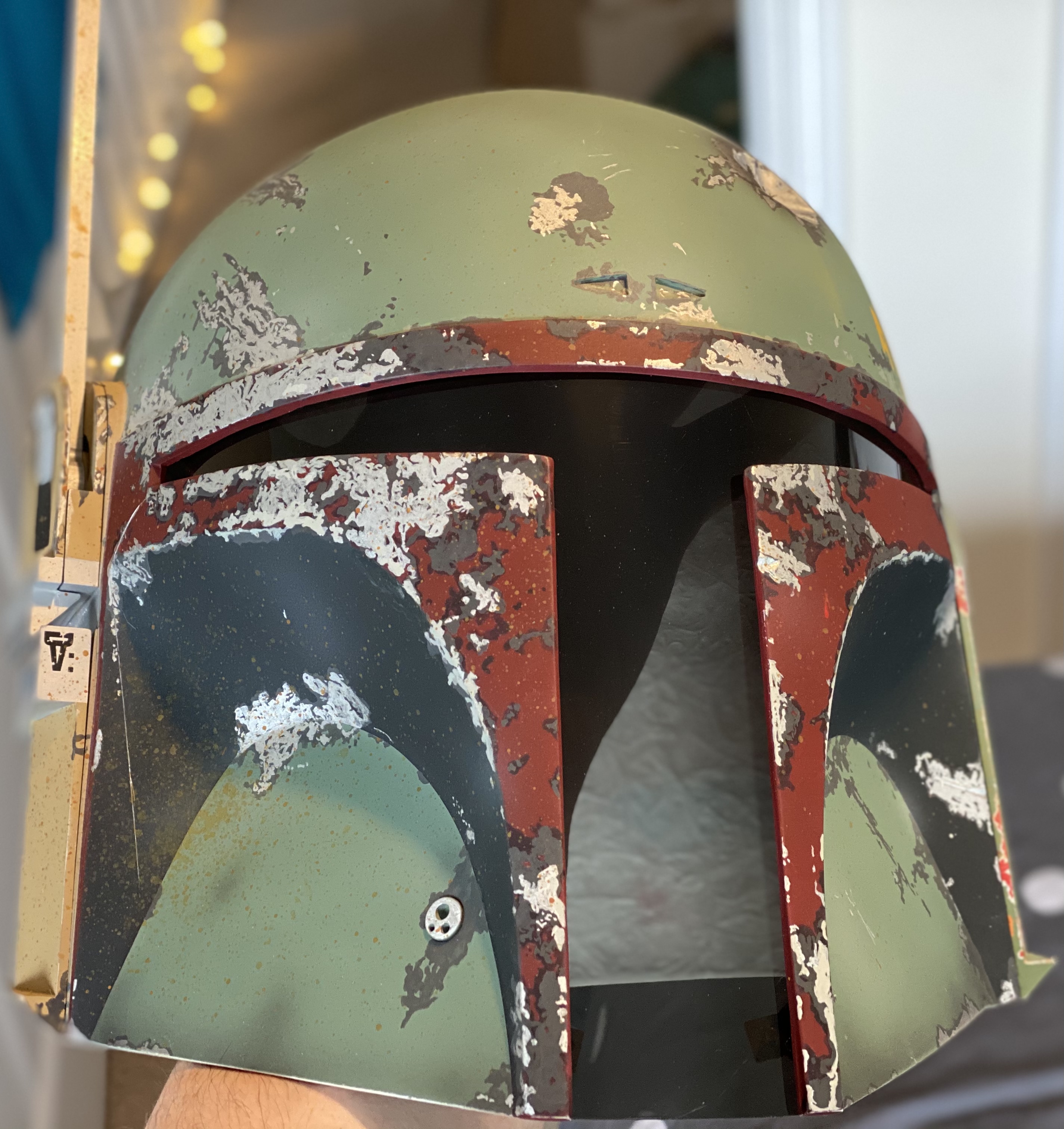

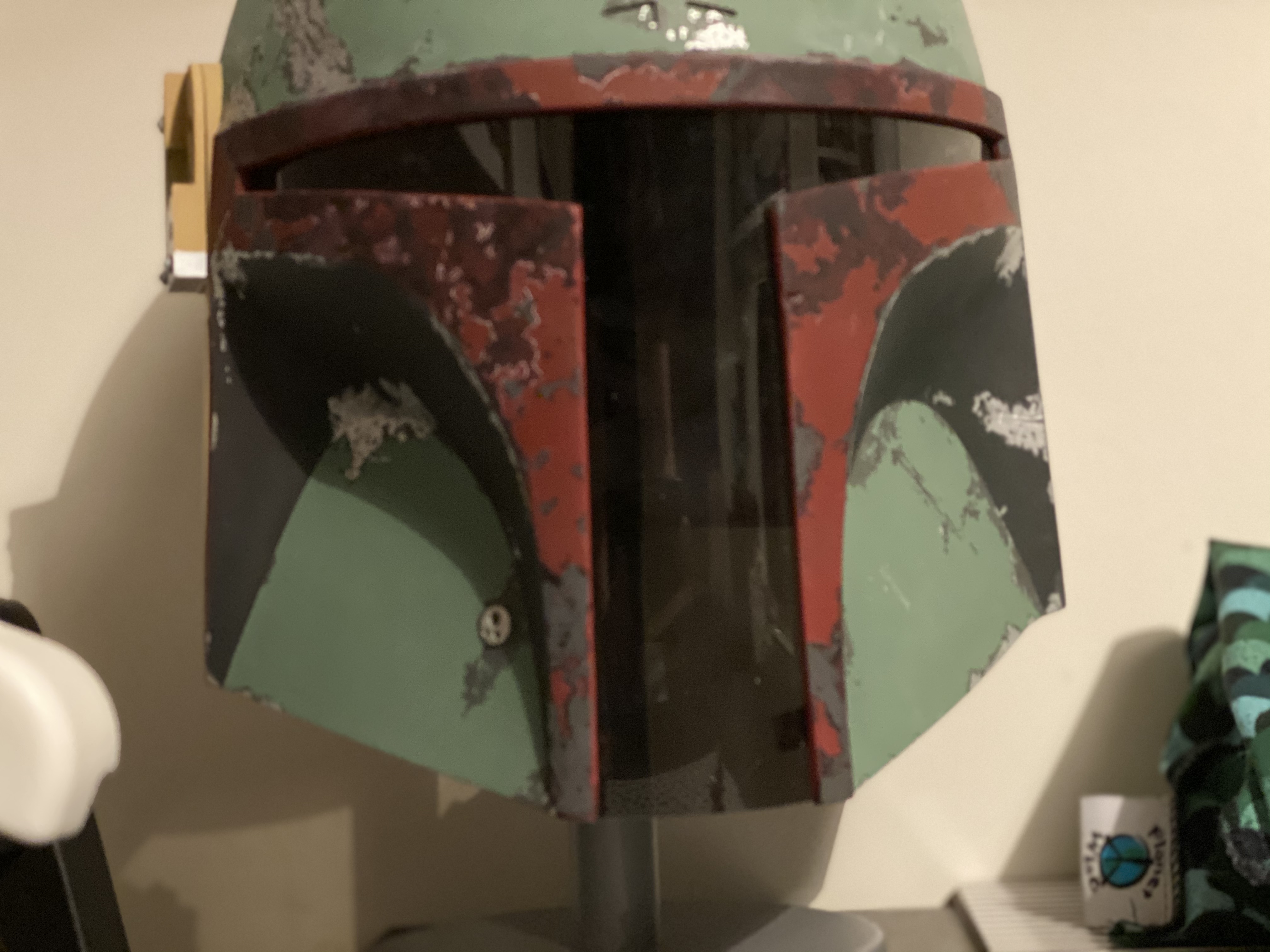

Started this paint up a while ago, but only picked up momentum recently. The ToEleven kit is fantastic. Arrived pristine with almost no clean up/filling required. Added visor clips from Sidewinder, these are very nice. Stencils and dry transfers were from Funkyred, both very easy to use.
Was intending to go full layered mode as I did on my ROTJ FPH2. I ended up just putting the main colours down with the airbrush and painted the rest with a traditional brush.
Still have a little left to do on it. I’m liking it so far. I’ll add more pics as I wrap it up.

It’s looking great! Can you go into any detail about how you layered/mixed your colours? Specifically the green on the dome and cheeks, and the right earpiece.
Not much mixing involved.
Dome and lower cheeks Light Green and Grime 50:50ish, tape pull was same but with more Grime. SP Dark Lark for main grey and greenish grey parts SP Lettering Grey
Visor/Mandible/Keyslots D&H Caboose, SP Dark Lark, Maroon mixed 50:50 Engine Black. Greenish grey parts done with SP Lettering Grey.
Upper Cheeks were painted D&H Caboose first then Grimy Black. Grey is SP Dark Lark.
Right Ear Earth Lt, SP Dark Lark, Engine Black and Tamiya White Primer.
Left Ear Coach Green first, then Light Green. Lighter grey is ANH DS Surface Grey and Red is Caboose. Spatter is Rust. White for decal/graphic is Tamiya primer.
Killstripes SP Armour Yellow with gradient to mixture of SP Armour Yellow and Rust.
Rear panels main green is Engine Black and Dark Green 50:50. Then Dark Grime, SP Dark Lark and SP Lettering Grey for greenish grey parts.

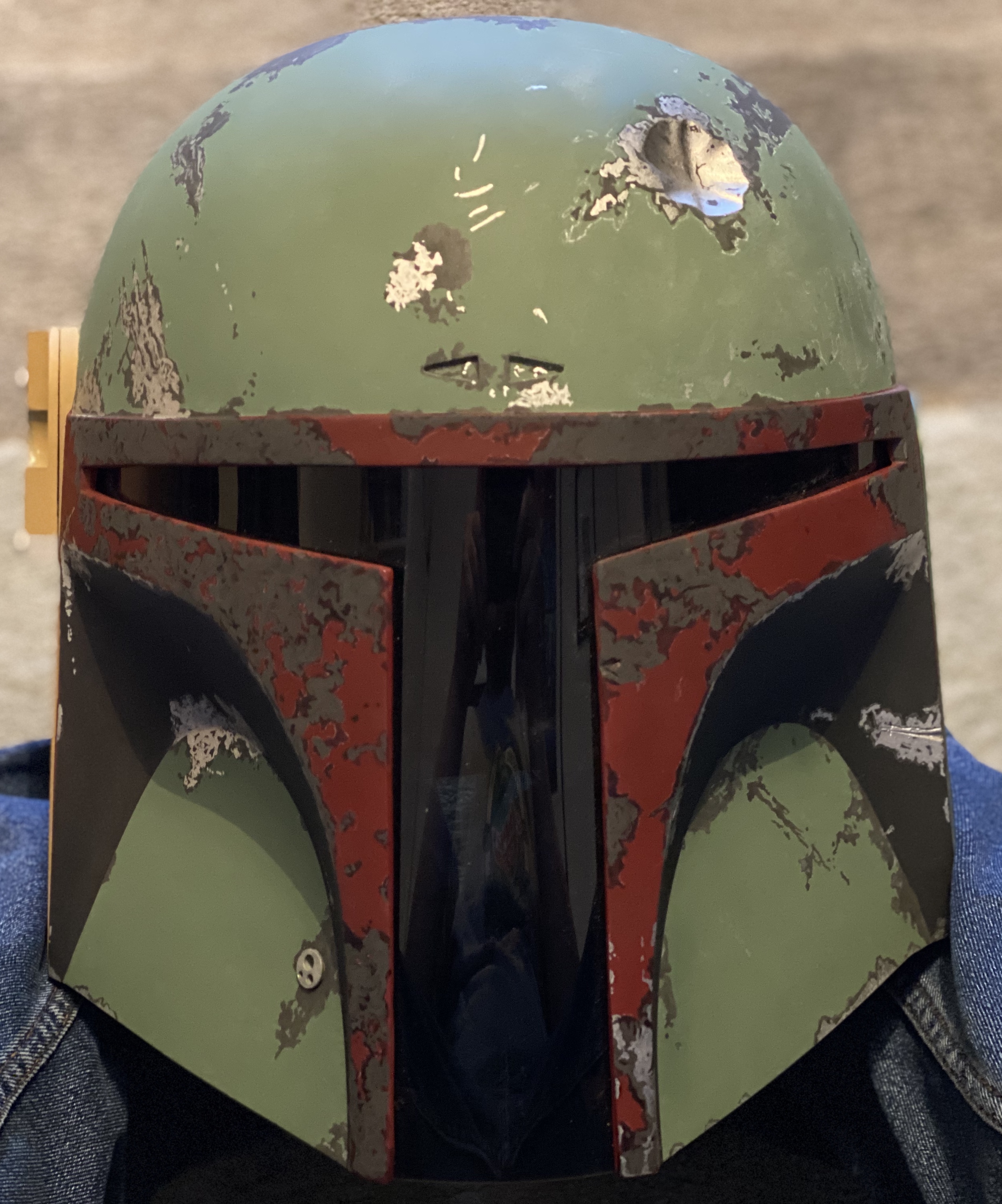

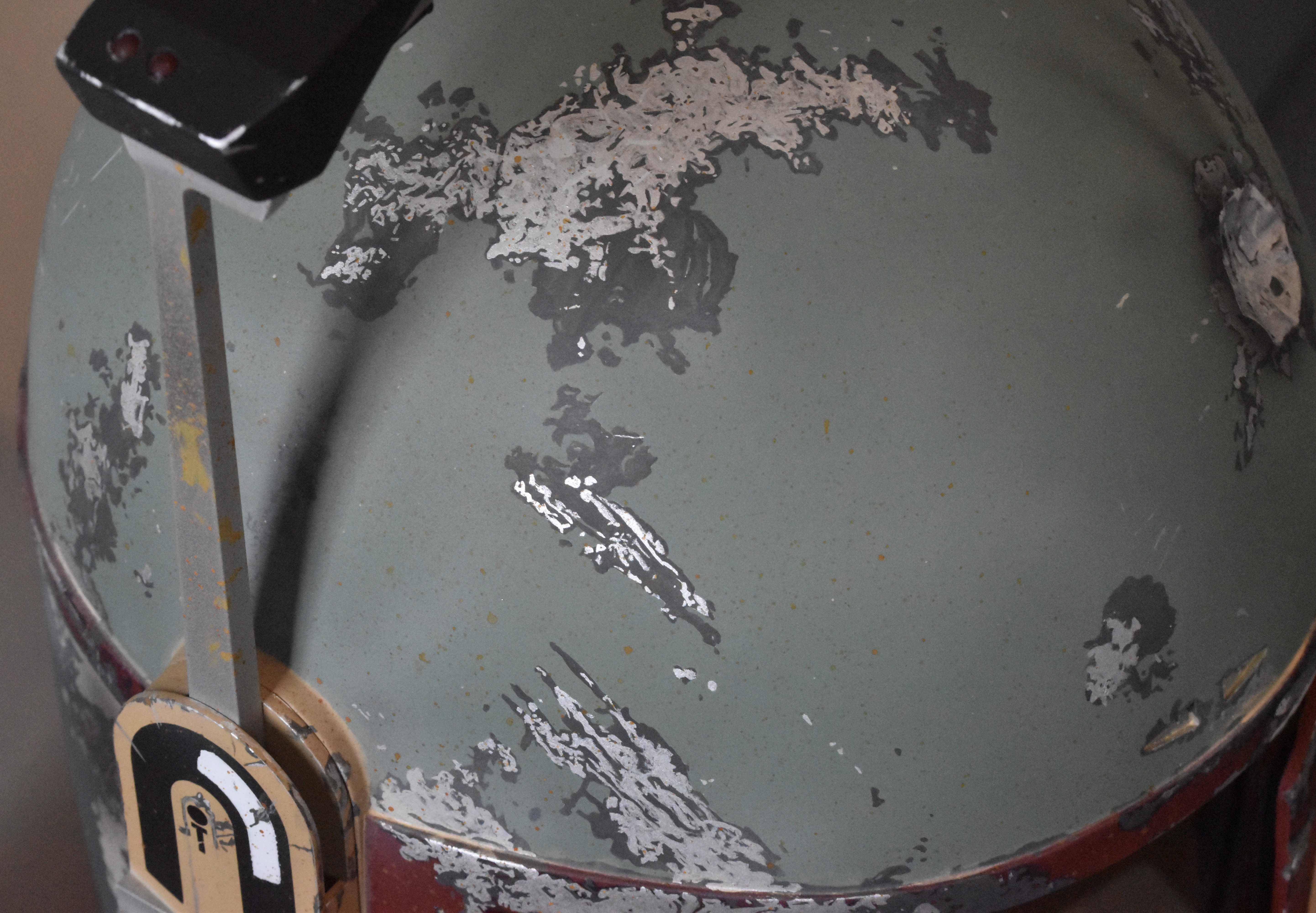

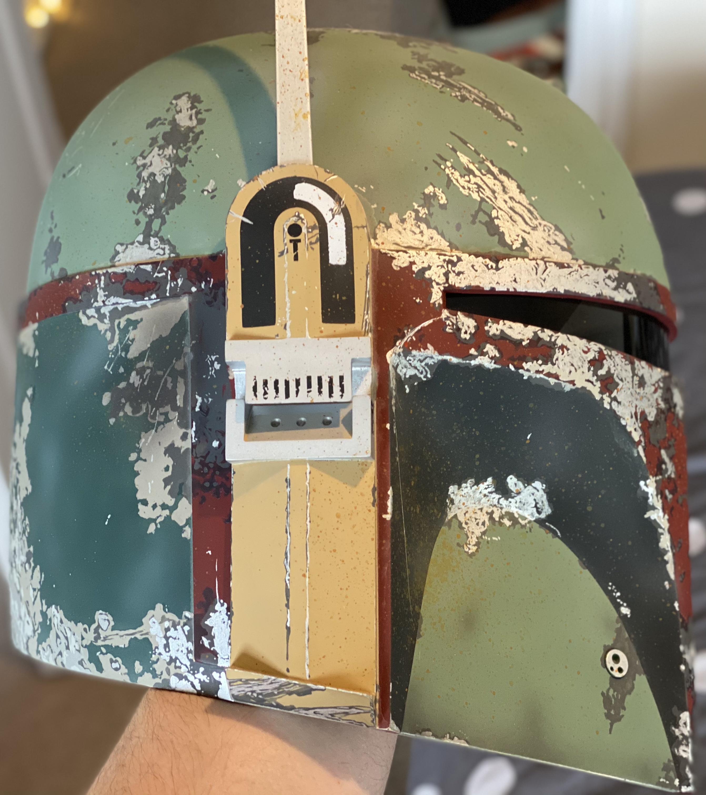

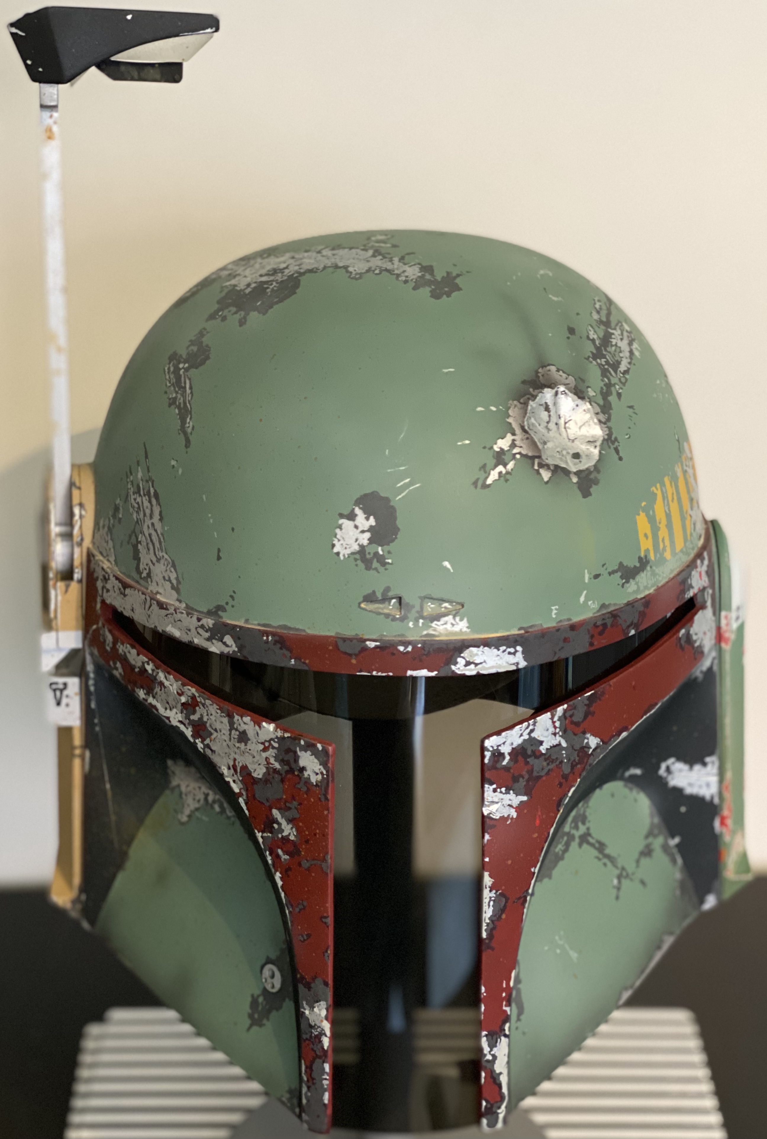

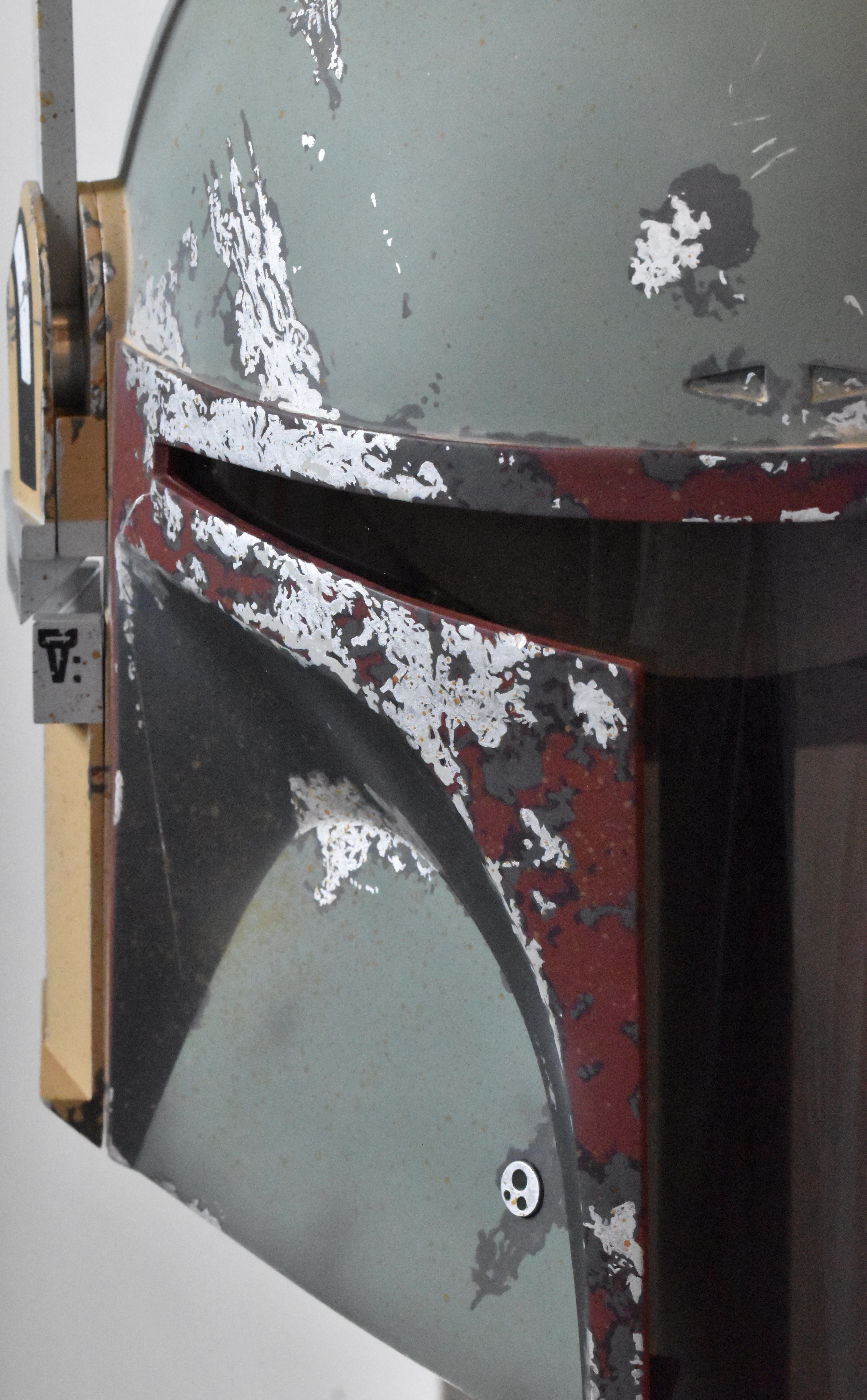

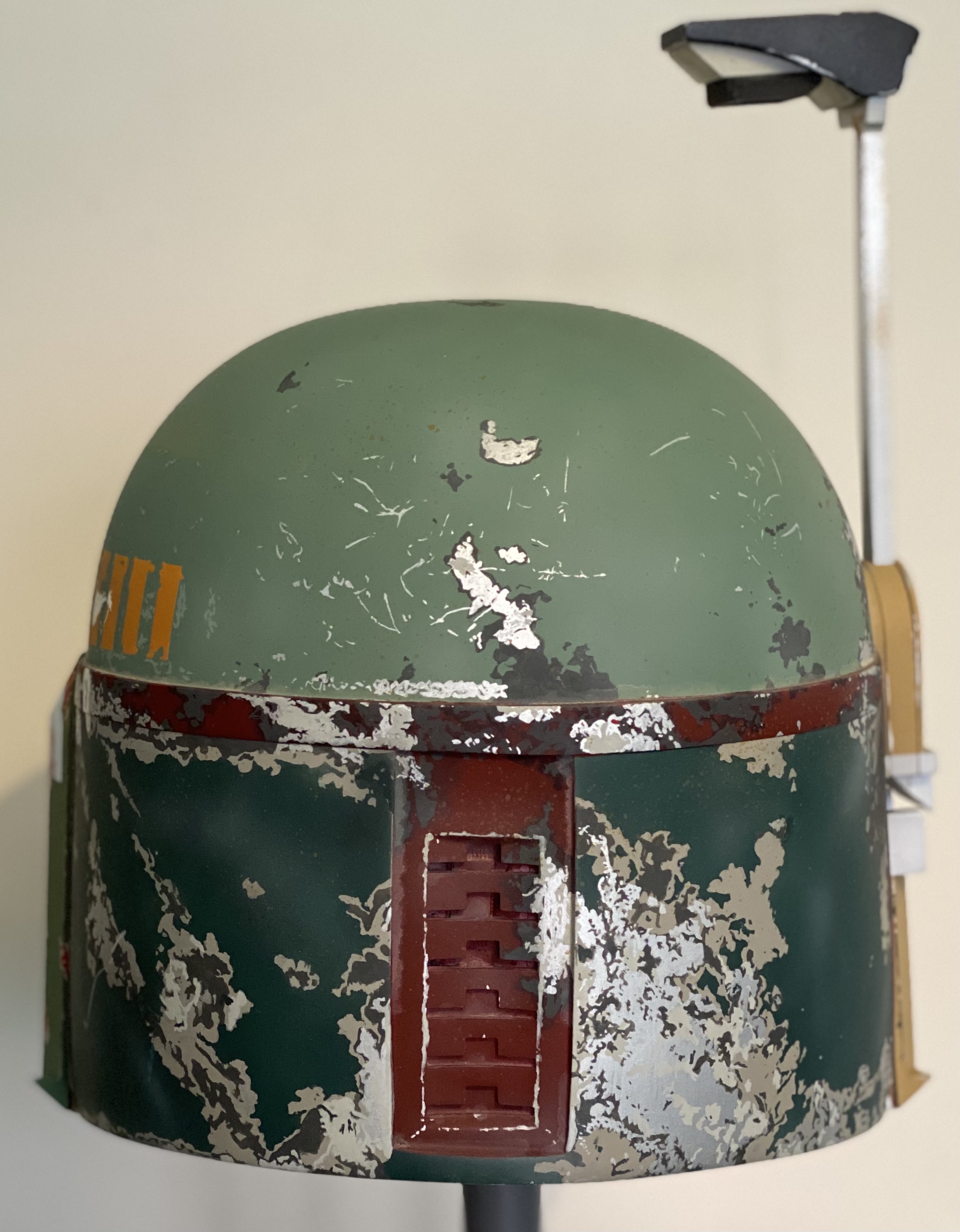

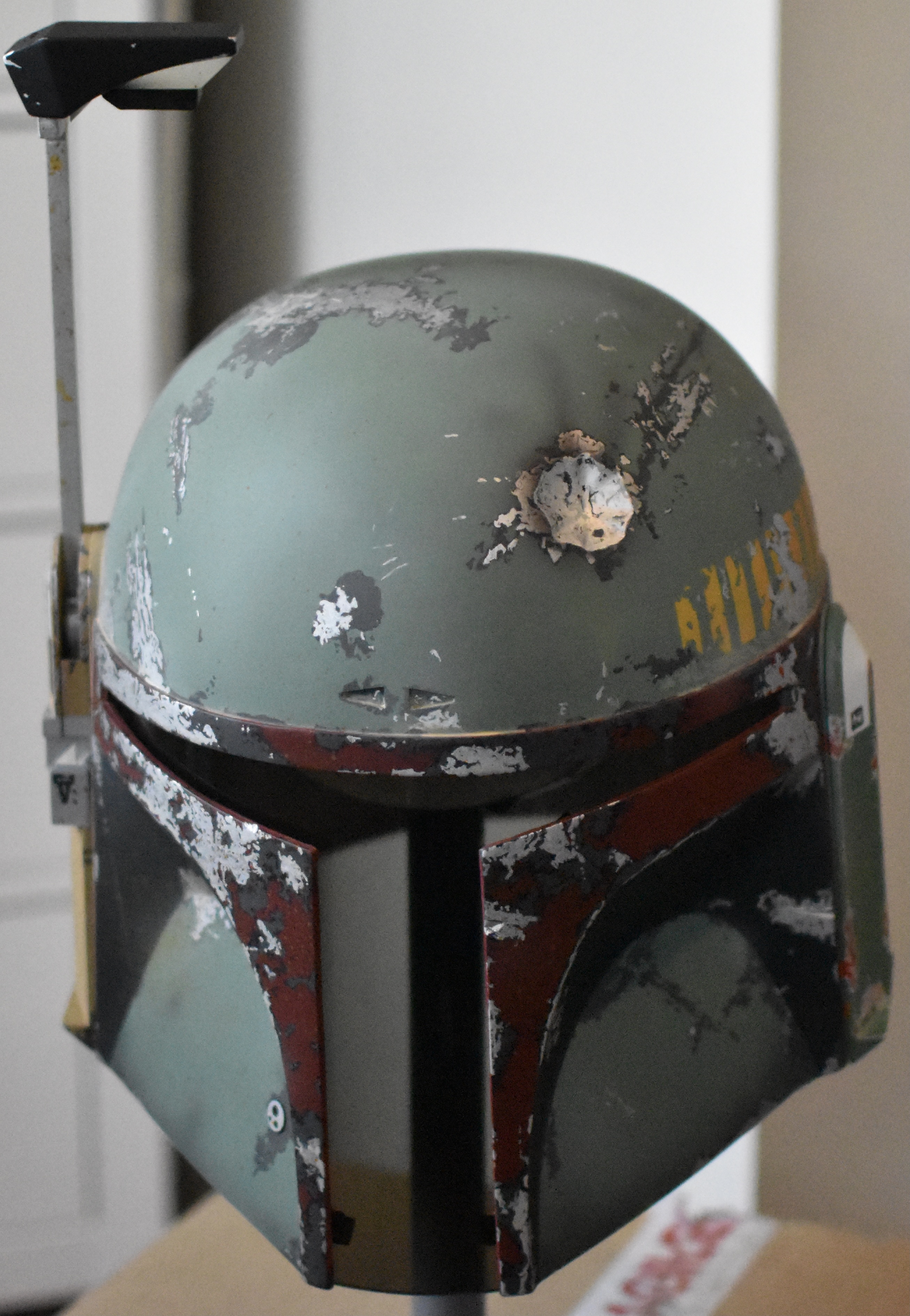

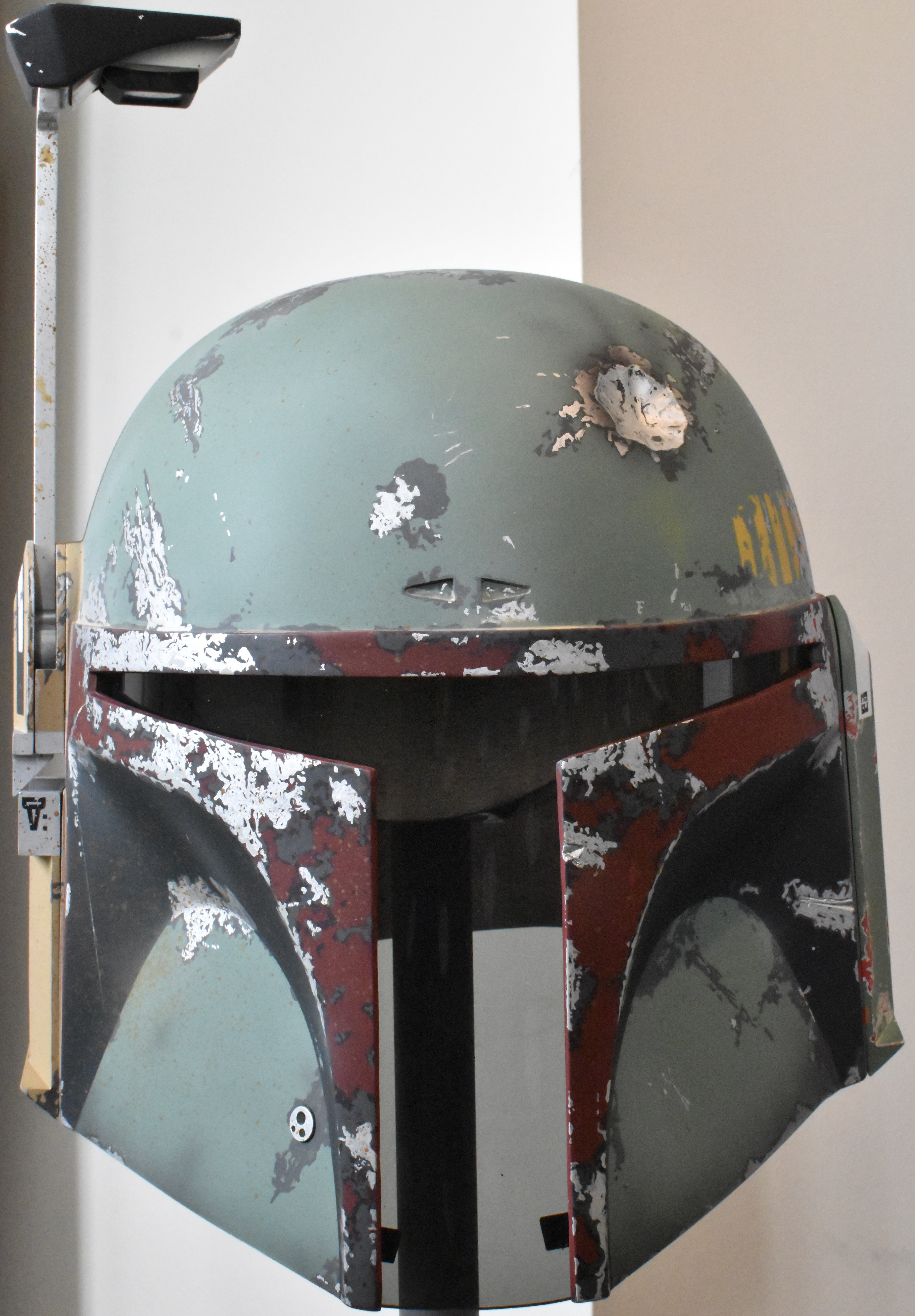

All done. DSLR makes it look grey in natural light. The iPhone makes it look very green. In reality it’s smack bang in the middle.
This will be up for sale in The Cargo Hold.
