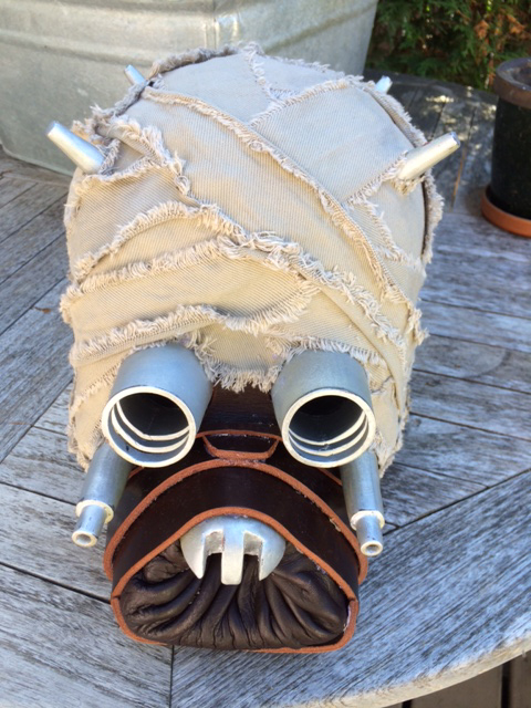

I used a khaki coloured fabric for the head bandages. I tore and washed the strips leaving them to hang dry over night. This gave the strips a natural weathered look.
The strips of fabric were applied using hot glue and were systematically applied in a random type fashion - make sense?
Next the head needed to be weathered and the colour needed to shift towards a darker more olive tone seen in Star Wars Episode 4. I lightly sprayed the finished head with black spray paint before applying chalk pastel. I layered a mix of earth green, charcoal and Terra Cotta. I then smudged the chalk into the fabric grain. I may seal the head with a matte fixative spray but will have to test it first. I don't want any type of sheen on the surface.
Here is the finished product.

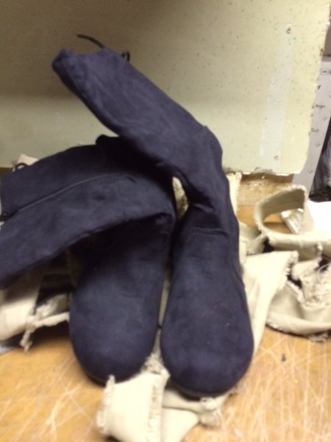

I purchased a cheap pair of girl's boots for the costume as I wanted something long and that fit snug around the leg. The boots were then treated and weathered in the same fashion as the head. I hot glued the strips around the boot - leaving the sole bare, and weathered with the same colour combination of chalk pastel.
photo 1-2.JPGphoto 2-2.JPGphoto 3-2.JPGphoto 4-1.JPGphoto 5-1.JPGphoto 3.JPG

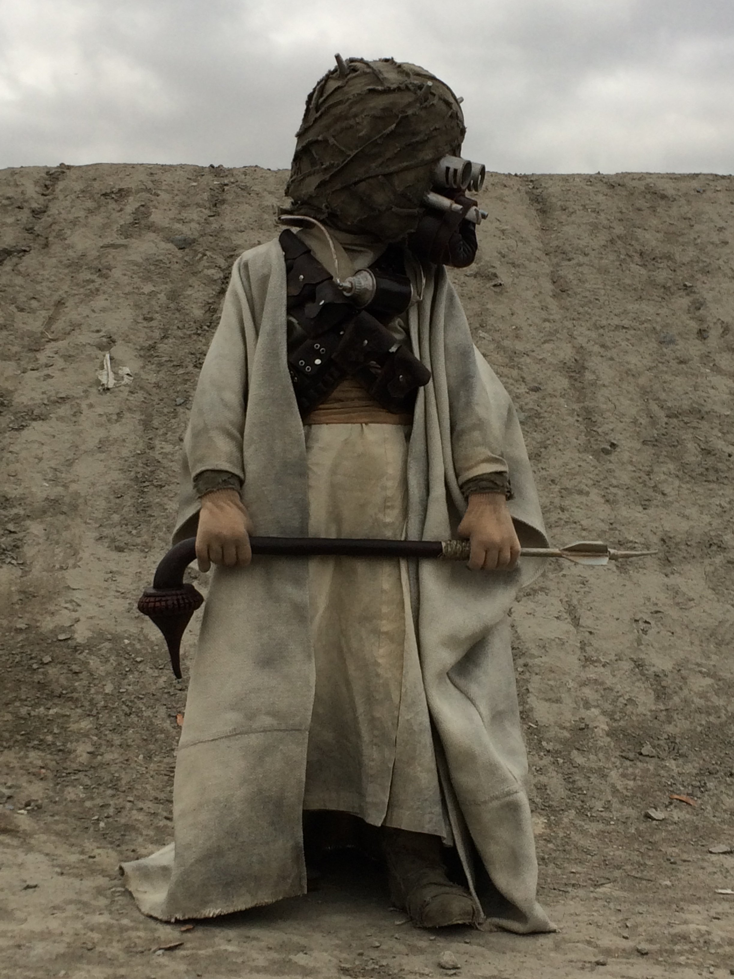

FINAL COSTUME:
The day before Halloween we headed to Sunnyside Bike Park here in Toronto, ON, Canada to take some photos. Photos were taken with an iPhone.
I hope you enjoy my son's Tusken Raider costume. I had a lot of fun creating it.
photo 5-3.JPGphoto 3-9.JPGphoto 3-3.JPGphoto 1-4.JPGphoto 2-5.JPGphoto 2-12.JPGphoto 3-5.JPGphoto 1.jpgphoto 3-1.JPG
