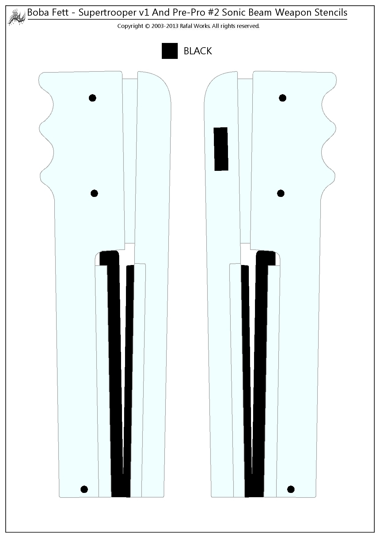

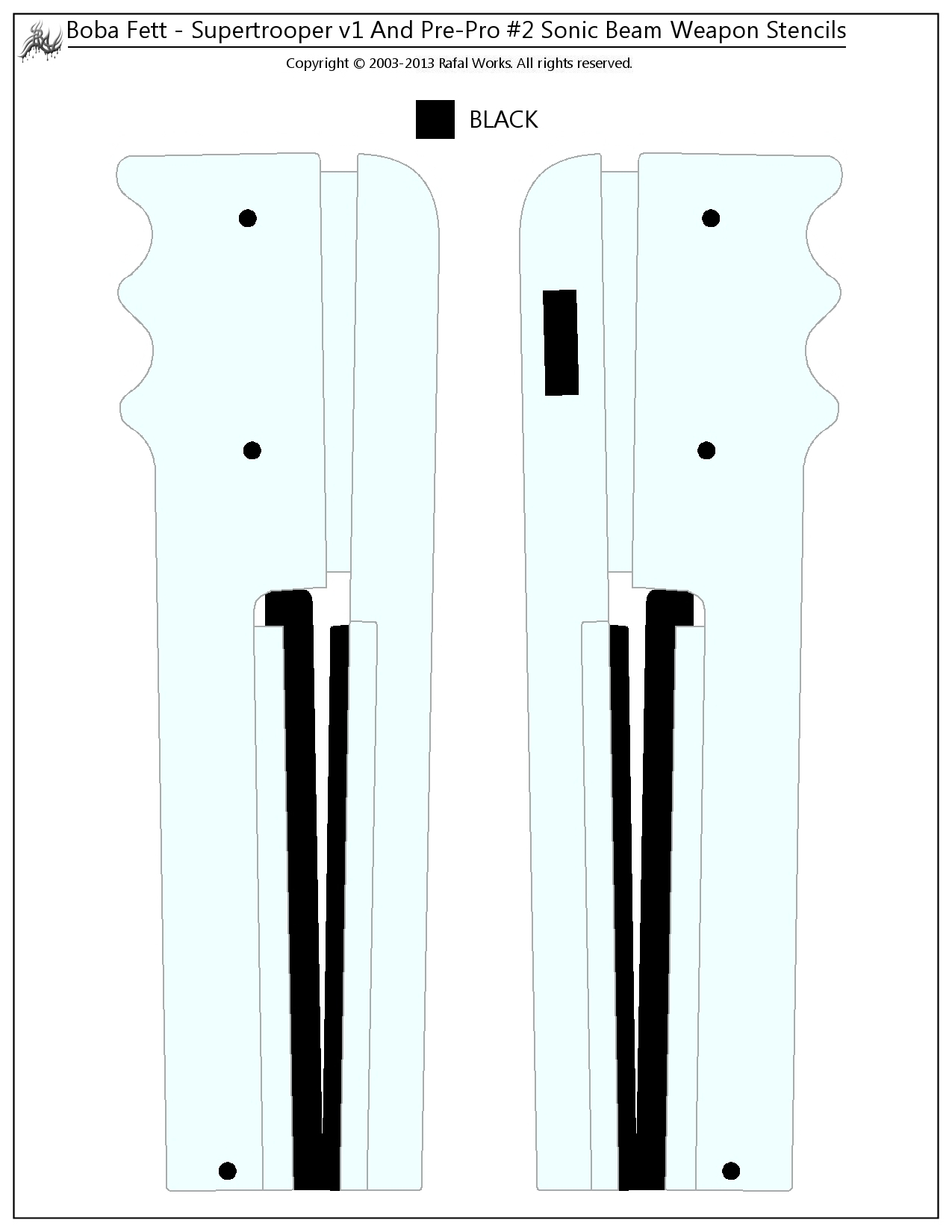

Early Supertrooper and Pre-Pro #2 Sonic Beam Weapon:
-------------A4----------------------------LTR--------------

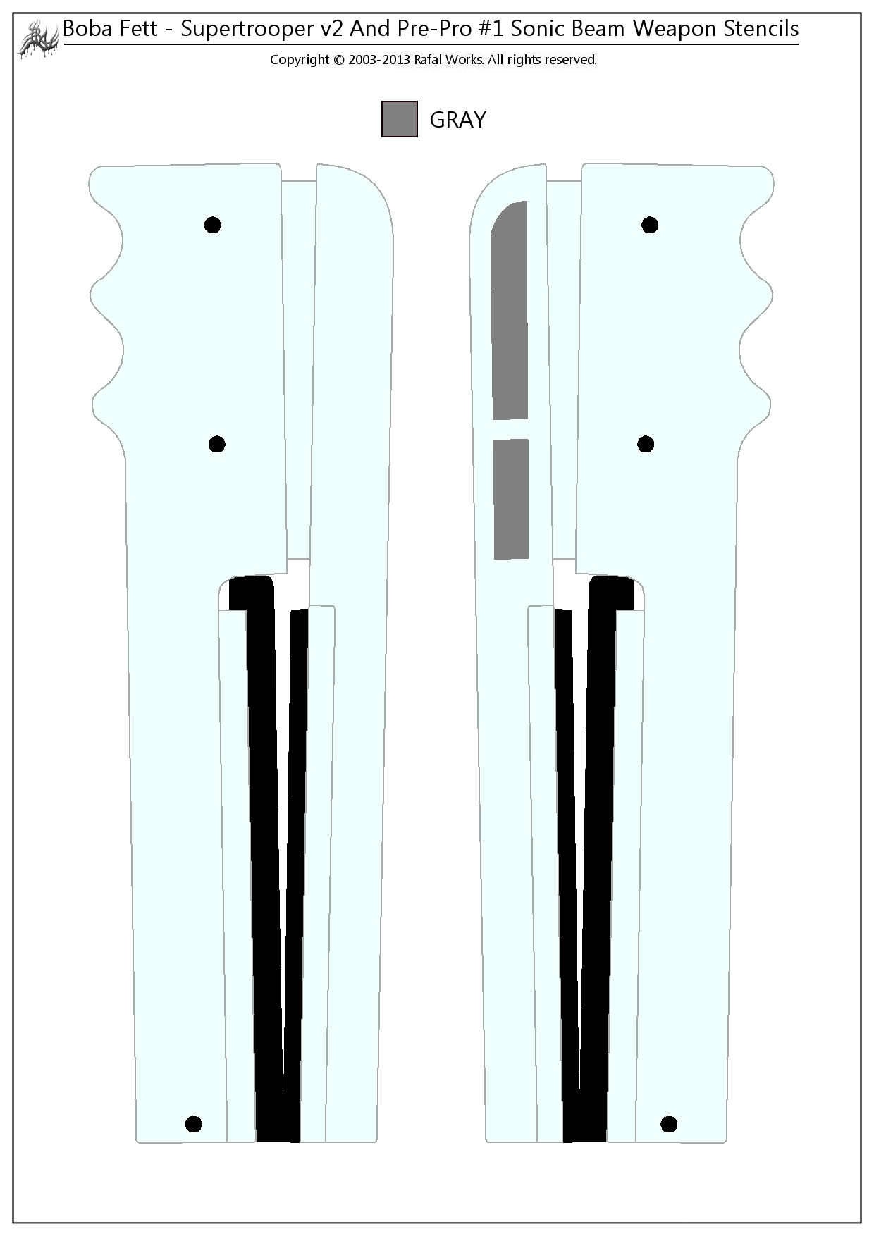

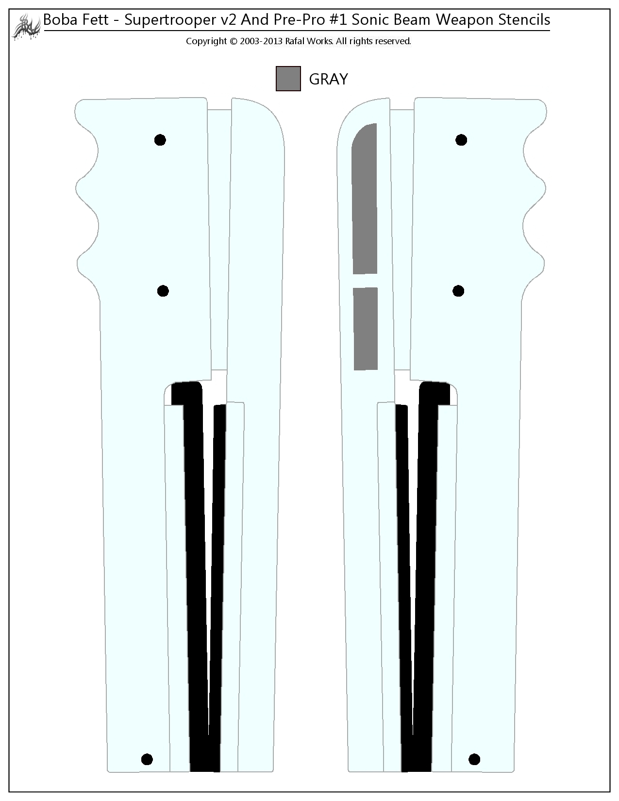

Final Supertrooper and Pre-Pro #1 Sonic Beam Weapon:
Pre-Pro #3, ESB Hero and ROTJ Hero Sonic Beam Weapon:

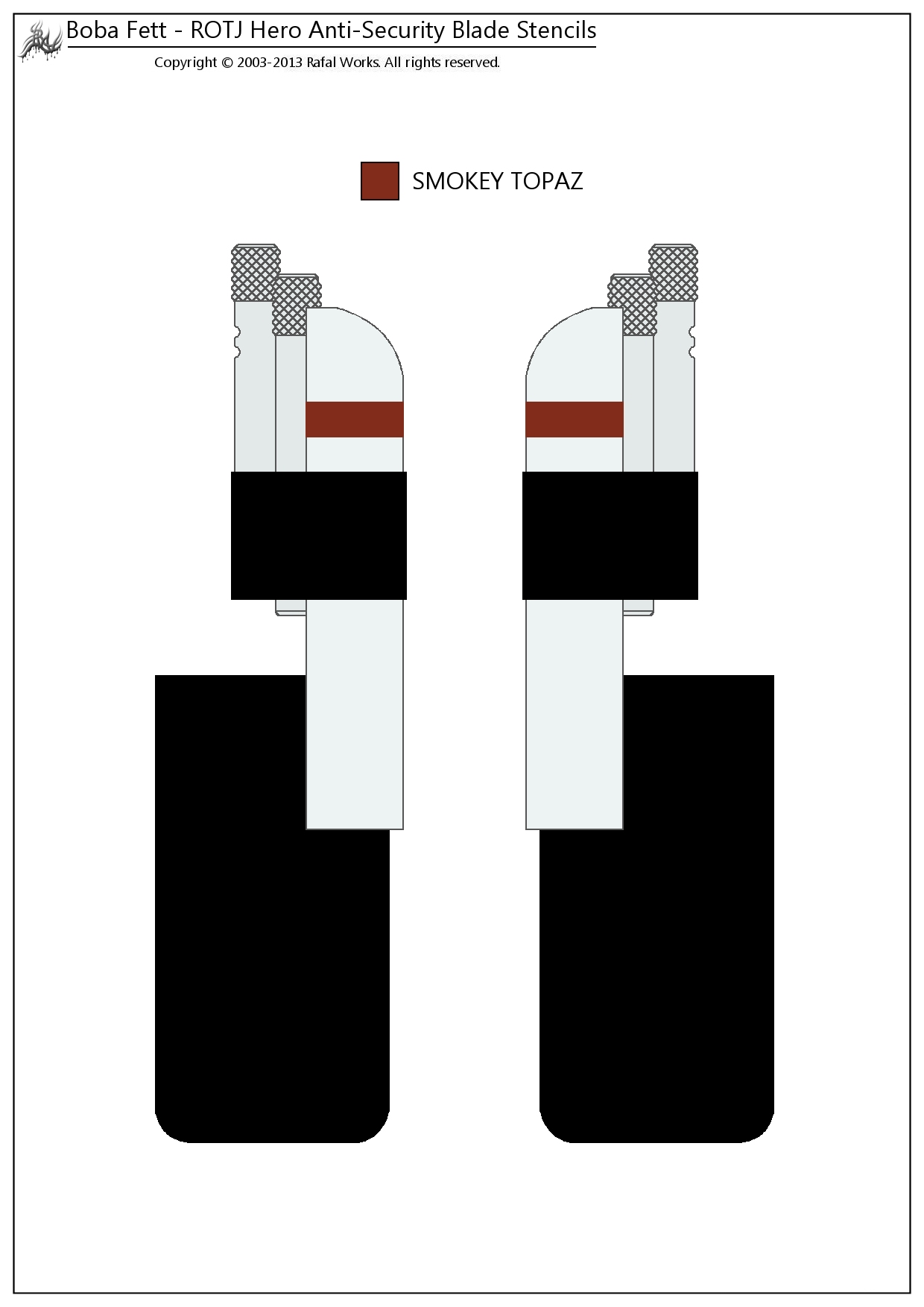

ROTJ Hero Anti-Security Blade:

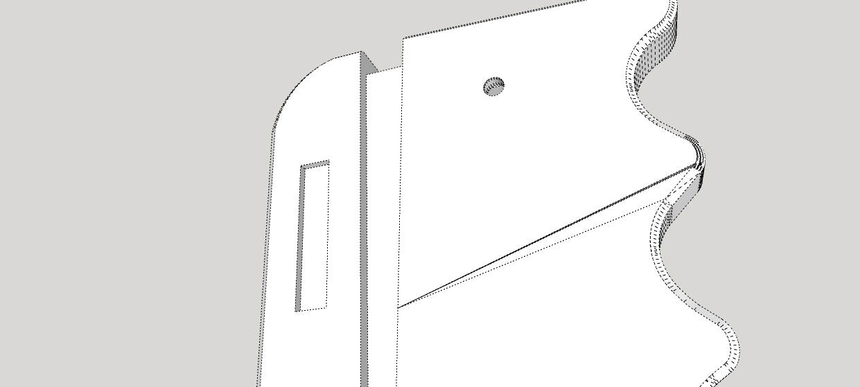

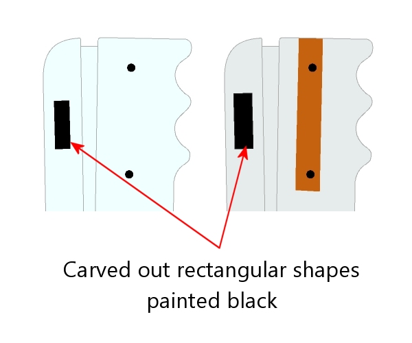

Note that the small rectangular shapes are first carved out, then painted black:

Thanks Raf you the man. Is the paint scheme different on the ESB anti-security blade than on the ROTJ one? And what should I use for the fourth tool and the black piece of the anti-security tool?
The ESB Anti-Security Blade does not have the red stripe, while the black 'stripe' is actually electrical tape (or something similar). Here is an image posted in my Misc Templates thread that explains all:

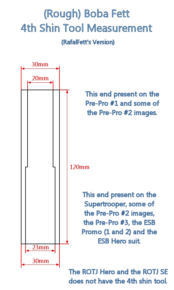

The 4th shin tool has not been identified yet, but the best replacement is a 100-120mm long steel/aluminum tube with a 30mm outer and 23mm inner diameter:

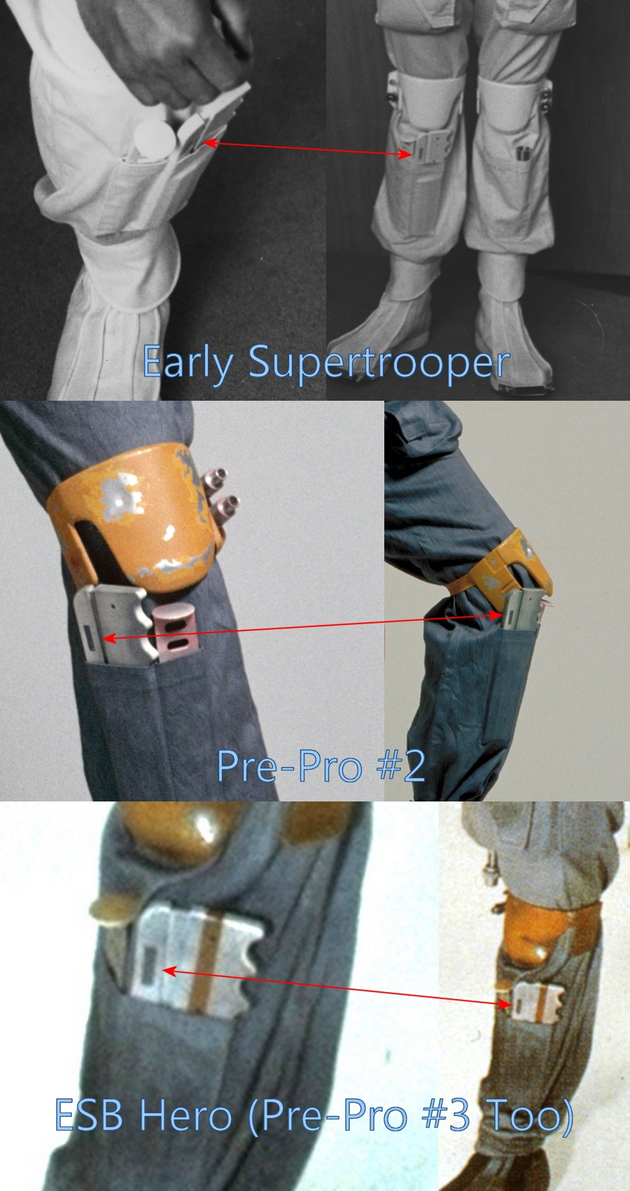

Thanks! Those carved out rectangles seems to be there on the Supertrooper, Pre-Pro #2, Pre-Pro #3/ESB images as it has that sense of deep (sometimes with shadows) and not just a painted plain rectangular shape:
Maybe the color is not black but dark gray. What you guys think?
heh i have no idea man, you'd know better than I! The only thing i ever concluded from that little rectangle was it was covering where it said "Patterson" on the original part. The new versions dont say anything there, but the one vintage set i had, it said Patterson there and that rectangle would cover it perfectly......other than that...i know nothing lol.
These files are part of the all Boba Fett Shin Tool Positions located in this thread ==> RafalFett's Misc Templates and Blueprints and these stencils were made by an indirect request by Jc27 (thread here ==>Looking for some painting help). So, here are the files for all the Sonic Beam Weapons and the ROTJ Anti-Security Blade:
Have fun!
So those rectangular shapes are actually cut out of the tool creating a hole and then the inside of the hole is painting black? Am I understanding that right?
