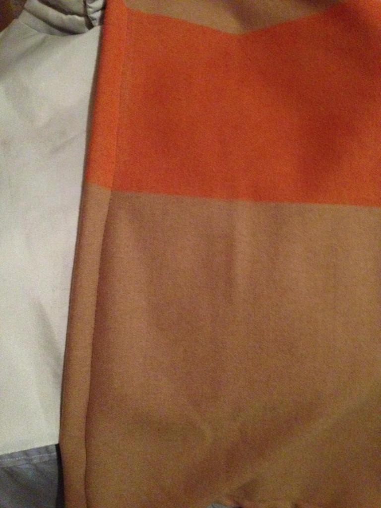

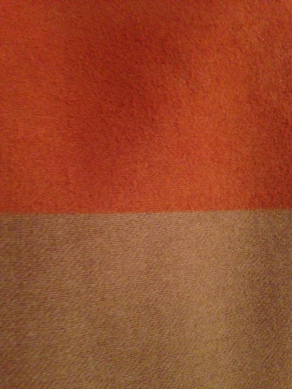

When I make my esb capes I do them in panels. If you have access to a sewing machine it's actually quite easy. That would eliminate you bleed problem. Screenshot_2014-11-05-09-04-37-1.pngScreenshot_2014-11-05-09-04-48-1.png
When I did mine I used a suiting wool, then I taped it off, and sprayed it with an orange spray paint. Then I hemmed the top and sides. Took all of 2 or 3 hours from start to finish. And I'm pretty happy with the final. I still need to rip it up a bit.
