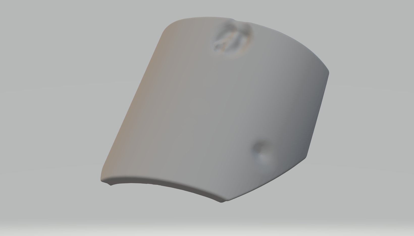

This is a modified RafalFett shoulder bell where I thickened it, smoothed it by remeshing it (adding poly count) and added the damage to the part. I will Resin print this out to capture the damage but I could easily FDM print it as well but would take some post processing to get rid of the layer lines.

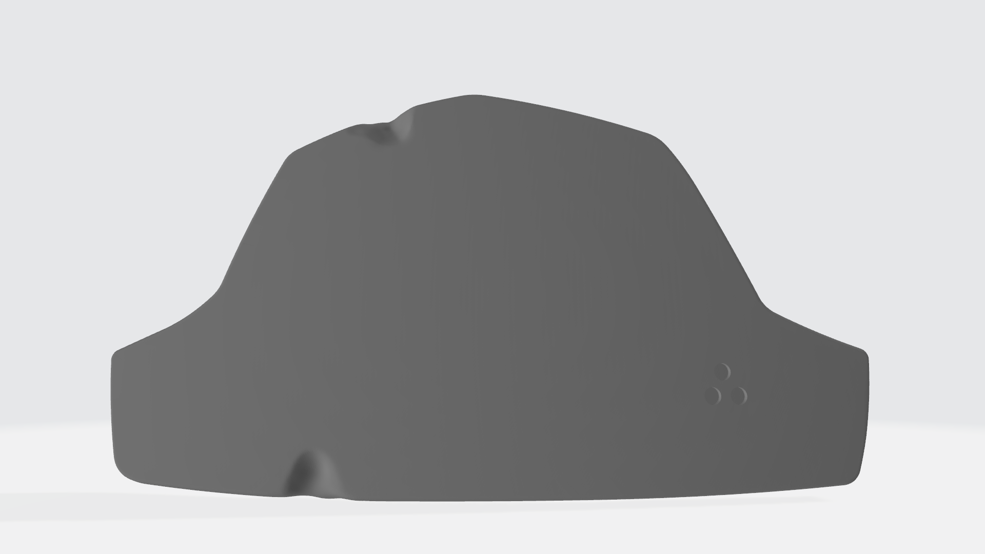

Armor plate

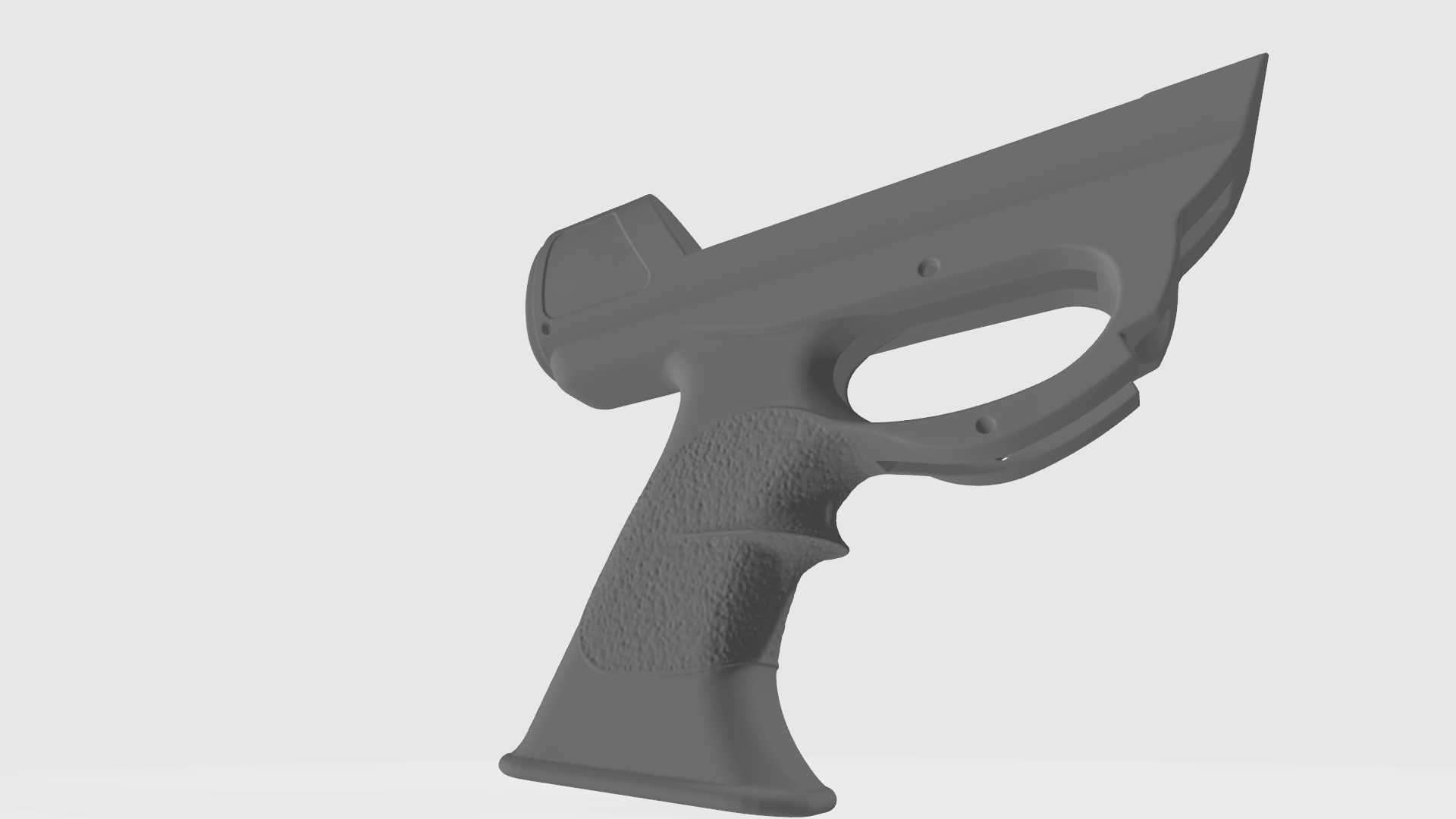

I also took his sidearm files and added the texture grip and removed the side emblems, barrel and trigger. Now I can paint each part individually and then glue them together.
Armor plate
If I ever get the OK from Rafalfett to post the latest copies of these files I will make them available for use.
