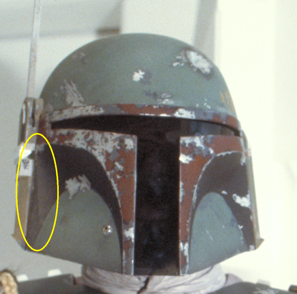

  • Helmet has a real or simulated crack on upper right cheek and closely matches visual reference.
For the life of me I can't see this crack in any reference pics. The Bobamaker helmet does not have a crack on the right cheek.

1) In terms of the crack it can be real (most hero helmets have retained the physical damage in the sculpt) or simulated which would be painting it into the helmet to make it appear there's a crack. The crack being reference I have circled below.
2) Since the casio mq-1 circuit board is built into the Boba Maker helmet it should be approvable for Level II.
Of course, I just checked my multitude of ref images and found this one of someone's build.
It clearly shows the required crack, but also a few more bordering the green cheek area, as well as some in the cheek. I think I will only do the required one.
Thanks Rafal!
