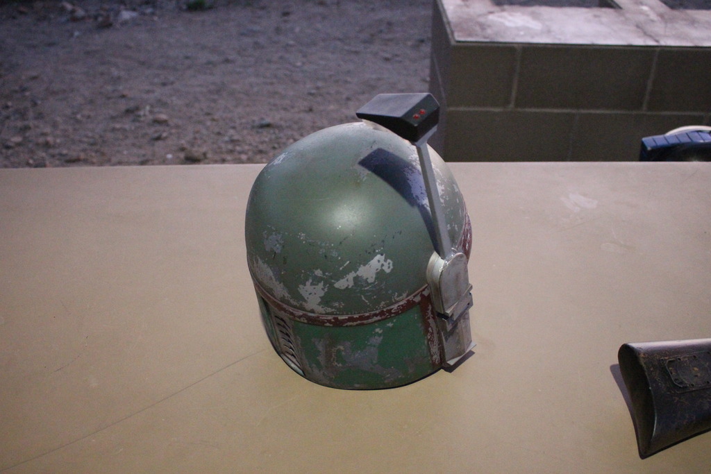

i put the detail bits on the ears, and mounted the RF stalk.
you'll note that i cut the top of the RF stalk down. technically rex's is round at the top and square at the bottom. i wasn't feeling like grinding that much metal, so i figured i'd let it be square. but it definitely doesn't have that fett-like T on the top.
i might fill in the head of the screw on the RF stalk. not sure yet. no plans to make it movable, so i can do whatever. it's glued into place already.

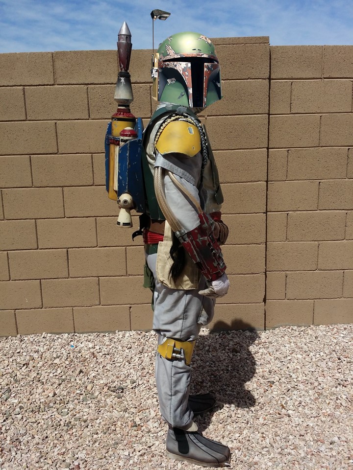

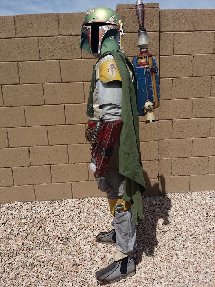

and while i'm at it, here are a couple of shots of me test fitting the whole suit.
there's a LOT yet to do... thighs aren't attached, ankles need to be trimmed, shoulders need padding, needs a belt, etc...
but, this is my first time putting it all on at one time, and i'm pretty happy with how it's looking!

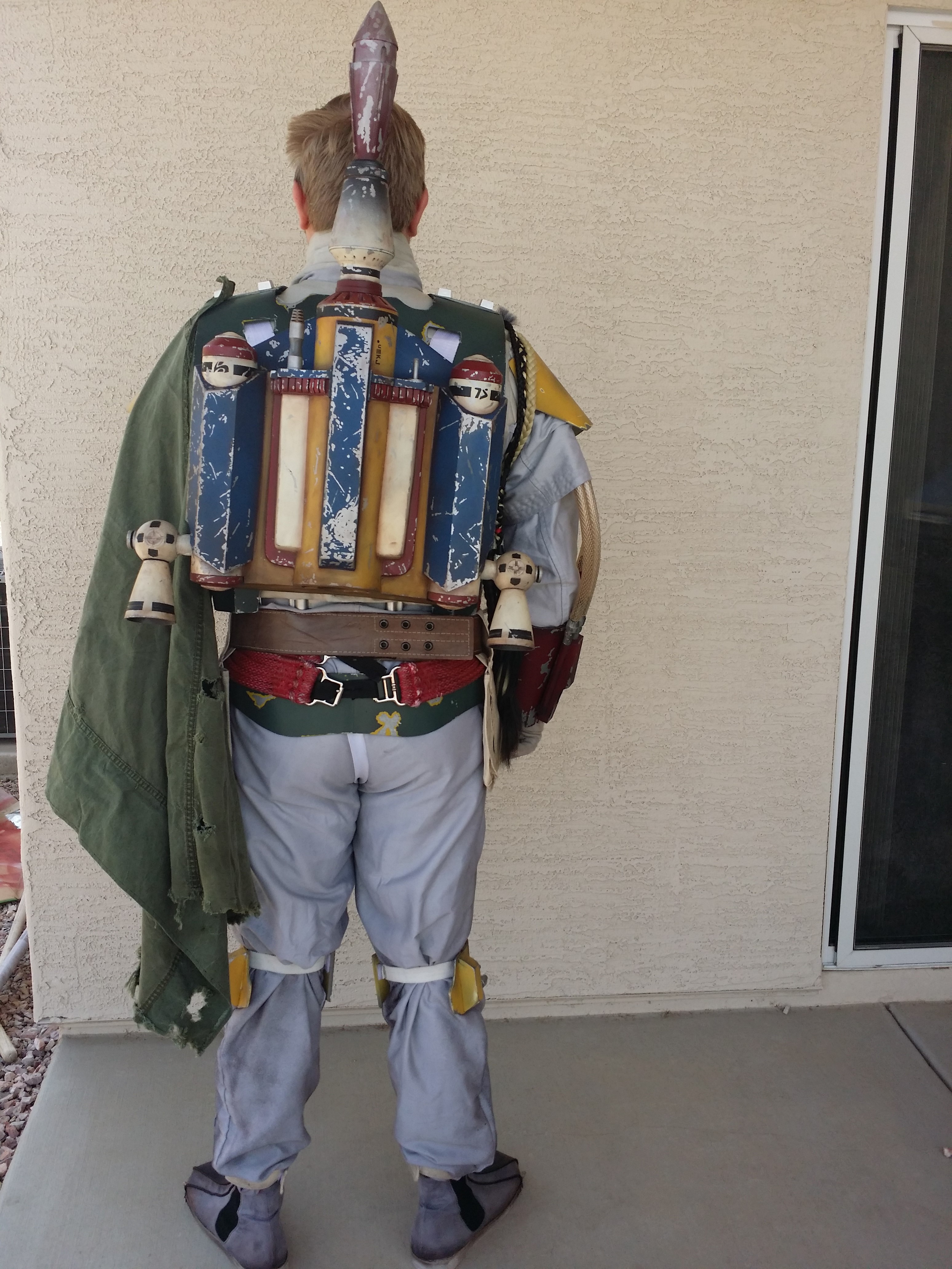

side shot:
back:
