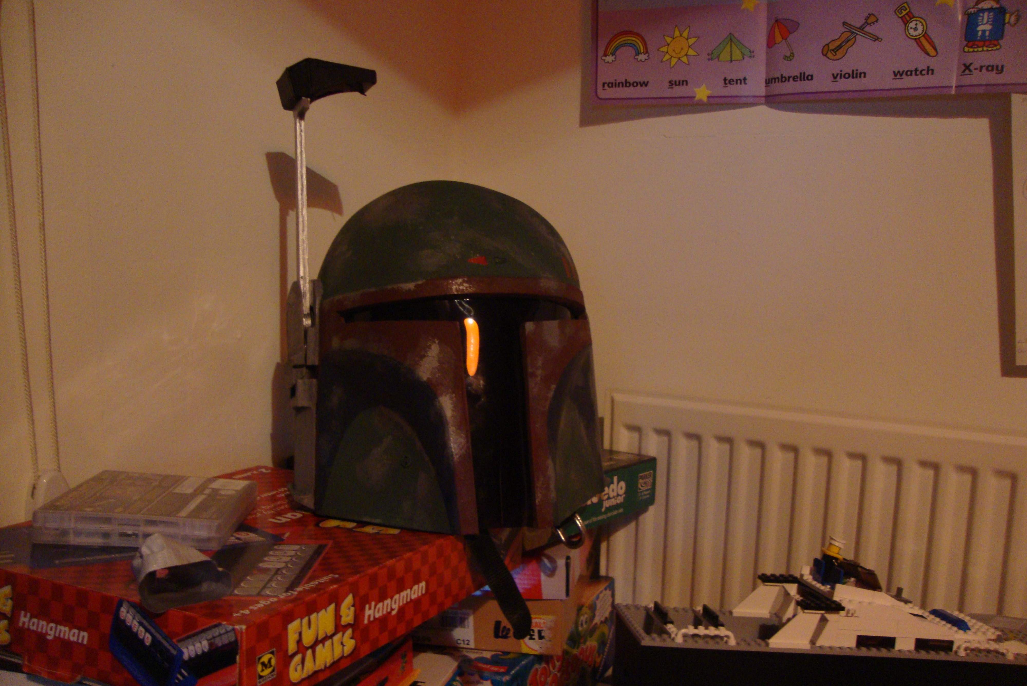

Heres a shot of the helmet mold up and almost ready for the fiberglass jacket to support the mold.
and then here is the two piece fiberglass jacket over the helmet mold material
I made a mold of my mr so i can mod it up.
It turned out good, except the dome is a little thin so it makes a little bit of waves, but im going to cut and sculpt on top of it, so ill fix that before I make the next wave of mold and casts.
