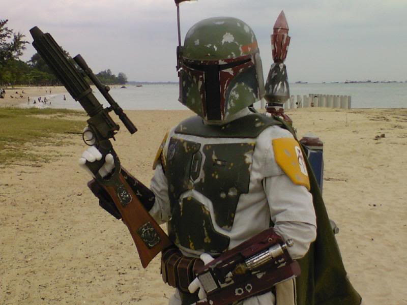

I think you need to specify exactly what you're looking for...streamlined OR smaller. Streamlined could be mean many things, up to and including removing certain parts to make it less 'cluttered'. Smaller basically means all the bells and whistles, cept smaller in size. It would also help to know if you're heading towards a Custom mando, or doing a movie version Mandalorian?
I'm 5'5" without armor and with standard movie sized armor and gauntlets [no modifications or resizing], this is me:
Hope this helps...

and you look great doing it!

To be more specific, I think I would be a bit more comfortable in gauntlets that were just about an inch or two shorter in length, and perhaps some that have less of a circumference, resting closer to the arm itself. I'd hope to not necessarily sacrifice any of the pieces on the gauntlets themselves.
HALO, that suit looks really great on you. Who is the artist? The flight suit and flak especially.

And thanks. The flightsuit was locally made and the vest is a retailored Batninja in med. What do you mean by the artist? LMK.
