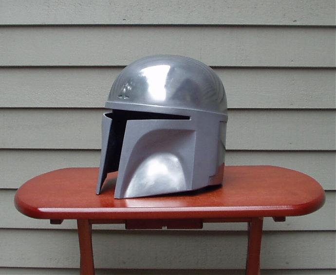

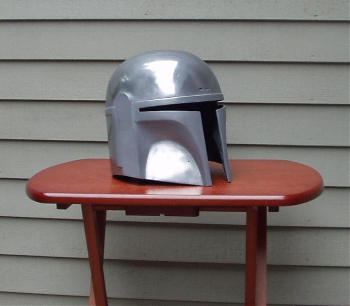

This is where I'm at so far...
I still gotta sand down a bit more for the visor region...

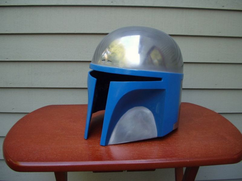

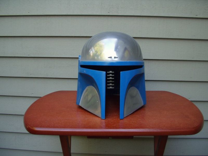

Well, while waiting for the krylon ocean blue to come in the mail, I did this....
It took about five tries to get to this. I'm happy with it.
I wetsanded the primer in the kitchen sink. Had some water running over while I sanded it with some 600 grit sandpaper. Don't know how everyone else does it, but this was fun.:lol:
Hey, great job. Just to add some warning though, when you start to tape off the silver when you satrt painting the blues, be careful, because when you start to pull of the masking tape, it can pull off some of the rubb and buff, leaving it to look "tarnished" and not as shiny as when you first out it on there.
-tubachris
It looks amazing!

What kind of tape did you use to mask off your helmet for the blue?

I cut out some layers of newspaper so it could fit over the silver parts, and taped it to the helmet along the edges. It took a little while to do, but worked out well.
