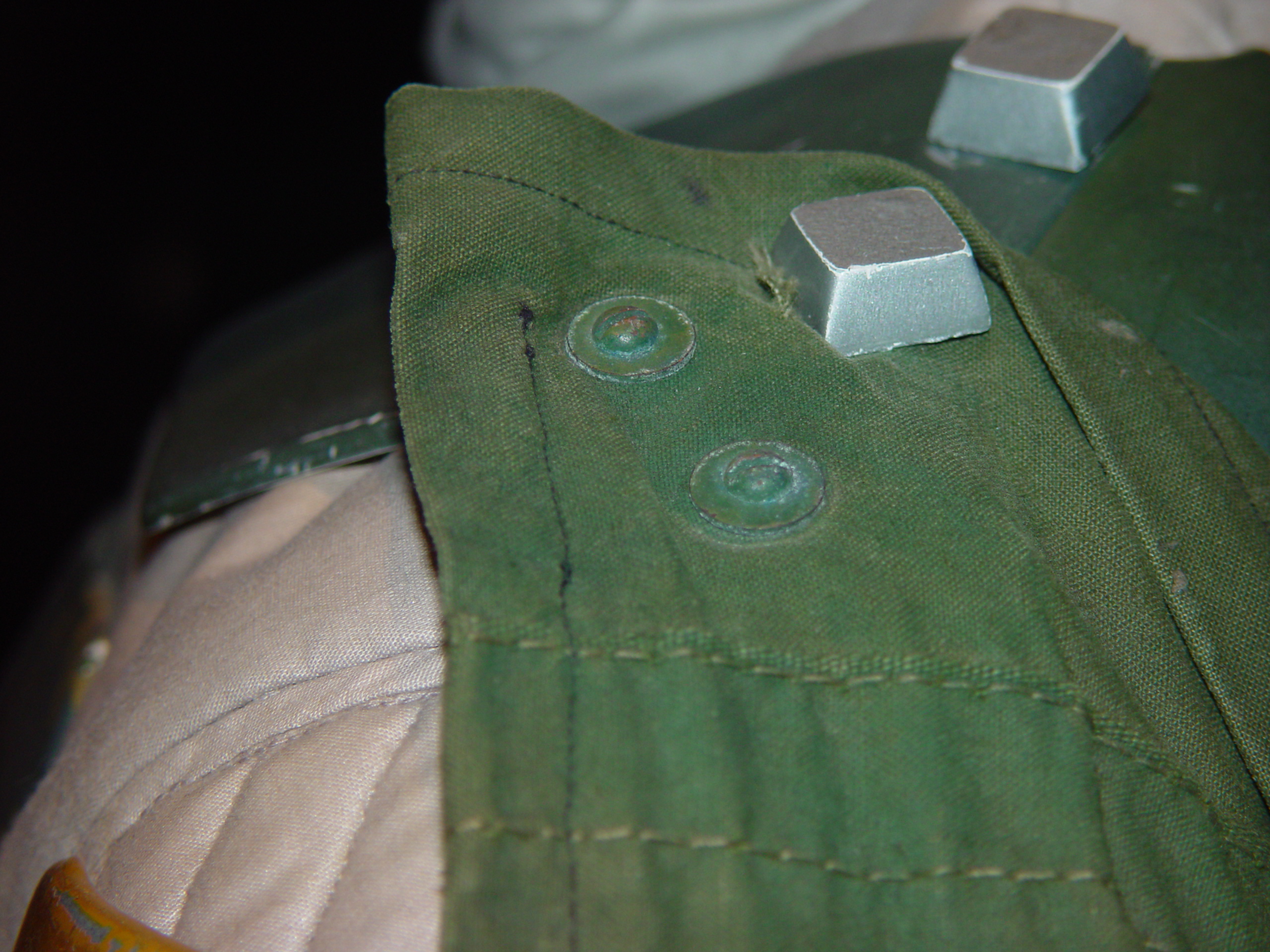

I used the same method on my Jango gauntlets & in three years have never had a problem with keeping them closed. The best part is that they are super easy to get into but require a bit of coaxing to get out of.
