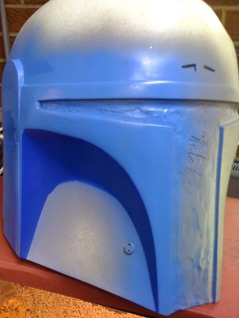

I am making a cold cast removable board for my TF... using Sipdys little invintion as a jump off point... but sadly it just looks like Titanium metal. :( But I did not use "layup resin" nor did I use enough metal powser from what TF tells me.
As per our discussion privately, I figured I'd post the conclusion :lol:
Urethane resin was the issue. Smoothcast 325, and metal powder = so - so results, at best.
Polyester Layup-Resin, clear is the best if anyone is following this thread for tips :)
