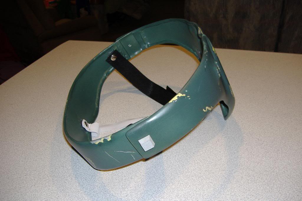

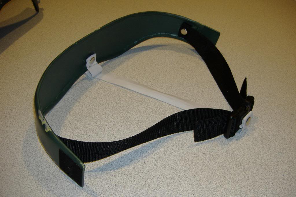

This is not my image but this is how mine is. The butt piece is made like a belt with a strap attached to it for tightening. then the cod piece attaches to the butt plate by velcro. You can see the velcro here.
Thanks for posting that Furious. I rushed to finish mine and just velcro'd the cod to the butt and it worked ok but that will def work in keeping it from sagging.

So it's Velcro on both sides and the inside belt is behind the cod. Is the cod just held on by the Velcro then?
And held in place also by the girth belt I imagine. And the keyboard keys are just ornamental glued onto the cod.
If you have a pic of the cod that goes to I'd love that also.

Yep. that's about it. The cod and butt piece will stay on nicely without anything else holding it up.
Are those snaps to the elastic? What kind of belt is it? That's a really awesome pic, I've never seen it like that! I'm getting RKD armor so it's good to see how vac formed armor would get put together.

This is a great set up & I have used it twice but with one variation on the second build I made the attachment blocks functional instead of using the velcro. This is very secure & the kidney plate doesn't sage cause it is pulled tight against your back. I am planning on switching my Boba to use functional attachment blocks. The girth belt also help hold the cod piece in place.
The belt is a custom piece I made just using 1.5" webbing & a quick release buckle that I got from strapworks.com. Those are snaps attached to the elastic. The top lip of the cod piece will rest on the front snap which is on the buckle.
