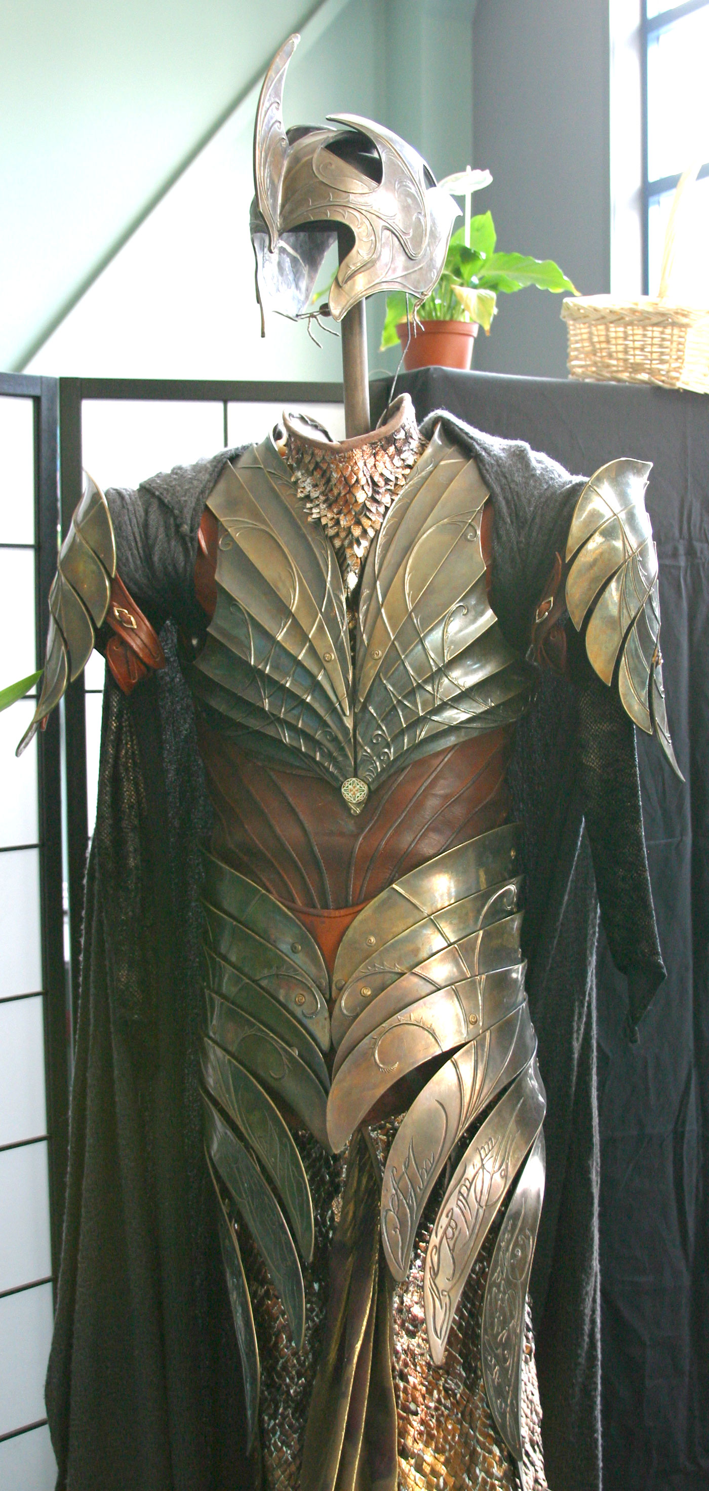

    I am working on a costume with armour, and I thought you guys could help me with a problem. I am using fiberglass over a cardboard base. this is my first time to use fiberglass in a costume, so I am working off of general tips I found. Once the fiberglass dries, it doesn't seem as hard as it should. I know it is completly dry, but the cardboard is still bendable.
    My technique is simply applying the fiberglass mixture over the cardboard. what am I doing wrong?

    Well, I'm kinda on a budget on this armor, and I don't think I can afford to have someone plate it.I have also run into another problem. The armour I'm working on has raised designs, and when I put my fiber-gauze on, it completely covered them up. Any tips? I was also wondering, incase just applying the fiberglass doesn't work, how hard is making a mold and casting it?

    That depends. I don't know what you're trying to make. a pic or description goes a long way.

    Oh, sorry about that. I'm make Lord of the Ring Helms Deep Elf armour.

    If you can, post a pic. I'd like to see what kind of draft you're looking at before I'd recomend a course of action. I could probably guide you through some fiberglass molding techniques, but it doesn't sound like you've ever worked with fiberglass, so I'd need as much info as I can get from you, in order to help at all. Also, how tight of a budget for materials do you have?

    The armour on the chest is what's giving me the most trouble.

    The chest doesn't look that hard at all. If it's made of painted fiberglass, you'll have to mold it with silicone to prevent any damage to the origional. However, since there's very little draft on the piece, you can make a silicone-lined, fiberglass-shelled mold. to do this, build up four layers of silicone, allowing each layer to cure before applying the next. next put a fifth layer of silicone on, but, before it's cured, take an old t-shirt and cut into pieces, and press them lightly into the silicone. do not cover them. you want the fabric surface for the next step. When you cut and apply the fabric from the t-shirt, try to fit the pieces together so they're touching, but not overlaping. when this cures, the fabric will be permanently bonded to the silicone. Now paint the fabric surface with fiberglass resin to saturate the fabric, and start laminating your matt over that. Allow it to cure overnight, before attempting to demold. What you will have is a silicone-lined mold, that holds it's own shape like a fiberglass mold. The t-shirt fabric is the binding layer of the two. Without it, the fiberglass and silicone would seperate. I also used this method for molds that bolt together, and come apart around the final casting. There you have it, another J. Dwedd molding secret revealed.

    OOOHHH, you don't actually have access to the origional in the pic. That changes everything. Sad news buddy, 20 bucks aint gonna cut it. I wish I knew what else to tell ya.
