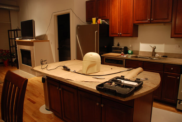

Here's my work space not exactly a workshop but it works:

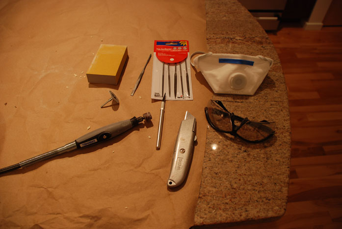

Here's the tools that I used to start the clean up of my helmet:
http://www.robertckrekel.com/miscimages/thetools.jpg

Remember kids always where your saftey gear:
http://www.robertckrekel.com/miscimages/safetyfirst.jpg
http://www.robertckrekel.com/miscimages/hereswhy.jpg

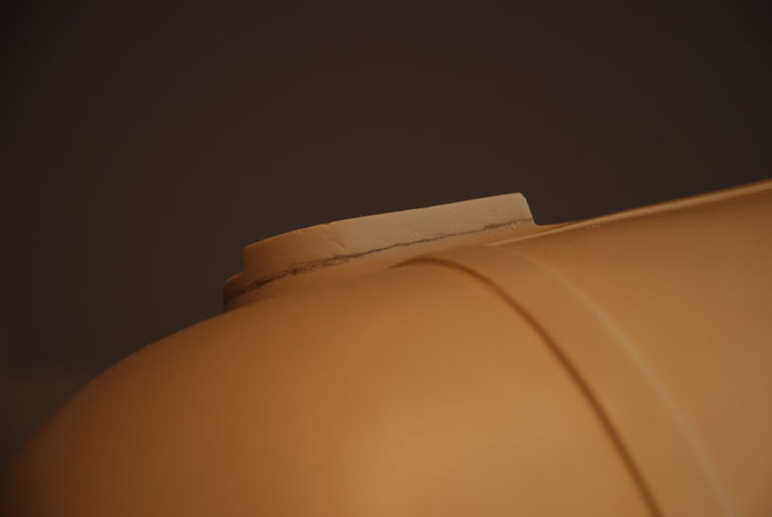

I then moved to the top of the t-visor and again cut it out roughly:
http://www.robertckrekel.com/miscimages/3_FirstCuts.jpg

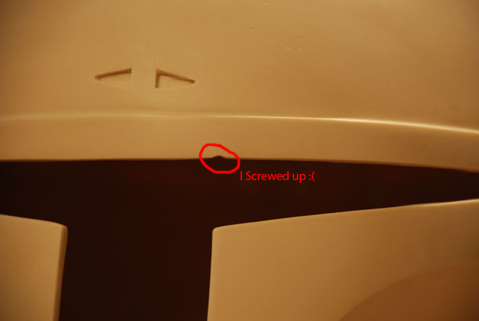

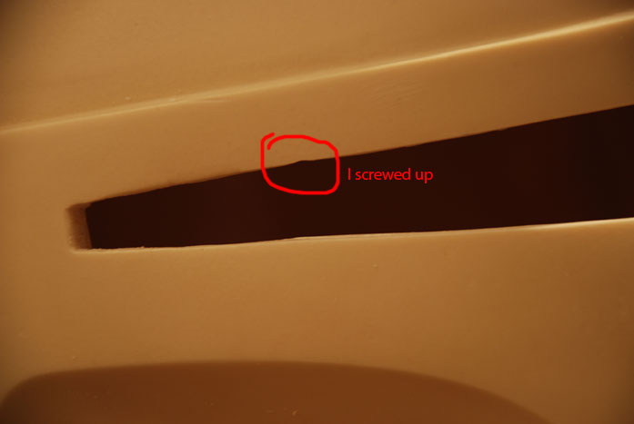

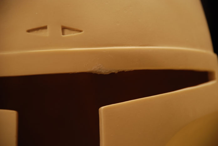

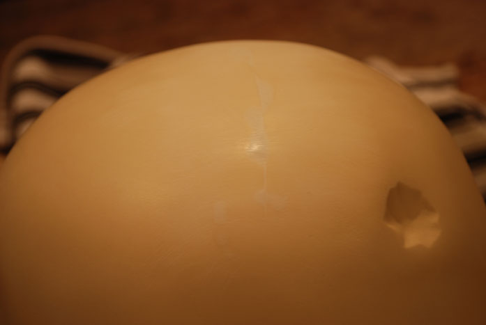

Screw up 1:
http://www.robertckrekel.com/miscimages/screwup_1.jpg
Screw up 2:
http://www.robertckrekel.com/miscimages/screwup_2.jpg

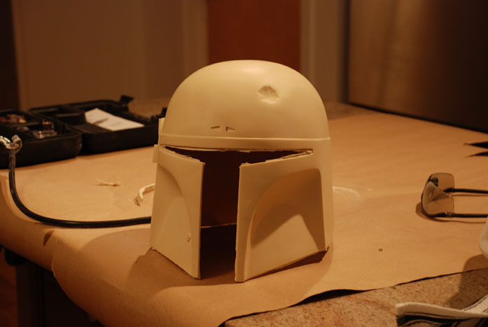

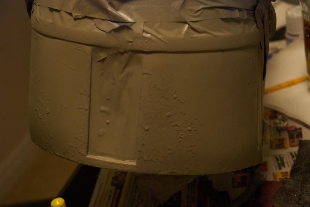

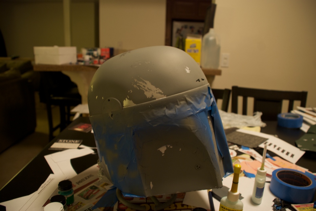

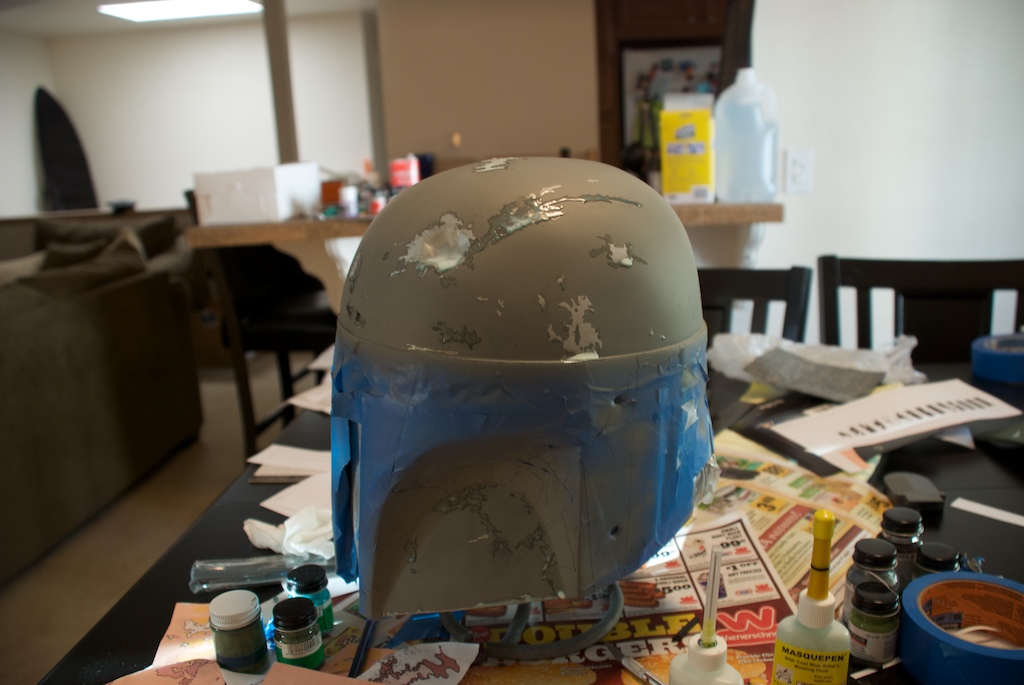

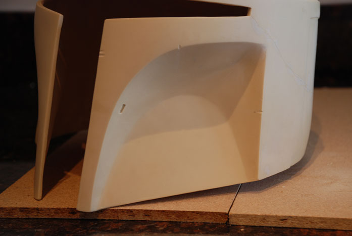

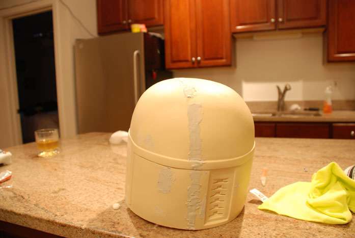

After the Visor was cleaned out I decided to start putting filler on the bucket. Here's the raw filler after it being put on the bucket. It's squadron white.
http://www.robertckrekel.com/miscimages/filler1.jpg
http://www.robertckrekel.com/miscimages/filler2.jpg

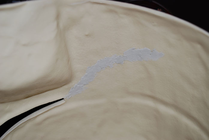

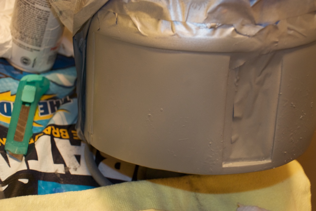

I was also able to use the filler to fix the areas that I had screwed up:
http://www.robertckrekel.com/miscima...thescrewup.jpg

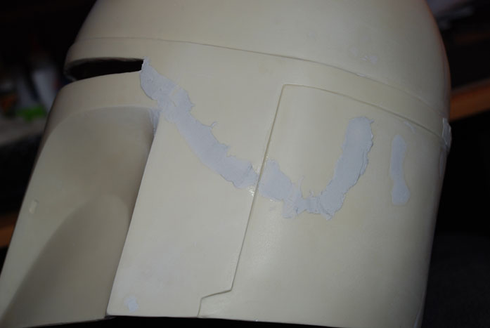

After 2 coats of filler I am pretty pleased with how the raised areas are looking:
http://www.robertckrekel.com/miscimages/sanded1.jpg
http://www.robertckrekel.com/miscimages/sanded3.jpg
http://www.robertckrekel.com/miscima...edscrewups.jpg

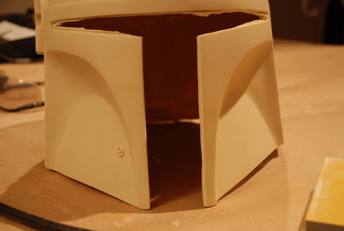

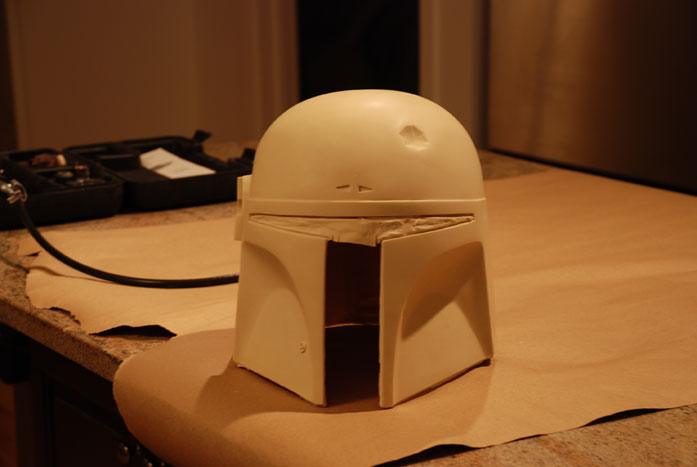

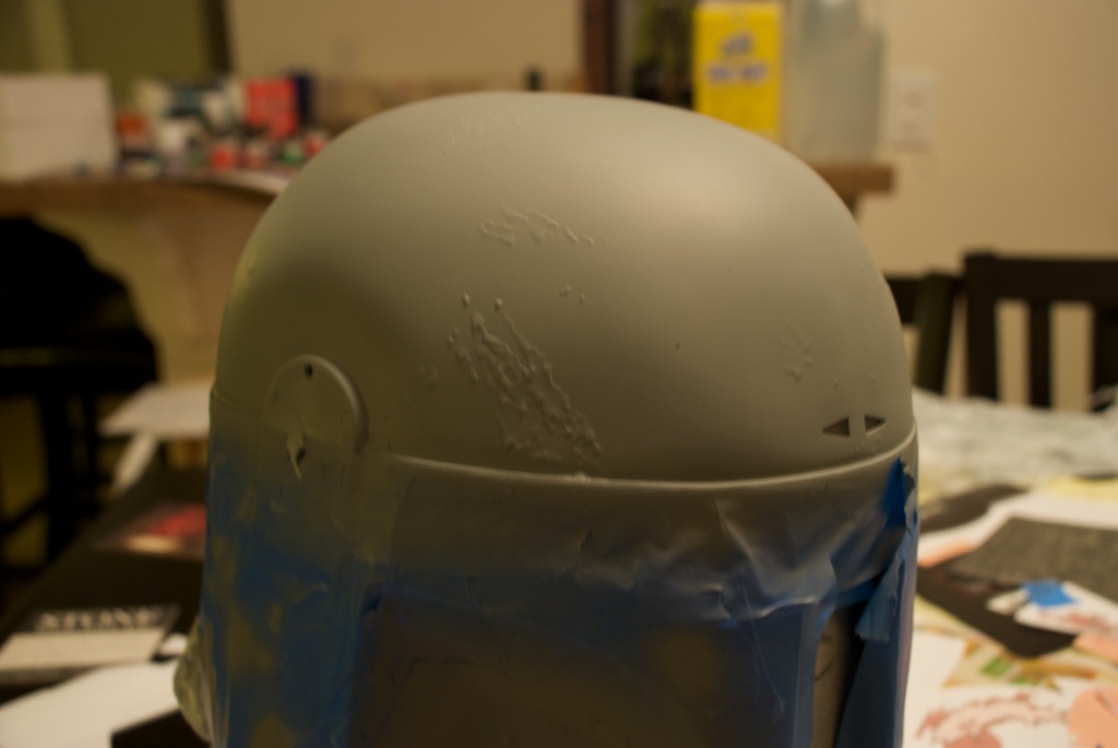

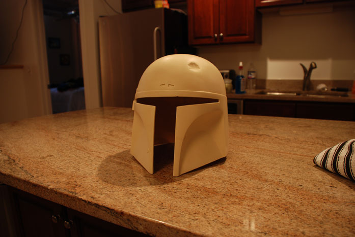

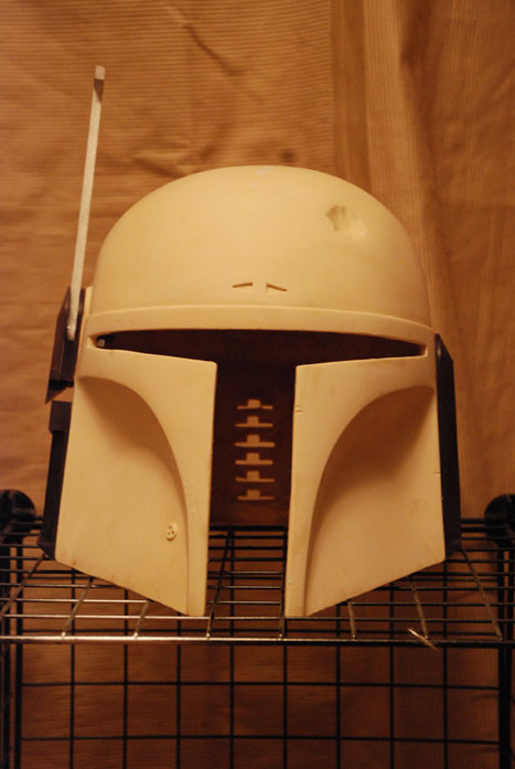

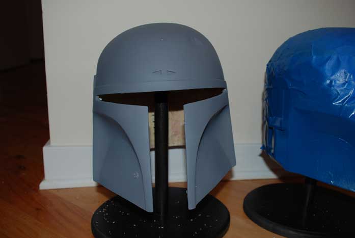

Here's the bucket almost done with the prep work. All that's left is the (gulp) ketslots. My plan for those is to do a rough cut with the dremel and then finish the clean up with the hobby files.
http://www.robertckrekel.com/miscima...newithprep.jpg
Aside from the ketslots I also need to even out the width of the visor opening from the inside of the bucket so that the tvisor will sit correctly.

Looking good so far Rob!!:thumbsup ....love the "workshop"..;)

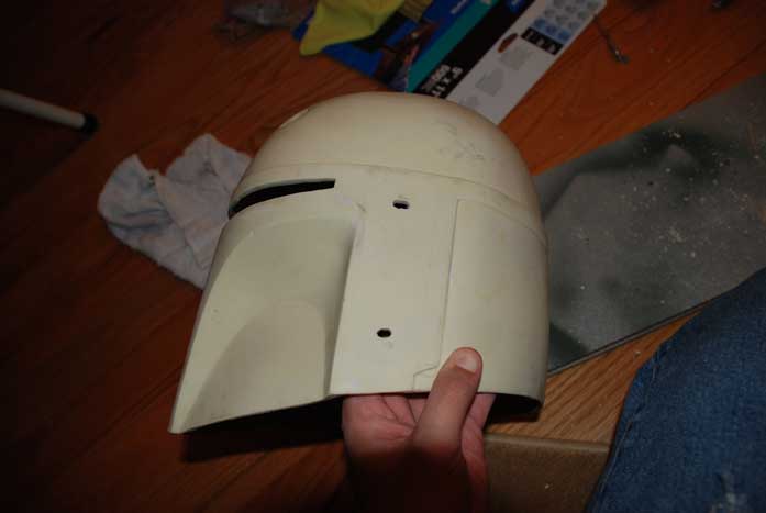

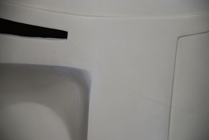

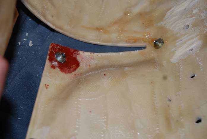

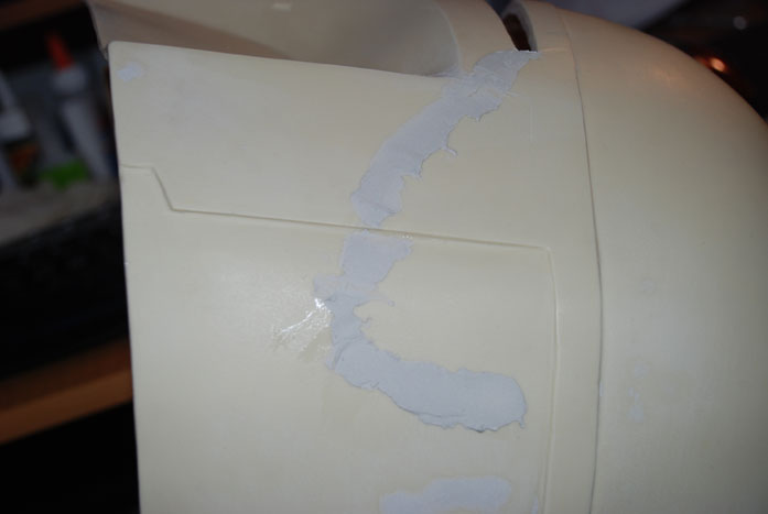

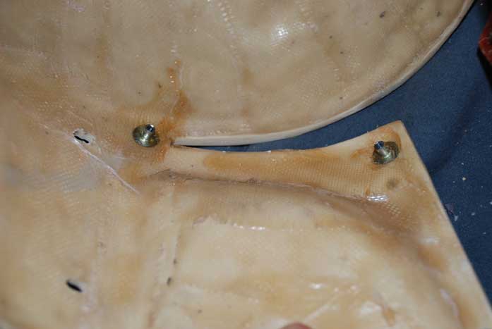

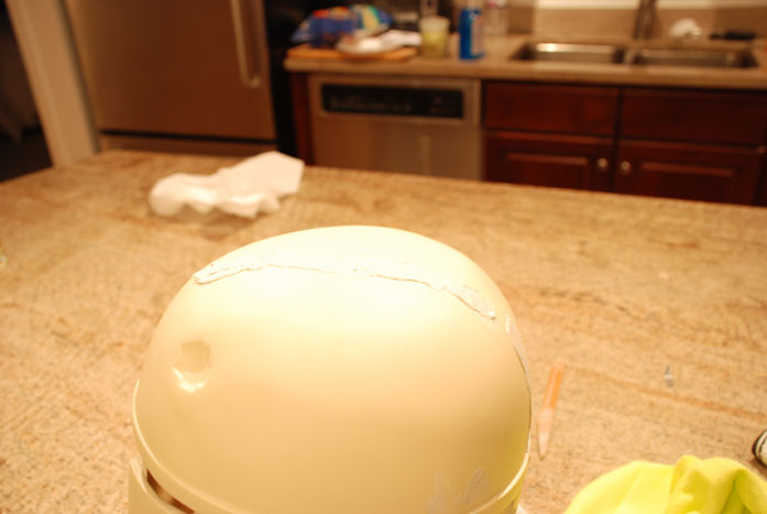

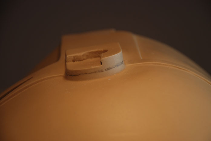

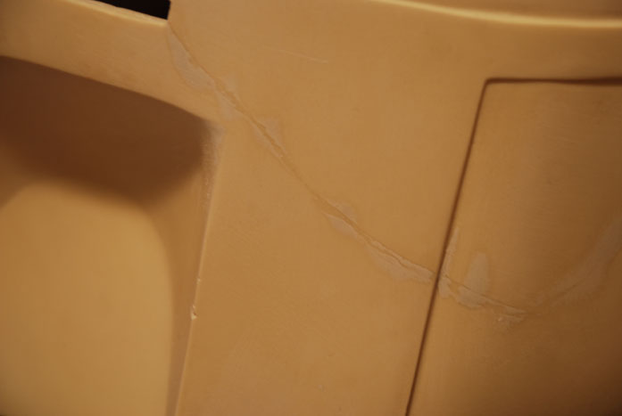

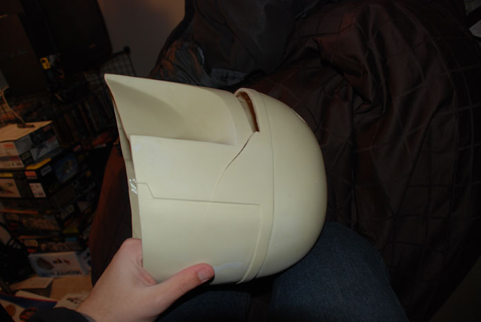

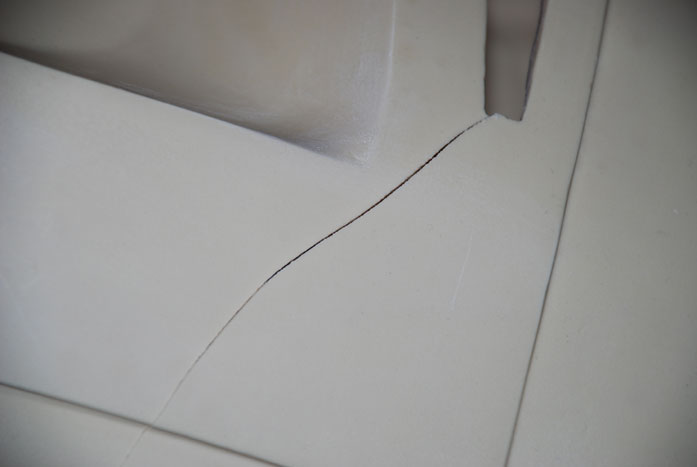

A disaster almost just happened. I was getting ready to go look at apartments and I had my bucket sitting on my bed. When I went to grab my jacket off the bed it knocked the bucket onto the ground right on to the mandible. It made a pretty nasty crack from the corner of the tvisor area to the rear of the bucket. Thank fully I was able to put some CA glue on it right away. I'll putty it up after the CA dries to cover the crack up.
http://www.robertckrekel.com/miscimages/ohno1.jpg
http://www.robertckrekel.com/miscimages/ohno2.jpg
http://www.robertckrekel.com/miscimages/fixing1.jpg
Do you guys think I need to reinforce this any more than just the CA glue and putty?
Re: NikNak's SgtFang Progress Thread (PIC Intensive)
You can't reinforce too much, when in doubt, add more. It might even counter balance the wieght of the range finder.
I broke the mandible off my Sgt. Fang too. Be sure to use shims on the inside of the bucket to reinforce the two pieces together. No one sees the inside but you so it doesn't have to be pretty, but it needs to be functional and support the two pieces.
:thumbsup
:skull
JB Weld on the inside, Bondo on the outside. ;)
You could always get some fiberglass and cloth and brush in some fiberglass gel and lay the swatch of cloth in and then brush a little more fiberglass on top. This will give an excellent reiforcement inside. But do this process out doors. Its stinky but very strong.

Couldn't agree more......there's no such thing as building something too strong.
I am pretty sure that I am gonna end up fiberglassing the inside of the bucket but I wont be able to until after I move. The mandible is stable now at least with the CA glue and filler on both sides. I have some really good industrial strength Expoy that I am gonna throw on the inside after I sand down the filler.
I also started squaring the "cheeks" with my exacto knife. You can see it a little bit in the pics with the broken mandible. I need to add some filler so that I can make the detail just a little bit sharper.

Man that sucks, I'm sorry that happend!:( That is the bad part about resin helmets VS. Fiberglass, it tends to be alittle less durable.
Ouch! Fibre glass tissue would be an ideal re- inforcement, a very fine layer; this would make the area effected as good as new with minimum bulk, laminated inside....

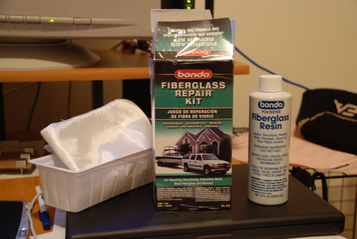

That crack can be fixed! Fiberglasss it! You can buy fiberglass repair kits at Walmart in the automotive section for $10. Their is probably enough in one kit to do most of the inside of your helmet. :)
Quote:
Originally Posted by
NikNak_aka
I fiberglassed Batninja SgFang and it seemed to fix the issue and made it a sturdy helmet. I have to say that I would not troop with that bucket without fiberglassing it simply due to how fragile the resin used to make it is. Its a great helmet but the resin used is one of the more brittle resins.
You want to get a bondo fiberglass repair kit and buy the larger size one. Cut the strips in small 1.5" by 4" strips and take your time. The instructions say to use one big peice but that is for filling a hole on a car hood or boat! Use strips... it will work better.

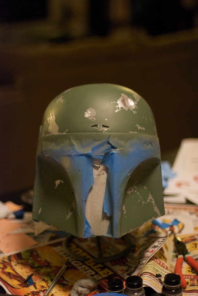

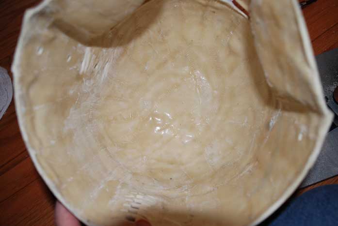

UPDATE 2/28:
So I managed to squeeze out some time last weekend to work on my bucket a little bit. I've finished most of the prep work and now only few things remain before I can start to put paint on it.
First I fixed the crack:
http://www.robertckrekel.com/miscima...ackrepair1.jpg
http://www.robertckrekel.com/miscima...ackrepair2.jpg
http://www.robertckrekel.com/miscima...ackrepair3.jpg
I worked the cheek corners just a little bit with a sharp exacto knife and then filled them a little bit with putty. I plan on going back and adding a little bondo to sharpen the detail a bit.:
http://www.robertckrekel.com/miscima...ekandcrack.jpg

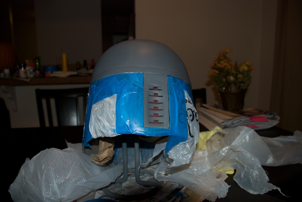

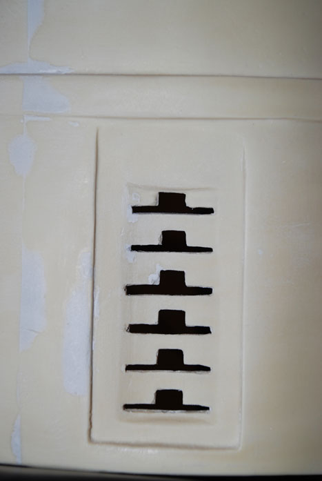

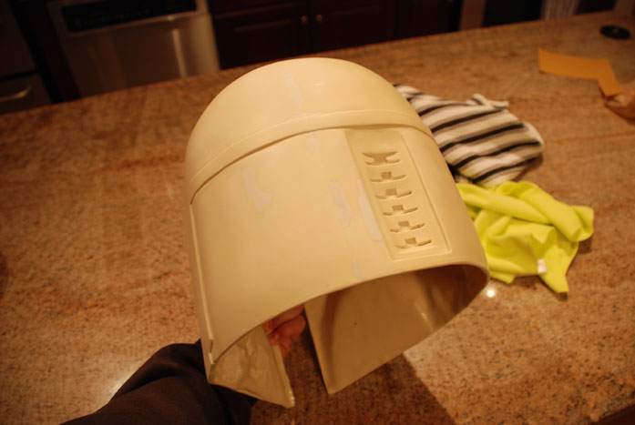

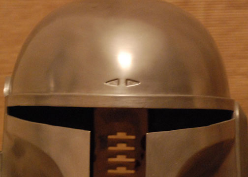

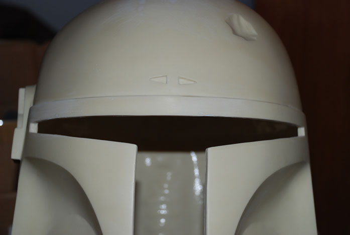

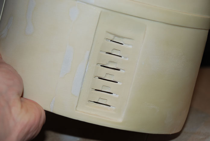

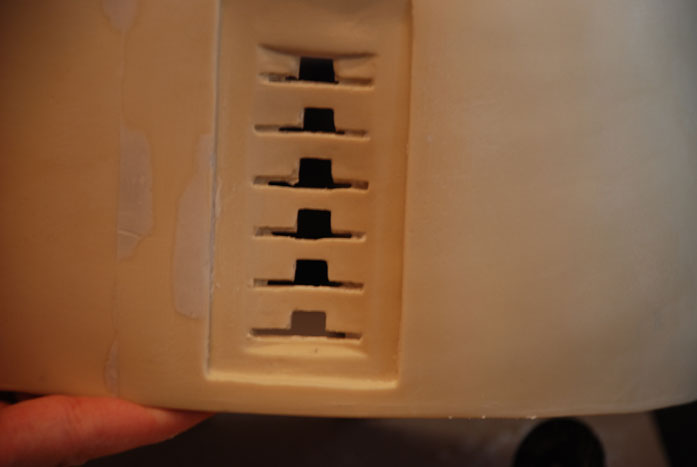

The I tackled the Key slots:

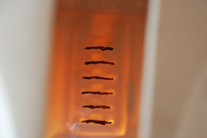

Here I put the bucket up to a light to see when I needed to cut through the inside of the bucket to get the long sections of the key holes I then marked off the areas with sharpie.
http://www.robertckrekel.com/miscima.../kesylots1.jpg
Then I trimmed out the longer sections just enough so I could fit in some of my slimmer files:
http://www.robertckrekel.com/miscima.../kesylots2.jpg

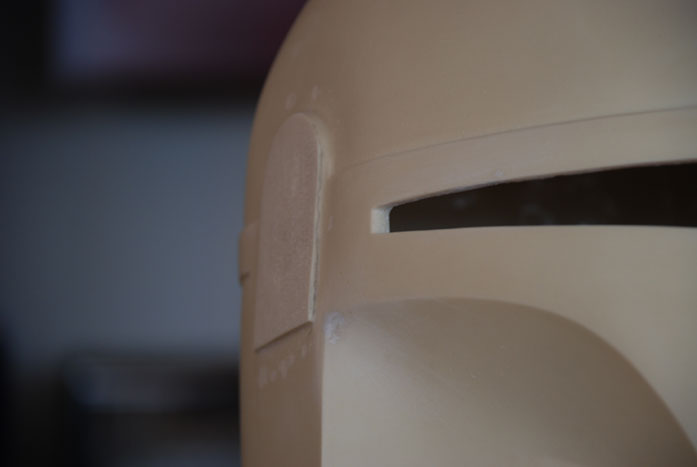

For the top parts of the key slots I used a very small cutting bit to get the general shape there. I then went back with my files to clean them up:
http://www.robertckrekel.com/miscima...a/keslots3.jpg
Here is where I left of the the Key slots. I added some putty to try to fix some of the areas that are just bad in the cast but its not an easy area to work. I am not 100% happy with this area and I will go back to it before I go to paint it.:
http://www.robertckrekel.com/miscima.../kesylots4.jpg
I then went back and added some of the signature dremel details that can be found on the ESB buckets:
http://www.robertckrekel.com/miscima...meldetails.jpg

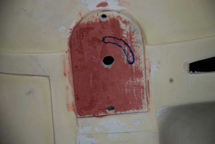

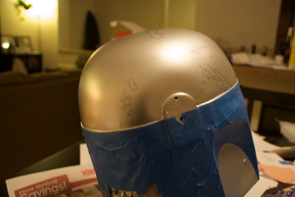

This part was a little bit scary. I marked off areas on the rf ear where I planned to sand it off to:
http://www.robertckrekel.com/miscima...fearmarks1.jpg
http://www.robertckrekel.com/miscima...fearmarks2.jpg
http://www.robertckrekel.com/miscima...fearmarks3.jpg

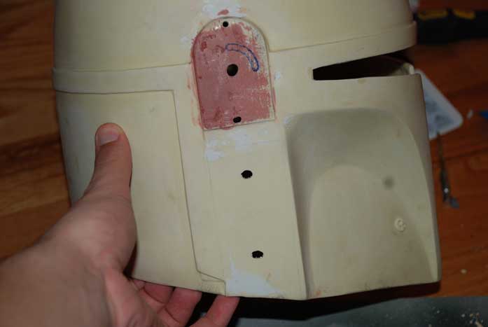

I then took the plunge and started going to town with the dremel. I did get away from me a few times but it did not cause any major damage that wont be fixed with putty and bondo.
http://www.robertckrekel.com/miscima...fearsanded.jpg
I got a little worried that I had taken too much off so I started to fill the area with a few layers of bondo.
http://www.robertckrekel.com/miscima...rfearbondo.jpg
After looking at my references again I am not not sure if I went far enough on the bottom part of the RF ear. I think this weekend I am going to grind some more off of it and see how the RS ear cap fits on it.
Once I figure out the proper height of the earcap base all that is left is to coat the inside with fiberglass using this kit:
http://www.robertckrekel.com/miscima...fiberglass.jpg

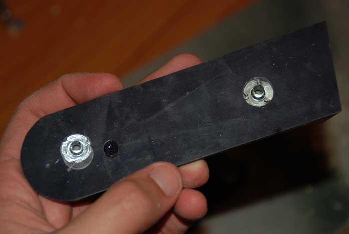

After that I will install my Visor using Spideyfett's super cool removable visor method using t-nuts.
After that some priming, some sanding, possibly some filling(if needed) and some more priming.
and then... PAINT!

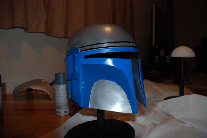

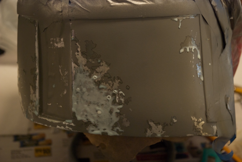

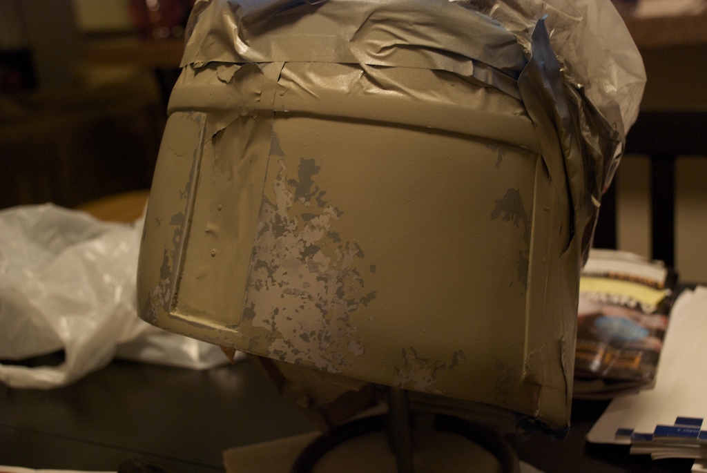

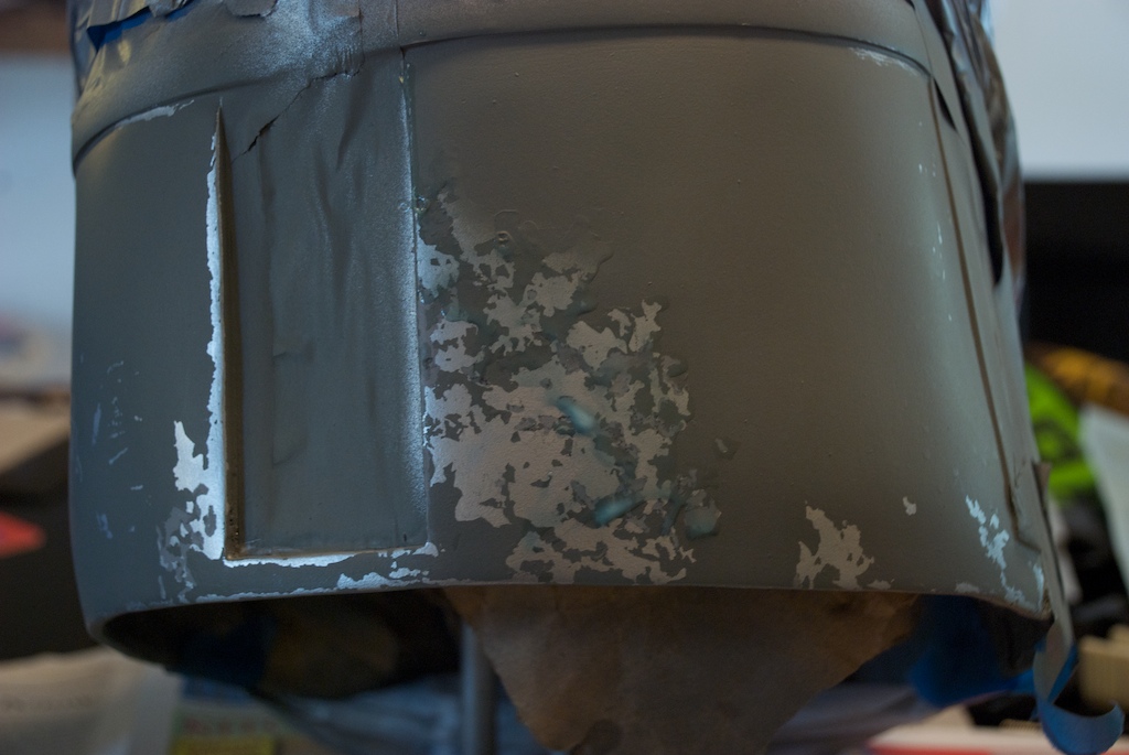

Update May 1st 2007:
I know its been a while since my last update but I have been working on my bucket among other things over the last few months.
This is kinda of a teaser for a more thorough update when I transfer the rest of the pics off of my camera.
http://www.robertckrekel.com/miscima...ba/newears.jpg
Yes, those are rouge studios ears on a sgt fang bucket :fettesb
Here's some teasers of the other things I've been working on, appropriate threads to follow in the future.
I've had a similar accident. I have a couple cracks in mine and want to reinforce mine too. This is my first bucket and I got a few questioins...
What is CA glue? What kind of putty did you use? Allso What do you use to do a fiberglass reinforcement of the inside of the helm? I saw a resin coating and was told to use fiberglass cloth with it? Would that work? If you got any name brands that you like can you list them?
Thanks for your help!
CA glue is a think clear glue that can be used to fill small gaps. The brand I used is "Zap a Gap" it can be found at any hobby shop.
The putty is white squadron, its available at almost any hobby shop as well.
As for fiber glassing I used the kit pictured at the bottom of post #31. The kit comes with the fiberglass resin and the cloth. Here's a pic of the kit:
I bought this kit at the Autozone down the street from me. It was really easy to use. Just mix small amounts of the fiberglass resin and the hardener at a time. I mistakenly mixed the whole bottle of resin and tube of hardener and ended up with it becoming solid in about 5 minutes. (I had to get a second kit :( )

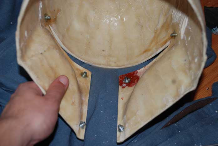

Ok first on the update I fiberglassed the inside finaly. It didnt come out a smooth as I had hopped as there are a few gators inside. Nothing too bad but still not as smooth as I had wanted.
http://www.robertckrekel.com/miscima...ssedinside.jpg
I then moved on and drilled my holes for the screws that I was planning on useind to secure the ears to the bucket. After the holes were drilled I held the ears on and marked them with a marker through the hole. I made the holes slightly oval because I wanted to give my self a little play room so that I could line the ears up 100% perfect.
http://www.robertckrekel.com/miscima...oba/lholes.jpg
http://www.robertckrekel.com/miscima...oba/rholes.jpg
http://www.robertckrekel.com/miscima...ba/rfholes.jpg

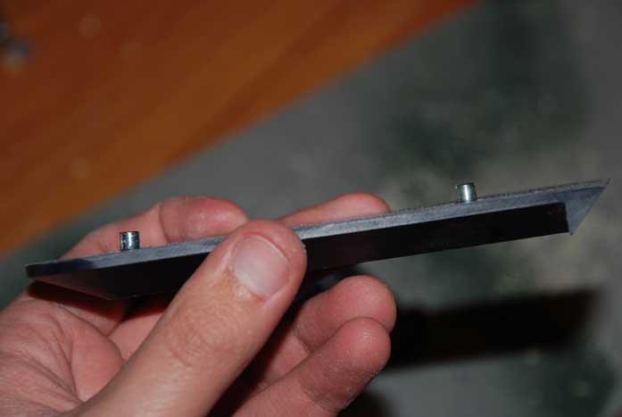

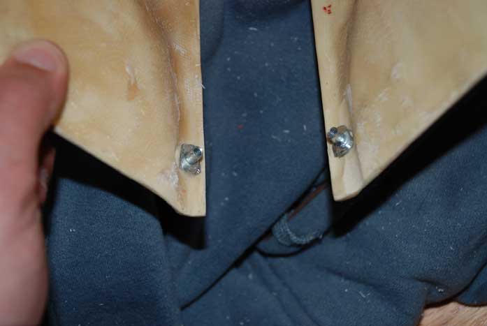

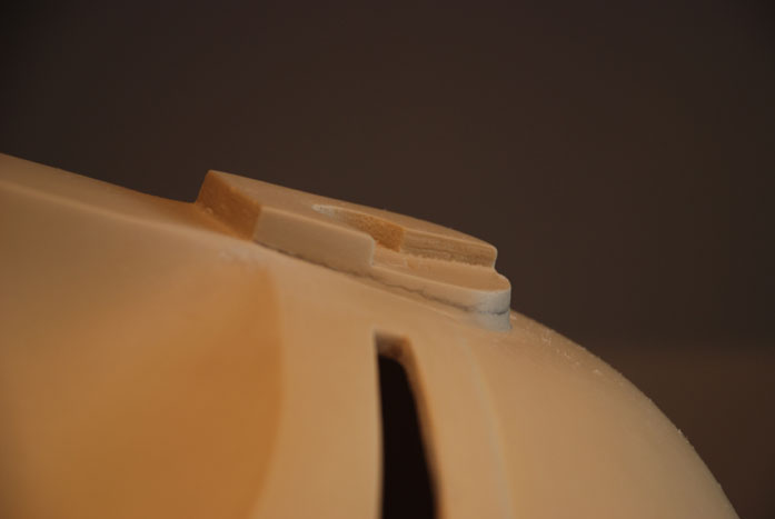

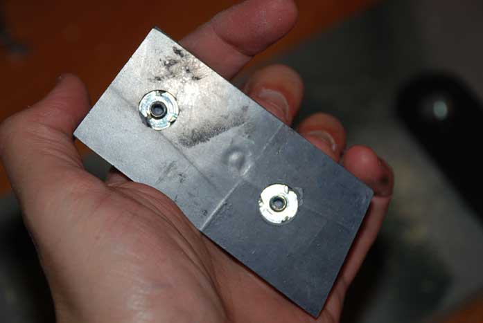

For my ears I decided to make them removeable like my visor. I used a fostner bit to sink some tenuts in the the ears them selves then glued them in with some 2 part epoxy.
http://www.robertckrekel.com/miscima...boba/lear1.jpg
http://www.robertckrekel.com/miscima...boba/lear2.jpg
http://www.robertckrekel.com/miscima...boba/rear1.jpg
http://www.robertckrekel.com/miscima...boba/rear2.jpg

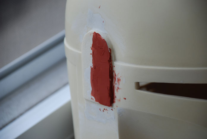

Unfortunatly when I was useing the fostner bit to sink areas for my tnuts inside the bucket I went a little too far and actually ended up going all the way through the mandible. Nothing a little bondo won't fix though!
http://www.robertckrekel.com/miscima...a/holesfix.jpg
Heres the inside of the bucket with the tnuts installed I made kind of a mess of the insdie of the bucket with the epoxy but its not big deal because I am planning on painting the inside anyway.
http://www.robertckrekel.com/miscima...oba/tnuts1.jpg
http://www.robertckrekel.com/miscima...oba/tnuts2.jpg
http://www.robertckrekel.com/miscima...oba/tnuts3.jpg
http://www.robertckrekel.com/miscima...oba/tnuts4.jpg
After some more sanding I finally threw a coat of primer on the bucket. Its actually starting to look like a good bucket! I still need to do some more finish sanding and a little bit more filling here and there but it will soon, and finally, be ready for paint!
http://www.robertckrekel.com/miscima...oba/primer.jpg

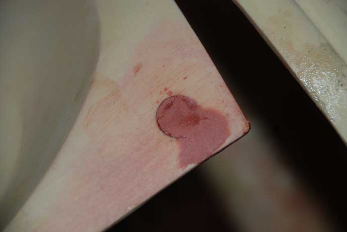

You can see here the hole repair went pretty well.
http://www.robertckrekel.com/miscima...fix_primer.jpg

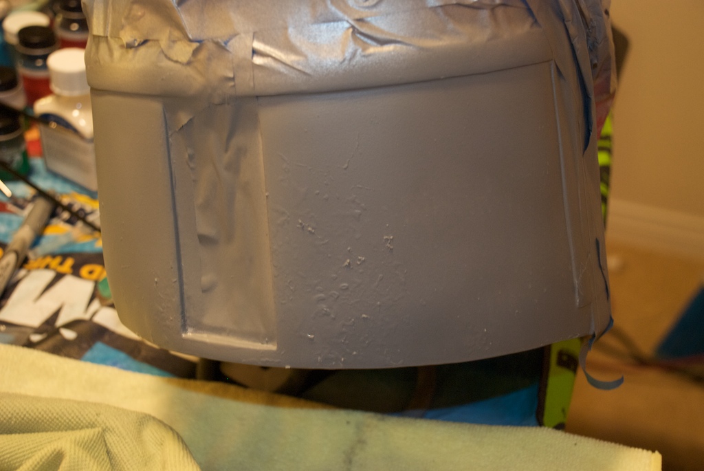

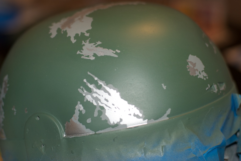

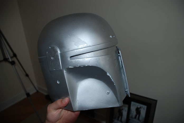

Fist I coated the whole thing down with a coat of bright silver. I let that dry for a good 24 hours and then I started to trace on damage and apply masking fluid:
http://www.robertckrekel.com/miscima...iquidmask1.jpg
http://www.robertckrekel.com/miscima...iquidmask2.jpg
http://www.robertckrekel.com/miscima...iquidmask3.jpg

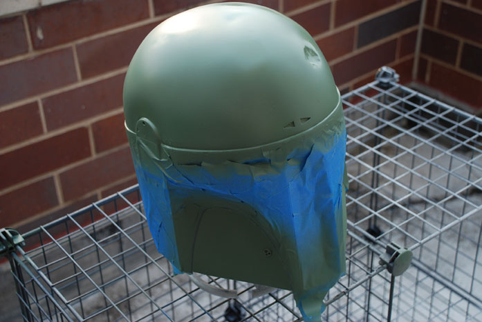

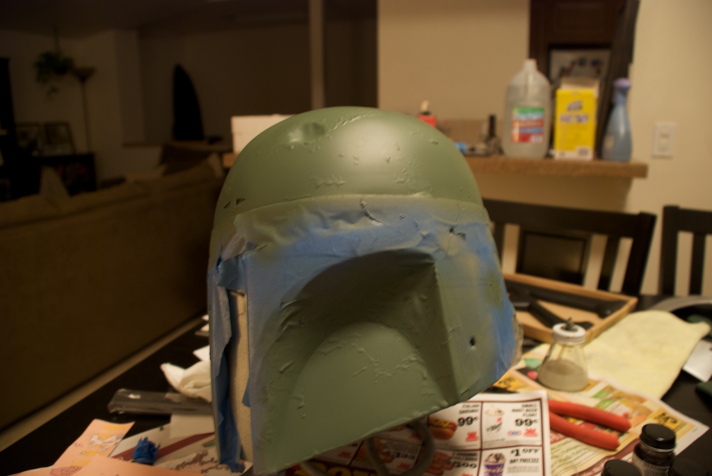

After the liquid mask dried I put on 2 coats of POG green:
http://www.robertckrekel.com/miscima...gboba/pog1.jpg
http://www.robertckrekel.com/miscima...gboba/pog2.jpg

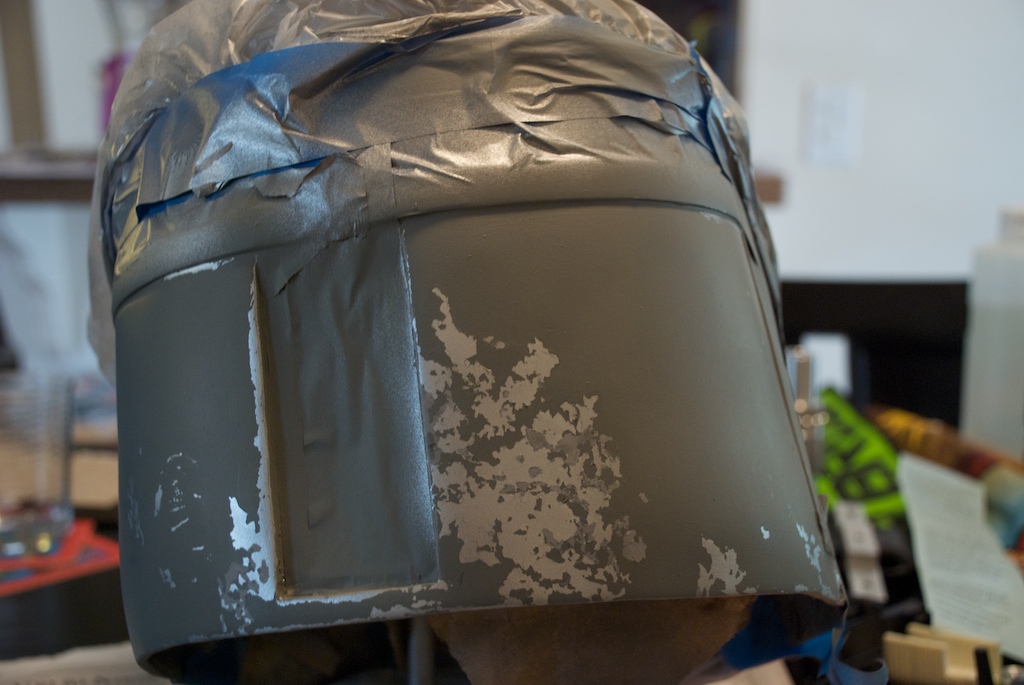

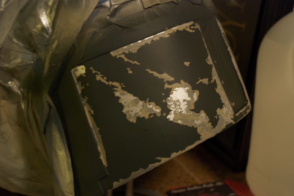

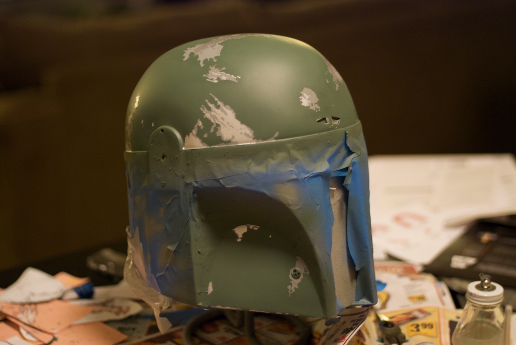

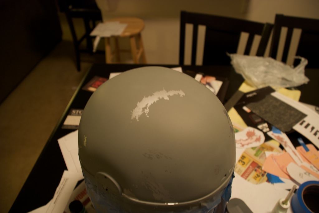

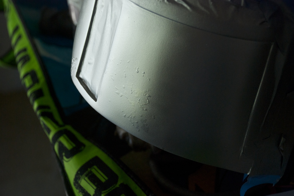

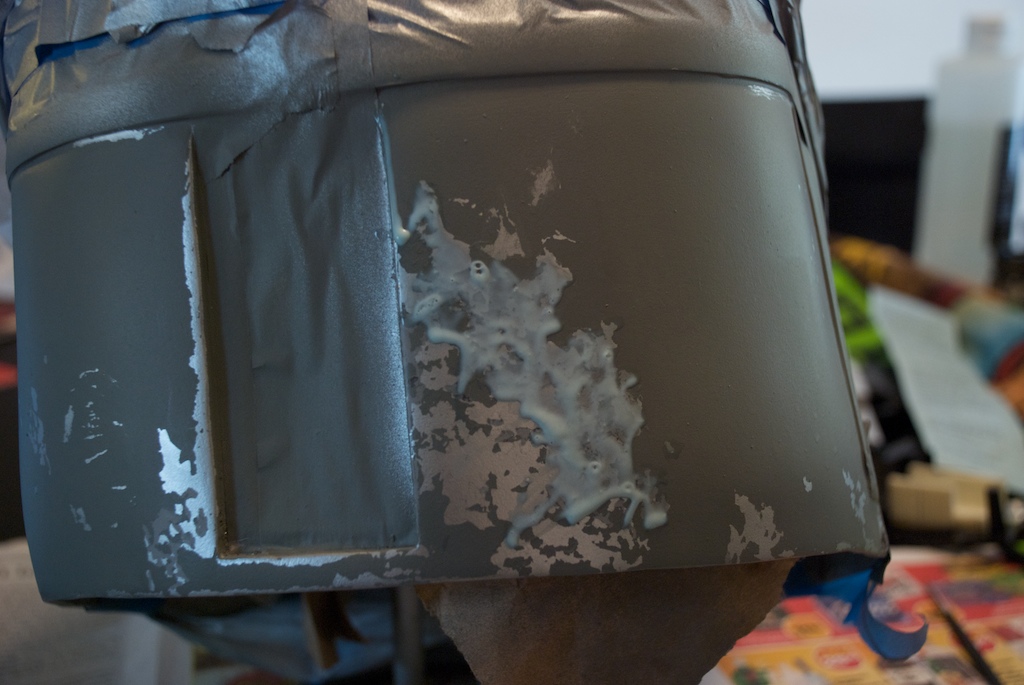

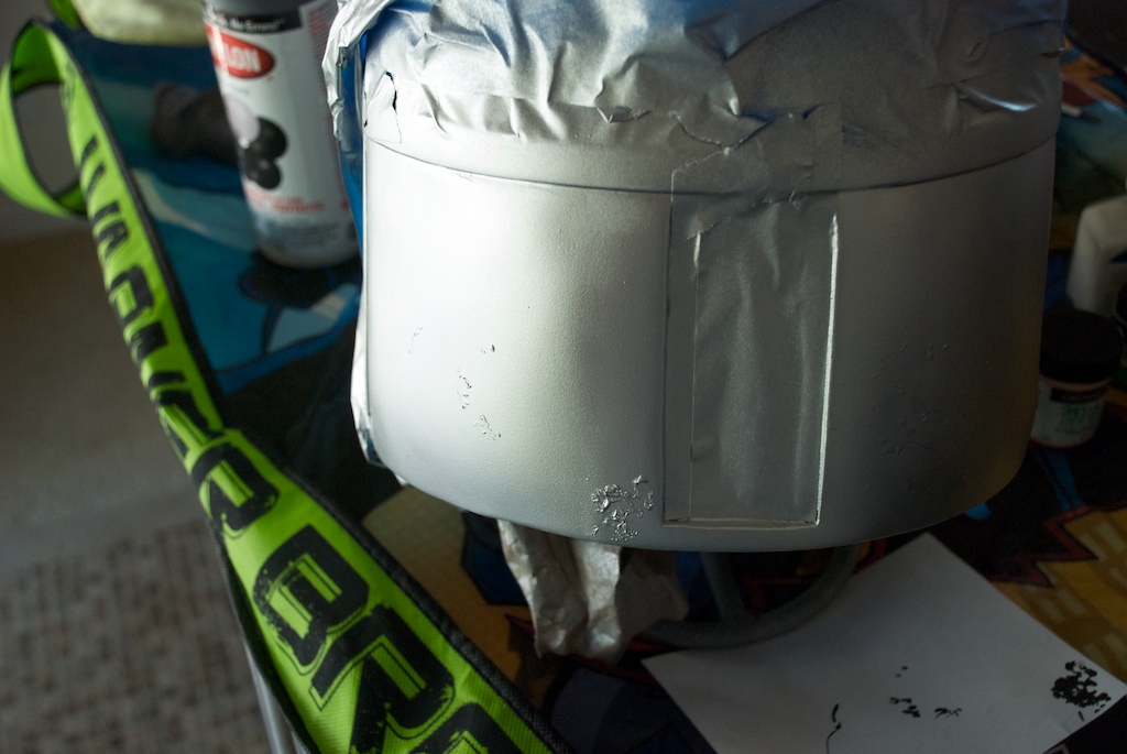

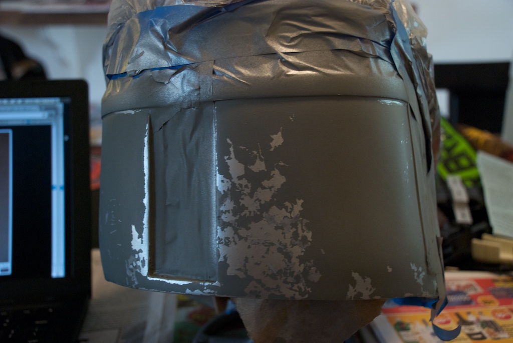

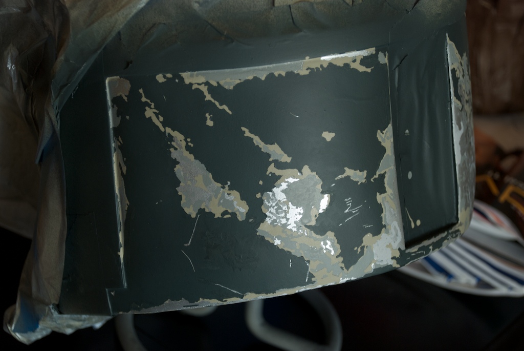

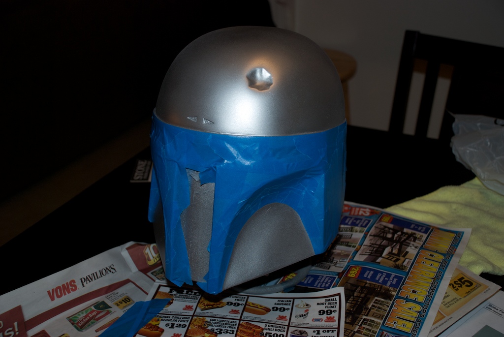

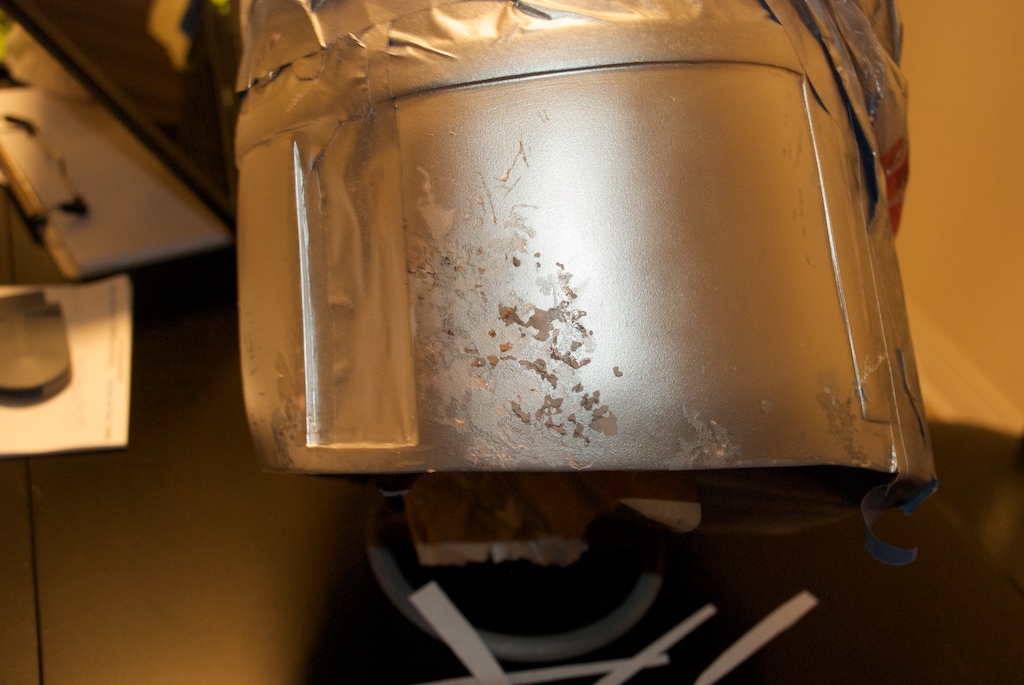

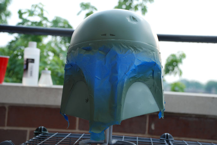

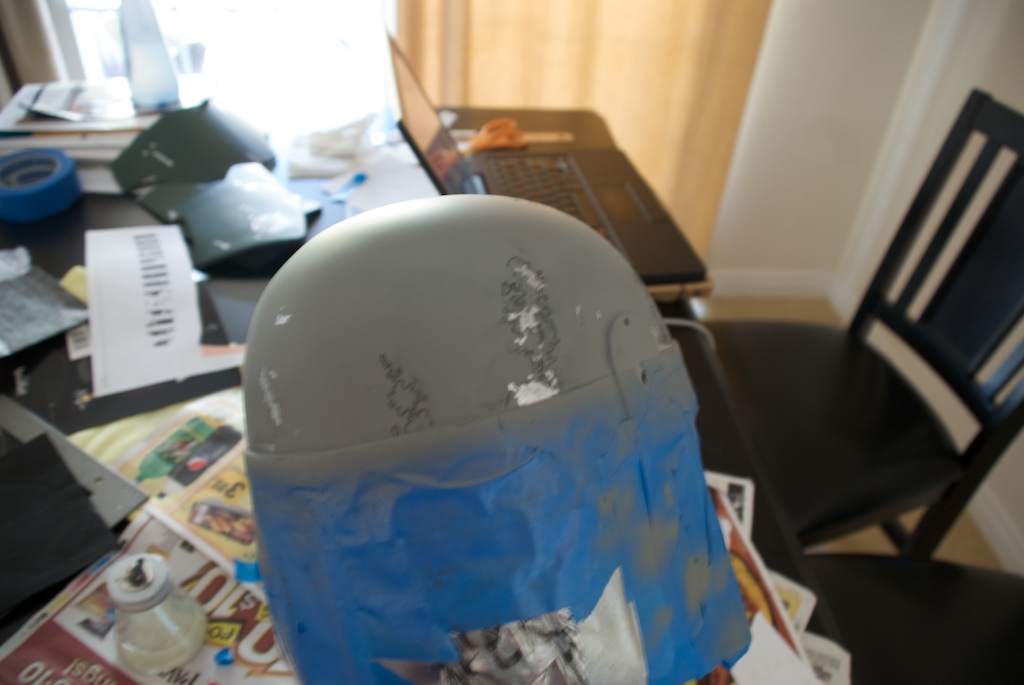

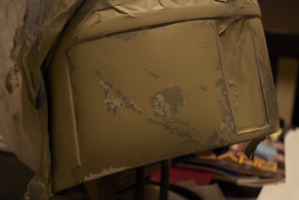

After the pog green was dry I then masked off the mandibles and painted on the caboose. When the caboose dried I hand painted the prr brunswick green on the checks.
Unfortunately the masking tape I used ended up pulling up a lot of the pog green. and didn’t do a great job on the cheek areas. Here is the results with the liquid mask removed:
http://www.robertckrekel.com/miscima...problems_1.jpg
http://www.robertckrekel.com/miscima...problems_2.jpg
http://www.robertckrekel.com/miscima...problems_3.jpg

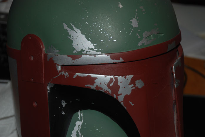

I attempted to do some cleaning up of the areas that had paint pulled up but ended up screwing up the evenness of the pog coat. This weekend I plan to strip it all down to primer and start over. Its a learning process so I don’t mind. There are more buckets in my future so I want to make sure I do as much learning and make as many mistakes as possible on the first one.

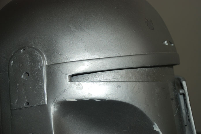

I'm back people. After a long lay off a failed relationship and a cross country move I'm finally back and I plan on starting up this thread and my work on the fett again. :D

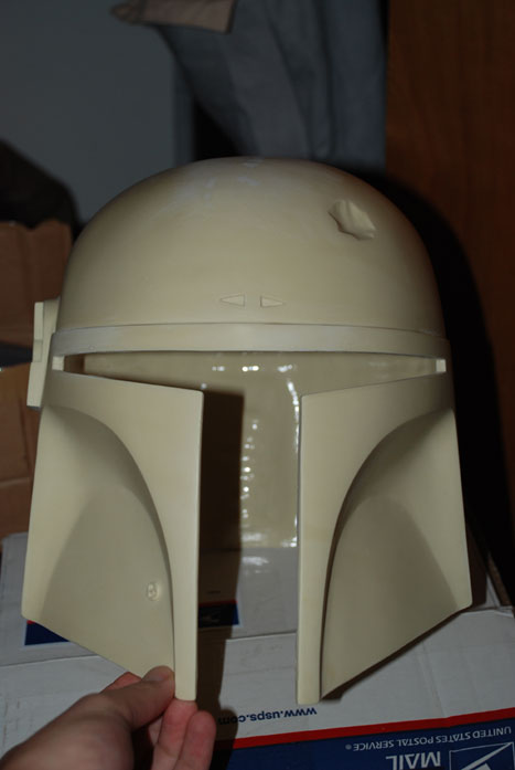

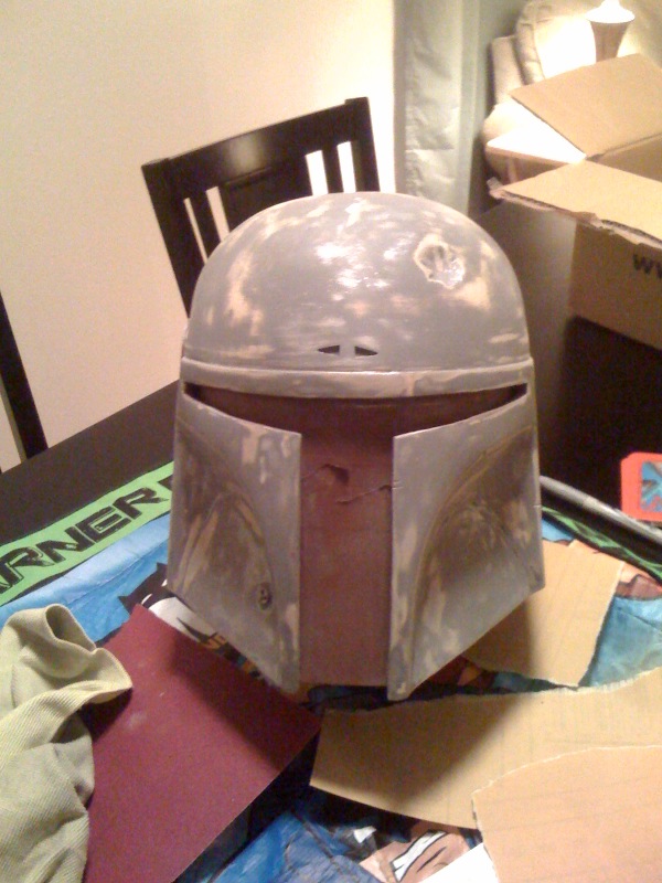

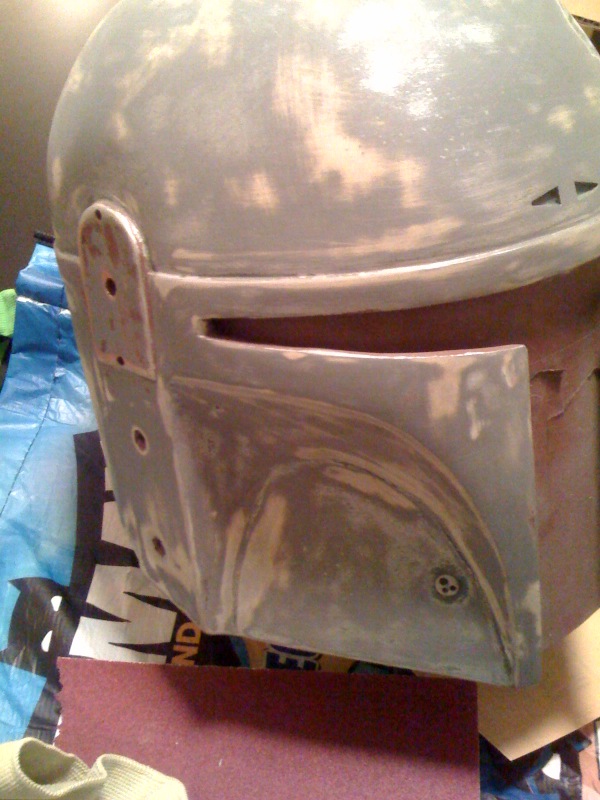

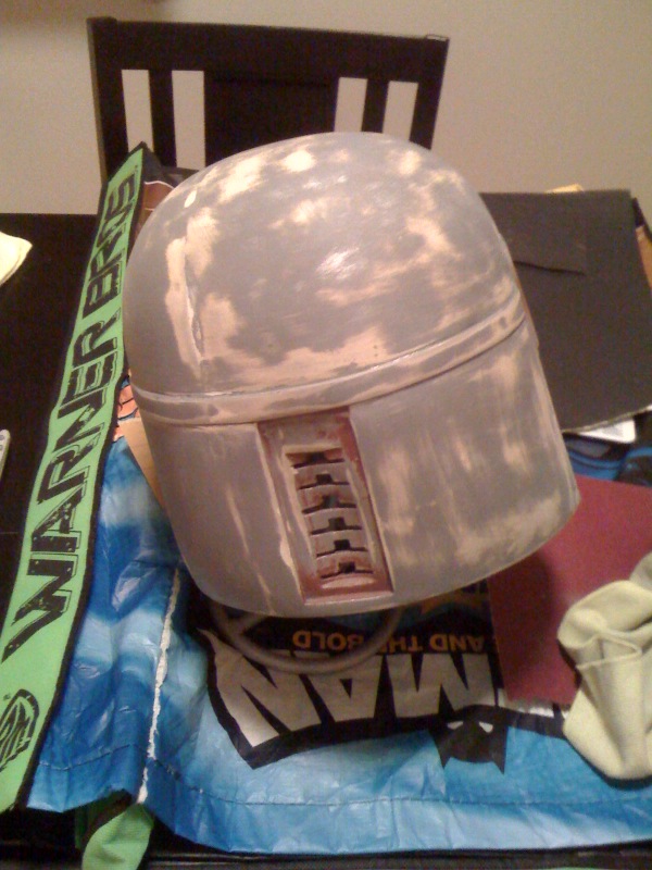

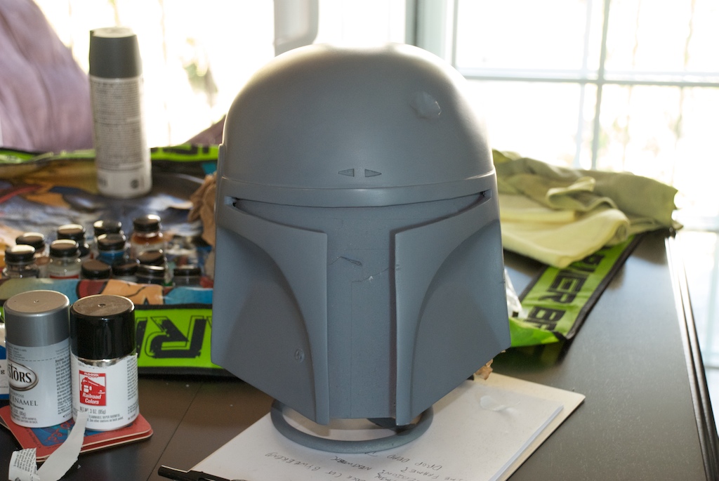

With the power of Necromancy I bring this thread back from the dead... again(again)!

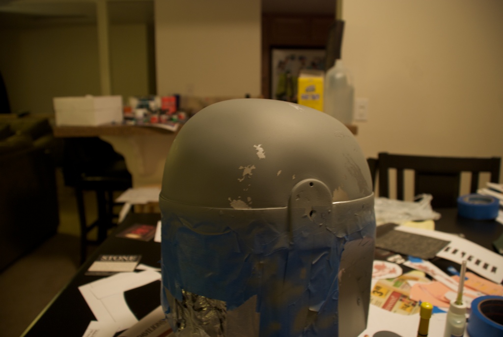

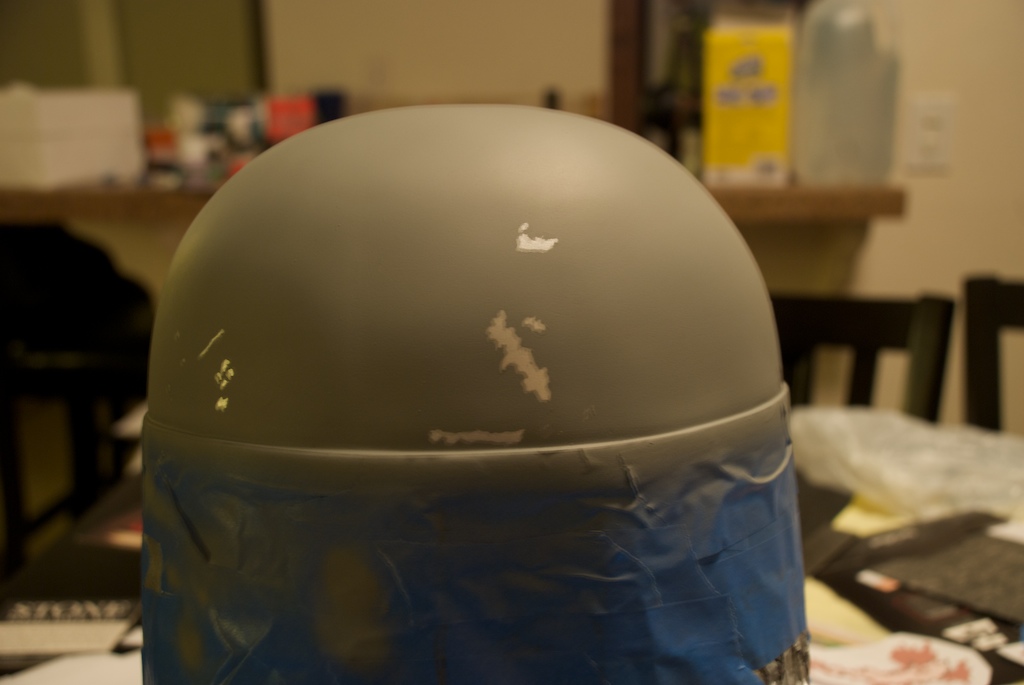

With a new commitment to get this thing done I took it out of storage tonight and sanded it down to primer:
http://www.robertckrekel.com/miscima...toPrimer_1.jpg
http://www.robertckrekel.com/miscima...toPrimer_2.jpg
http://www.robertckrekel.com/miscima...toPrimer_3.jpg

Dude 3 YEARS TO PAINT IT UP only to strip it back and start again
Yes, sadly it needed to be done. I'm going to try an all layered method. I discovered that all my paint had dried out from may many moves so I need to pretty much buy everything all over again. then I can get started. I'll probably hit it with some grey primer tonight though.

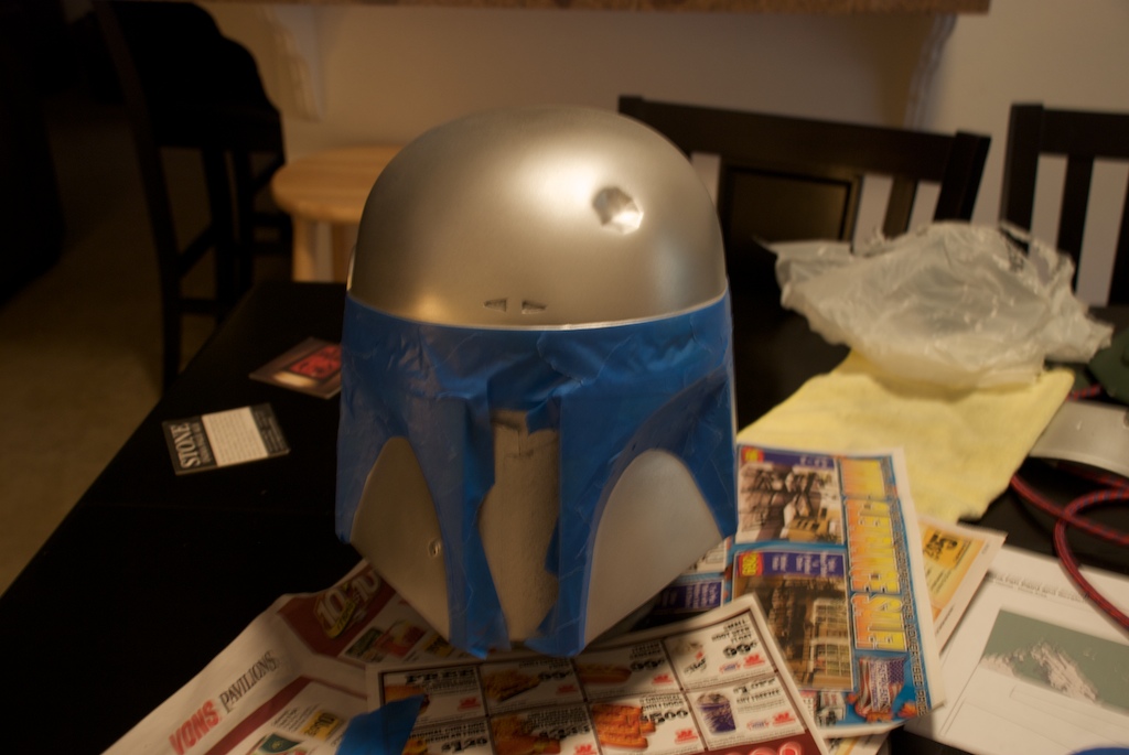

Re-primmed and sanded ready for paint:
http://www.robertckrekel.com/miscima...NewPaint_1.jpg

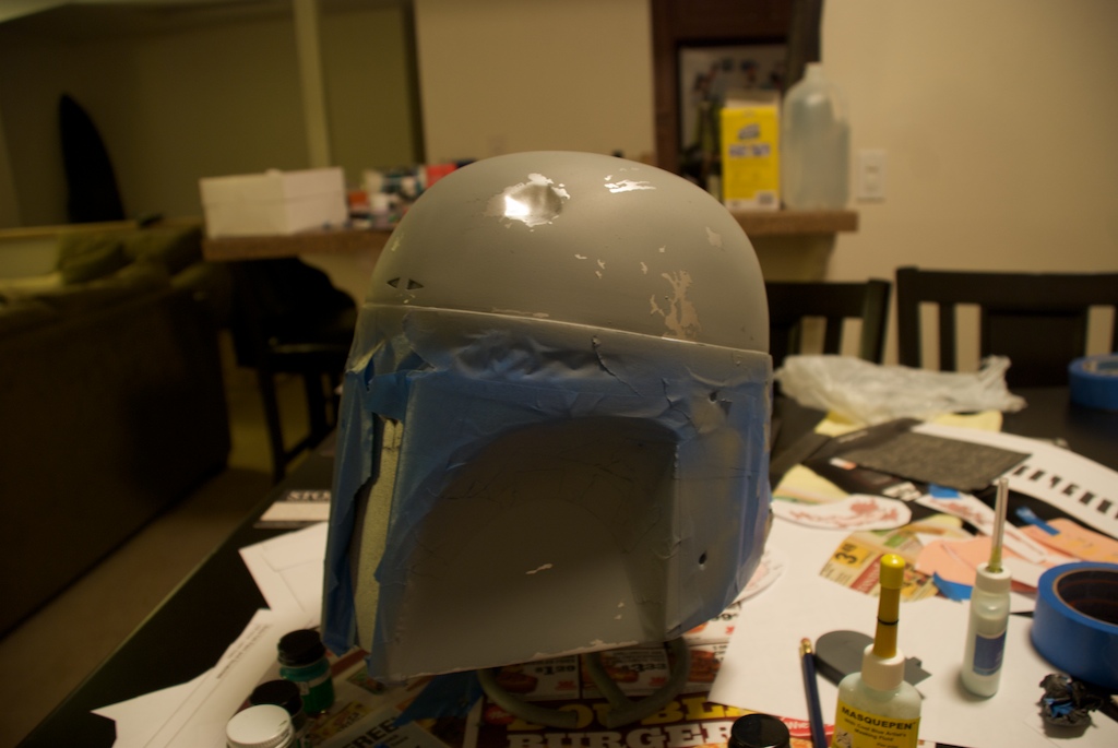

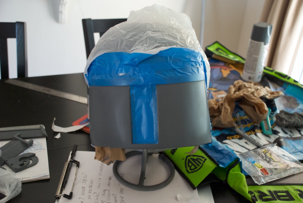

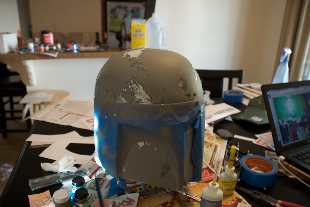

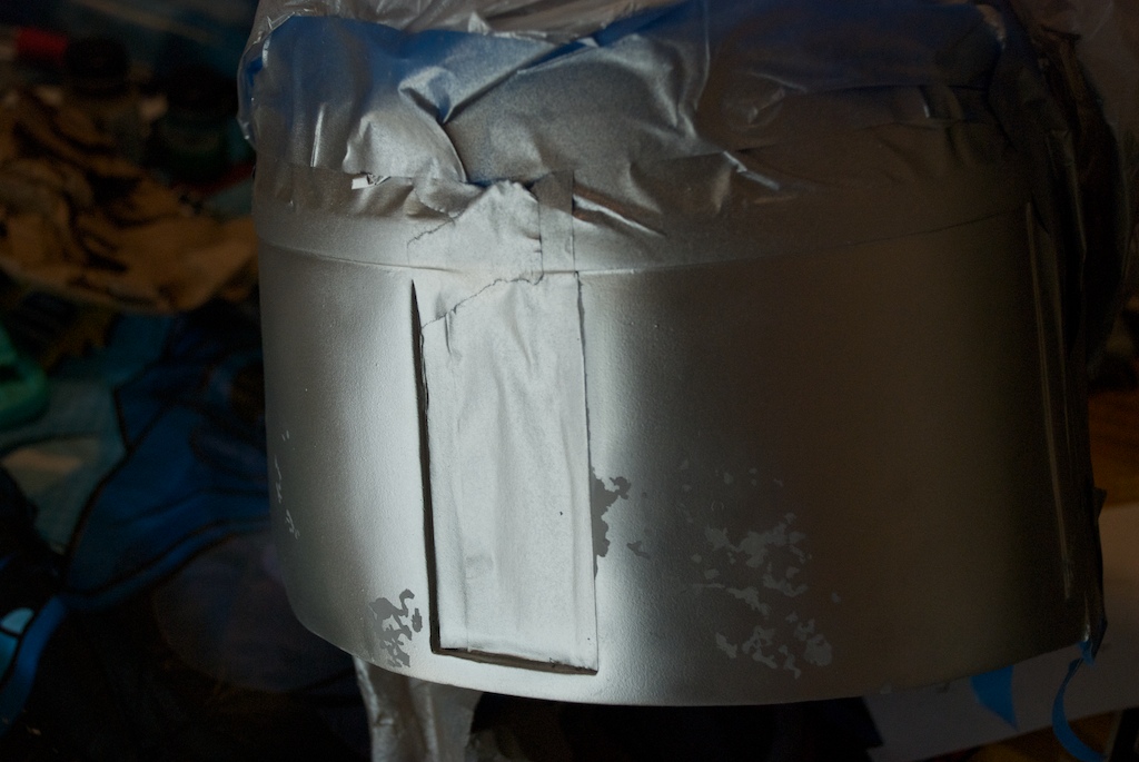

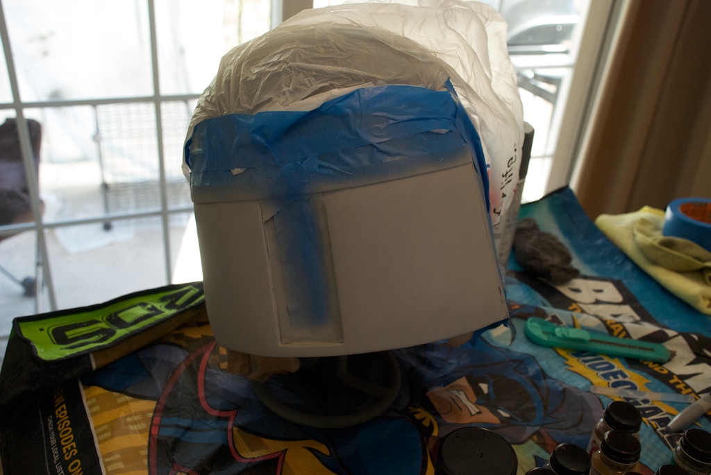

I decided to start with the rear panels this time around so I masked everything else with blue painters tape and a plastic bag.
http://www.robertckrekel.com/miscima...NewPaint_2.jpg

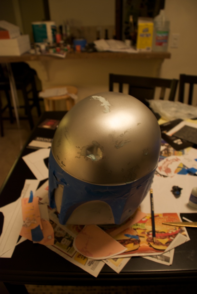

I started with Poly Scale Light Gray L-5:
http://www.robertckrekel.com/miscima...NewPaint_3.jpg
I broke out my Airbrush and layed down two thin coats:
http://www.robertckrekel.com/miscima...NewPaint_4.jpg

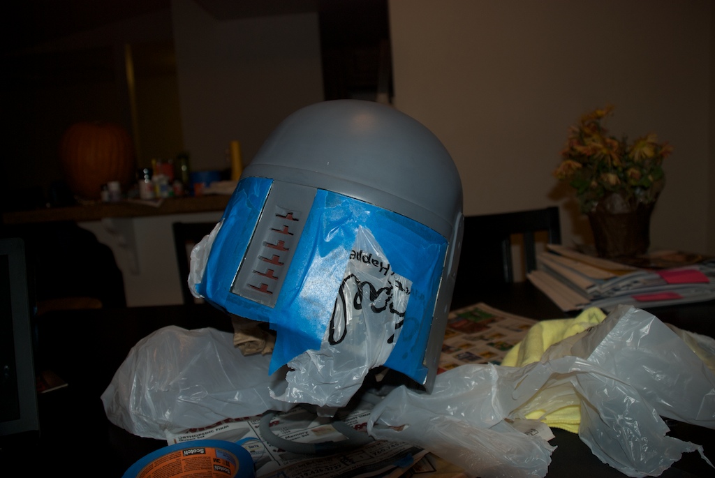

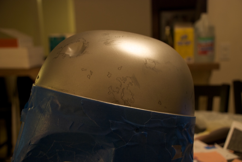

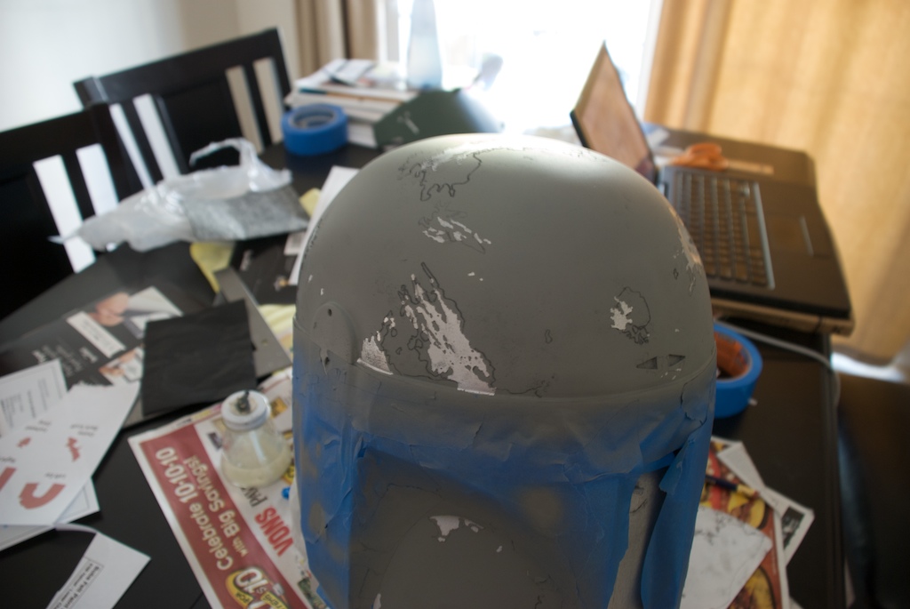

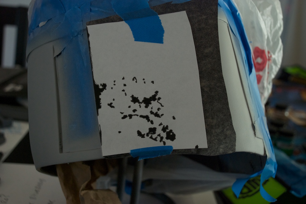

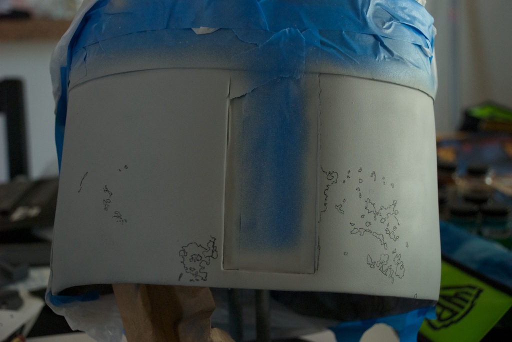

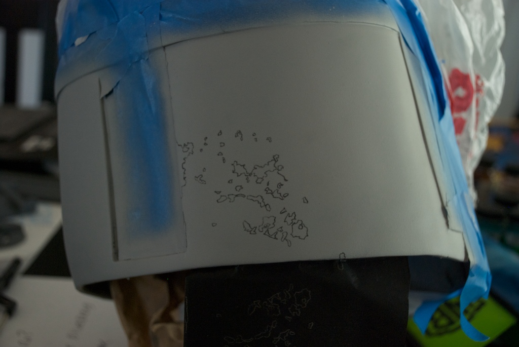

I scaled up and printed out the templates from Rich D. then I grabbed some Graphite transfer paper and put it under the template print out. I then lined them up on the back of the helmet and taped them down:
http://www.robertckrekel.com/miscima...NewPaint_5.jpg
The Graphite Transfer paper worked out really well.
http://www.robertckrekel.com/miscima...NewPaint_6.jpg
http://www.robertckrekel.com/miscima...NewPaint_7.jpg
I then used masking fluid to cover the stencil lines and sprayed on bright silver (not picutred)
I'm gonna allow this to dry overnight then I'll peel back the masking fluid.
Cheers!

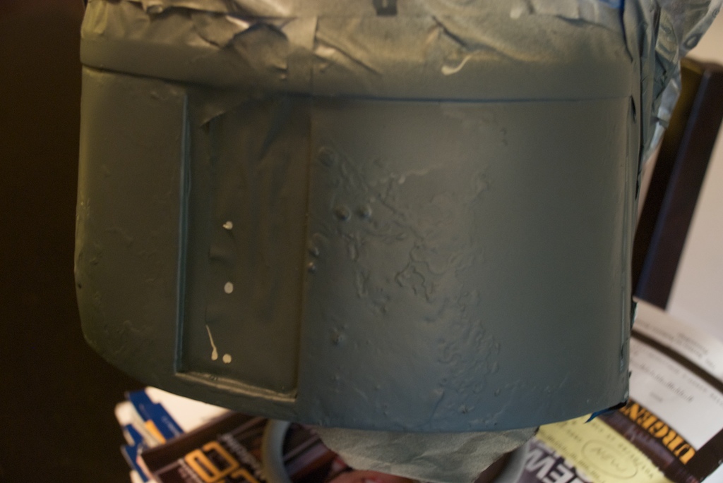

Here is the rear with the light grey masked sprayed with Bright Silver:
http://www.robertckrekel.com/miscima...eferGrey_8.jpg
http://www.robertckrekel.com/miscima...eferGrey_9.jpg
Here is where the mask is removed and the light grey is exposed:

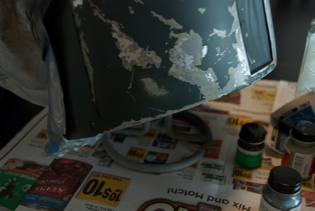

I then repeated the process of tracing the silver damage backed with graphite transfer paper. The graphite transfer paper didn't quite work as well on the bright silver but it worked well enough to mask the damage with miskit.
http://www.robertckrekel.com/miscima...eferGrey_4.jpg
Poly Scale Reefer Grey:
http://www.robertckrekel.com/miscima...eferGrey_3.jpg
The Rear panels after two light coats of the Reefer Grey were spray over the masked silver and light grey damage.
http://www.robertckrekel.com/miscima...eferGrey_1.jpg
http://www.robertckrekel.com/miscima...eferGrey_2.jpg

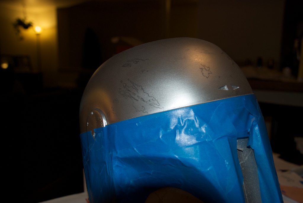

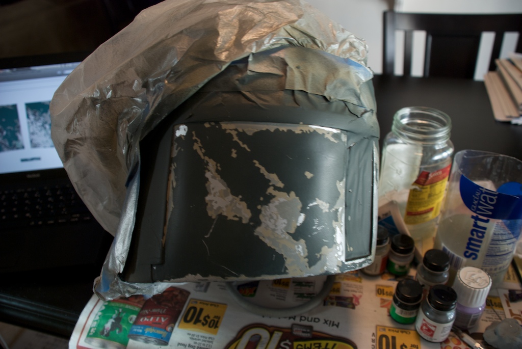

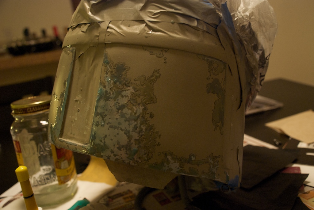

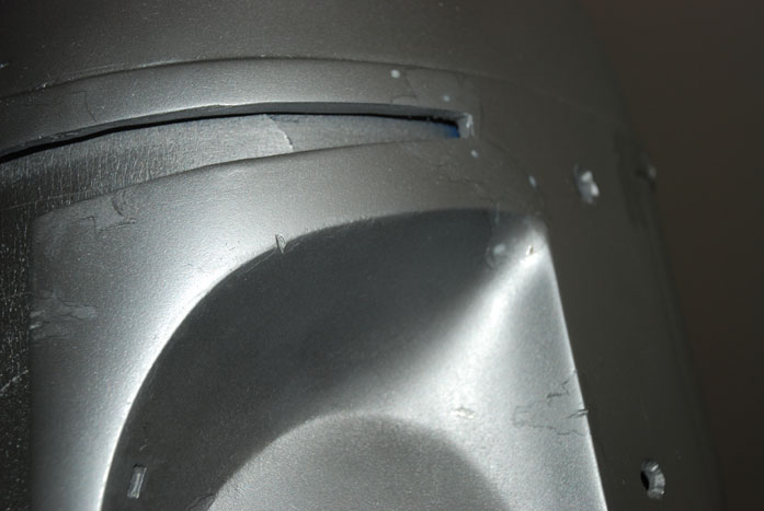

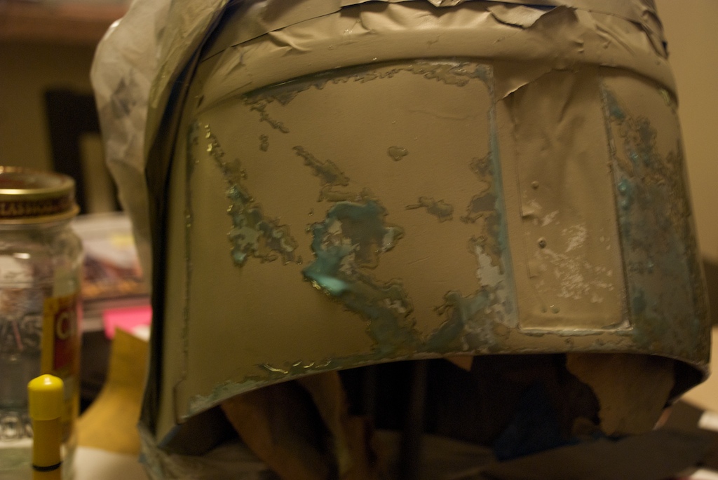

Update 10/17/2010:
I peeled off the masking fluid:
http://www.robertckrekel.com/miscima...grey_fix_1.jpg
I noticed that the masking fluid actually peeled off more of the Reefer Grey than I wanted so I ended up Re-masking a small area and doing a quick touch up with my airbrush:
http://www.robertckrekel.com/miscima...grey_fix_2.jpg
I got a new masking fluid called Masque Pen. It's great especially the very fine supernib version. It's pretty much the new standard in masking for me.
http://www.robertckrekel.com/miscima...grey_fix_3.jpg
http://www.robertckrekel.com/miscima...grey_fix_4.jpg
Much Better:
http://www.robertckrekel.com/miscima...grey_fix_5.jpg

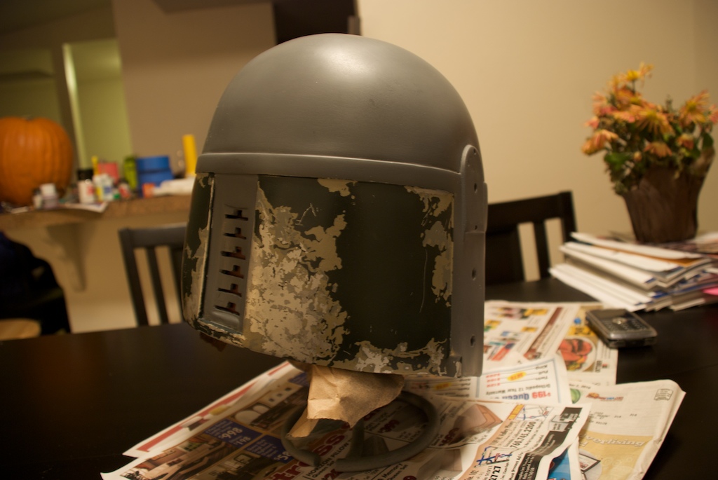

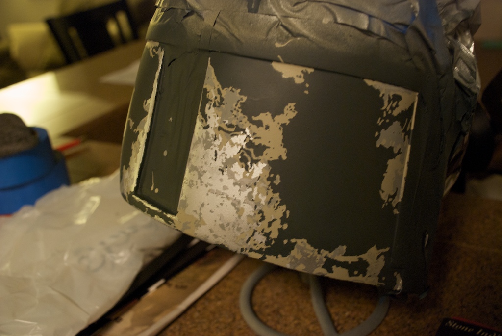

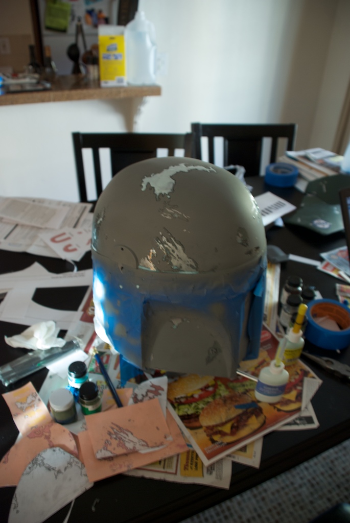

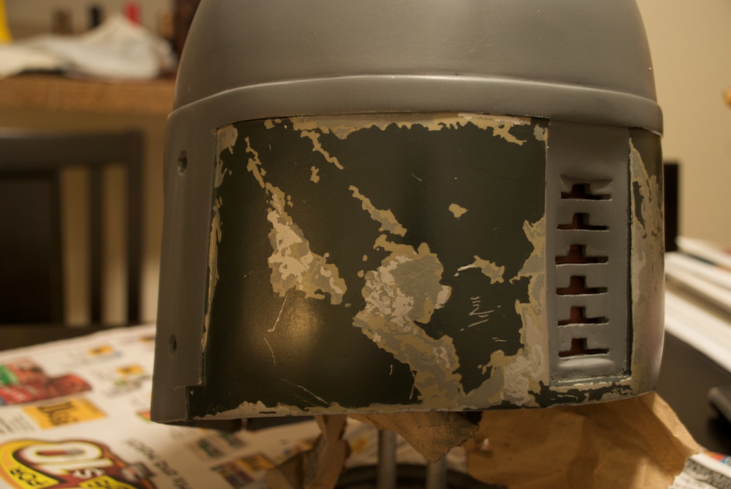

Update! 10/28/2010:
Finally squeezed out a few more hours to work on the bucket.

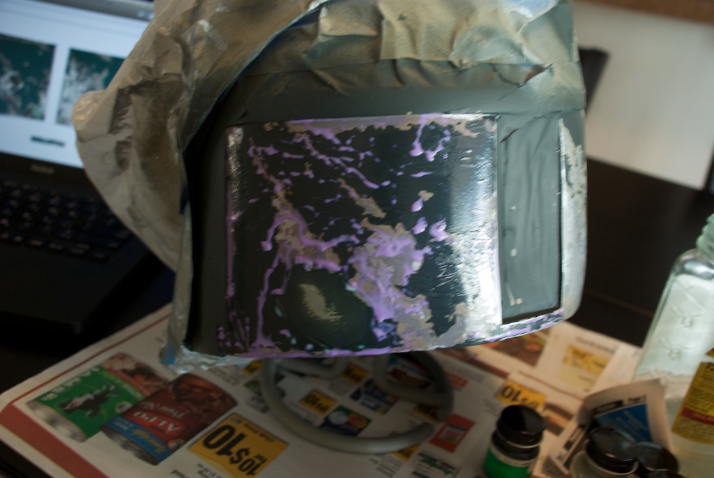

I did repeated the same trick as I've been using with graphite paper under a template.
This time I traced the Concrete damage on:
http://www.robertckrekel.com/miscima...concrete_5.jpg
Here's the Concrete I used. It's PollyScale Acrylic.
http://www.robertckrekel.com/miscima...concrete_1.jpg
I sprayed it on in about 3 very thin even coats. I usually water down my acrylics about 3 parts paint to 1 part distilled water(over even less) Just enough so it flows smooth through the air brush with no stopping or sputtering.
http://www.robertckrekel.com/miscima...concrete_4.jpg
This evening I removed the liquid mask to layers beneath:
http://www.robertckrekel.com/miscima...concrete_2.jpg
http://www.robertckrekel.com/miscima...concrete_3.jpg
So far I'm really happy with how everything is going. I just wish I had more time AND that the painted dried and cured faster than 24 hours. Being patient is hard.
Next up is the final layer on the rear panels the RLM73 Green. Then it will be on to the Dome!

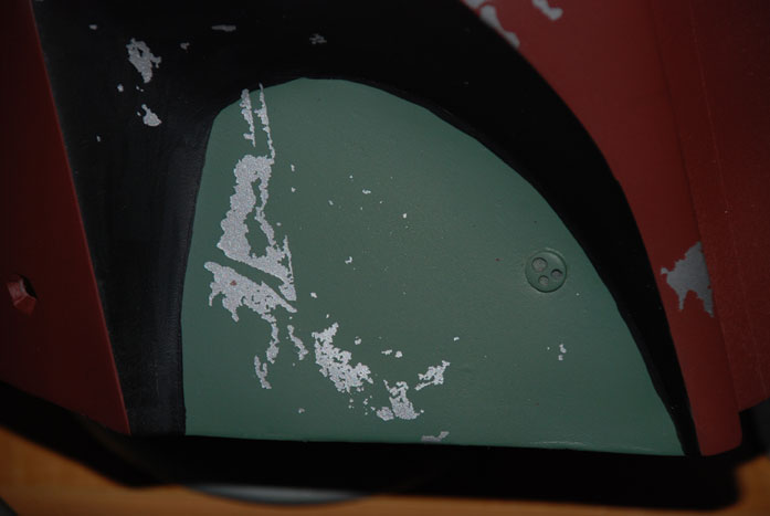

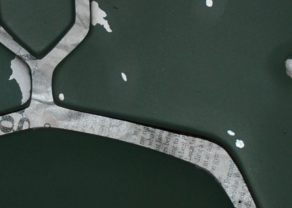

Update! 10/1/2010:
I traced the concrete damage on to the helmet via the stencil/graphite paper method.
http://www.robertckrekel.com/miscima...rlmgreen_1.jpg
http://www.robertckrekel.com/miscima...rlmgreen_2.jpg
I used Polly Scale German RLM 73 Green for the rear panels main color.
http://www.robertckrekel.com/miscima...rlmgreen_4.jpg
http://www.robertckrekel.com/miscima...rlmgreen_3.jpg
Tonight I peeled off the masking fluid to revel the final rear panel.
http://www.robertckrekel.com/miscima...rlmgreen_5.jpg
http://www.robertckrekel.com/miscima...rlmgreen_6.jpg
There is a little sagging on the left side that I might sand down slightly and re-spray. After that I'll start doing the fine scratch detail with a needle and an exacto knife. After that I'll seal the back with Testors Semi gloss Lacquer. I'm planning on dull coating the whole bucket once the paint is done so I'm not worried about the slight shine.

I added a bunch of the fine scratches as well as touched up a number of areas with topical application of many colors.
http://www.robertckrekel.com/miscima...ckdetail_1.jpgI also sanded down a small area that had some paint sagging.
http://www.robertckrekel.com/miscima...ckdetail_2.jpg
then I masked the surrounding area with humbrol maskol. It works great for large blanket masks like this.
http://www.robertckrekel.com/miscima...ckdetail_3.jpg
The Patch turned out pretty well:
http://www.robertckrekel.com/miscima...ckdetail_4.jpg
Then I used model masters semi gloss to seal the back panels. That way I won't repeat my mistakes of having paint come up from the masking tape when painting other parts.
http://www.robertckrekel.com/miscima...ckdetail_5.jpg
The finish is kind of like satin. Its not too glossy but really its only to protect the layers below. I'm going to wash and dullcote the whole helmet once all the paint is on.
http://www.robertckrekel.com/miscima...ckdetail_6.jpg
http://www.robertckrekel.com/miscima...ckdetail_7.jpg
Then I masked the rear panels so that I could spray Bright Silver on everything else.
http://www.robertckrekel.com/miscima...ckdetail_8.jpg
http://www.robertckrekel.com/miscima...ckdetail_9.jpg
I'm going to start with the upper cheeks then move onto the dome and lower cheeks and finish off with the mandibles.

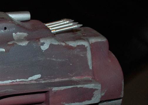

2 Attachment(s)
Have you thort about making platforms for thears to go on ,Attachment 48175Attachment 48174
This is my fang with them added Bad pics but you get the point just seeing your putting so much efort in to it , it could make it that littl bit more acurate
I thought about doing the platforms but I'm too far along into painting at this point to go backward and do more prep type work. This isn't the last bucket I'm gonna do. I have an MS3 that was gonna be my RotJ but will probably be my ESB v2 as I'm also signed up to get a GMH bucket which will be my RotJ.

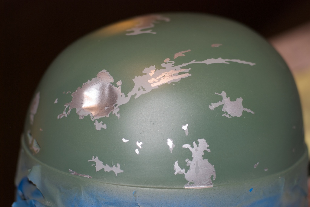

Update 11/28/2010:
Finally got some more time to paint. Holiday weekends are great for that.
I sprayed on Testors Chrome from a can after masking the mandibles.
http://www.robertckrekel.com/miscima...eygreen_18.jpg
Now there isn't any complete Stencil set for the dome. So i ended up using some of Rich D's Stencils as well as some hours starring and tracing ref pics via superjedi's stencil method. I got most of the silver damage traced on the helmet that way.
http://www.robertckrekel.com/miscima...eygreen_17.jpg
http://www.robertckrekel.com/miscima...eygreen_16.jpg
http://www.robertckrekel.com/miscima...eygreen_15.jpg
http://www.robertckrekel.com/miscima...eygreen_14.jpg
I once again used the Masque Pen masking fluid to mask all the traced damage:
http://www.robertckrekel.com/miscima...eygreen_13.jpg
Then I Sprayed Floquil Reefer Grey:
http://www.robertckrekel.com/miscima...eygreen_12.jpg
After a good 24 hour cure I peeled back the masking fluid to revel the chrome.
http://www.robertckrekel.com/miscima...eygreen_11.jpg
http://www.robertckrekel.com/miscima...eygreen_10.jpg
http://www.robertckrekel.com/miscima...reygreen_9.jpg
http://www.robertckrekel.com/miscima...reygreen_8.jpg
http://www.robertckrekel.com/miscima...reygreen_7.jpg
Then the process is repeated for the grey + Chrome:
http://www.robertckrekel.com/miscima...reygreen_6.jpg
http://www.robertckrekel.com/miscima...reygreen_5.jpg
http://www.robertckrekel.com/miscima...reygreen_4.jpg
http://www.robertckrekel.com/miscima...reygreen_3.jpg
http://www.robertckrekel.com/miscima...reygreen_2.jpg
The I sprayed on 3 good coats of Panzer Olive Green:
http://www.robertckrekel.com/miscima...reygreen_1.jpg
Now I just need to wait the 24 hours for a good cure and I'll peel back the masking fluid. After that I paint topically additional details and xacto the more fine scratches in. The a coat of semi gloss to protect it when I mask it and move onto the mandibles.
Looking forward to getting on to the mandibles.

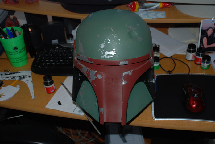

Just pulled back the masking fluid. I have to say I'm a bit disappointed. Reefer grey does not seem to be the right shade of grey to me. Maybe it's because its the Polly Scale acrylic version as oppose to an enamel? In fact most of the RS colors seem to be off. Maybe it's because I've been staring at reference photos exposed with a flash and such but over all the colors don't feel right. The RLM Green on the rear panel seems too dark. The Reefer Grey seems too light. The Panzer Olive Green seems too dark.
At this point I feel I'm too far along to start over again but its really nagging me. I supposed that I could hand paint the Reefer Grey areas with something like SP Lark Dark Grey.
http://www.robertckrekel.com/miscima...reenpeel_1.jpg
http://www.robertckrekel.com/miscima...reenpeel_2.jpg
The Flash, I think. really shows how the reefer grey is too light.
http://www.robertckrekel.com/miscima...reenpeel_3.jpg
http://www.robertckrekel.com/miscima...reenpeel_4.jpg
Looks just great from here. I'm amazed at your diligence and patience. It's really paying off. I really like the depth that having the various different colors on that back panel gives it. The panel jumps out at you like it's really been through hell. Nice work dude.
Anyone have opinions or advice on the grey?
With the flash that close it does look a bit light, however with some blackwash carbon over it I wouldn't really notice.
my 2cents
NikNak_aka
Honestly if you dont want to repaint brush it on a darker color...mix black with yuor reefer and go from there with some test strips?
Yeah i had the same issue with the first bucket I painted the reefer Gray is just to light and it does not matter if you use acrylic or enamel. I read in another thread to use SP Lark Dark Gray F110132 and have used it ever since. For the Dome and Cheeks I use Panzer Oliv Grun 1943 TES2097 and for the left ear cap i use Panzer Olive Green F505113
when I did ESB i had to mix my own...if you have the reefer and black may as well mix you up some urself...and apply by brushing it on or start over? Testing the paint before is what Id reccomend for the next time...swatches or some spare parts I use a spare knee armor I have to test colors out
I should have tested the paint first but I really figured that the RS list was as close as it got. Now I'm not so sure. I have both reefer grey and sp lark dark grey. I think that I'll make a mix of the two of those and hand paint it on. Pain in the butt. Really disappointed about the RS list.
deadland
Thats what I use... I think it was AFFO$'s suggestion in the 'airbrushed challenged' paint list. Comes out looking like a dark primer. Its perfect. ;)
