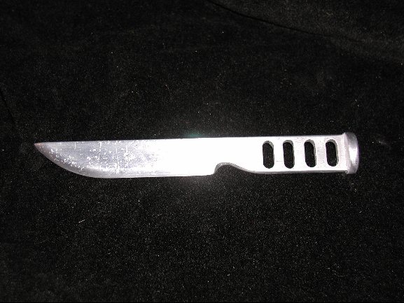

    Merged: Merged: Boba Fett Survival Knife finished (pics)
    I posted this over at the RPF and thought I would post it here as well.
    I received my survival knife from DL 44's project today. I did some grinding, filing, sanding and epoxying on it. Here is the finished results:
    Please forgive the reflections.
    Chris
  6. #6
    Migrate from As You Wish
    Guest
    Merged: Merged: Re: Boba Fett Survival Knife finished (pics)
    Here is how I did it:
    First I made a copy of the supplied drawing and cut out and taped it to the blade. Then sanded and filed down to the line on the drawing. I used some temperature curing epoxy I have to glue the disk to the blade, but I think room temp 2 part epoxys should work as well. I did not sharpen the blade, I left it the same thickness.
    For the point I first used a hack saw to remove some of the excess material, then used a disk sander to shape it.
    For the scallops I just used a standard bastard file.
    I used som 400 grit wet/dry sandpaper and wet sanded all surfaces to remove any scratches.
    Chris

    Merged: Re: survival knife specifics?
    Fettcicle - nice knife! I like it. Looks mean!
    Here's mine. I made it from 1/8" aluminum, and JB Weld Weathering is cheapo, flat black paint from Walmart, buffed off with steel wool.
