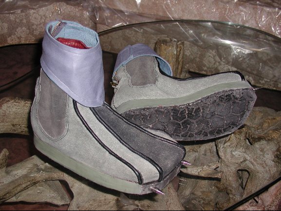

    <B>Merged:</B> MMM's Custom (what else?) Boots
    Here they are. Unashamedly, I'll start by saying the soles were from a pair of women's sandals I picked up at WalMart. I completely removed everything but the sole.
    On these soles, I sewed a one-piece upper, to create a high-topped shoe. To this, I sewed a piece like this _/ with velcro attached to the sides to create an "openable" tapered tube. So, to this kneee-high boot of canvas, I sewed strips of split leather in shingle fashion. I like the effect, and also use these with my Tusken outfit. The velcro opening runs nearly the entire length of the boot at the rear.
    The top one is with flash, the bottom is without. These have been weathered heavily in darkish brown.
  29. #29
    Packrat's Avatar
    Join Date
    Mar 2003
    Posts
    288
    Merged: Re: MMM's Custom (what else?) Boots
    Quite... custom. Look more like tusken boots than Mandalorian boots, though.
  30. #30
    Join Date
    Nov 2002
    Posts
    1,146
    Perhaps I haven't been to the parts of Planet Mandalore that you have to see what a typical pair of shoes looks like.
    Anyway, custom means custom. This is what I wanted, this is what I made. Didn't know there were any rules to the whole "custom" thing. How are yours coming along? :p
    Besides, this is what Mandalorian cowboys wear. You just need to get out of the city. :p

    Here's my boots (I know, I know only 1 is finished- but I couldn't wait)
    Keep in mind that they cost under 5 bucks total to do.
    &#36;2 thrift store boots
    &#36;1.24 for piping
    spikes are pen tips,toe plate is leftover vinyl "for sale" sign, had the paint already.
    Oh yeah, your eyes do not deceive you,the boots were purple.
