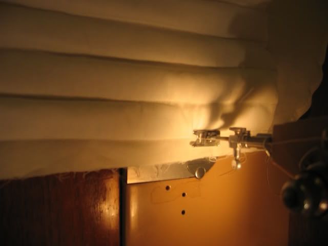

    NECKSEAL 101 **PIC INTENSIVE**
    Hello All,
    I have been wanting to do this for quite a while, but just did not have the time. Here is a tutorial for the Boba Neckseal. This is one interpretation. I also like Mrs. TK409's version (which is AWESOME) and I am not sure which is considered more screen accurate. Again, it is interpretation, and really subjective. I have looked at the High Def screen caps and here is one version....
    First, you will need a piece of tackle twill, or whatever you would like to make this with. And you will need a different material, a lightweight cotton for the lining and a dickie portion. So, we will have the "neckseal" the "lining" and the "dickie". You will also need some padding.
    The neckseal and the lining are both cut the same way. Take your neck measurement and add 3 inches. This will be the length of the rectangular piece of material you will be cutting. The width will be 7". So here is a pic of what you will have.....
    So you will need to cut one piece of the neckseal material and one piece of the lining material, with the same dimensions.
    Next, put "right sides together" this means take the part that you want to be seen for the neckseal and the part that you want to be seen for the lining and put these two pieces together, facing each other.
    Then, you will sew 3 of the edges with a 5/8" in seam allowance. This simply means to sew your line 5/8" in from the edge of the fabric. This is a standard sewing method.
    *Sewing tip, you have an alternative of cutting only a 1/4" seam allowance. This will help you to avoid the trimming, but the sewing is more difficult. It is easier to sew with a 5/8 inch seal allowance, and trim later.
    So, you will sew the two short edges and one long edge. And you will have this....
    Next, the trimming. First cut the two corners at a diagonal, about 1/4 to 3/8 " away from the stitches. If you cut too close to the stitches, you will risk the strength of the seam, so don't cut too close. Here are two pics...
    Next, you will trim all three edges at about 1/4 to 3/8"....
    Now you are ready to turn so the "right sides" will be facing outward...
    You can take an object with a point and press into the corners to make them sharp. Don't use something too sharp and be careful or you will poke through the seams or material. A No No
    Take this to your ironing board, or some similar facsimile of, make sure the
    iron is not too hot. I like to use a spritz of water and/or steam, and press the edges.....
    Next you will make lines with a very fine pencil. This will wash out later.
    Start at the top edge and make your lines for the ribs, 1 1/8" for each ribs, and make 5 ribs...
    Then you will need to cut the batting in strips that are about 1/2" to 3/4" w wide. 2 pics........
    Next make the strip the same length as the neckseal and put the strip in between the neckseal and the lining........
    Now you will stitch the neckseal and lining along your first line.....
    wash, rinse, and repeat, until you have 5 ribs.... 2 pics....
    you can do it!!!
    When you have all 5 ribs, take a look...... you are almost done!
    You will need to cut the dickie from the lining fabric...
    Then take the dickie to the ironing board, or similar facsimile thereof. You will now need to put the "right side" down. You may not have a "right side" and you may not really care, no one will see this part of the neckseal.
    Press up 1/4 to 3/8" on three edges, the two sides and the longest edge...
    If it is easier you can press all edges, it wont matter too much, but the top edge will be finished when you sew the neckseal to the dickie, so it is not necessary.
    Next you can set your machine to a zig zag stitch, with about 10 stitches per inch and the widest setting. Just practice on some scraps until it lays ok, this is not crucial either, no one will see this and zig zag this edge down...
    Now take the "right side" of the neckseal and the "right side" of the dickie and line up the edge you are going to sew together...
    Then sew these two edges together...
    And Viola.... neckseal..... I will leave it up to you to close as you would like.
    You can take a toothbrush and some bar soap, or Shout, or something and a little water and wash off the pencils line, and there you go........
    CONGRATS!! YOU DID IT!!

    Also, what thickness batting are you using?
  10. #9
    Join Date
    Jul 2007
    Location
    Oakdale, CA
    Posts
    1,295
    Re: NECKSEAL 101 **PIC INTENSIVE**
    I usually just buy it. I think it's 1/4 to 1/2"

    just a little not you dont reeeally need to cut thebatting into strips as your stitching pulls it really tight so both pieces of fabric almost touch.
    nice job though
  20. #19
    Join Date
    Jul 2007
    Location
    Oakdale, CA
    Posts
    1,295
    Quote Originally Posted by younginfett View Post
    nice job though
    I have done this both ways, and I just prefer putting the batting in strips. I like the look I end up with better, but here is more than one way to skin a cat.
    Thanks for the tip~
